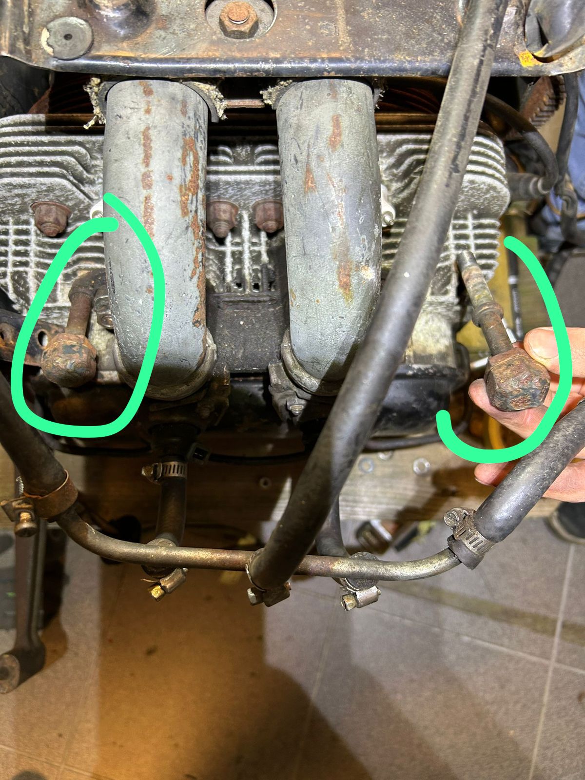

QUOTE(JeffBowlsby @ Jan 10 2024, 05:27 PM) *
Considering all the above, looks like you started with a 75 2.0L 49-state engine, which now has a case change to an early 1.7L case, with the original hardware swapped onto it.
Thank you Jeff for your help... on another note, when starting to take of the metal parts on the engine I noticed some bolts going into the cylinderheads (see picture). I cannot find them in the Porsche parts catalog and I am unsure of their purpose. Anyone know? Are these merely to hang the engine whilst works are done? Or do they serve a purpose?

Member No.: 104
Those are capped off air injectors, supplied by your also missing air pump and its piping. All 75 2.0s would originally have that system. Emissions.

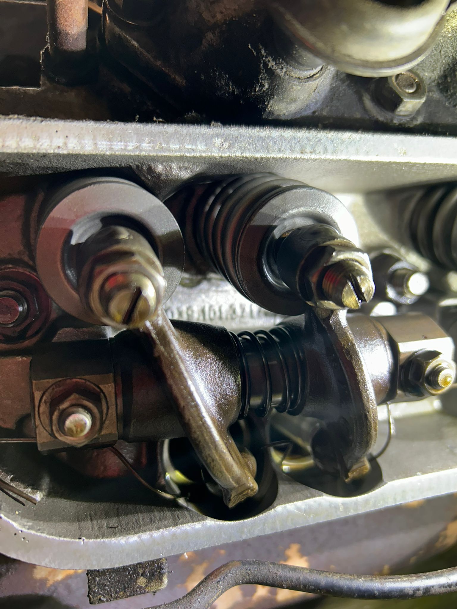

I have opened the valve covers of the cylinder heads to see the ref number on them (still trying to find out if I am now running a 1.7 (as the engine number indicates) or a 2.0 (what I thought it was originally).
The cylinder head ref reads 039 101 371 A (I think a 2.0 cyl head).
Would I need to dig deeper to know whether the engine is in fact a 1.7 turned 2.0 or still a 1.7?
Any suggestions on how I could find the answer to that?
Thanks
Shivers
post Jan 13 2024, 09:27 AM
Post #30
Posts: 3,708
Joined: 19-October 20
From: La Quinta, CA
Member No.: 24,781
QUOTE(Junioren @ Jan 12 2024, 01:20 PM) *
Thanks for all your help on previous questions.
Thanks
The 1.7 and the 2.0 have a different stroke. Maybe you can measure that to get your answer.
emerygt350
post Jan 13 2024, 10:35 AM
Post #31
Posts: 3,806
Joined: 20-July 21
From: Upstate, NY
Member No.: 25,740
And unless it is a bus 2.0 the intakes on the Porsche 2.0 has 3 bolts. 1.7 has 4. Your spark plugs are in the 2.0 position though, so you certainly don't have 1.7 heads. Not sure if the exhaust on the bus went out the sides or down like the 914.
Dave_Darling
post Jan 15 2024, 02:28 AM
Post #32
914 Idiot
Posts: 15,365
Joined: 9-January 03
Member No.: 121
All of the Type IV motors have bottom-side exhaust ports. That's one of the things that makes them a Type IV motor. The pre-72 Buses that have exhaust ports on the front and rear sides of the head have Type I style motors, not Type IV.
The plug angle already says these are 2-liter 914 heads. It is possible but very unlikely for someone to use those heads on a smaller-displacement motor. You're probably OK to assume the engine is a 2.0 one. If you really want to be sure, you can find someone to "pump the engine" and measure the air flowing into or out of the engine through a complete combustion cycle. But I wouldn't bother, myself.
--DD
emerygt350
post Jan 15 2024, 11:06 AM
Post #33
Posts: 3,806
Joined: 20-July 21
From: Upstate, NY
Member No.: 25,740
I bet if they went through the trouble of a new case they probably used the old sleaves and pistons or maybe even upgraded. Can't imagine keeping the 1.7 setup if you are going that far.
