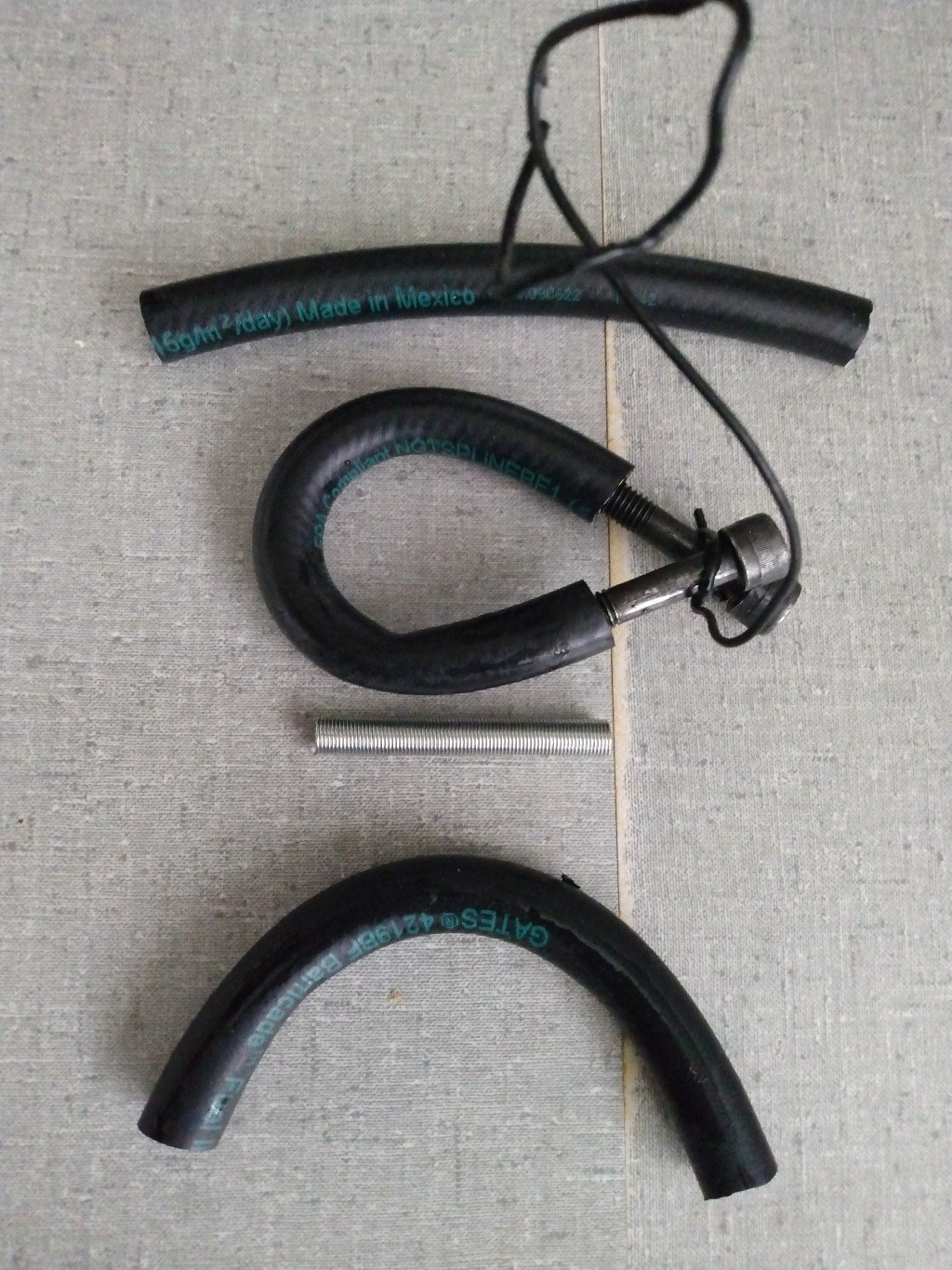

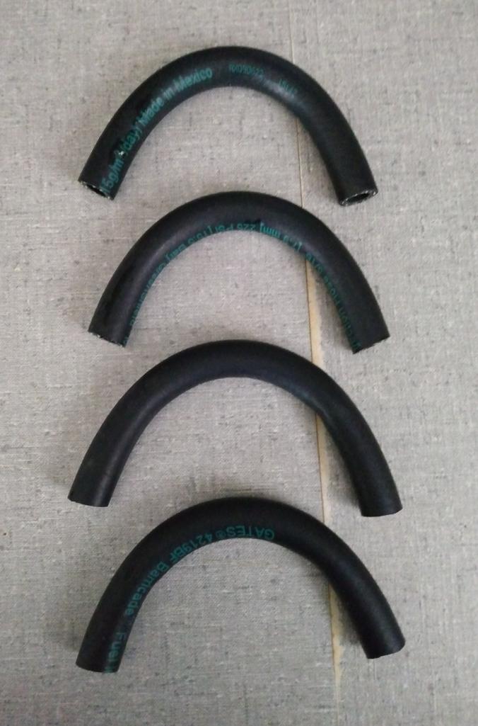

Gates Barricade 5/16 fuel injector hose. 2' cur to 6" pieces, inserted a small spring inside to hold the shape. Placed in boiling water for 3 minutes and cooled in ice water.Attached Image Attached Image
