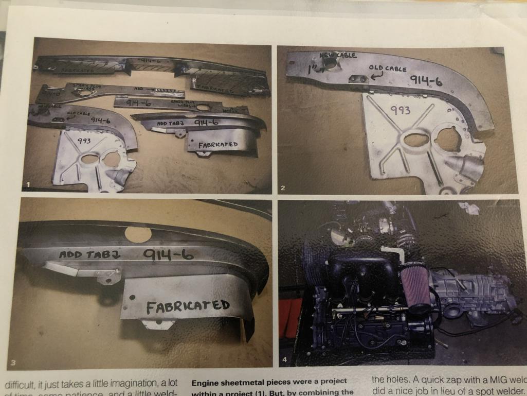

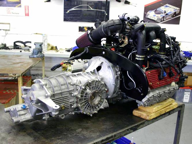

Also FWIW, what @mepstein describes is exactly the 'recipe' they did on my engine
QUOTE(mepstein @ Feb 6 2024, 10:26 AM) *
We go the opposite on our performance 3.6-4.0 builds. Switch to solid rockers and RS style cams.
This is a 993 converted to 3.8, RS cams, big valves, ect.
And since every thread is worthless without pictures (IMG:style_emoticons/default/chowtime.gif)

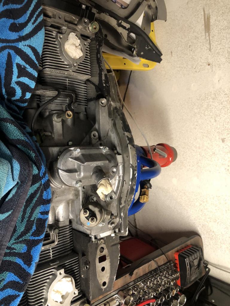

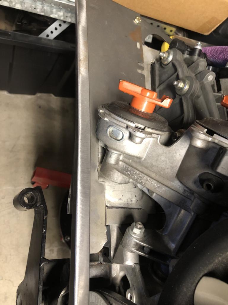

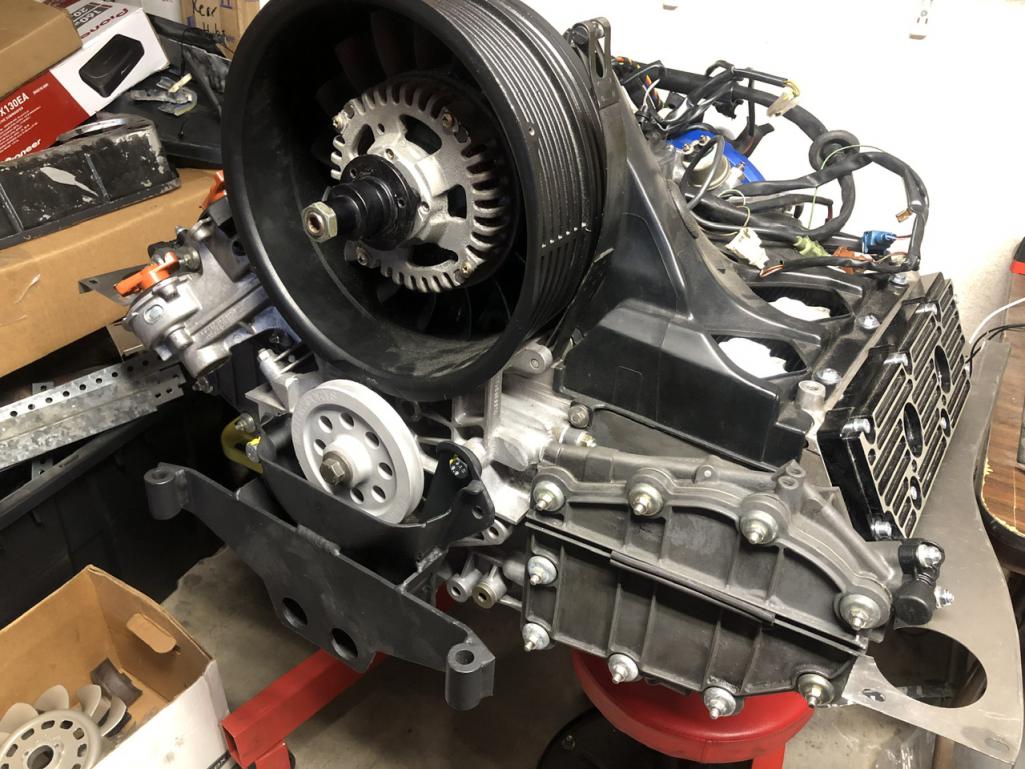

I trimmed the MB911 tin to fit my 3.6 and cut pieces off the 3.6 tin to fill the gaps. Note the indentation for the 12 plug distributer from the stock tin. Next steps is to either weld the pieces together or use rivets. I cut the top off the rear 3.6 tin but I will need to get the motor off the engine stand to make it all fit.
Next steps:
-Wire up alternator
-Put Fuel Injection back on
-Install Clutch
-Take motor off of engine stand and put on hydraulic table, so I can install the rear tin and mate the 916 gear box.
-Clean up engine compartment and install 3.6 wiring harness, ECU, etc.
-Install drive train.
Cairo94507

@Steve - Hi Steve,
Very glad to see you moving forward and ahead of me. Kind of gives us a road map. I hope to pick up my car from Chris' Red Barn the last week of March. Seriously looking forward to getting started on engine stuff. (IMG:style_emoticons/default/beerchug.gif)

QUOTE(Cairo94507 @ Mar 18 2024, 05:27 AM) *
@Steve - Hi Steve,
@cairo94507 Michael, I'm surprised you don't let the red barn cut and paste/weld the tin together. To do it right I envision welding the MB911 tin to the 993 tin in the front and back. Using plug welds, seam welds and scab plates. My welding skills are crap, but you can't really see the tin once the motor is in the car. I will also send it out and get the Frankenstein mess powder coated when done.

@Steve Hi Steve - I have a set of the 993 tins and a new set of Ben's 914-6 tins. We will fit them and weld as needed- do some light bodywork then powder coat satin black. Should look good. (IMG:style_emoticons/default/beerchug.gif)

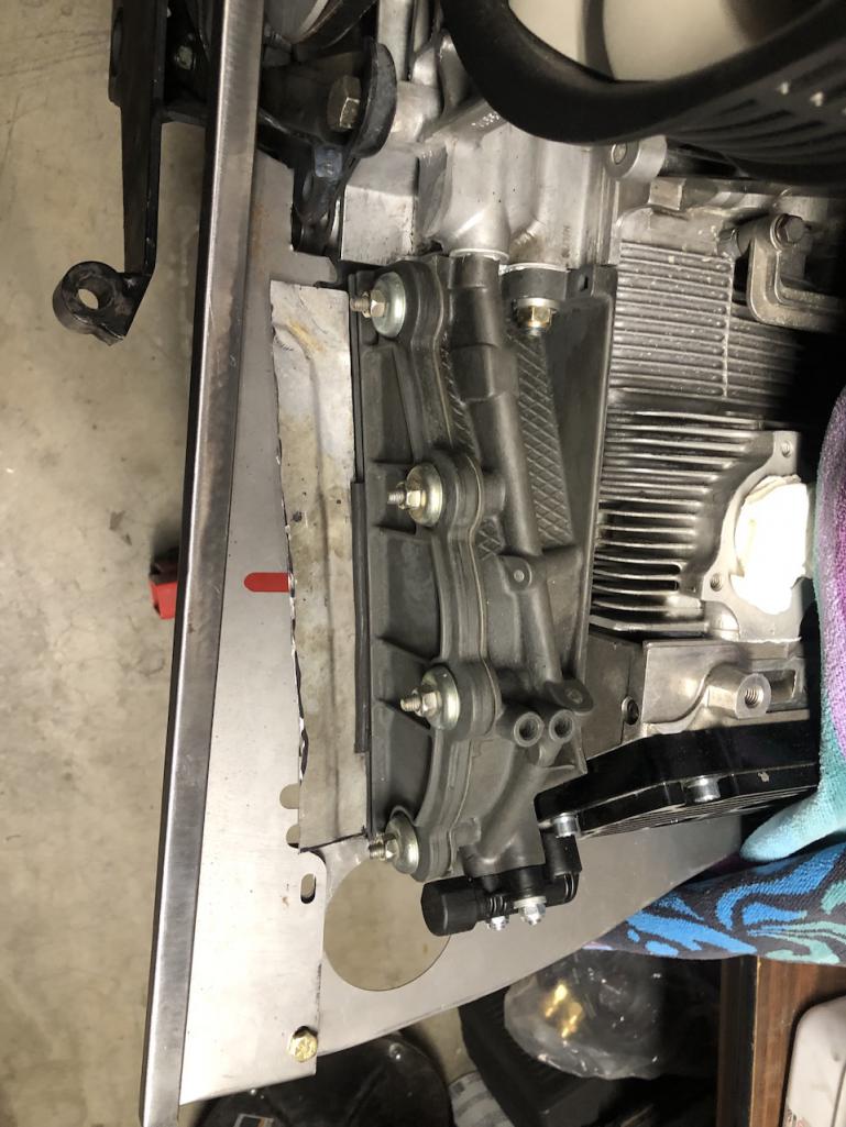

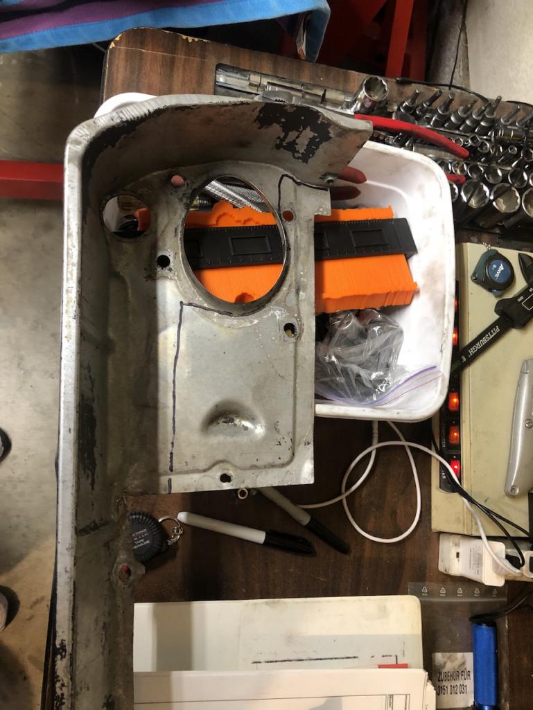

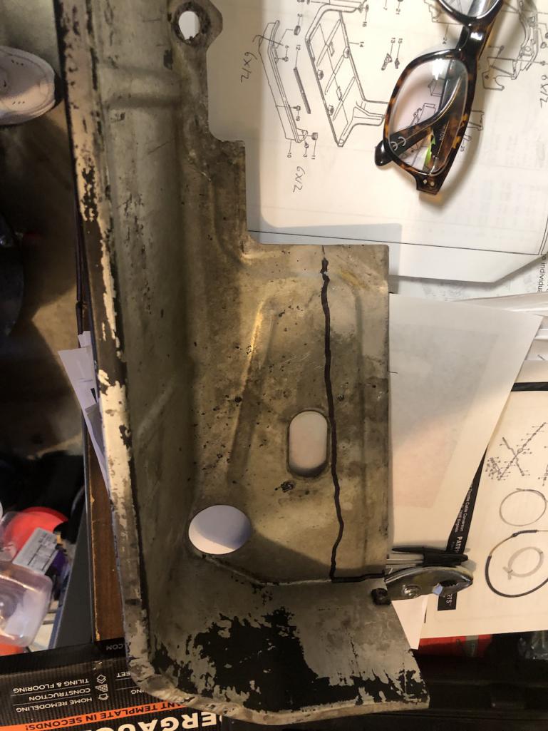

Facing the motor, I should of cut more out of the 993 tin on the right side, to cover some of the MB911 holes and slots. Old Saying... Measure twice, cut once!!
Same thing with the rear... I should of left the 993 tin one piece and just cut off the top. Then cut off enough of the bottom of the MB911 tin to match the 993 tin, then make it two pieces.
I also plan on cutting the front piece of the tin in half, so I can easily remove it when removing or installing the engine. With the front tin in place, its hard to get to the Rich Johnson mount top bolts and his mount hangs up on the front tin. I don't know if the stock six mount has this problem.

I did the same thing when installing my 4.0 motor. I had to alter the aftermark 914-6 tin and graft in the 3.6 specific items. And I had to fabricate the filler for the left rear where a 914-6 has the oil cooler.

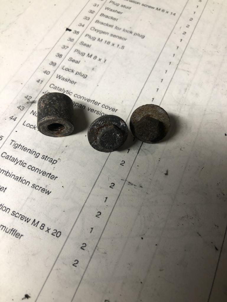

One week at a time. I can’t get to the rear tin with motor on engine stand, so I decided to put motor back together first and then put it on hydraulic table.
One problem at a time. The bottom studs for the motor mount were too short, so I replaced them with bolts like the top. I ended up with Top Right 10x35x1.5. Top left 10x70x1.5 and the bottom 10x55x1.5 and torqued all four to 30 ft-lbs.
The motor mount is a Rich Johnson mount that Otto's installed 25 years ago. I used it on a 2.7 for a couple of years and then on my 3.2 for the last 20+ years.
I used evaporust to clean and remove rust on the hardware. It made some of the hardware look oxidized. I ended up going to ace hardware and replacing all the shroud sheet metal screws. Not factory, but they look great. Factory has the washers permanently on the bolts for a ton more money.
Next is finish up mounting and wiring the alternator and then onto distributor and spark plug wiring and then onto the injection.
