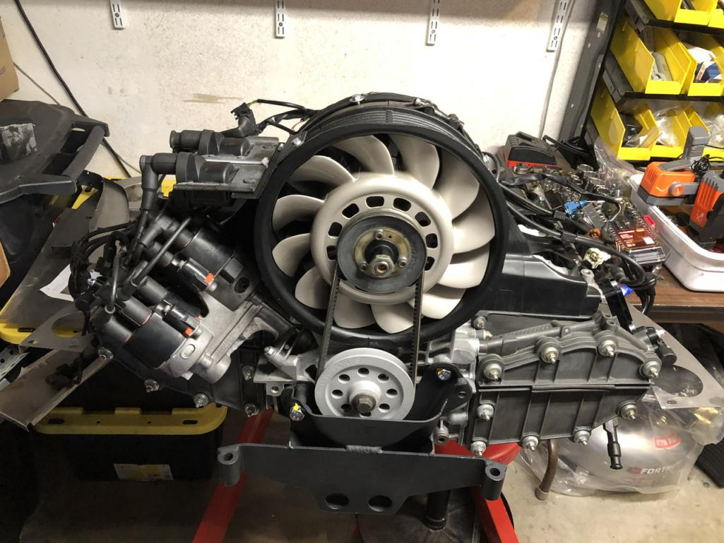

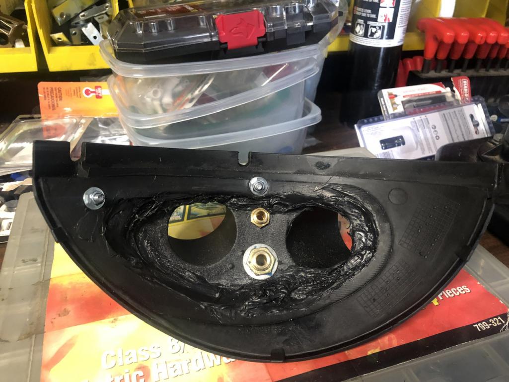

Steve   I trimmed the MB911 tin to fit my 3.6 and cut piec...   Mar 17 2024, 06:43 PM
Steve   I trimmed the MB911 tin to fit my 3.6 and cut pie...   Mar 28 2024, 09:46 AM
Cairo94507   @Steve - Hi Steve, Very glad to see you moving fo...   Mar 18 2024, 06:27 AM
Steve   @[url=http://www.914world.com/bbs2/index.php?show...   Mar 18 2024, 08:45 AM
Cairo94507   @Steve Hi Steve - I have a set of the 993 tins a...   Mar 18 2024, 09:07 AM
Steve   [b]@[url=http://www.914world.com/bbs2/index.php?s...   Mar 18 2024, 09:30 AM
Cairo94507   @Steve - Good to know- we shall see how it works ...   Mar 18 2024, 09:34 AM
ClayPerrine   I did the same thing when installing my 4.0 motor....   Mar 20 2024, 02:18 PM

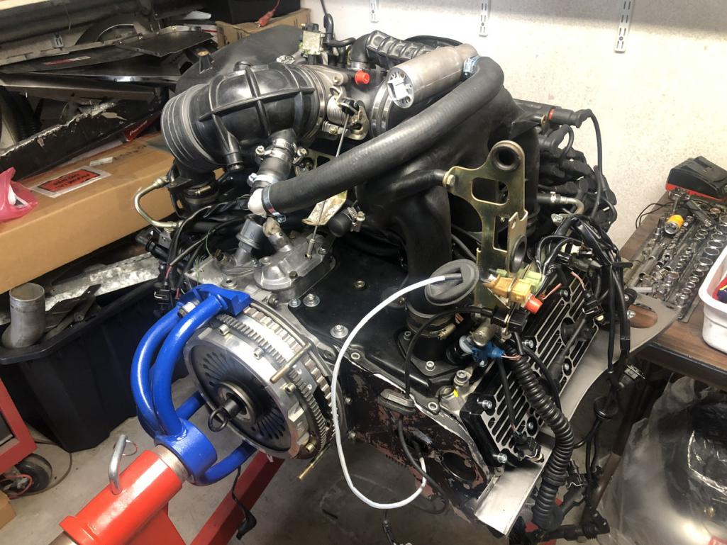

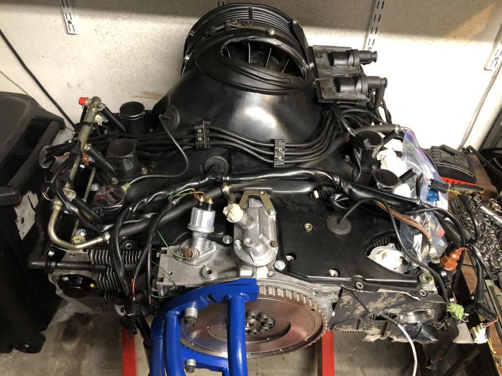

Steve   Slowly but surely. Wired up Alternator and mounte...   Apr 1 2024, 09:32 AM
SirAndy   ... Also connected up the spark plugs and coils wi...   Apr 1 2024, 11:38 AM
Steve   ... Also connected up the spark plugs and coils w...   Apr 1 2024, 01:27 PM

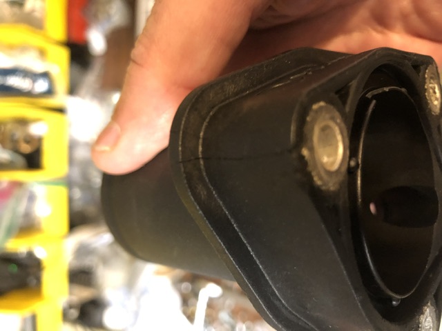

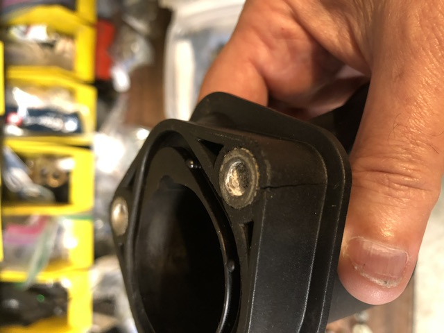

Steve   Not much progress. Caught Covid, dog ate my homew...   Apr 22 2024, 12:17 PM
mepstein   They always crack. Luckily they are pretty cheap.   Apr 22 2024, 12:33 PM

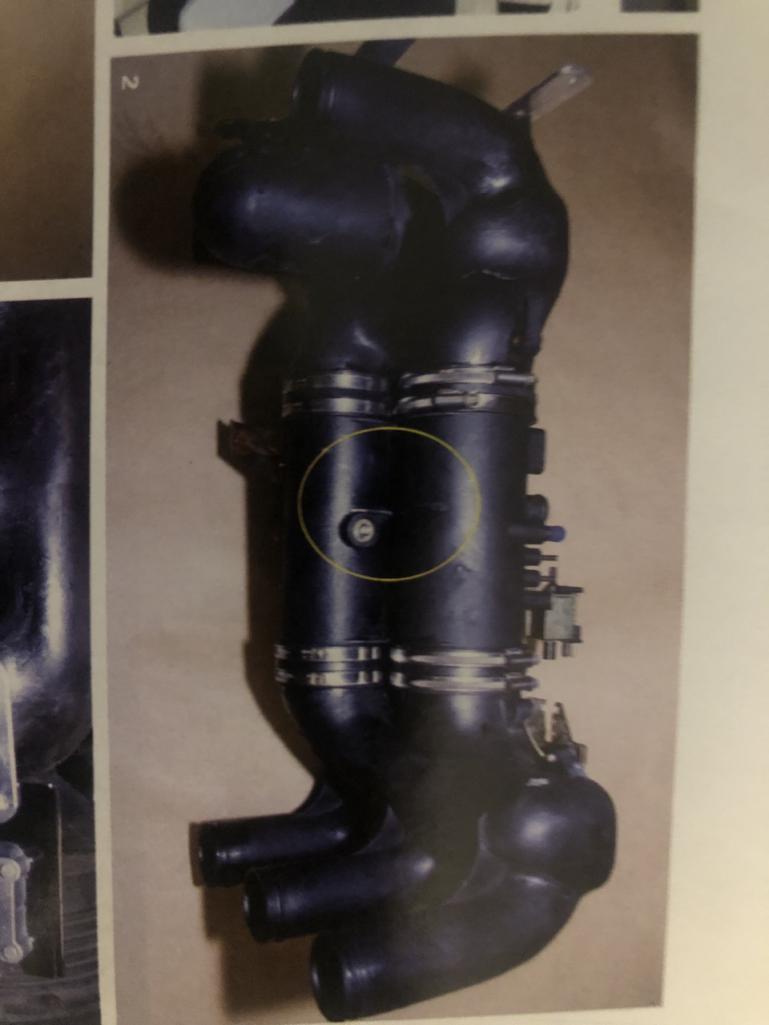

Steve   Something else I read on Pelican. If the 3.6 came...   Apr 22 2024, 01:02 PM
rick 918-S   Nice detail. Seems like there are several hot rods...   Apr 23 2024, 09:58 AM

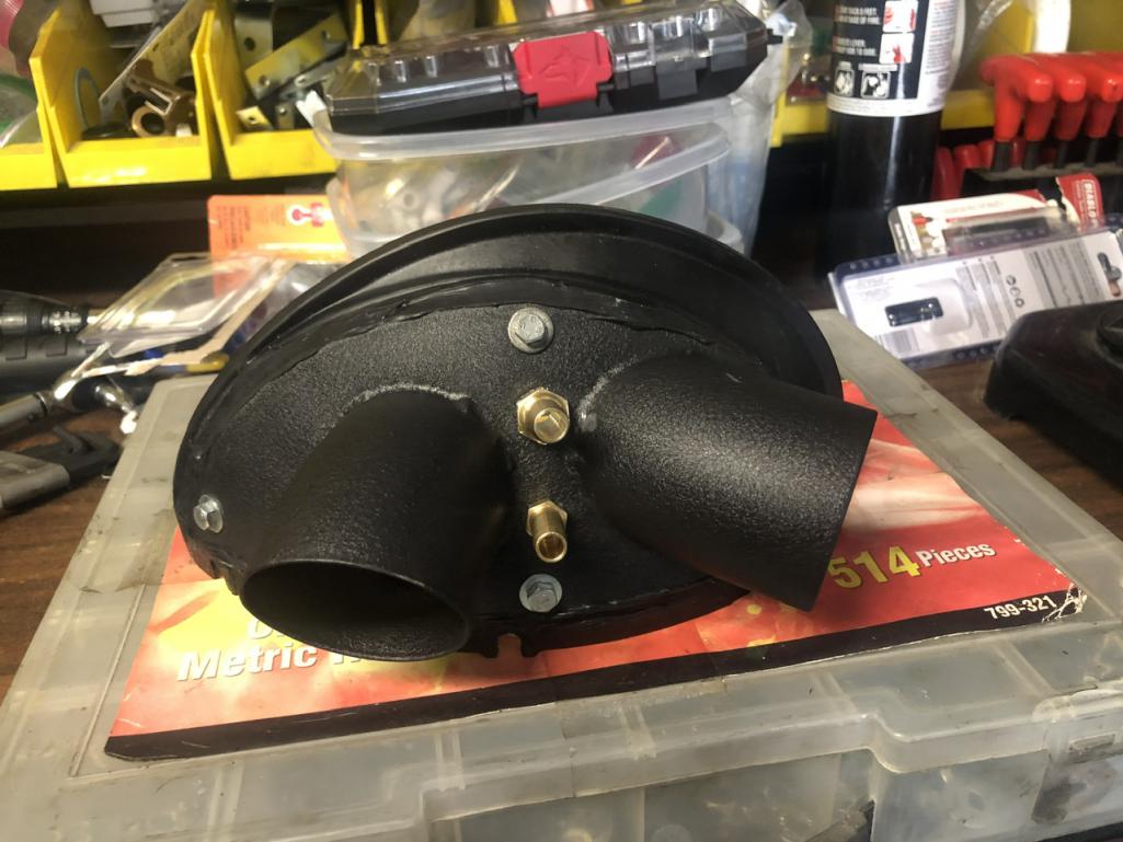

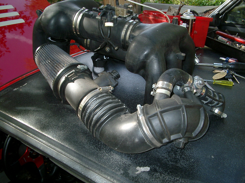

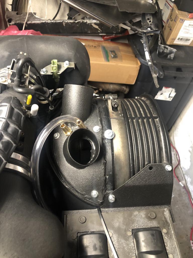

Steve   Plumbed the idle control valve into the new PMS 3....   May 4 2024, 05:57 PM
Cairo94507   Looking good Steve; I appreciate the photos to kee...   May 5 2024, 06:55 AM
Steve   @sirandy [b]@[url=http://www.914world.com/bbs2/...   May 5 2024, 07:48 AM
SirAndy   @[url=http://www.914world.com/bbs2/index.php?show...   May 5 2024, 10:28 AM
Cairo94507   :popcorn: :beer2:   May 5 2024, 08:49 AM

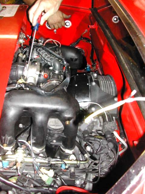

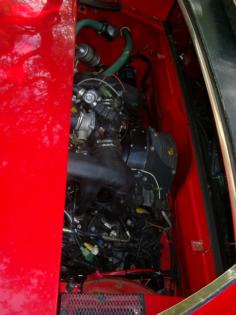

SirAndy   You can sort of see where it all ended up here: h...   May 5 2024, 10:35 AM
SirAndy   And this shows you where my air filter ends up: h...   May 5 2024, 10:37 AM
SirAndy   I think that short 90 degree bend piece between th...   May 5 2024, 10:40 AM
Steve   :beer2: Thanks @[url=http://www.914world.com/bbs...   May 5 2024, 11:39 AM
Cairo94507   @SirAndy and [b]@[url=http://www.914world.com/bb...   May 5 2024, 02:21 PM
Steve   @sirandy looks like you added another 45 degree e...   May 5 2024, 03:38 PM
SirAndy   @[url=http://www.914world.com/bbs2/index.php?show...   May 5 2024, 05:11 PM
Steve   [quote name='Steve' post='3143523' date='May 5 20...   May 5 2024, 05:44 PM
ClayPerrine   I did the same thing. I cut the two tubes apart s...   May 5 2024, 07:36 PM
Steve   I did the same thing. I cut the two tubes apart ...   May 5 2024, 10:06 PM
Steve   Idle control valve connected from the bottom of th...   May 6 2024, 08:45 PM
