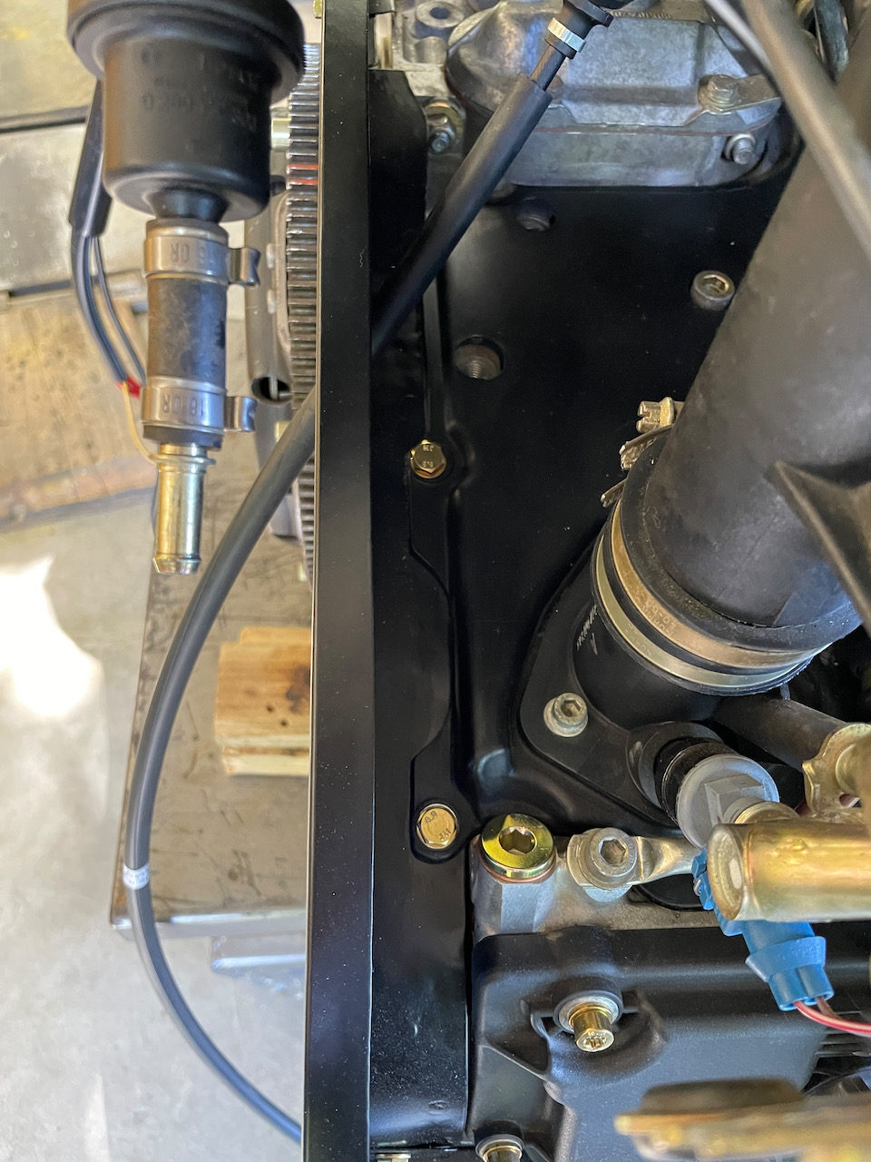

Yesterday we started with Greg replacing the distributor belt. Now "they" tell you that you can drift the pin out for the gear at the bottom of the shaft; I call BS on that. We tried for a good 20 minutes and that little sucker would not budge. We ended up drilling it out and that did the trick with no collateral damage. I ordered a new pin from Porsche along with 2 rotors for general principle. So belt replaced and distributor reassembled- save for the pin which is on the way.

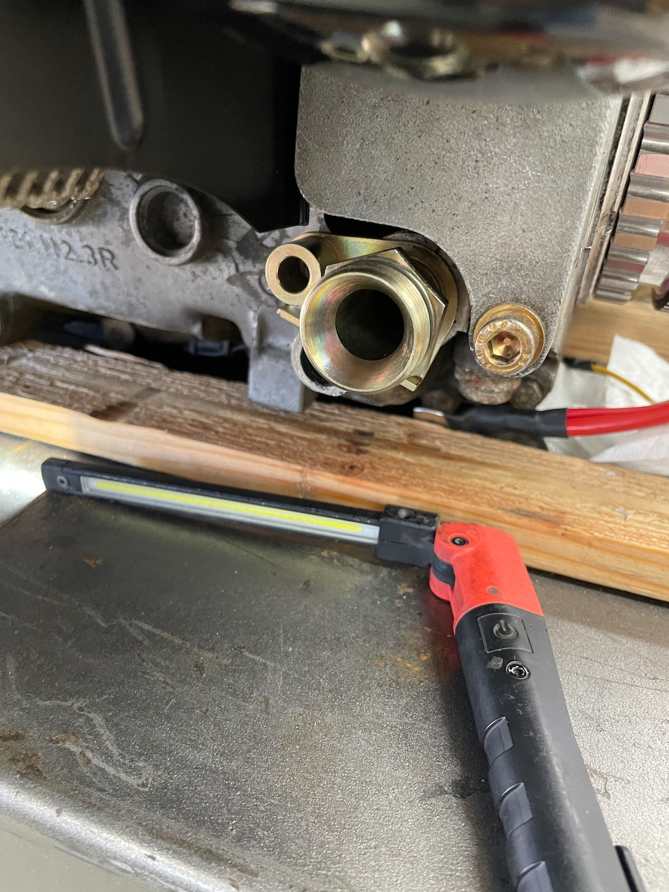

We then installed the oil return fitting below the oil filter on the 3.6 - took about 3 minutes- strangely satisfying though.
Then we installed the modified fan shroud "Mickey Mouse" ears and coil bracket with coils. I still have to order the new decals for the coils.

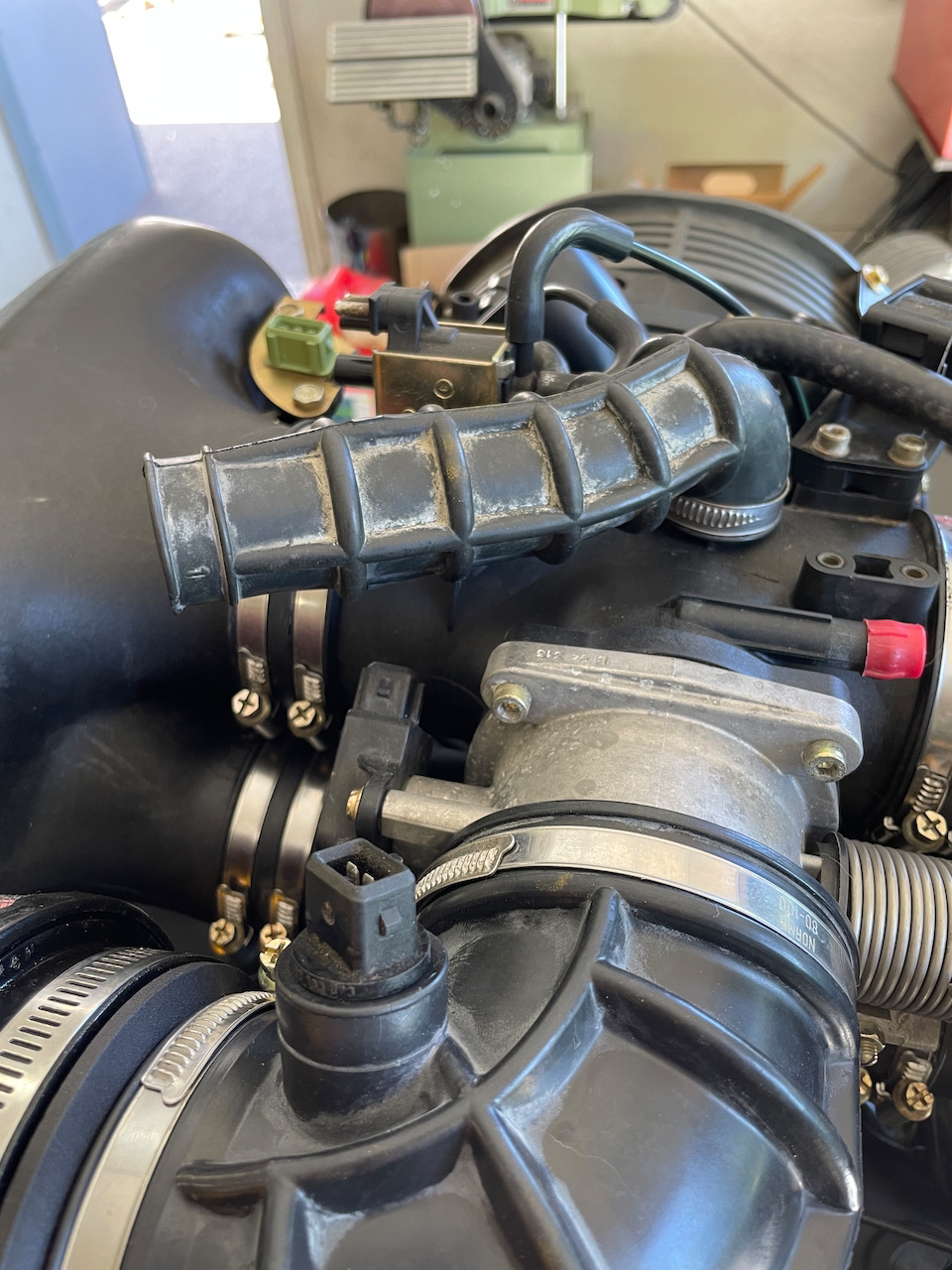

Greg did the modification that allows you to rotate the throttle body downward- that was a bit stressful just because we were cutting the plastic bridges (3) between the upper and lower. Glad to report that was done and now we can rotate the throttle body down about 1" or so to be sure we can clear the engine lid.

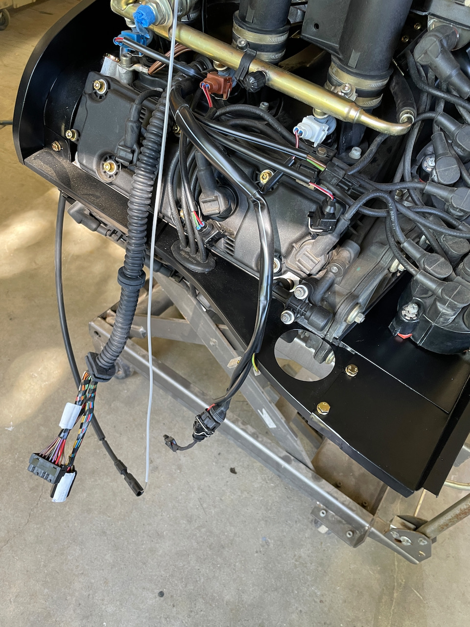

Then we pulled out ALL the wiring harnesses for this motor to go into the car. We have 2 PMS harnesses and then the stock 993 car harness that connected to the engine harness and DME (with 22 connectors). We already replaced the engine harness with a factory new harness- that was about $110= best deal ever. In total, It's a whole lot of wires and connectors. We are working to figure out exactly what we need and what can be discarded. That will be a big project.
We also got the PMS throttle cable on the engine- I just need to order the clip that connects it to the throttle body.

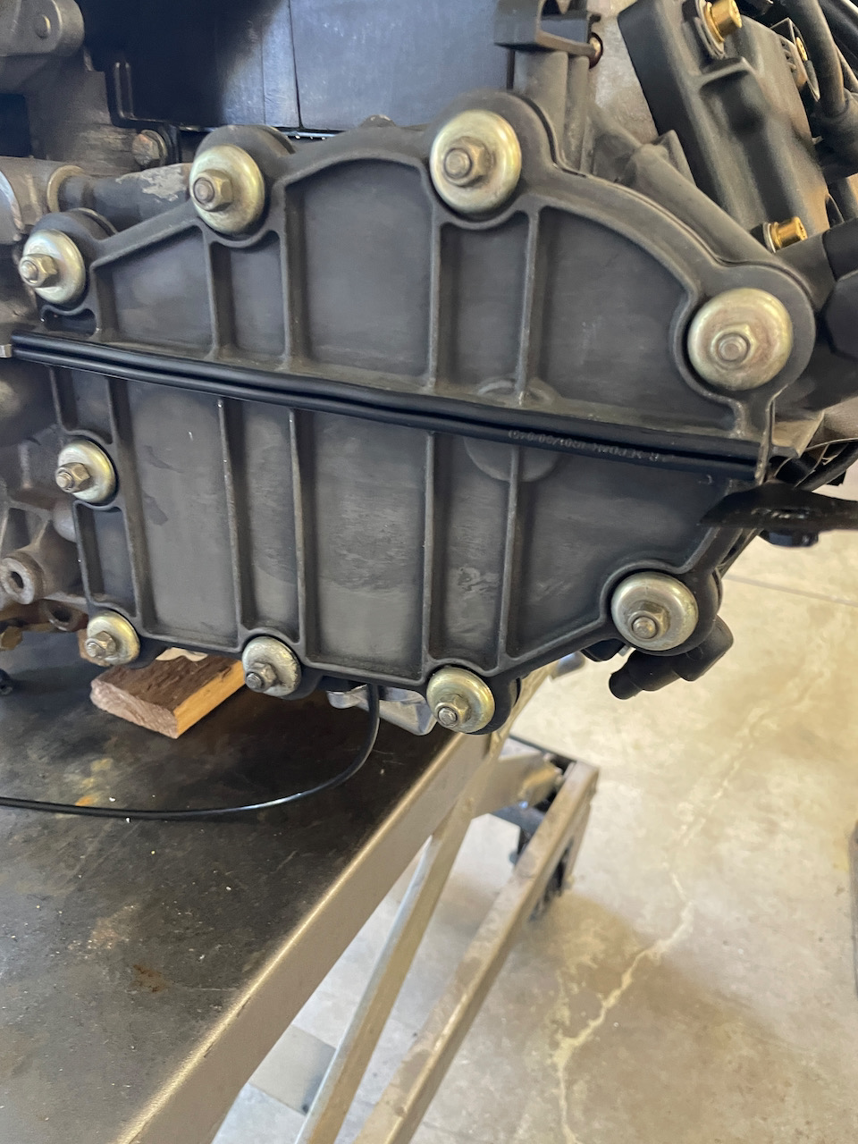

OH, and for those "Porsche tax" followers, I was missing the small rubber "gasket" which fits into a slot on the outside of the cam chain box covers- straight piece of rubber with a channel that accepts the engine tin where it sits against the chain box cover. In Post 192, the last picture, shows the chain box cover with the engine tin slipped into the slot on the cover where the rubber gasket belongs. It actually looks like a wiper blade refill with a grove. I thought surely it would only be $10..... well $132 later I have those 2 small pieces of rubber coming from Porsche. That was with my PCA, AARP, AAA, Old Dude, and good customer discount.... man, Porsche, really?
Can I see what those rubber pieces looks like?
Looking great!

Hi @Gint . Yeah, here is a picture of one side, they are identical.

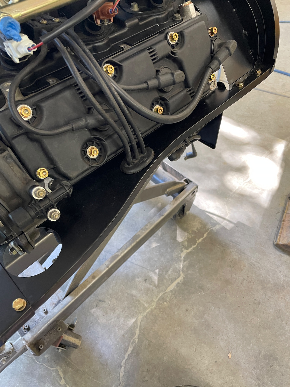

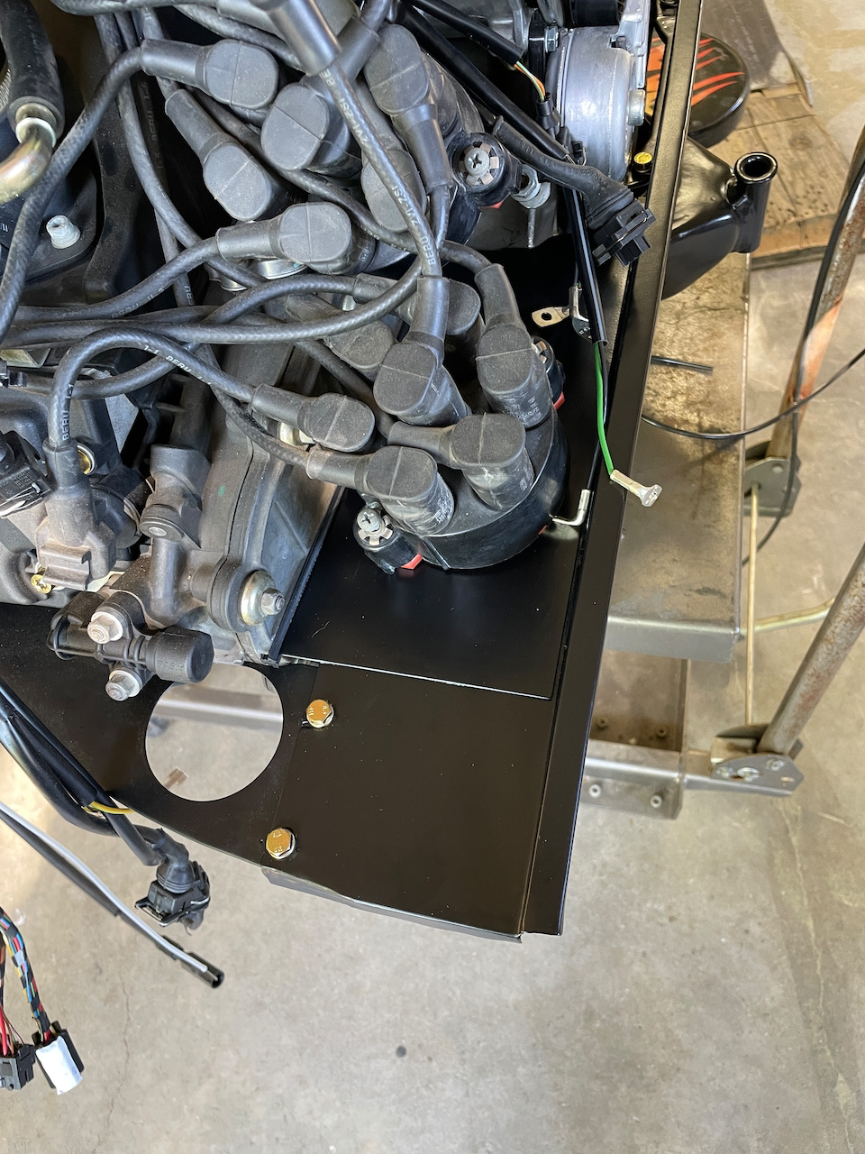

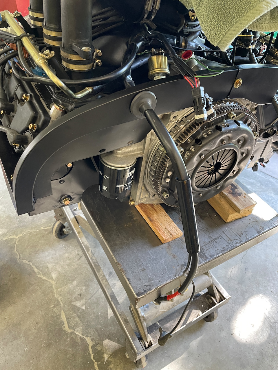

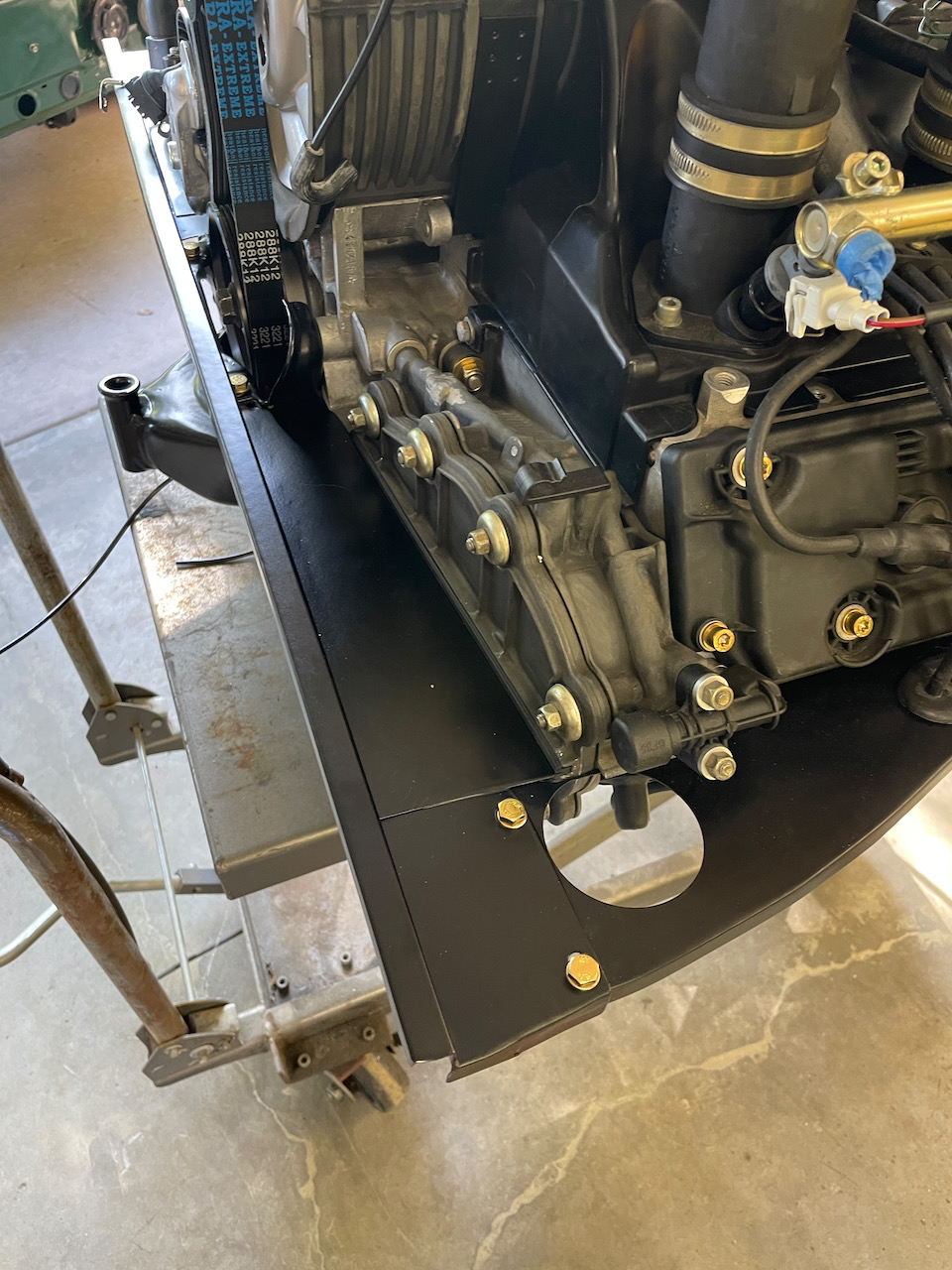

Didn't do much today. I did "install" the two stupid priced rubbers that the front engine tin fits into so it does not rattle and makes a good seal.
Then we installed the last piece of engine tin, the front (Fan) side- that completes the engine tins and I have to say they look great; Greg does nice work.

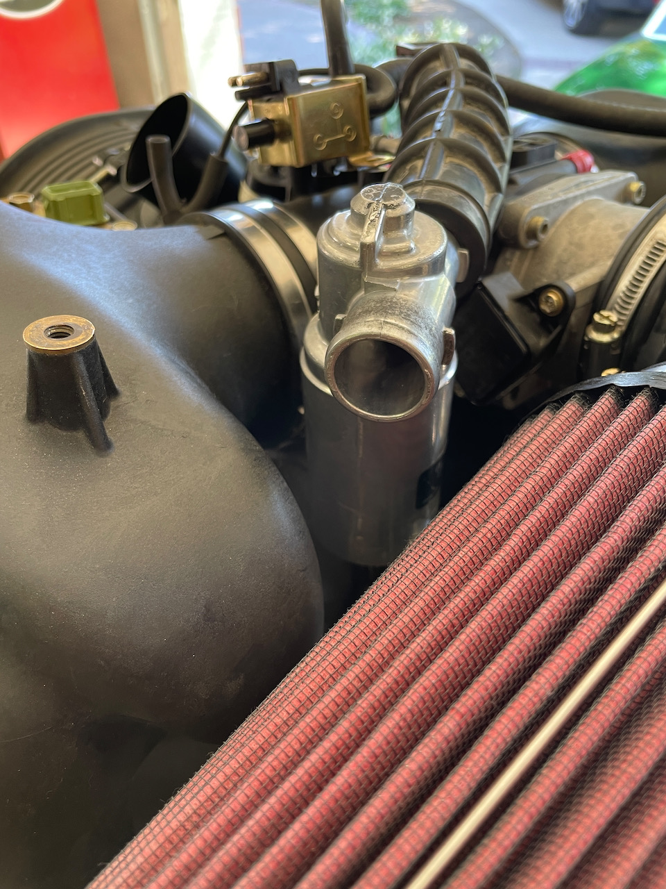

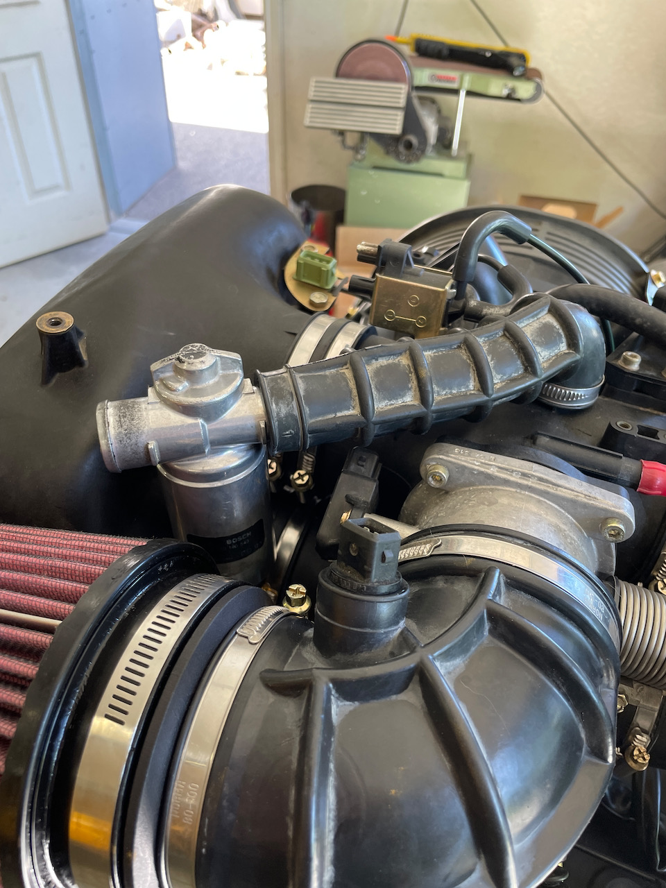

Then we began futzing around with the idle control valve that in its stock position sits right on top of the motor and looks like crap. So we are exploring relocating it under the intake or at the very least to the non-throttle side of the throttle body so it is not right in your face. We are going to source to 7/8" OD pipe and see if we can make a pipe that will allow us to move it. It pulls vacuum so a normal rubber hose would likely collapse.
Anyway, that was it for the day. We just kind of enjoyed lunch and then sat in the shade, like old men, and talked. (IMG:style_emoticons/default/beerchug.gif)

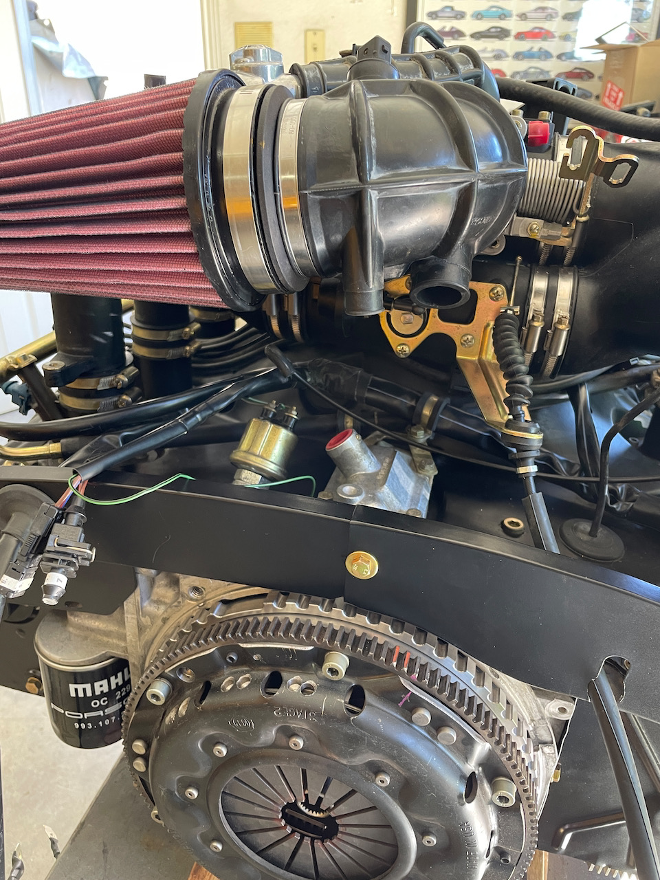

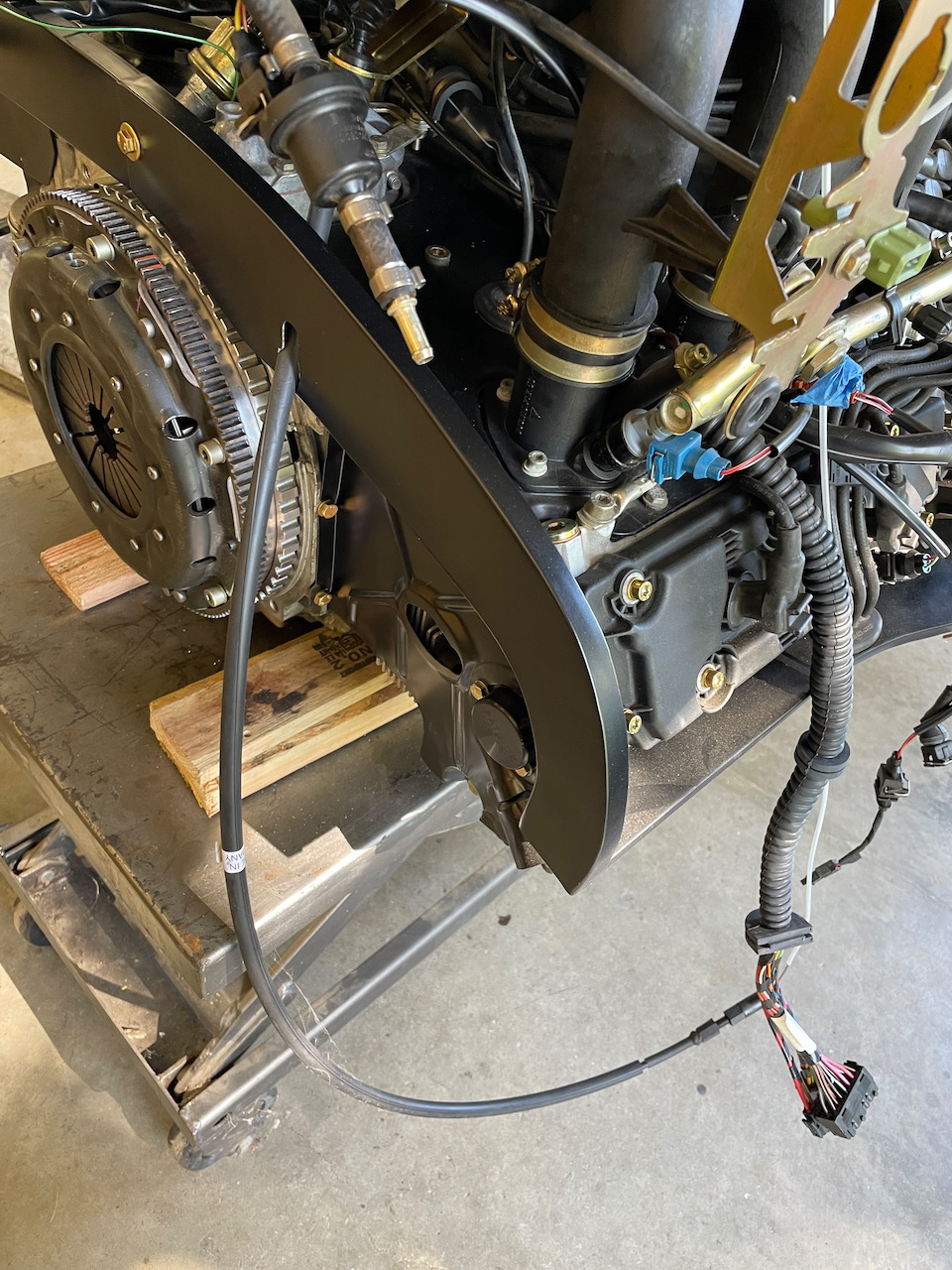

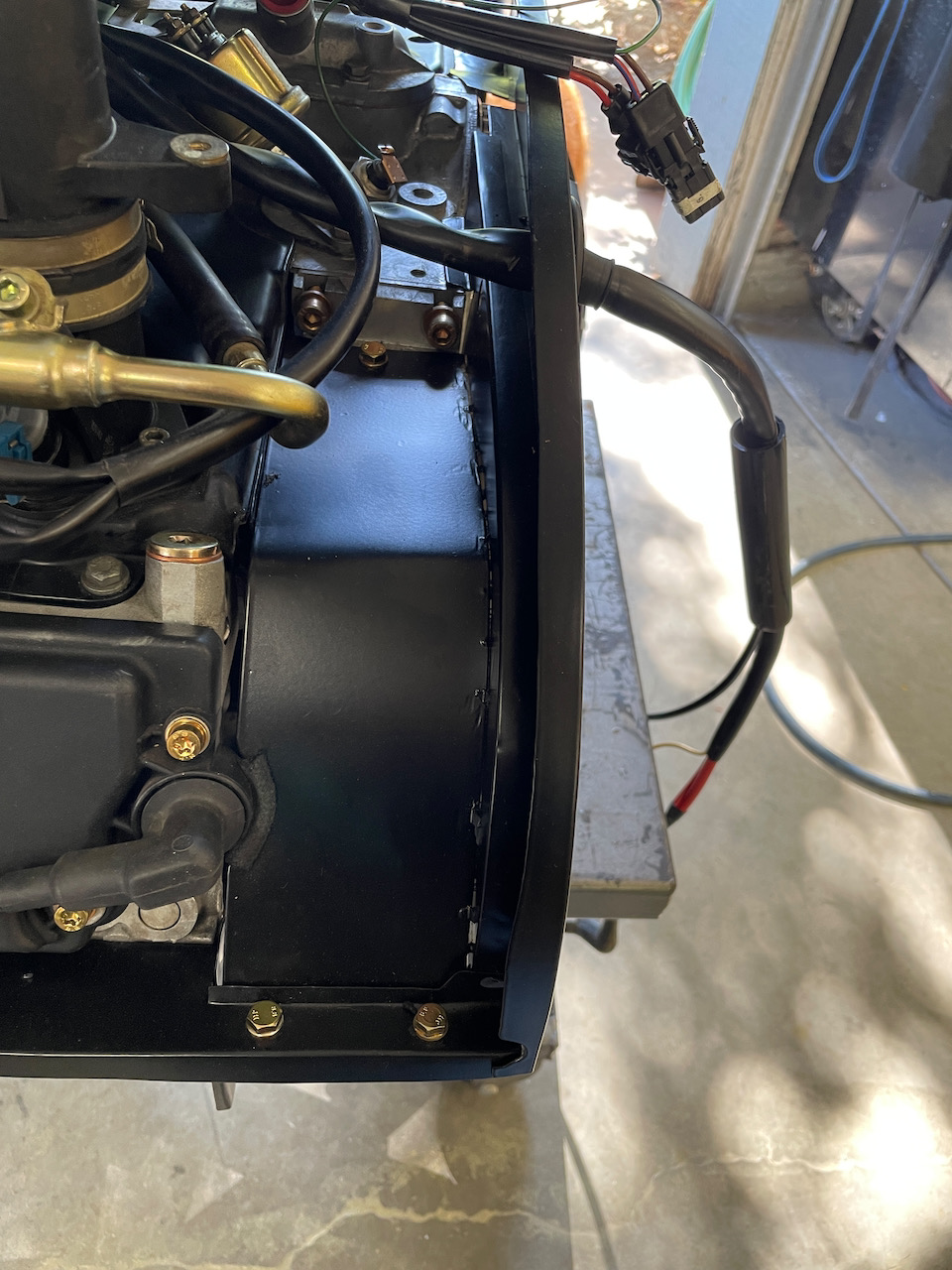

More:

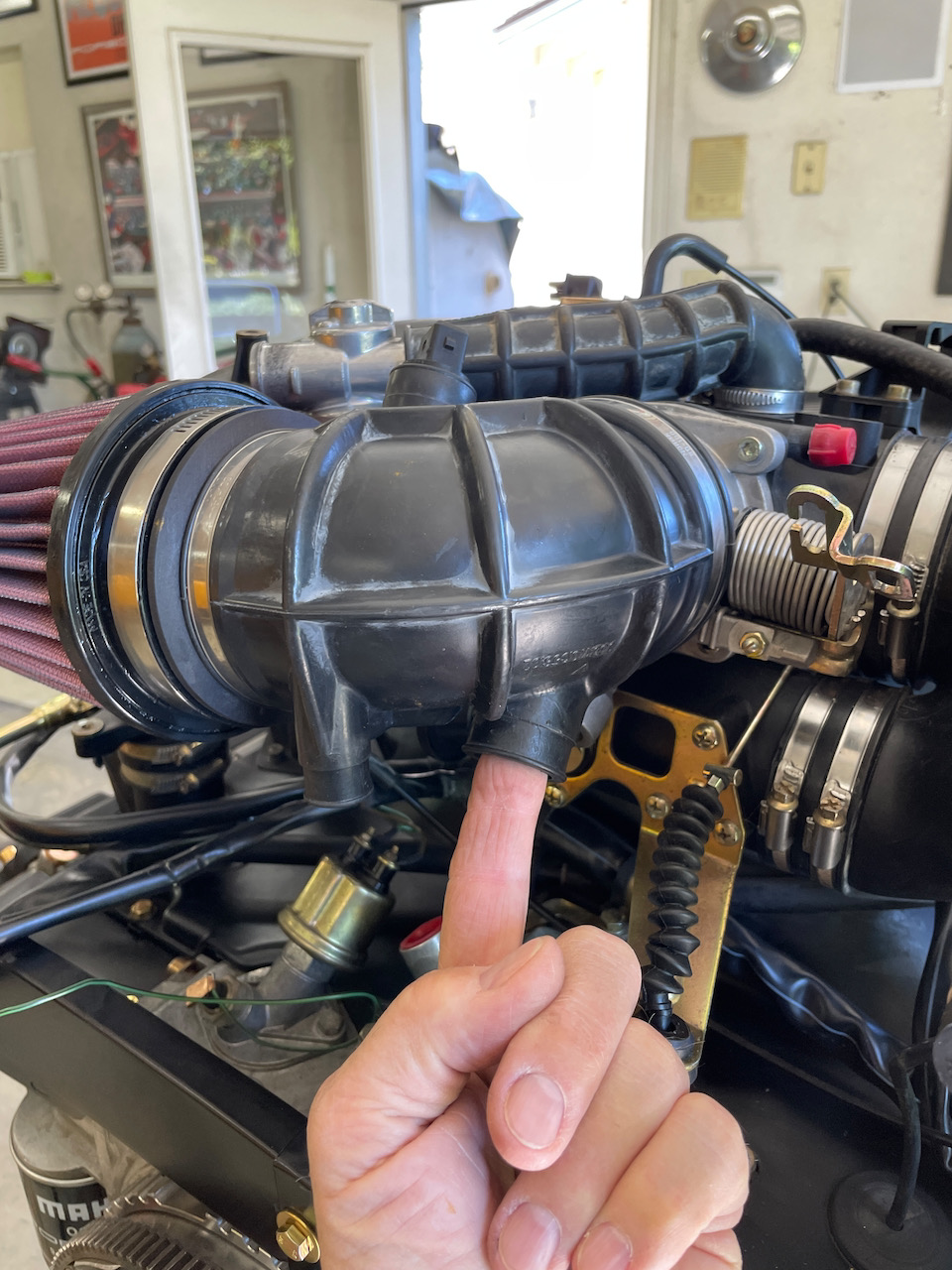

Nice air cleaner setup. But where is the Mass Airflow Sensor?
Cairo94507
post May 12 2024, 07:55 AM
Post #217
Michael
Posts: 10,806
Joined: 1-November 08
From: Auburn, CA
Member No.: 9,712
@ClayPerrine - Now that is a great question (IMG:style_emoticons/default/confused24.gif) . The PMS boot which replaces the stock 993 boot has ports for "things". I doubt those are for the MAF sensor. I googled '95 993 3.6 Porsche MAF sensor and I don't think anything like that came with the engine as received. I will have to look into this on Tuesday when Greg and I next meet to work on this. And Clay, thanks for staying tuned in on this swap. I appreciate your expertise. (IMG:style_emoticons/default/smilie_pokal.gif)

QUOTE(Cairo94507 @ May 12 2024, 08:55 AM) *
It isn't something that attaches to the ports for "things".
The MAF sensor goes between the air cleaner and the throttle body. It has to be there for the engine to run.
(IMG:http://www.914world.com/bbs2/uploads_offsite/cdn4.pelicanparts.com-1143-1715522456.1.jpg)
The factory motronic won't work without it unless you do major modifications to it.

@ClayPerrine OK, that helps a lot. I will find one if we do not have it sitting somewhere. I checked the pictures I have of the engine as purchased and it did not have the MAF on it. I have reached out to the seller to see if it may be sitting around in his shop. Thanks again Clay. (IMG:style_emoticons/default/beerchug.gif)

QUOTE(Cairo94507 @ May 12 2024, 09:17 AM) *
Probably still attached to the air filter assembly. And you don't need the air filter assembly, it won't fit in a 914. The DME harness should have a round plug that connects to it.
If you can't get the MAF, then you can buy one. They are about $200.00.
And you will need to hook the idle air motor in after the MAF.
