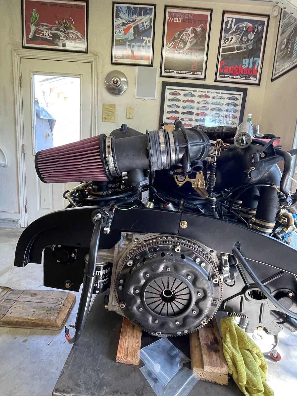

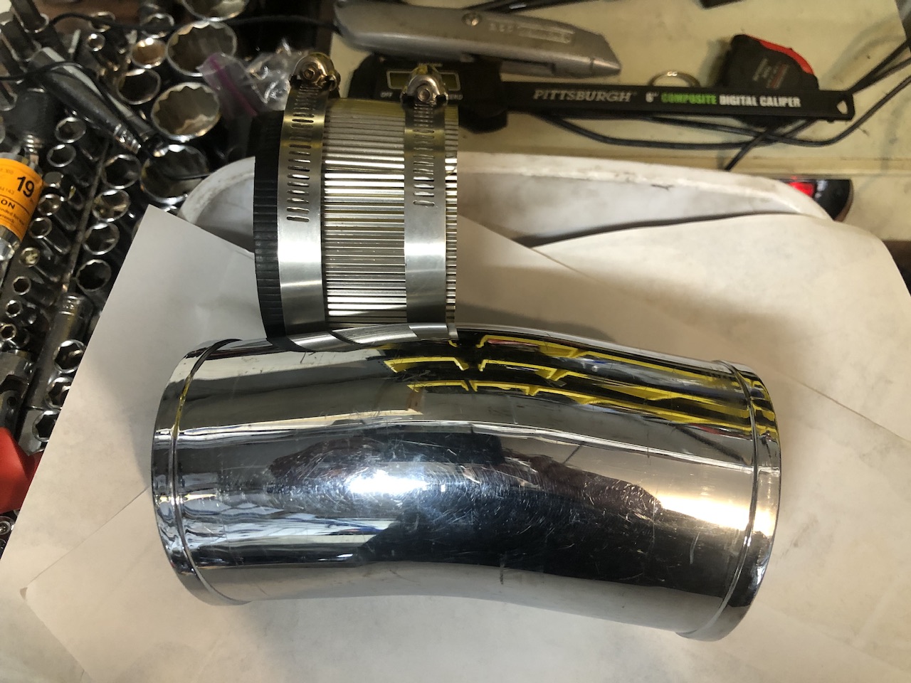

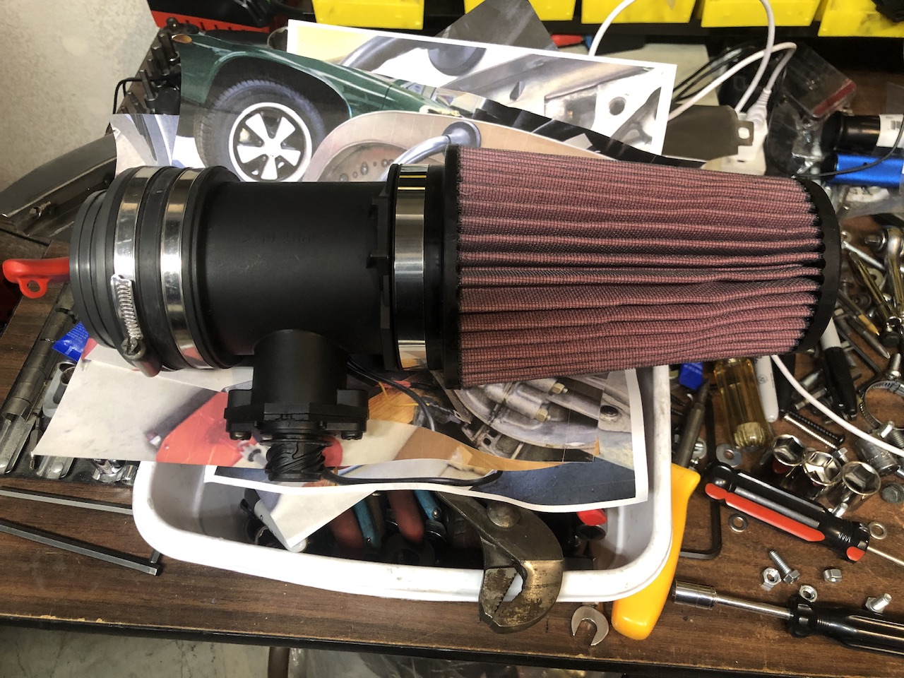

I attached the air flow sensor to the air cleaner. The MAF and air cleaner is 3.5”. The 3.2 PMS elbow and throttle body is 3”. I’m debating on extending the elbow like Sir Andy did, so I can run the idle control valve hose on top versus the bottom. Plenty of 3” intake stuff at O’Reillys and auto zone to make it work. Regarding the 1” pipe from the 3.2 elbow to the idle control valve, I cut up left over hose from the smog pump and other left over parts to extend the hose. Curious if you have to lay the idle control valve flat. I’ve only seen them horizontal on 3.2 and 3.6 installs.
Spectre and Home Depot 3” adapters.

MAF just in front of the air cleaner
(IMG:http://www.914world.com/bbs2/uploads/post-179-1202450824.jpg)

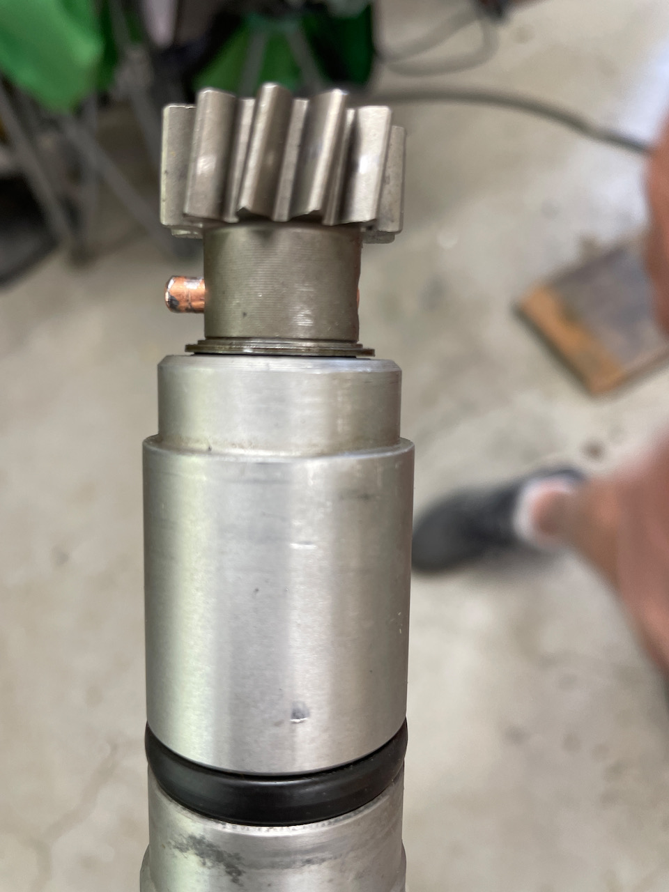

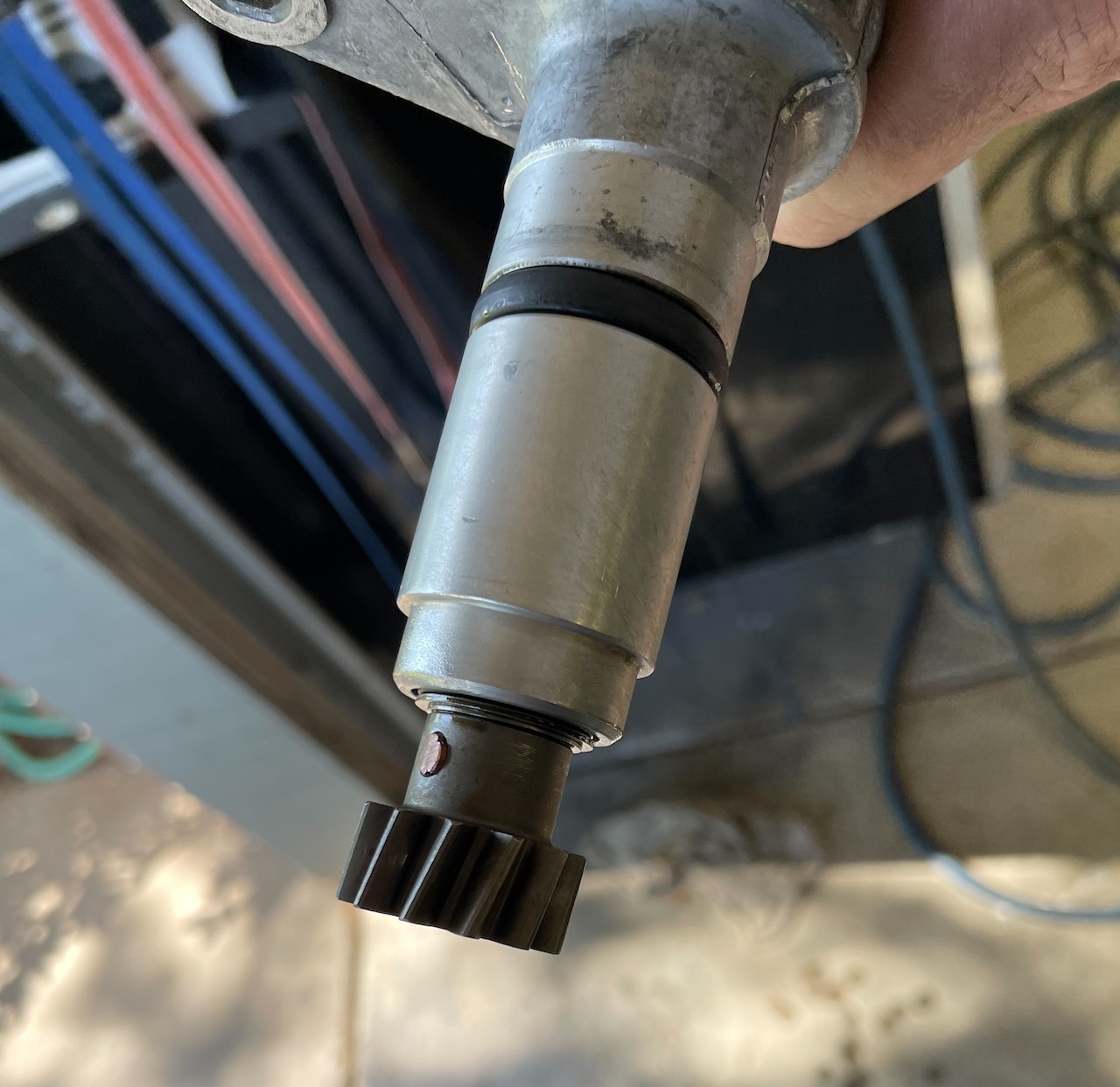

Today we put the distributor shaft gear pin in. You drive it in and it protrudes about 1/8" on either side. Greg used a punch and hit it to make the pin swell in the gear- that took about 1/8" of the excess off and then he ground the remainder. That puppy is not going to come out without drilling it out. We then put the new rotors on and installed the distributor after once again confirming both rotors are properly timed. Then we connected the coil wires and that was a wrap for the ignition.

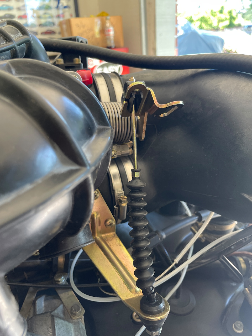

Then we installed the new throttle cable clip- nice and easy.

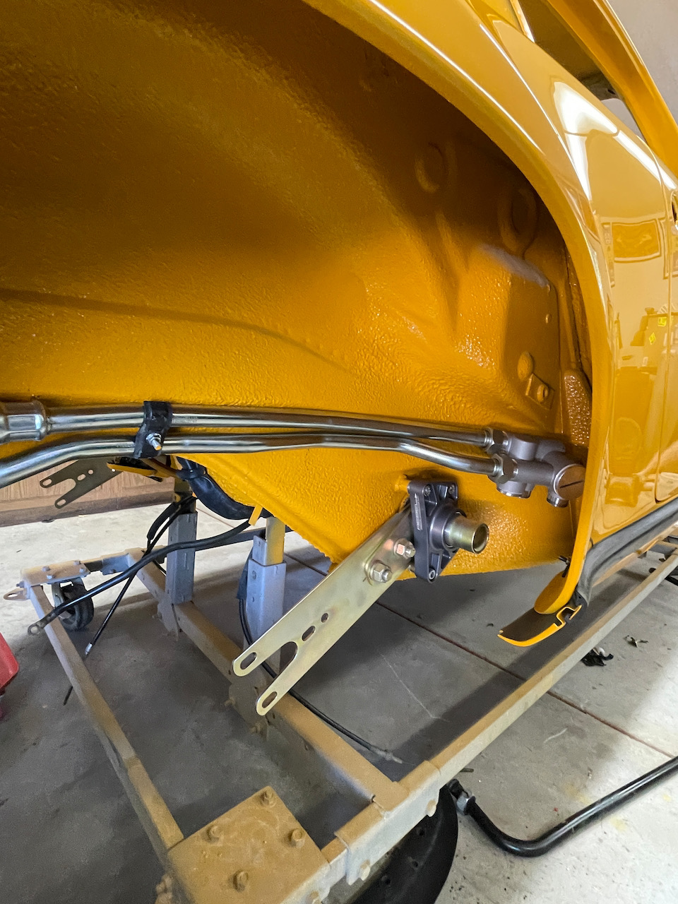

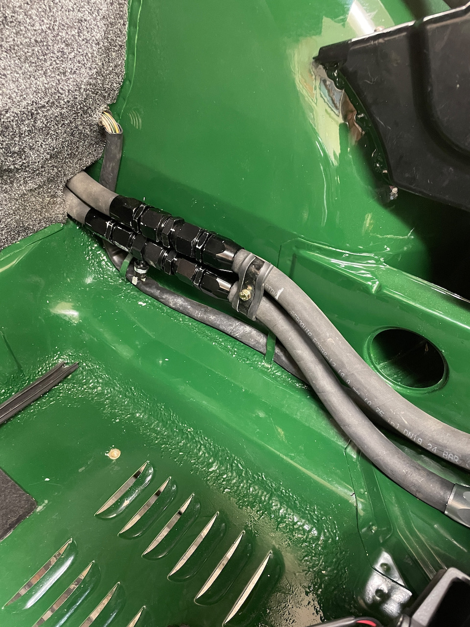

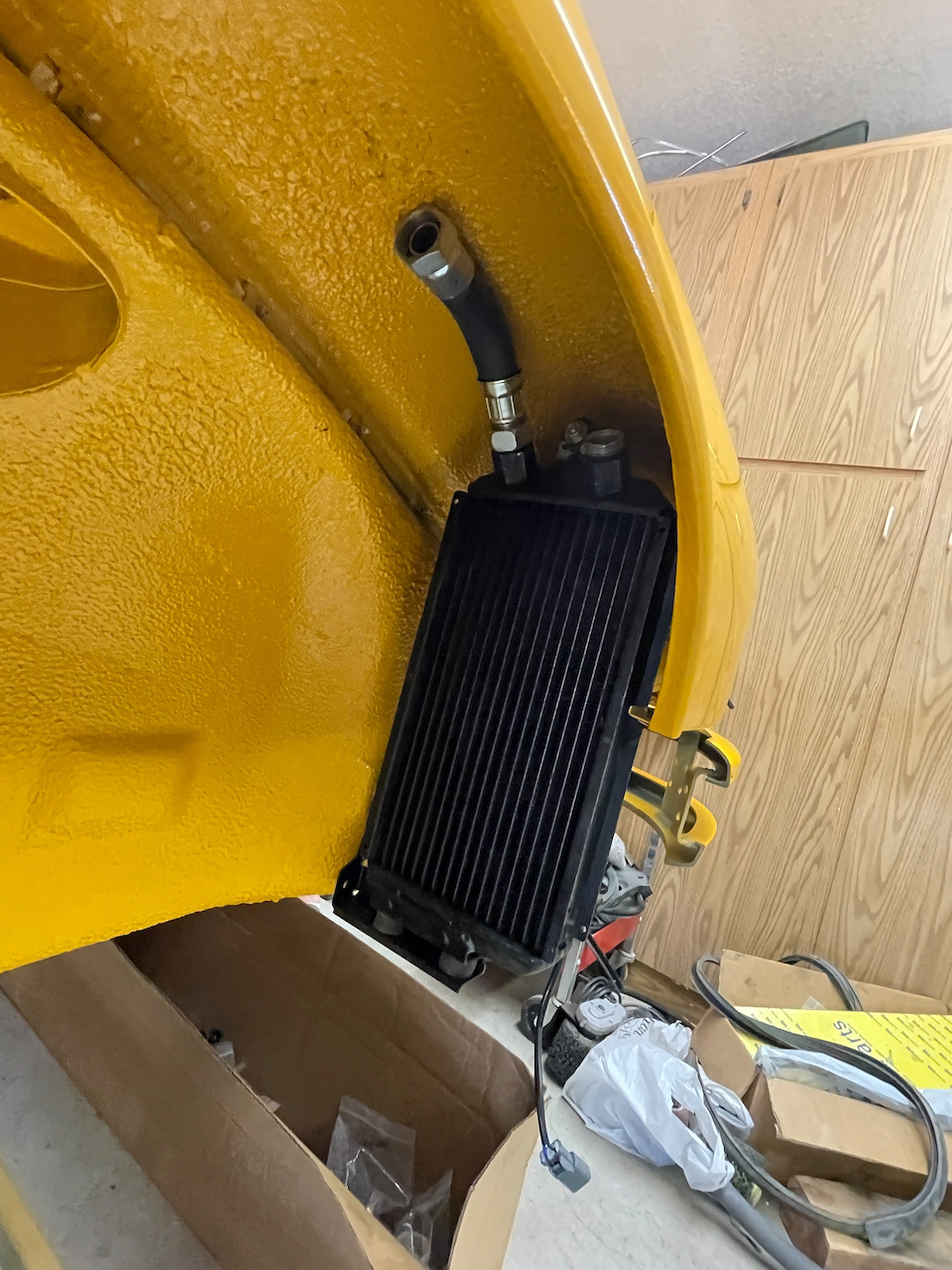

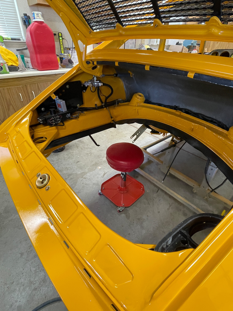

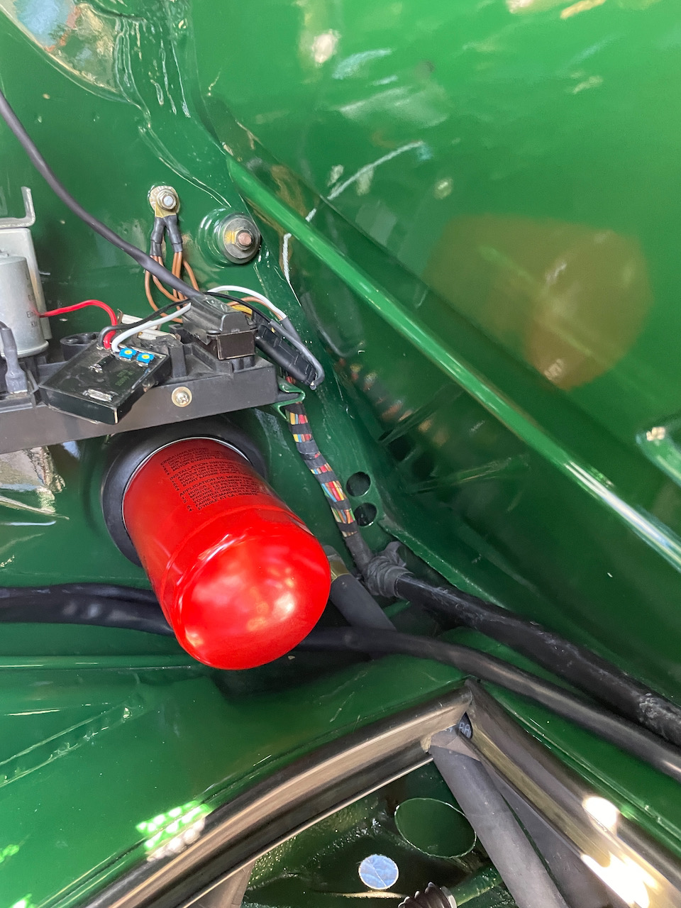

Then we installed the new electric thermostat for the oil cooler and secured the lines to the trunk wall with a riv-nut. Nice and tidy. This thermostat will turn the fans on/off automatically. We are also going to wire switch with an LED indicator to override that in the event I want to manually turn them on/off.

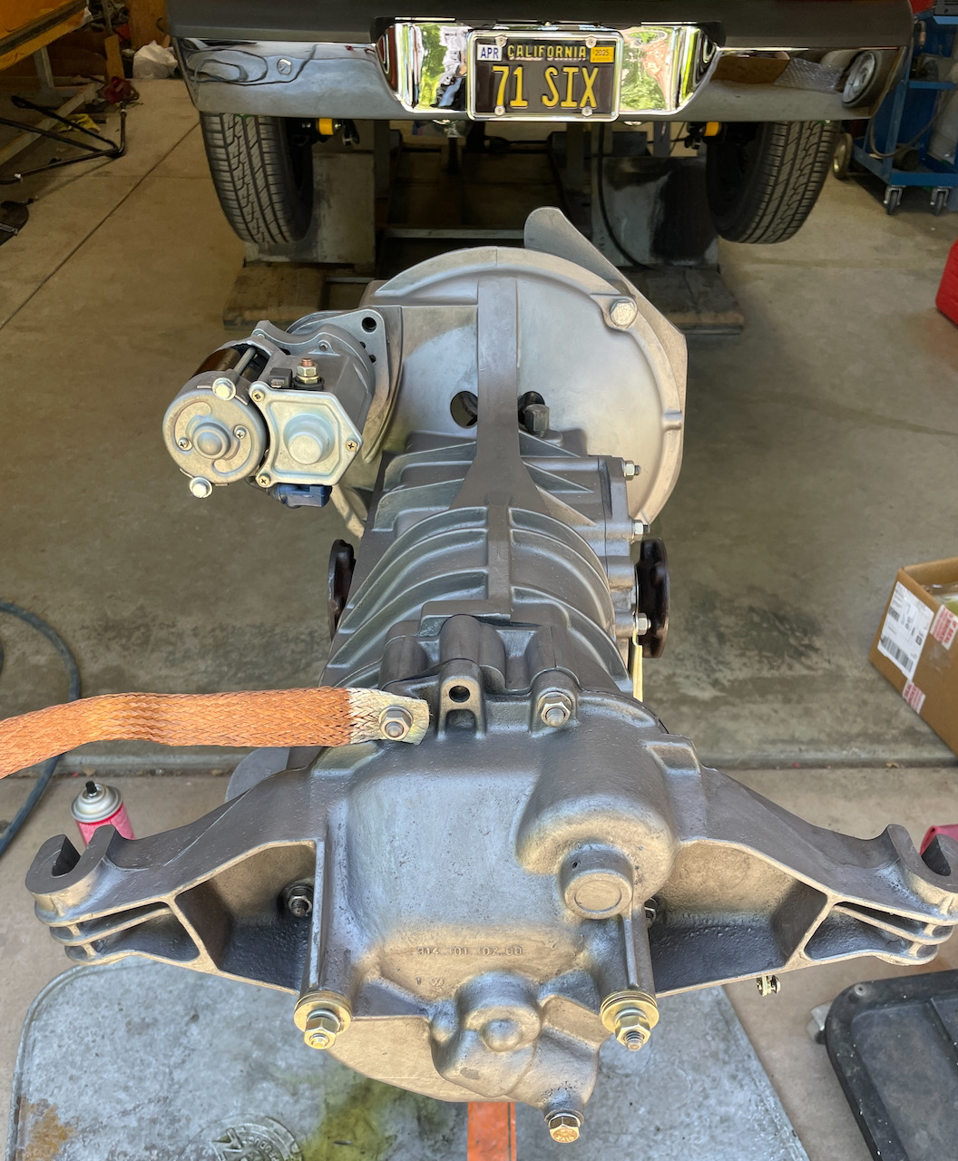

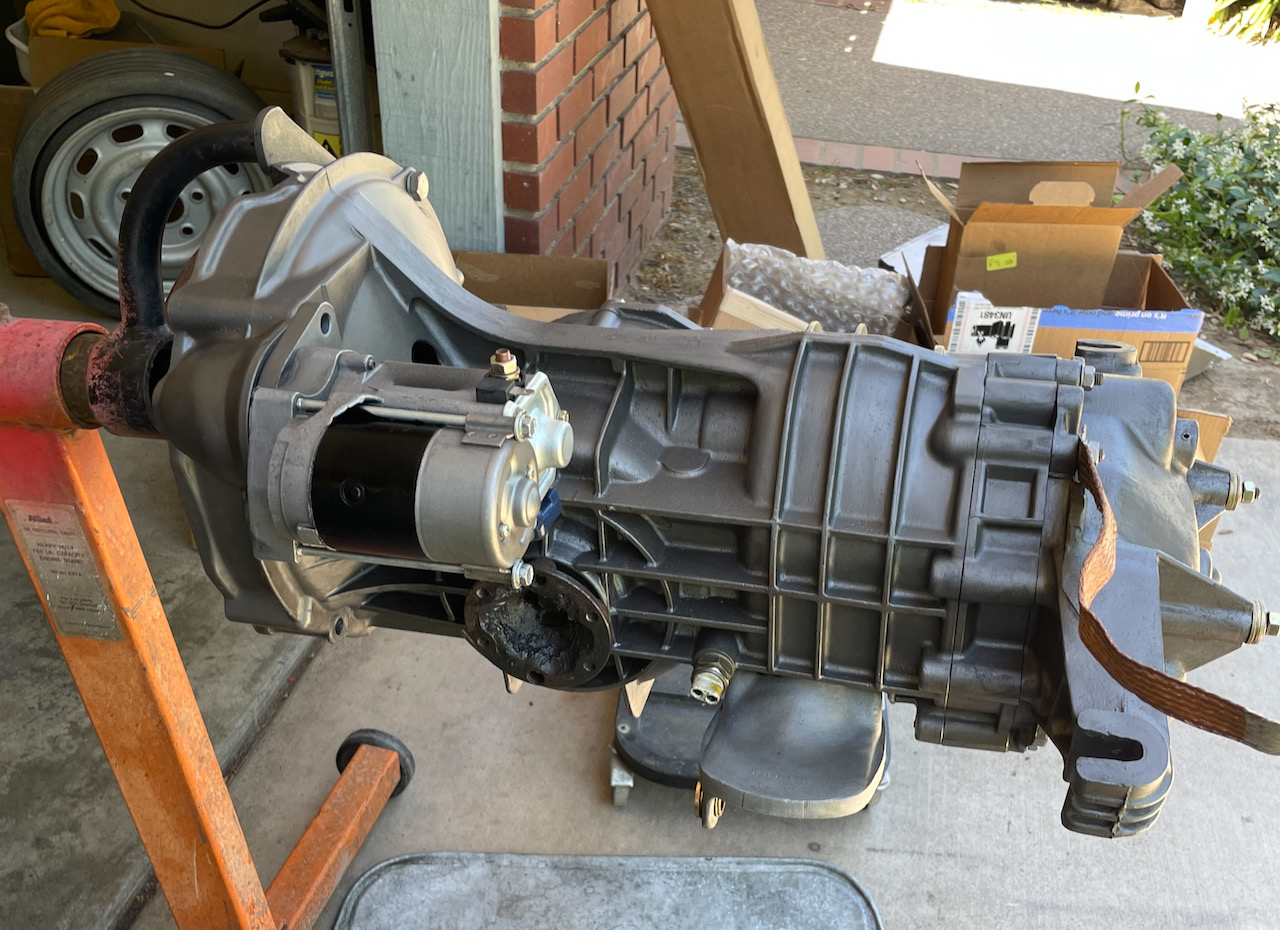

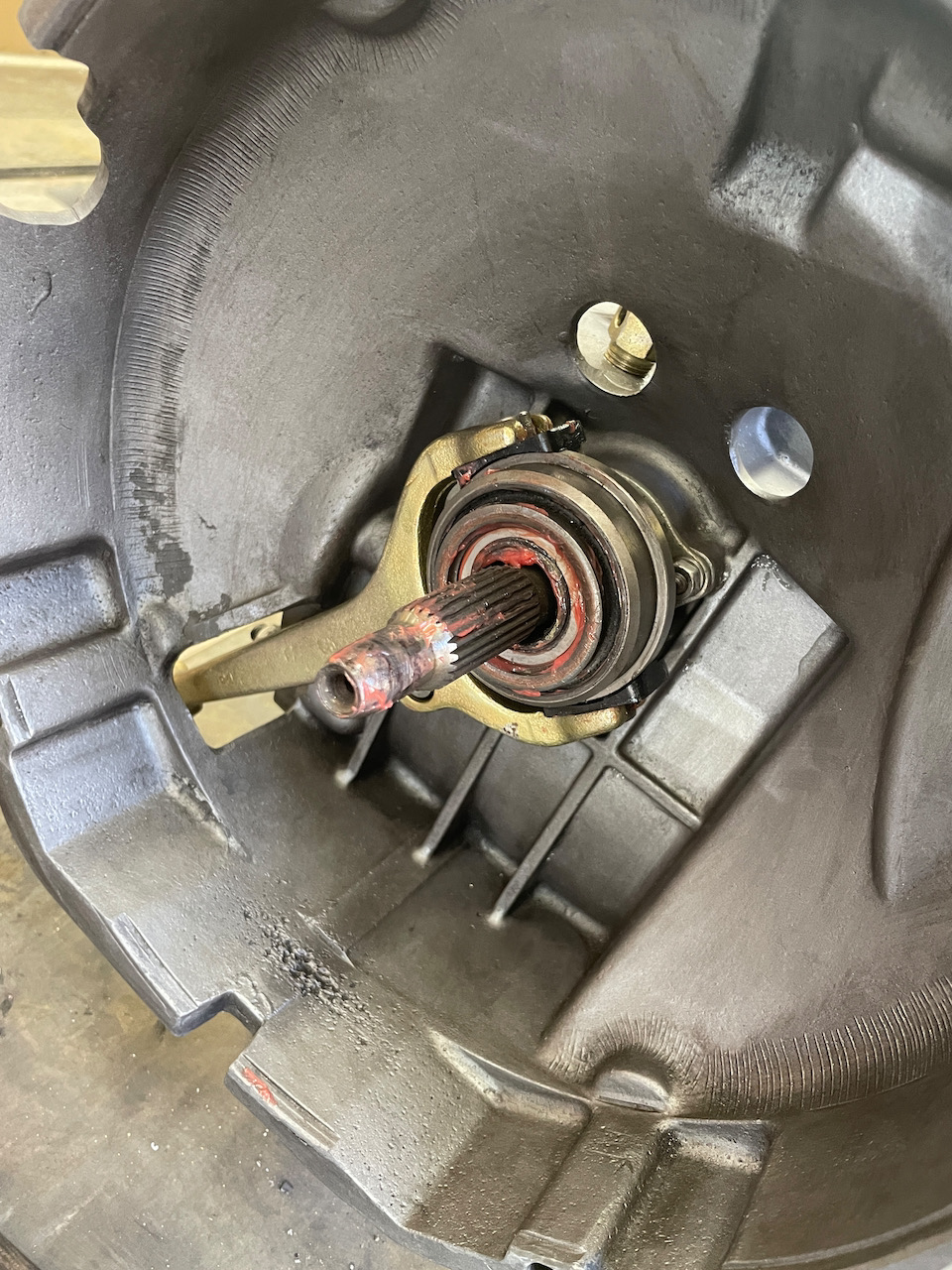

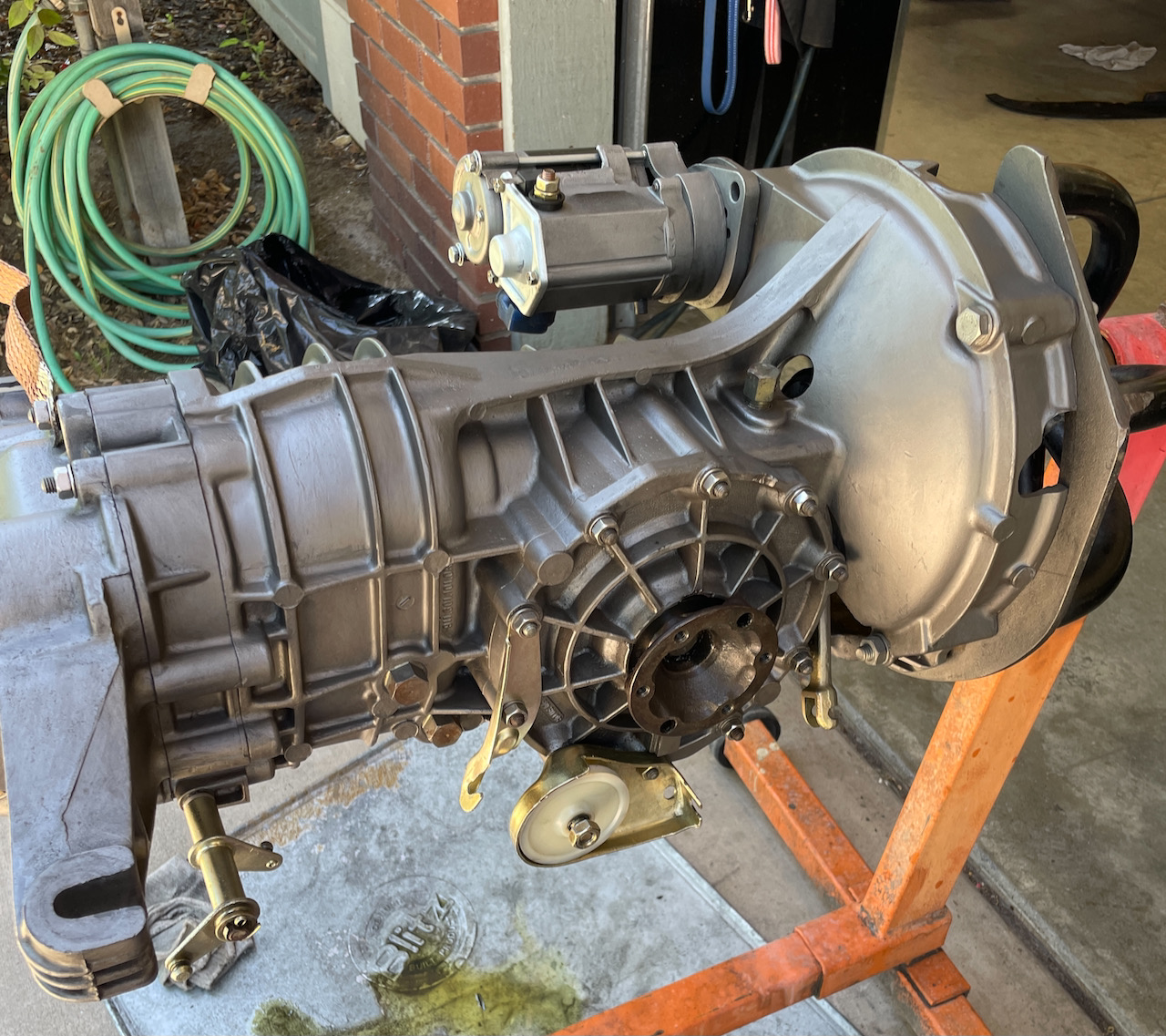

Then we pulled out the transaxle to address a output shaft seal leak that we had been unable to completely stop. We installed a speedi-sleeve (Stoddard) on the output shaft and then a new seal on the transaxle and reassembled. It feels like it should not leak again- fingers crossed. Then I cleaned up the transaxle so it will be ready to install once we get the crankshaft ignition sensor bracket that we realized we were missing. Order that from Gaudin and hope to have it by the weekend. The we can install that and then install the transaxle.

More:

Hi Andy, @Krieger - Thanks; it's a coating Mike Lesniak (Dr. Evil) applied when he rebuilt it back in approx. 2016. All we did was spray it with brake clean, lightly brush and blow it off. (IMG:style_emoticons/default/beerchug.gif)

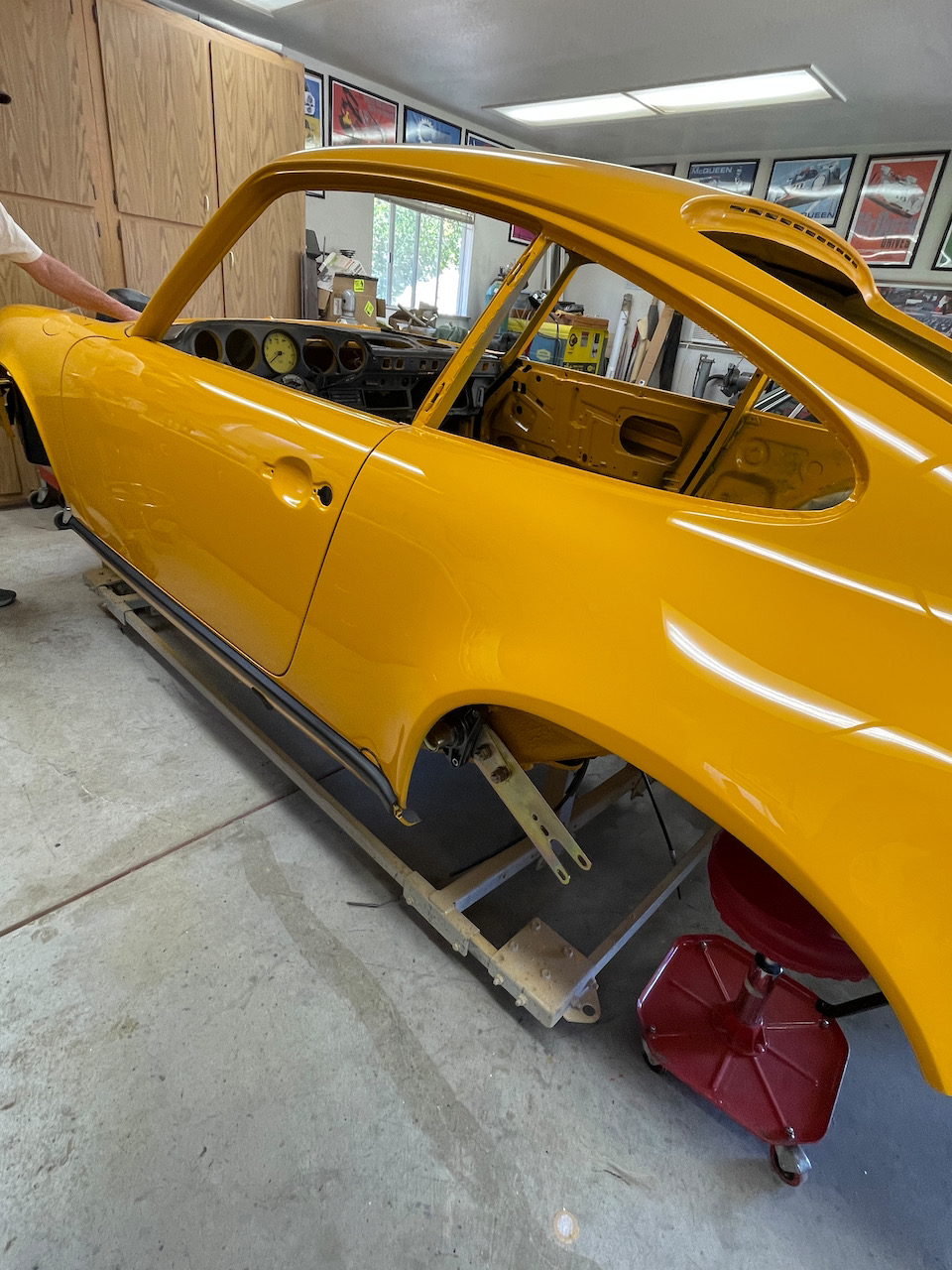

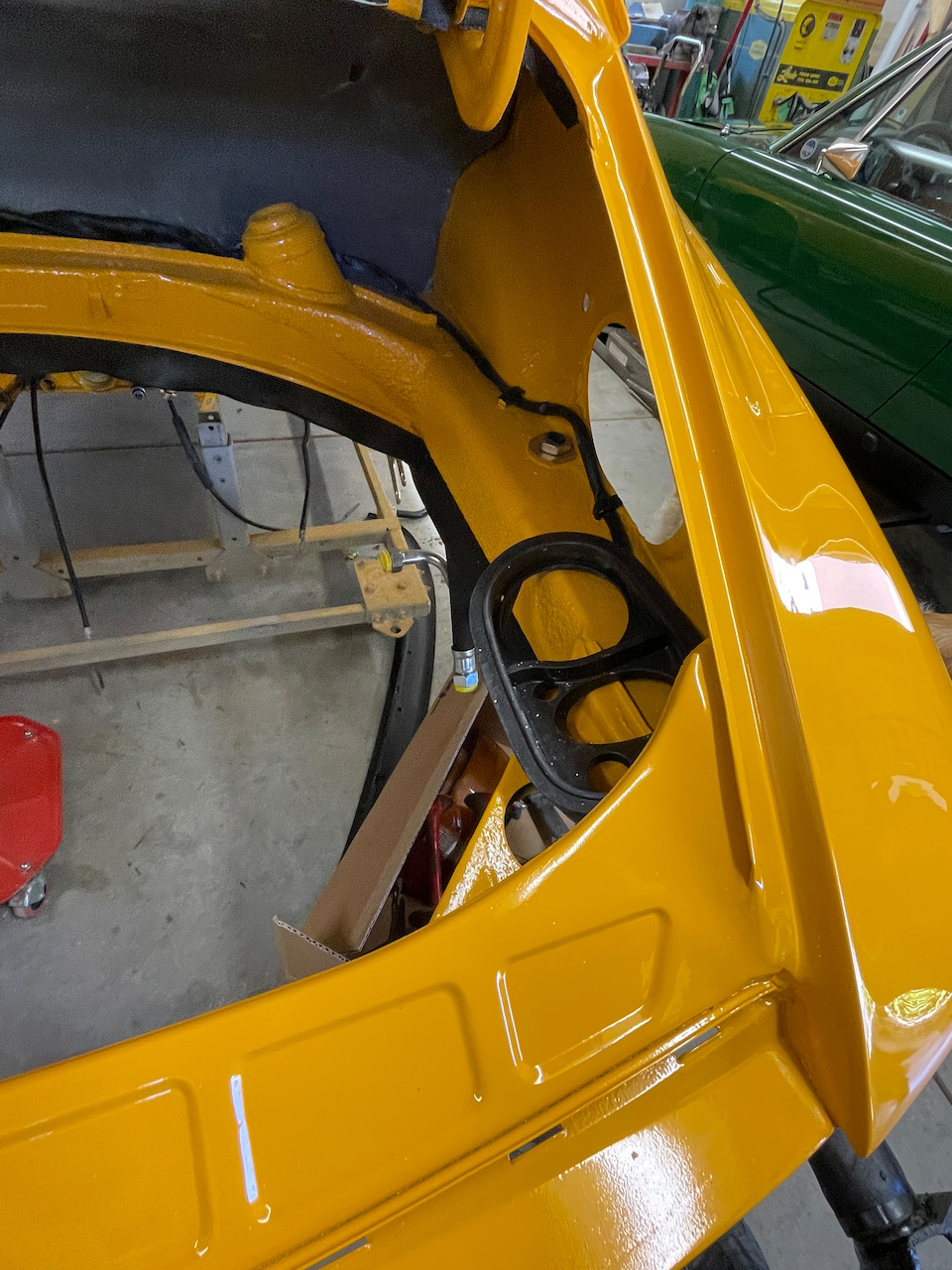

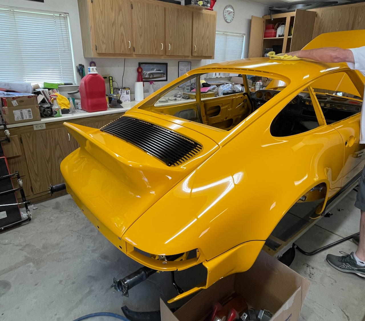

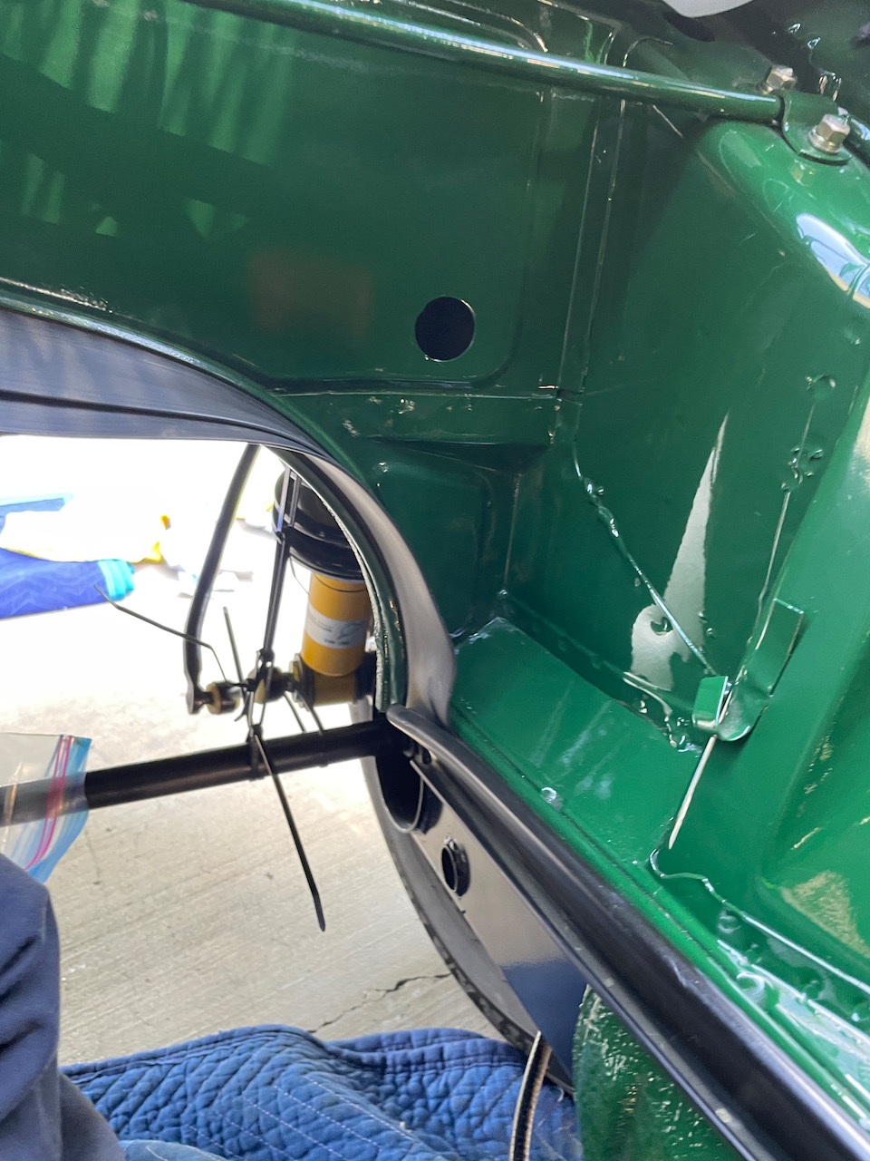

Got a couple hours in yesterday. We were able to get the front valance and bumper back on the car. Easy peasy, but for me it was a big step to getting her back on the road. I also spent some time cleaning the engine compartment. I wiped it down with brake clean. The next time we are at Greg's I will ask my brother to touch up a couple small scratches in the engine compartment and then follow that with a coat of wax.
This morning we are headed off to pick up my MAF meter.

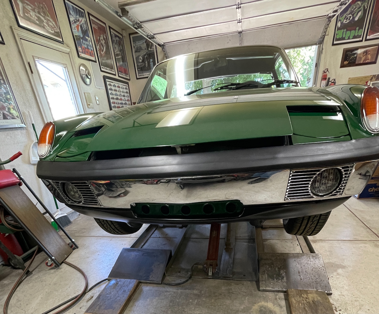

And just for a change of pace, here is what my car is sharing Greg's shop with. Pictures posted with Greg's permission.

Thanks for the pictures of the 911.
Closeups are every bit a gorgeous as I expected it would be.

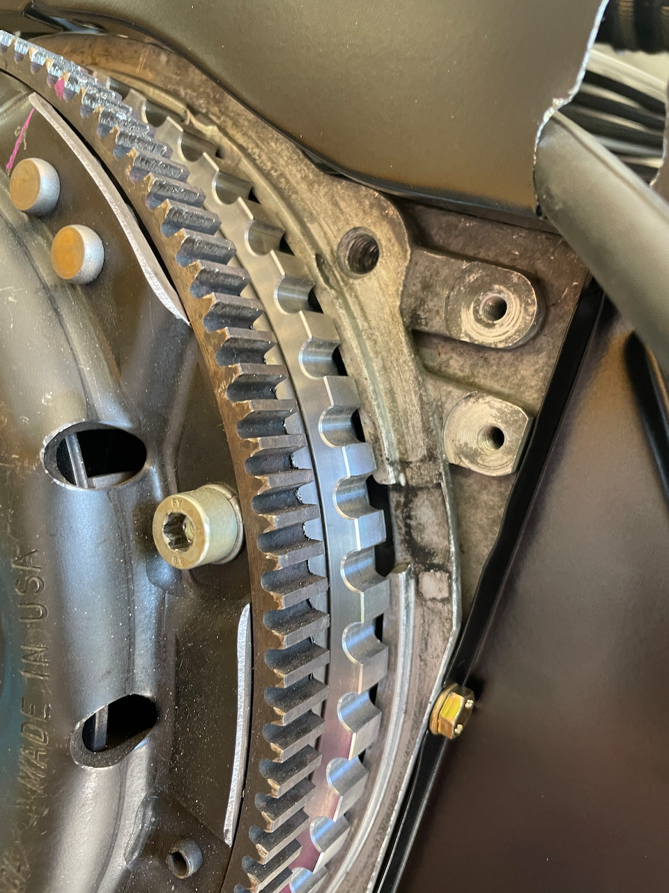

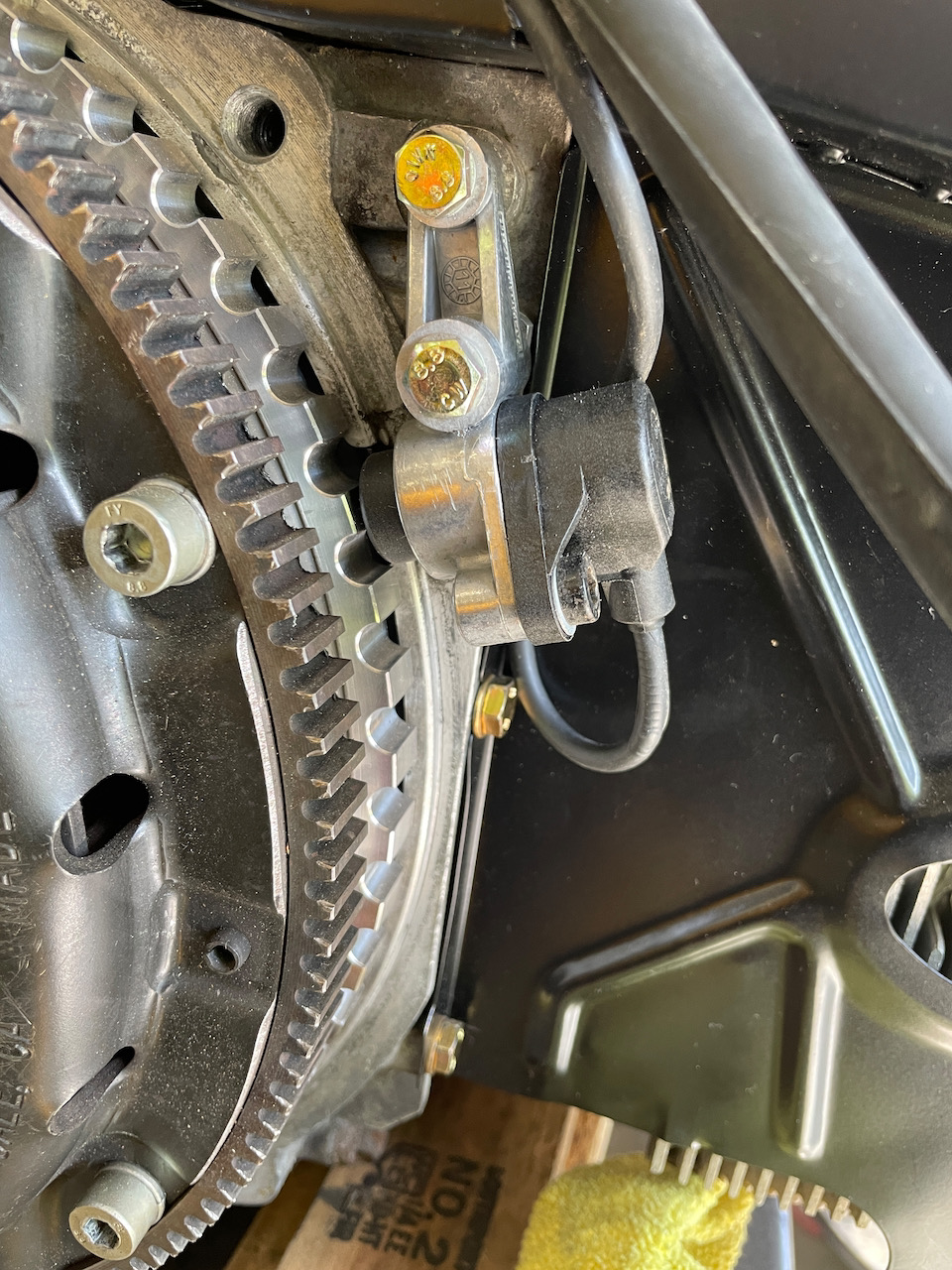

Greg installed the new crank position sensor with the new mounting bracket. Fits nice and looks proper too.

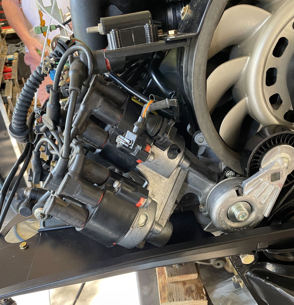

Then we installed the MAF sensor, it fits nicely, but I need to order a couple new clamps from RM European to wrap that up.

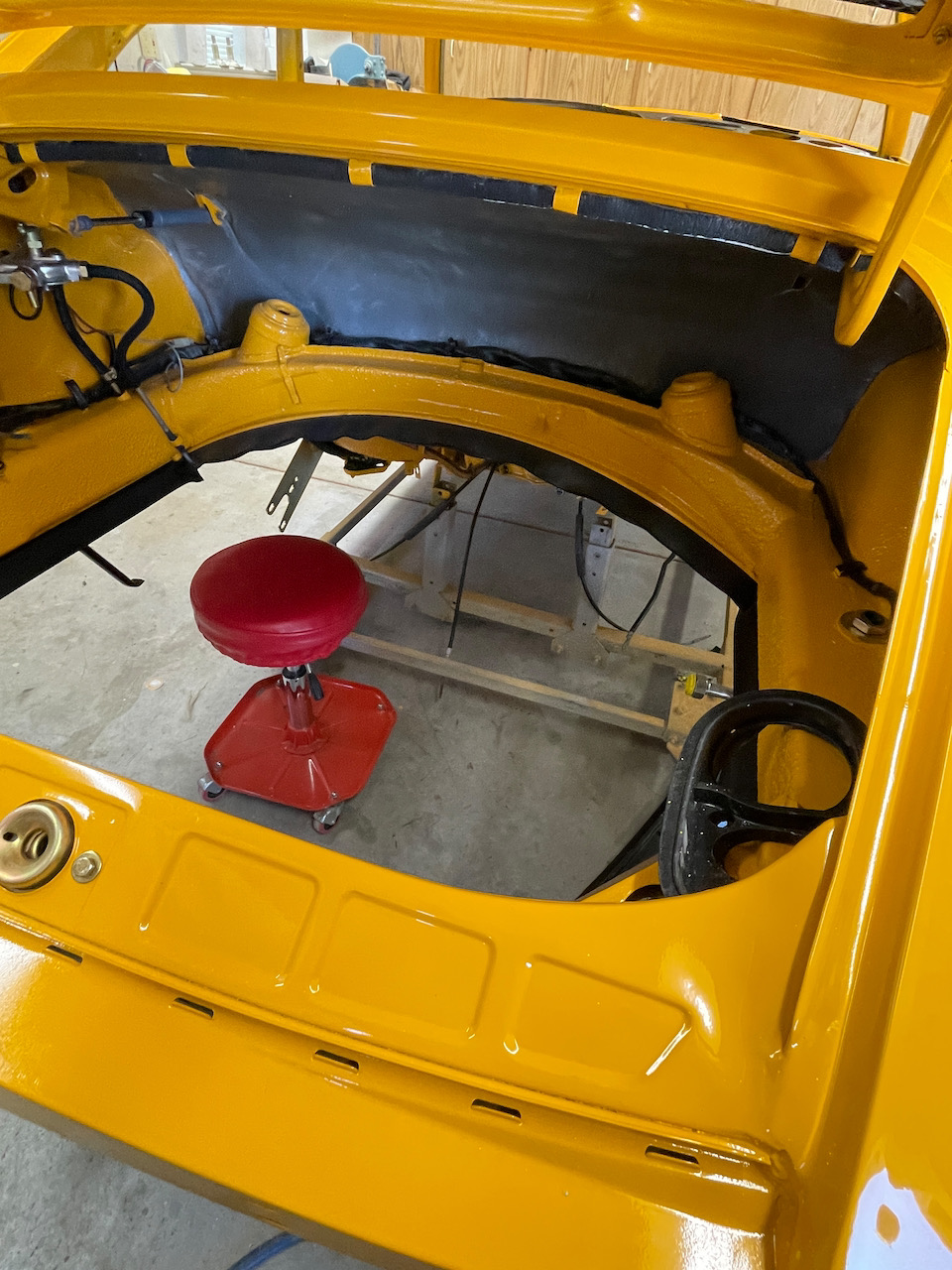

While Greg ran to the dentist I took the opportunity to clean the engine compartment for the eventual motor installation. It was not really bad, but it cleaned up nicely. Now, maybe in a couple weeks the motor will be in its new home.

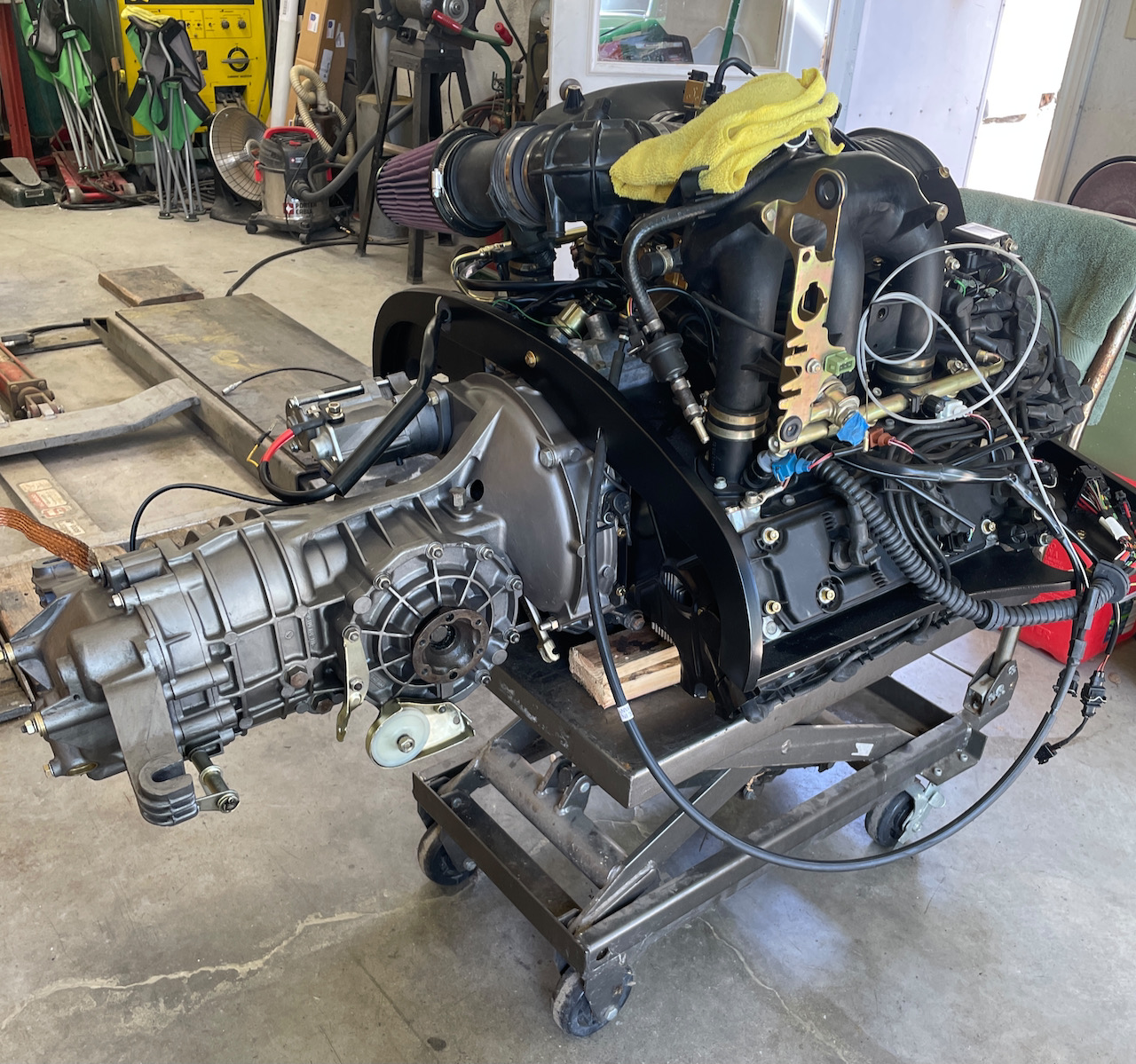

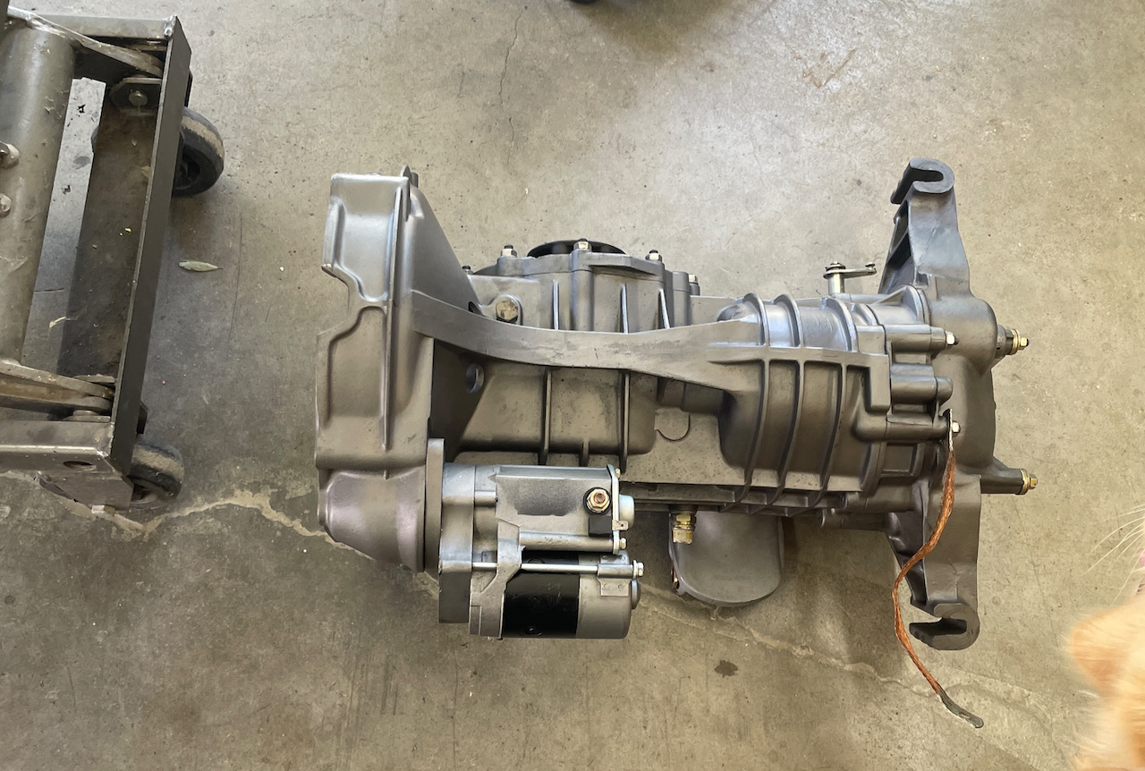

Then we put the transaxle back where it belongs - with the engine. We replaced the little plastic bits on the clutch fork arm, greased the throw out bearing and it all went together nicely. I was really pleased to see that happen as it means we really are getting close to getting them back in the car.

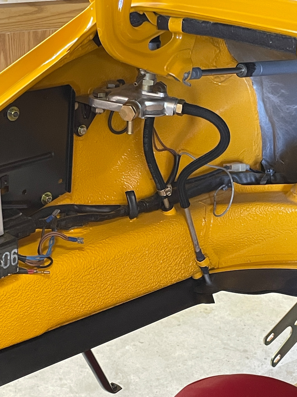

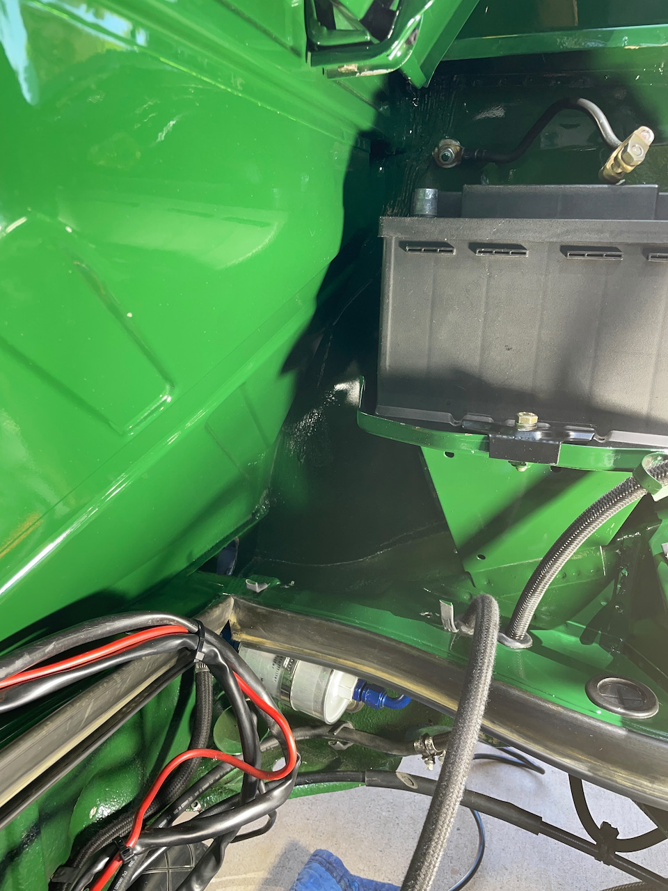

Next Greg tackled the wiring for my oil cooler fans. We previously installed the Setbrab in-line thermostat for the fans. I wanted the fans to operate automatically - let's face it I am old and don't want to forget having to turn them on when the oil gets hot. But, I also wanted a manual switch to turn them on too. So we repurposed my rear window defroster switch, (the rear defroster did not work anyway) for that function. Greg is a terrific electrician technician (of course) and made this look simple aside from the contortionist positions required to get up under the dash as he is 6'3".
Our next tasks will be to sort the engine vacuum lines and hopefully start getting the electrical for the engine figured out so we can get the DME mounted in the car and get the wiring from the dash to the engine done. We also still have to make the idle control valve pipe so we can mount that where we want instead of the stock 993 location.
