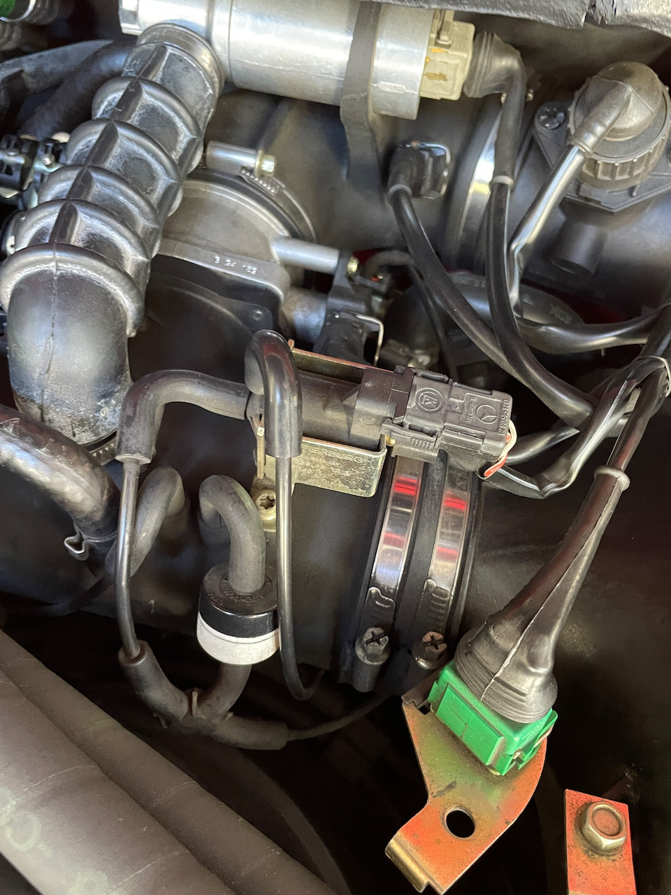

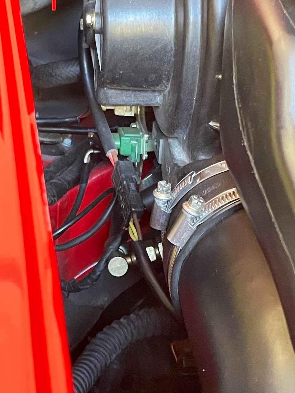

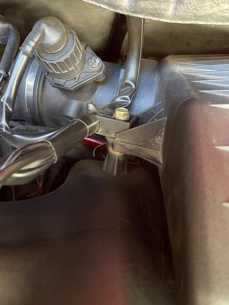

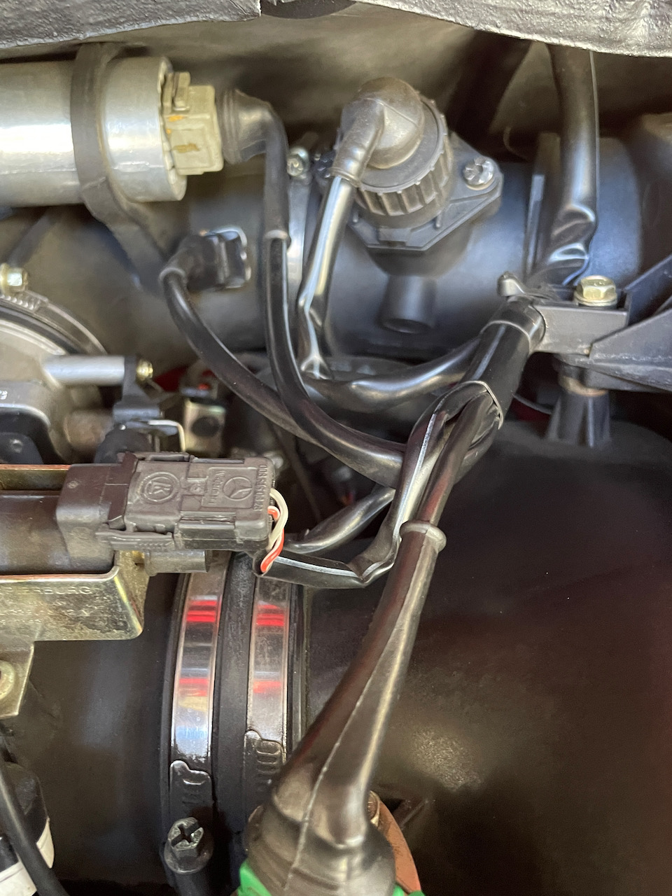

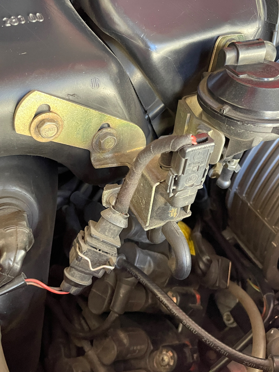

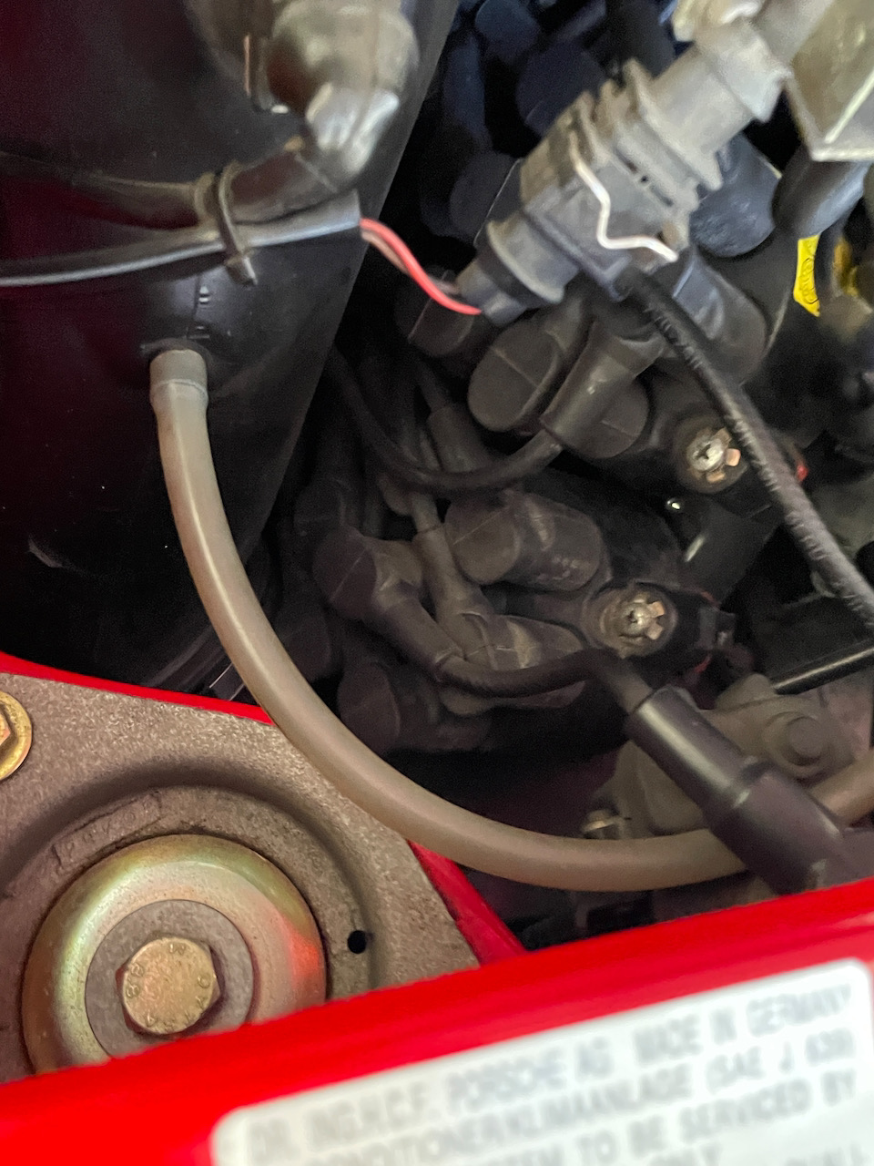

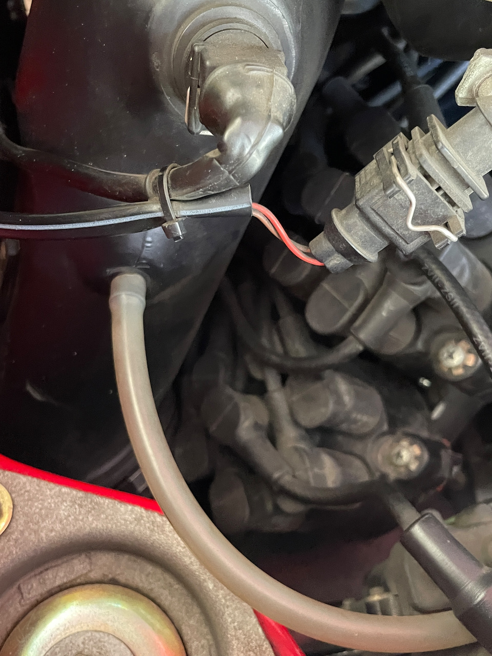

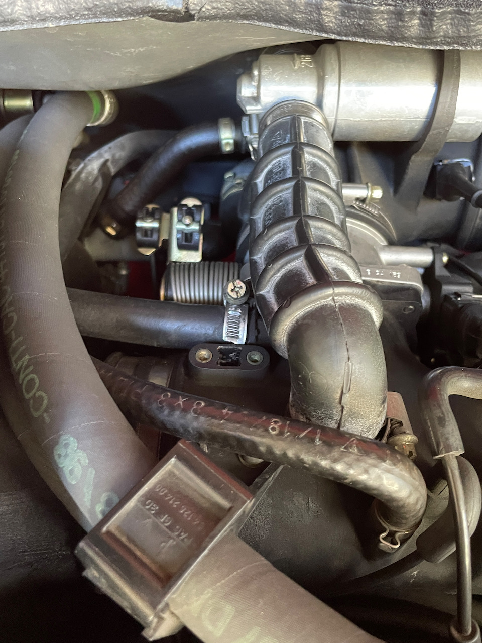

Yesterday, Greg, my brother and I went to the Diablo Region PCA Wash 'n Shine at the Danville Livery (Sycamore Valley Rd and San Ramon Valley Blvd). It was a terrific day with perfect weather. There were a whole lot of Porsches in attendance. Amazingly, only 2 993 cars attended, a '98 and a '96. We needed a '95 OBD 1 car.
Fortunately, Alex had reached out to me and said he had a '95 993 and lived in San Ramon. He was only 7 miles from the car show. Greg and I drove to his home and saw his absolutely stunning and pristine 993 Coupe with about 60K miles on it. We were able to take photos and look at harness routing. That will certainly help us get one step closer to getting the engine installed. Thank you very much Alex.
Here are some pictures:

I am guessing we don't need the heater fan blower sensor or the charcoal canister valve assembly? @sirandy where did you plumb the charcoal canister connections? Normally one goes to the shroud and one goes to the air cleaner. On the 993 it goes through a valve assembly that connects to the intake manifold.
ClayPerrine
post May 28 2024, 10:31 AM
Post #260
Posts: 16,568
Joined: 11-September 03
From: Hurst, TX.
Member No.: 1,143
QUOTE(Steve @ May 28 2024, 09:01 AM) *
You are going to need the charcoal canister solenoid to keep the DME from setting codes. And you can plumb that back into the 914 charcoal canister system.
The 914 charcoal canister system is a blow through system. The 993 charcoal canister is a suck through system. You hook the line for the charcoal canister that originally hooked to the fan shroud and hook it to the air cleaner Hook the other line to the 993 charcoal canster valve that connects to the intake.
