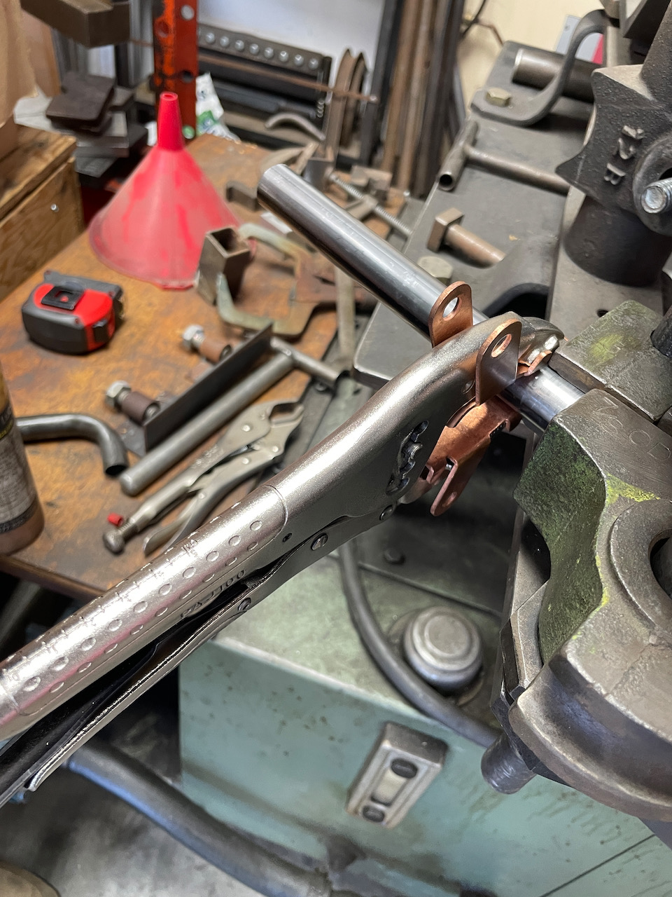

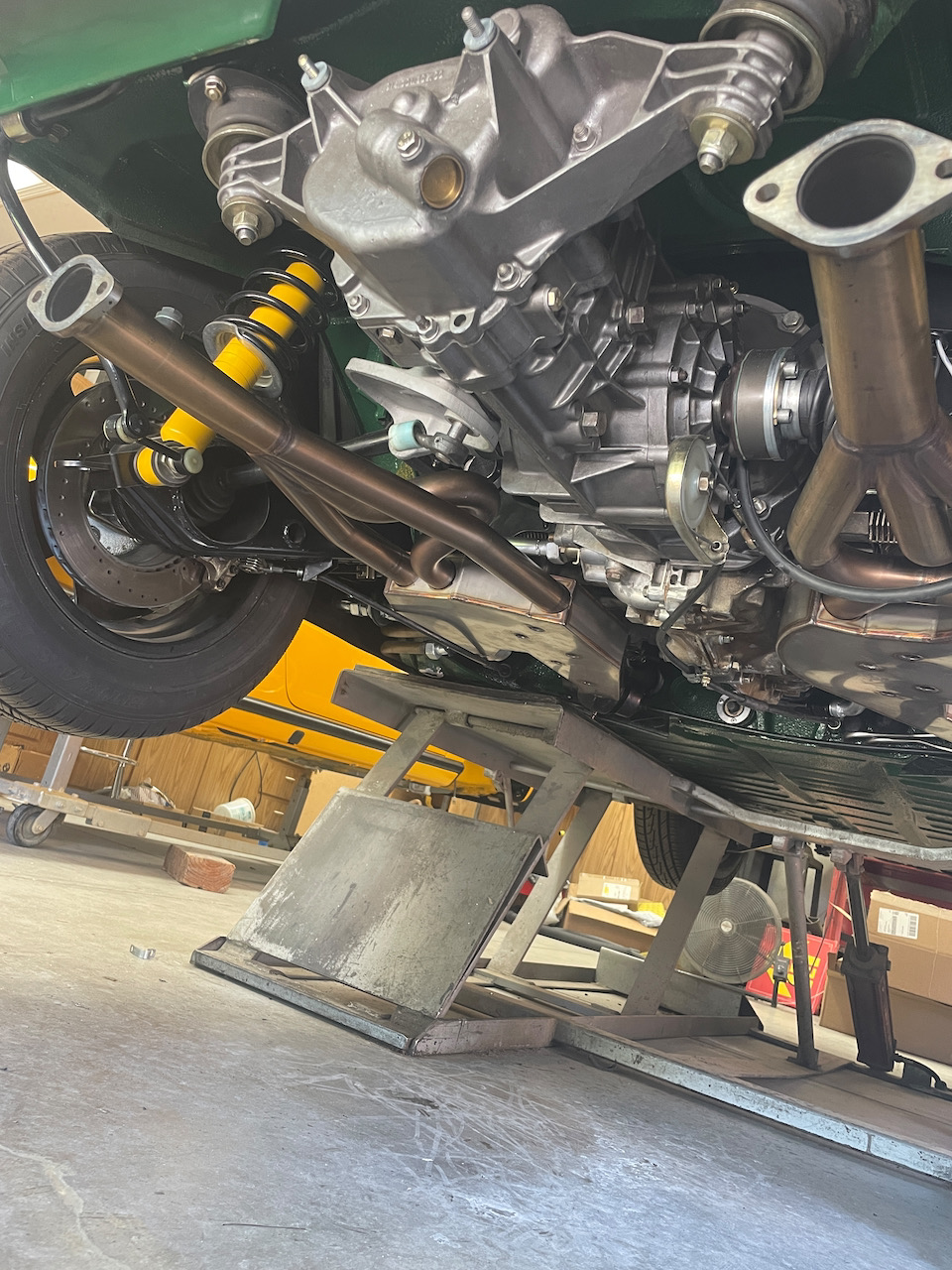

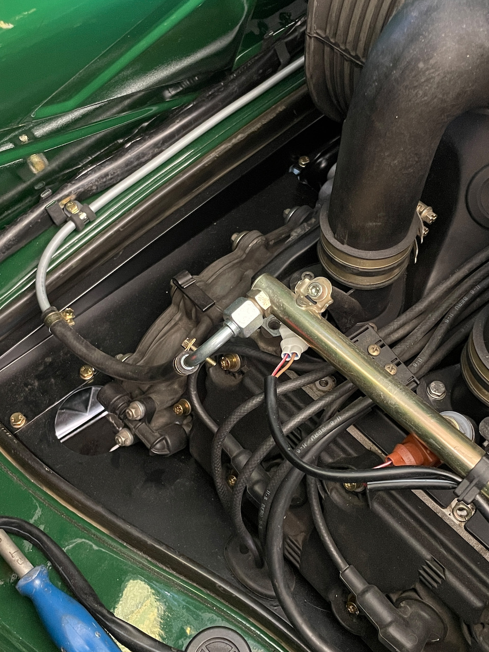

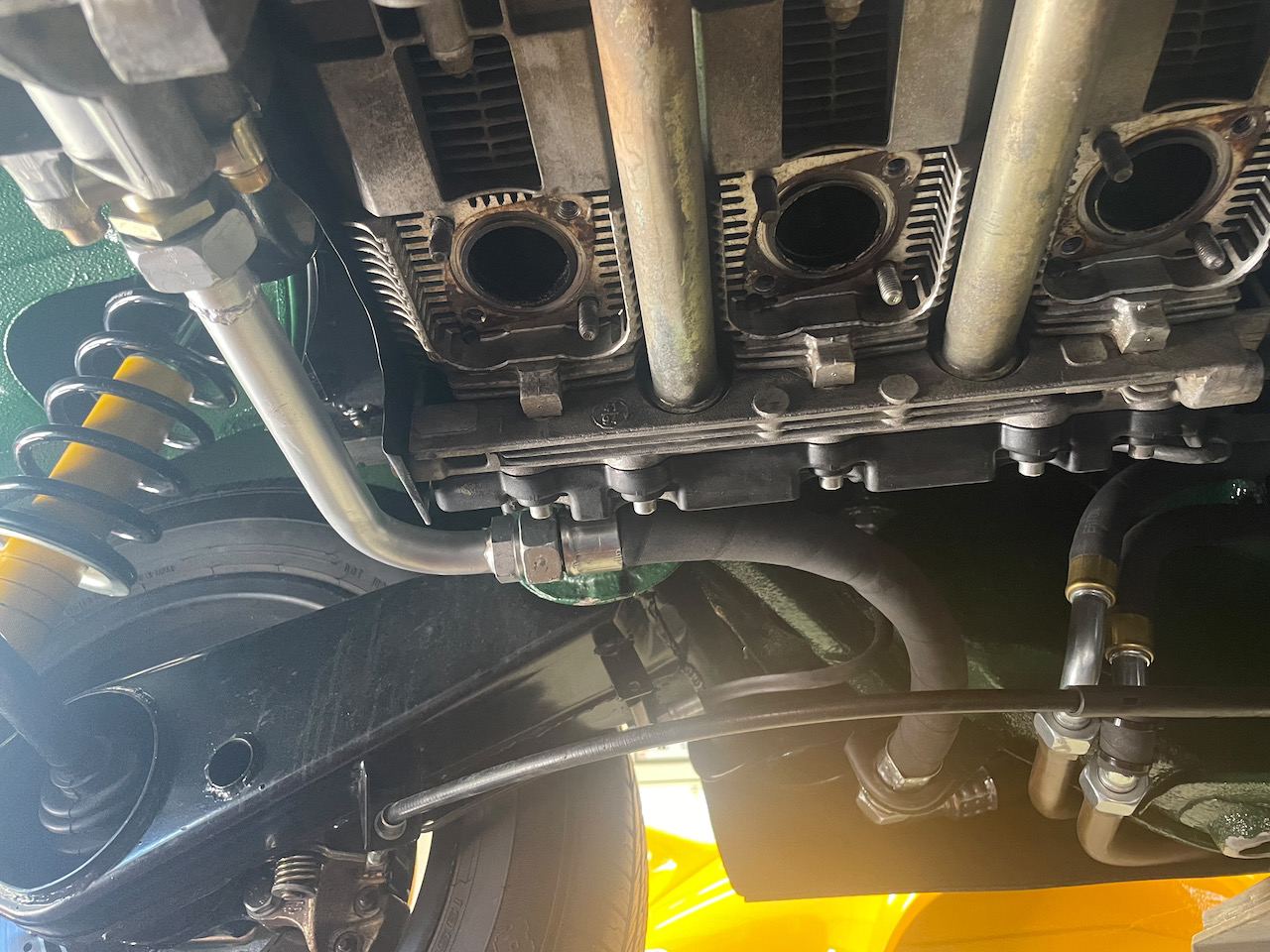

Making decent progress. Greg has the fuel lines all completed except for the line from the fuel filter. We had to order a new fitting for that.

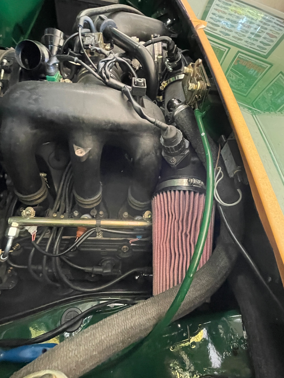

Greg got the complete intake system finished and it fits really nicely right where we wanted it.
Then we got the passenger side heat exchanger installed along with the clutch cable connected. We are waiting on the one oil line that goes from the oil tank to the engine. Tomorrow my brother and I will take a ride to The Red Barn where Chris is going to bend me some pipe for that.

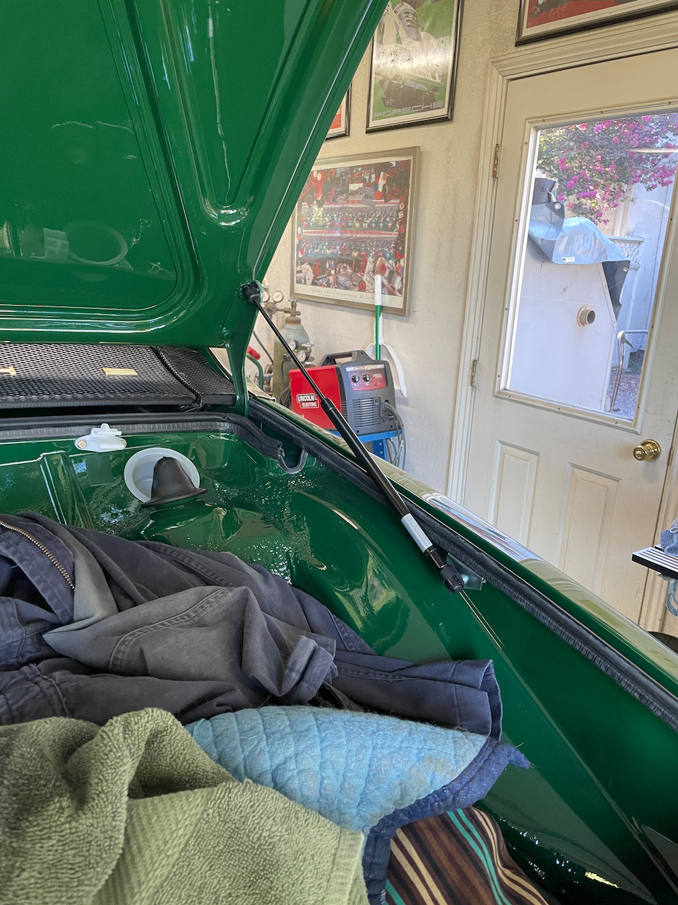

Then we got the new rear trunk "shocks" installed. Thanks to Craig at Camp914 for those beauties. They work like a charm and look quite nice too.

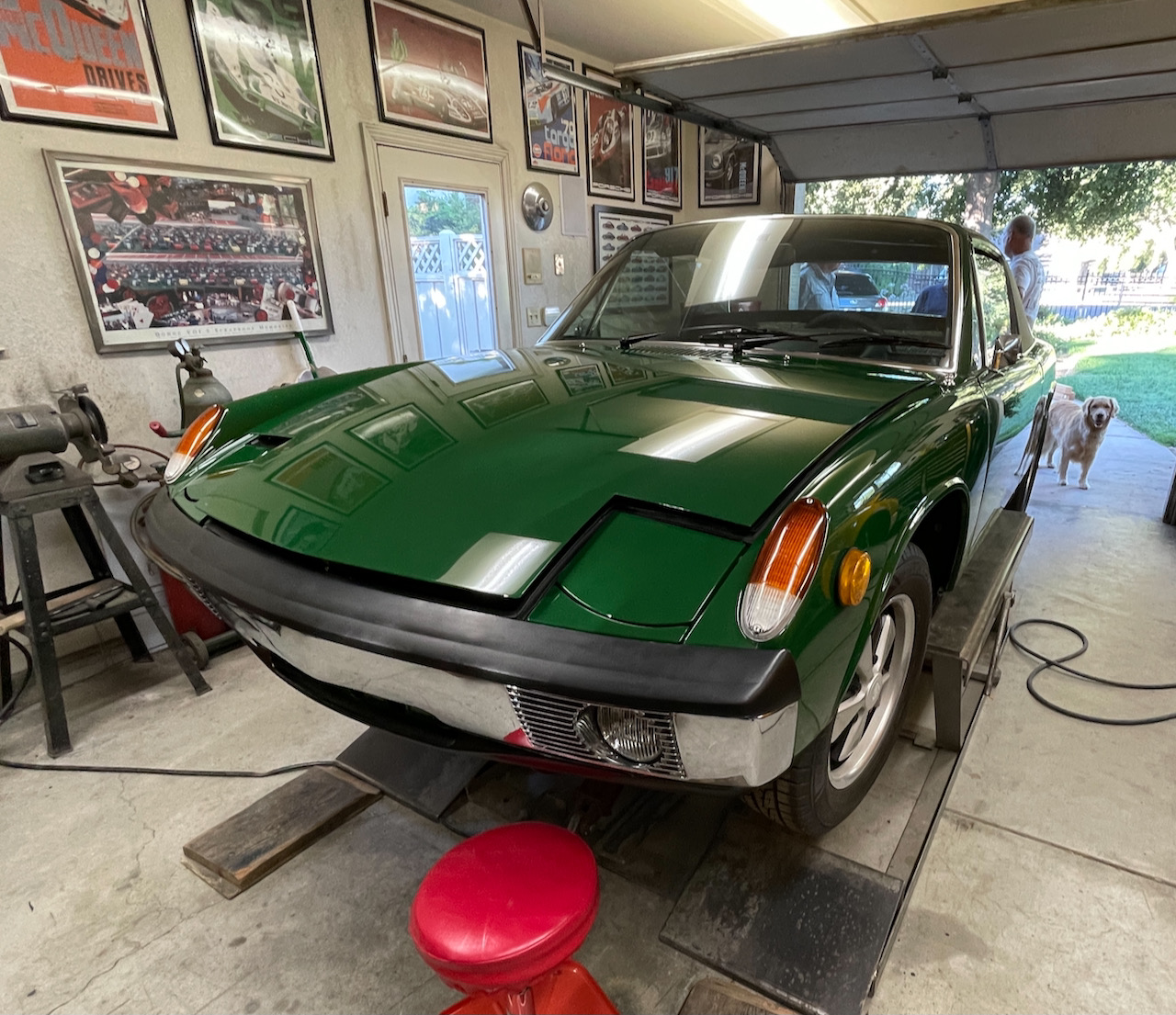

Couple gratuitous '74 911 shots and my car sitting and waiting until our next day. That 911 is just amazing; the color is off the hook! Greg knows what he is doing and that is for sure. (IMG:style_emoticons/default/first.gif)

I'd hate to see that engine get ruined by the K&N filter - just say'n
https://bobistheoilguy.com/forums/threads/k...-or-bad.164018/
technicalninja
post Jun 27 2024, 09:11 PM
Post #323
Posts: 2,531
Joined: 31-January 23
From: Granbury Texas
Member No.: 27,135
QUOTE(live free & drive @ Jun 27 2024, 06:08 PM) *
All that will do is possibly require the MAF to be cleaned more often.
He's NOT over oiled and I believe there is NOTHING paper based that could fit there.
Now, I personally prefer large surface area paper-based filters, but that car does not have room for one. I want my filter box to have a high-pressure cold air intake as well.
The 914 is LOUSY for high pressure cold air back there.
Really needs a snorkel that extends above the roof line and that would look like ASS...
He's not going to be off roading that car so the level of silica between paper and cotton gauze will be very hard to measure.
That MAF looks stupid simple to clean as well.
@Cairo94507 The foam "pre-covers" do help enough on particulates to be worth installing. Might look into one.
And, if you're not automatically cleaning that MAF every couple of years regardless of air filter type you should be BITCH-SLAPPED! (IMG:style_emoticons/default/chair.gif)
Having a properly oiled K&N is far, far better than nothing at all...

Pre filter is a must. K&N filters are actually very poor at filtering. We did testing some 20 years ago at a company I worked at that showed more wear than its paper counterparts

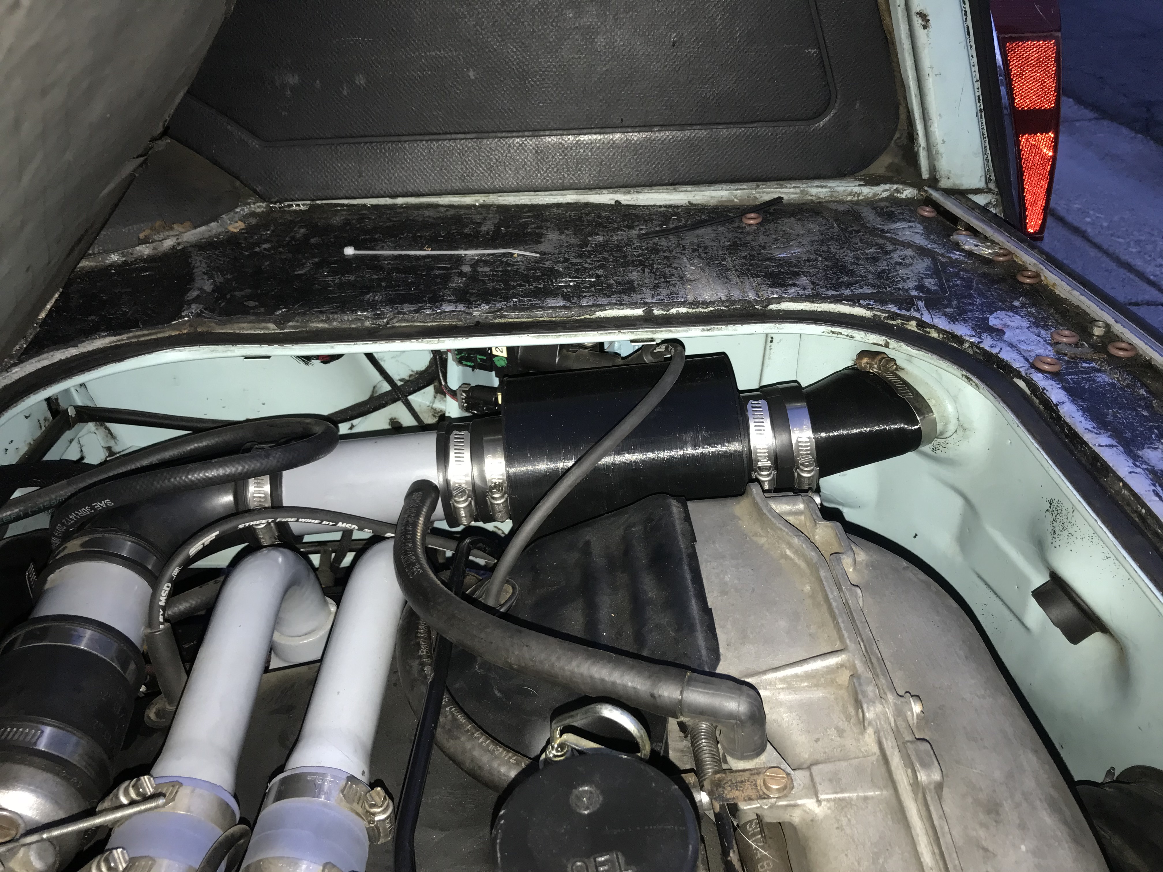

When/if you get around to the intake upgrades we have a printer here at our shop that will run CF/Nylon.
Does it really need to be good to 200F though? You're not pulling 200F air into the motor?
My Squareback has a CF/Nylon oil filler to fit under the decklid, but the air filter plumbing is PVC with a PLA filter housing. (That's the cheap plastic that everyone and their aunt uses)

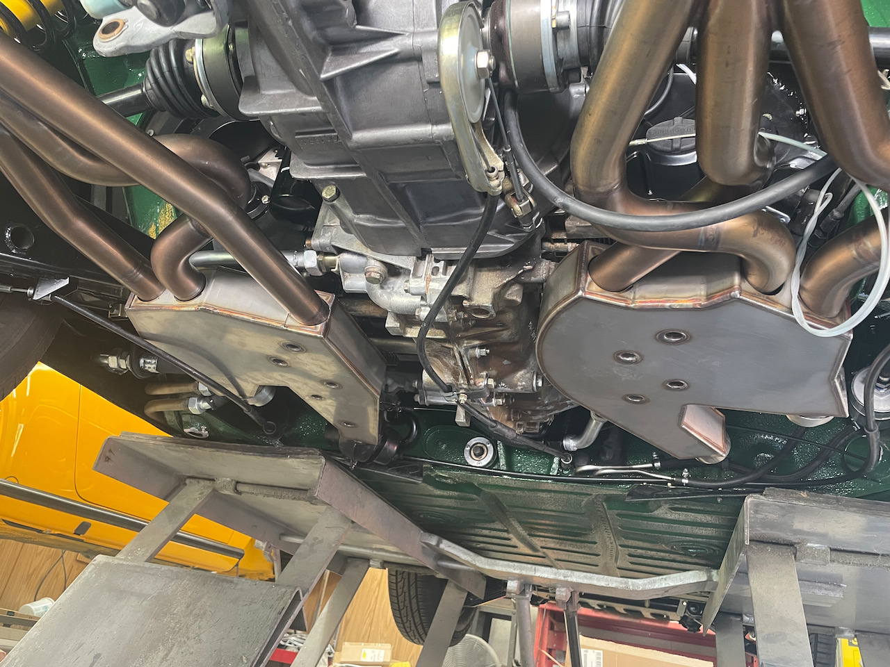

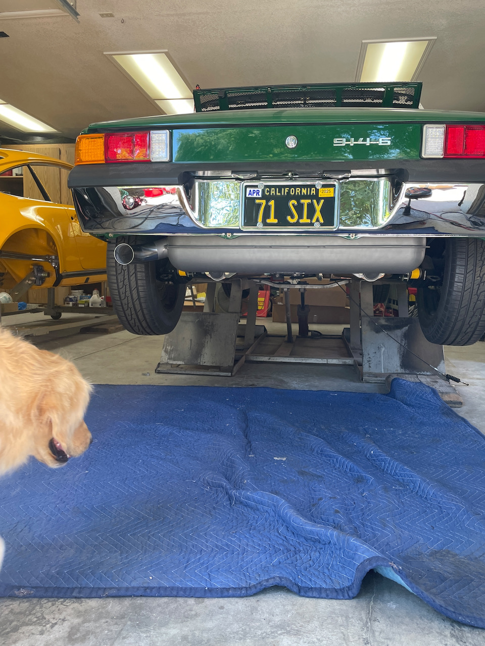

Had a productive day today. Fuel system is done. Oil lines are done. Throttle cable connected and working fine. Driver's heat exchanger on along with muffler. When it hit 95 degrees in the garage we stopped.
