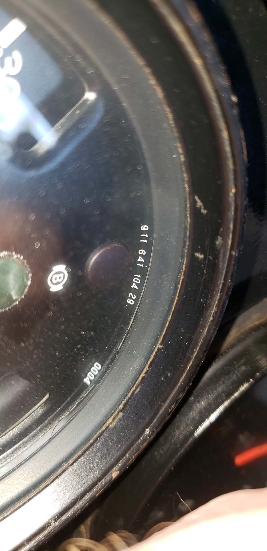

The stock 3.6 sender is 0-5 Bar (0-72 PSI). Your gauge is 0-80 PSI. I don't know if its worth the hassle of changing the pressure gauge or sender. I would just change the temp sender to match your temp gauge. Temp accuracy is more important.
I have a matching gauge/sender pair. In fact, i bought the gauge i liked first and then bought the matching sender for it.
@Steve
It's a 0-10 bar dual sender with an adapter to fit in place of the stock 0-5 bar sender.
And the gauge is a 911.641.104.29 which is a 0-10 bar/0-140 psi pressure gauge.

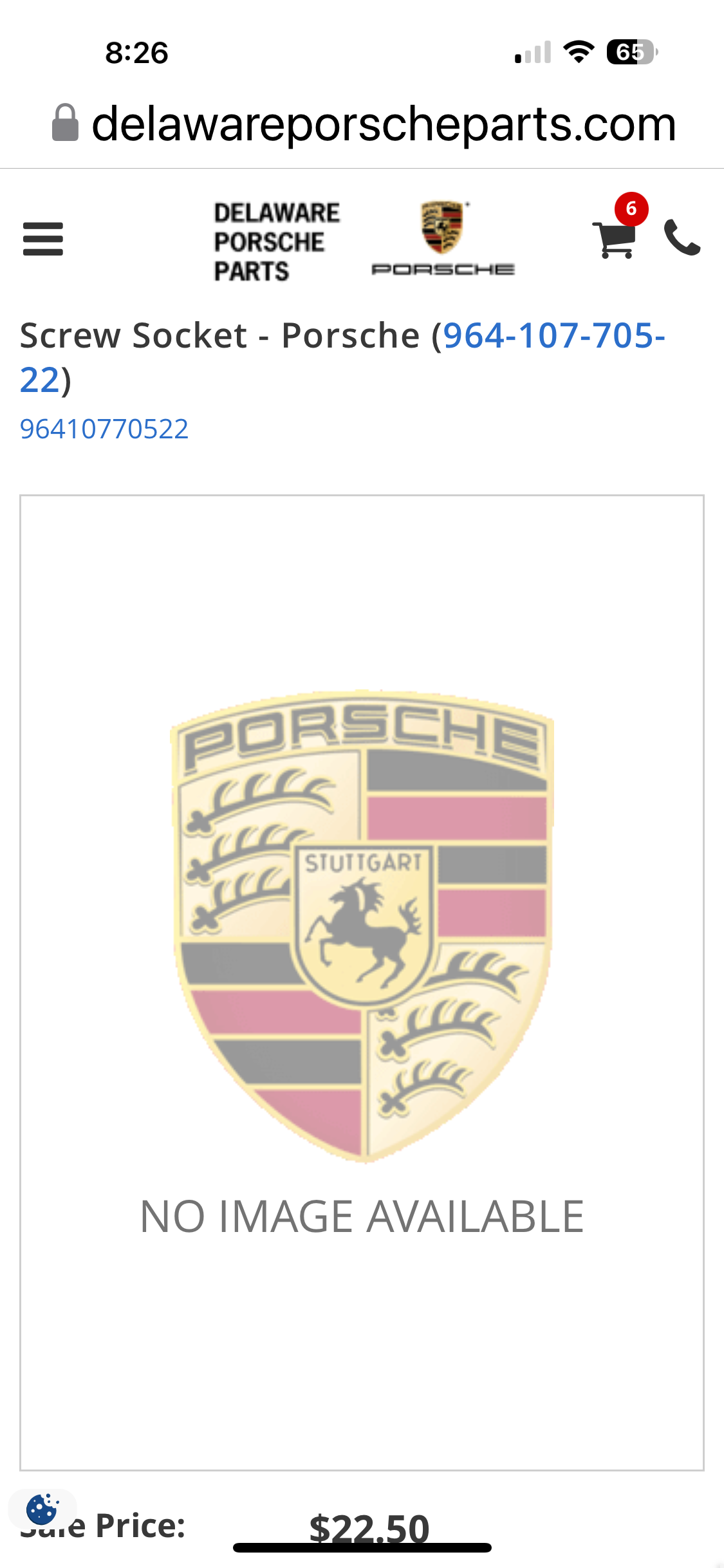

@ClayPerrine - I checked with Porsche and that adapter, (96410770522) is out of stock everywhere. Any other possible sources? (IMG:style_emoticons/default/beerchug.gif)
I would call these guys. They usually come through for me.

@mepstein - Thanks Mark - Ordered it and it should be here within 2 weeks. (IMG:style_emoticons/default/smilie_pokal.gif)

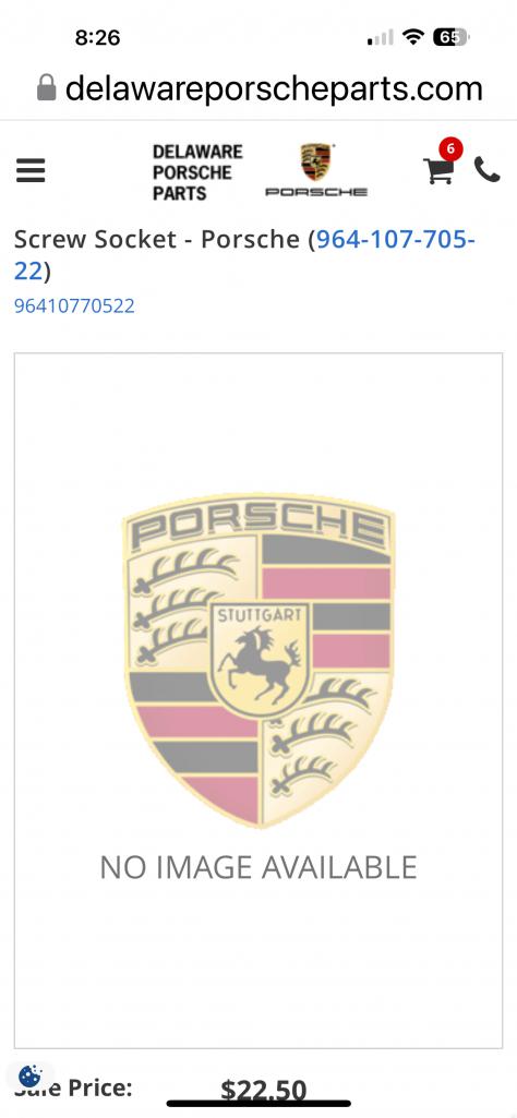

Ehhh....part on backorder and they cancelled it as no ETA available. Guess we will buy a plug and then tap it to accept the sender. I have emailed Palo Alto Speedo to see what they have to say about a solution. (IMG:style_emoticons/default/beerchug.gif)

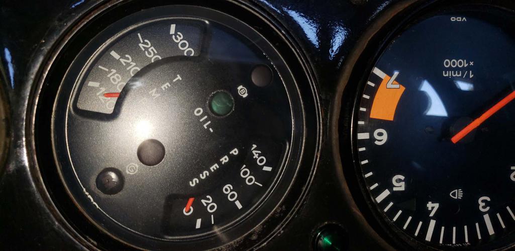

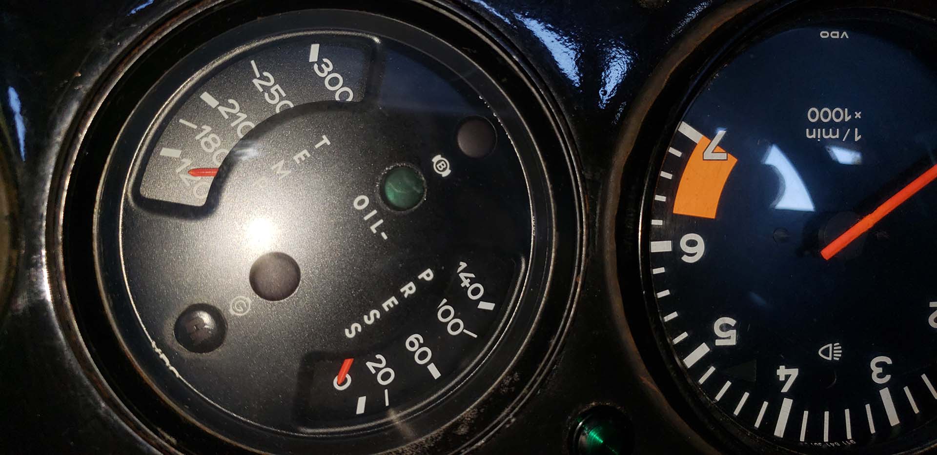

Looks like my path forward may be to swap in a 0-10 bar dual sender to address the pressure gauge and warning light and then send my tach/oil pressure combo gauge to Hartmut at Palo Alto Speedo to swap in a 0-140 PSI gauge to match the sender. That should give me accurate pressure readings. Once the rain starts, I will do that. (IMG:style_emoticons/default/beerchug.gif)

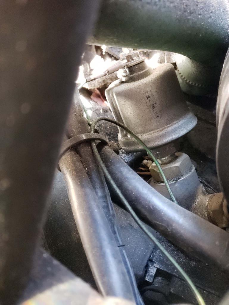

OK, we got the 0-10 Bar oil pressure sender, dual-pole unit with the adapter swapped onto the engine today...kind of a biatch to get in there. My next move is to send my gauge to John Bell for him to match the gauge to the sender, 0-140 lbs. I will probably do that in about a month when it starts raining as the car will be down for about a month with the gauges out. (IMG:style_emoticons/default/beerchug.gif)

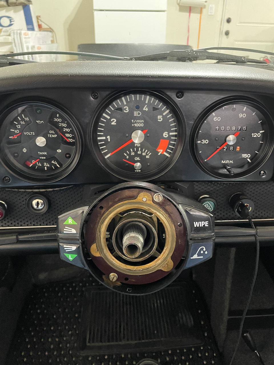

OK, finally getting back to working on may list of things I still want to do. I pulled the gauges and shipped them off to John Bell. I can't wait to get them back in about 5 weeks. I am having the "scale" corrected to match the oil pressure sender as well as a little creative stuff. Should look pretty cool.

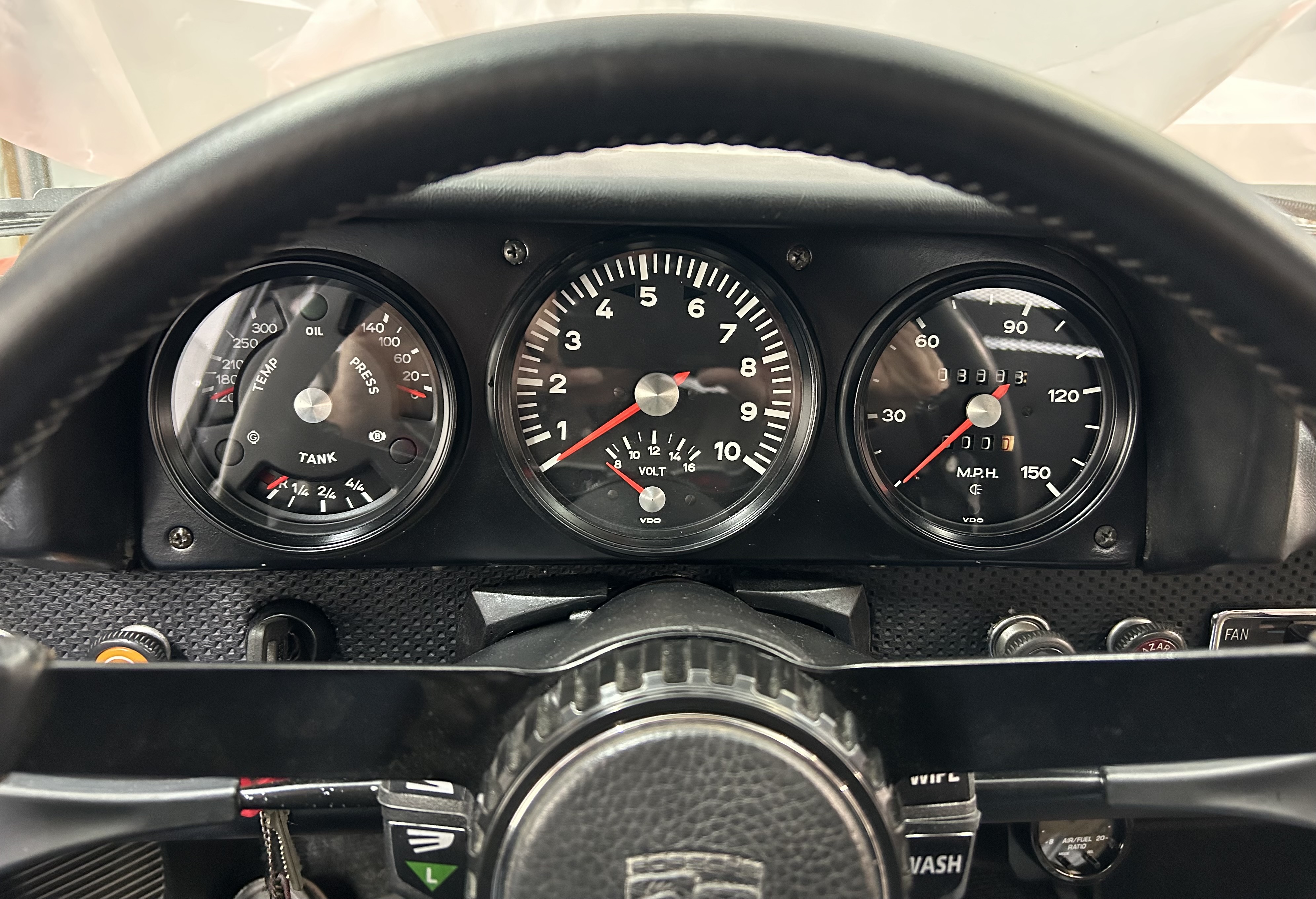

Similar to mine.Attached Image
Cairo94507
post Jan 20 2025, 02:56 PM
Post #499
Michael
Posts: 10,799
Joined: 1-November 08
From: Auburn, CA
Member No.: 9,712
Well thought out; I did not want to have to add extra gauges as I wanted to stay close to stock-ish in appearance. (IMG:style_emoticons/default/beerchug.gif)
