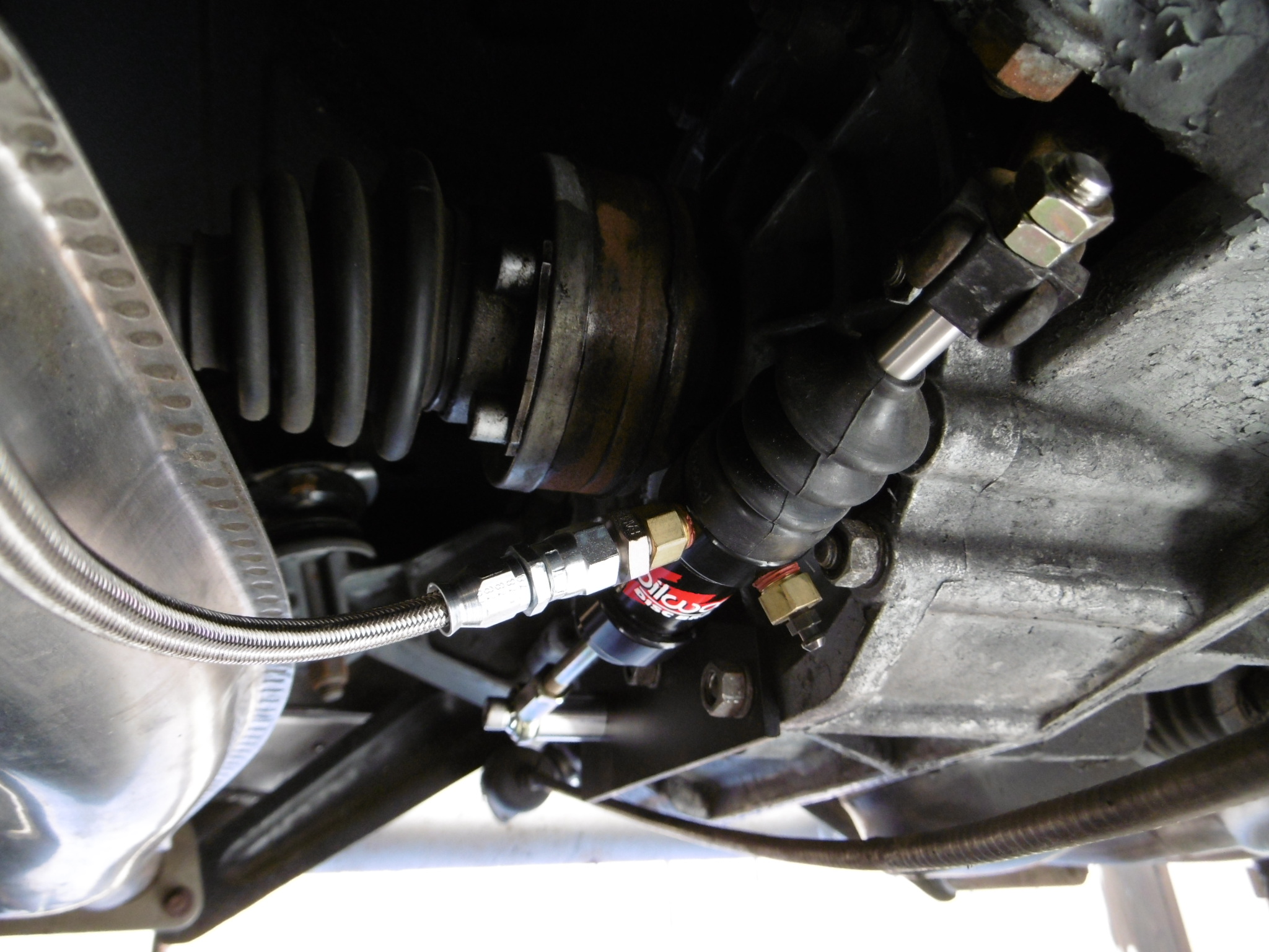

You'll need to use a 3/4" pull type slave cylinder & 5/8" MC. IIRC, Mark did this on his 914 @Euro911 .

euro911
post Feb 22 2024, 08:25 PM
Posts: 8,937
Joined: 2-December 06
From: So.Cal. & No.AZ (USA)
Member No.: 7,300
Did it on th 'BB' ...

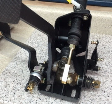

aturboman
post Feb 23 2024, 08:05 PM
Posts: 151
Joined: 18-October 11
From: CA
Member No.: 13,687
This is a hydraulic pedal assembly using all Genuine Porsche bits. G50 + 911 parts.
Just fits under the stock pedal board.

ClayPerrine
post Feb 24 2024, 06:07 AM
Posts: 16,542
Joined: 11-September 03
From: Hurst, TX.
Member No.: 1,143
QUOTE(aturboman @ Feb 23 2024, 08:05 PM) *
I tried that. It didn't fit. The clutch master cylinder ran into the body sheet metal.
aturboman
post Feb 25 2024, 09:44 AM
Posts: 151
From: CA
Member No.: 13,687
Agreed, requires a slight clearance bump in the sheetmetal but its all factory. The rest is plug and play.

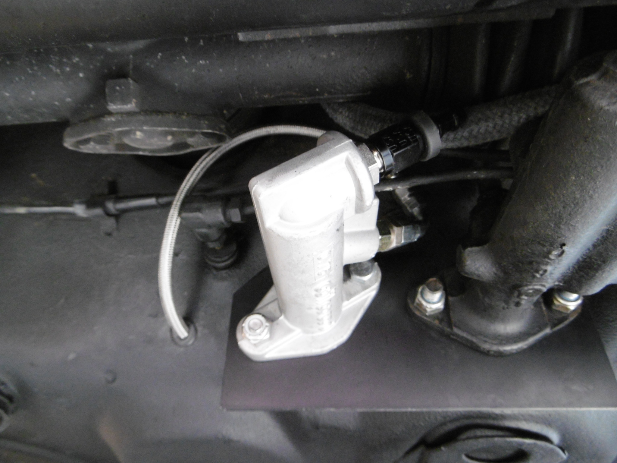

Hi Used to offer a kit.
These are the parts I used. Dont have any remaining mounting brackets although.
The following list is the part numbers, description, and vendor price for the parts I sourced.
• Wilwood remote master cyl. ¾ bore, WIL-260-6089, Summit Racing $47.94
• -3 AN PTFE Hose, SUM-220981 @ 20 ft (may only need estimated 12ft) Summit Racing $40.49
• 7/16-20 to 5/16 hose barb fitting, 3207, Pegasus racing www.pegasusautoracing.com $24.99
• (2) 90 deg. -3 fitting, AER-FBM1120, Summit Racing $12.97 ea.
• -3 AN hose to female -3AN straight steel fitting, AER-FBM1120, Summit Racing $8.97
• 3/8-24 to -3AN Male adaptor WIL-220-3406, Summit Racing $2.99
• 5/16 rubber tubing from master cyl. to reservoir, Auto Zone $ ??
• Remote Reservoir WIL-260-7577, Summit Racing $59.94 (Mine leaked I sourced a replacement from an older Chevy S-10).
David
dwillouby
post Feb 26 2024, 02:33 PM
Posts: 395
Joined: 27-December 02
From: Mt Washington, KY
Member No.: 29
Forgot the slave
• Howe Racing slave cyl; HRE-829, Summit Racing $53.97*
