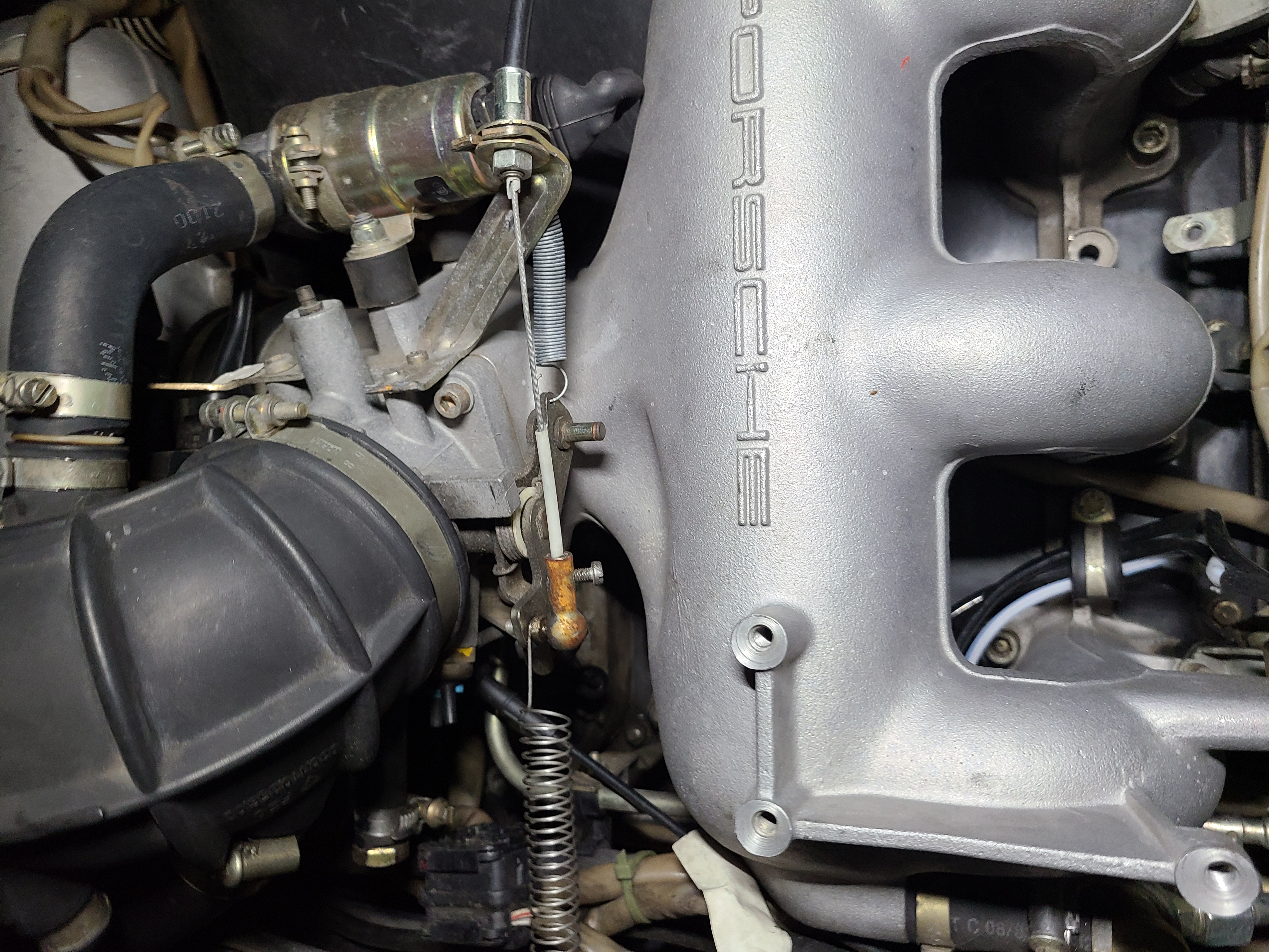

Does anyone have pics of this part installed on the car, above and below? I am missing most of the 911 style accel cable parts for my 3.2 and want to see if this means not having to buy them. Like the $100 coat hanger, etc.

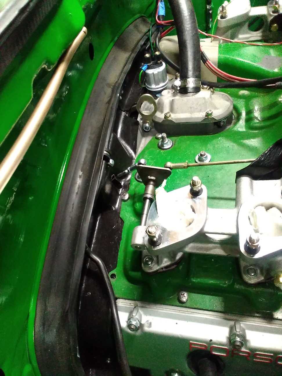

Coat hanger not required with this cable. I will try to get a topside pic later. I have this cable installed, but shortened the core portion by 1 1/2" to get everything correct

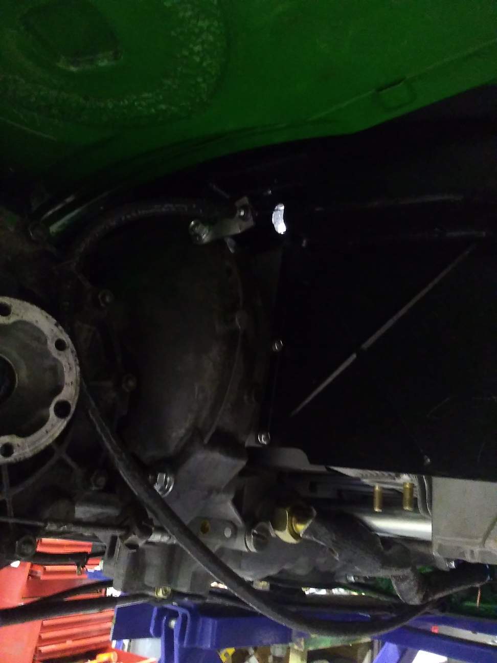

and

Great topside pic. I will need several threaded ball cups and the rod on top.
Now a good pic showing how the underside connection and adjustment are made.

Does the shot from below indicate what you are looking for?

I can't exactly make out how and where the cable attaches under the tins. In the PMS pic, there is a CAD plated part that attaches somewhere and has a threaded adjustment barrel on it. Where does that go?

This is what I am dealing with.

So the PMS part, a bracket, bolts to the trans just before the cable goes through the tins? Is that where a cable slack adjustment would be done?

Correct, the bracket furnished with the PMS cable attached to the trans bolt and there is a small adjustment available there.
From what I can tell it's a custom product, after shortening the core about 1 1/2" it seems to be working fine. Time will tell
