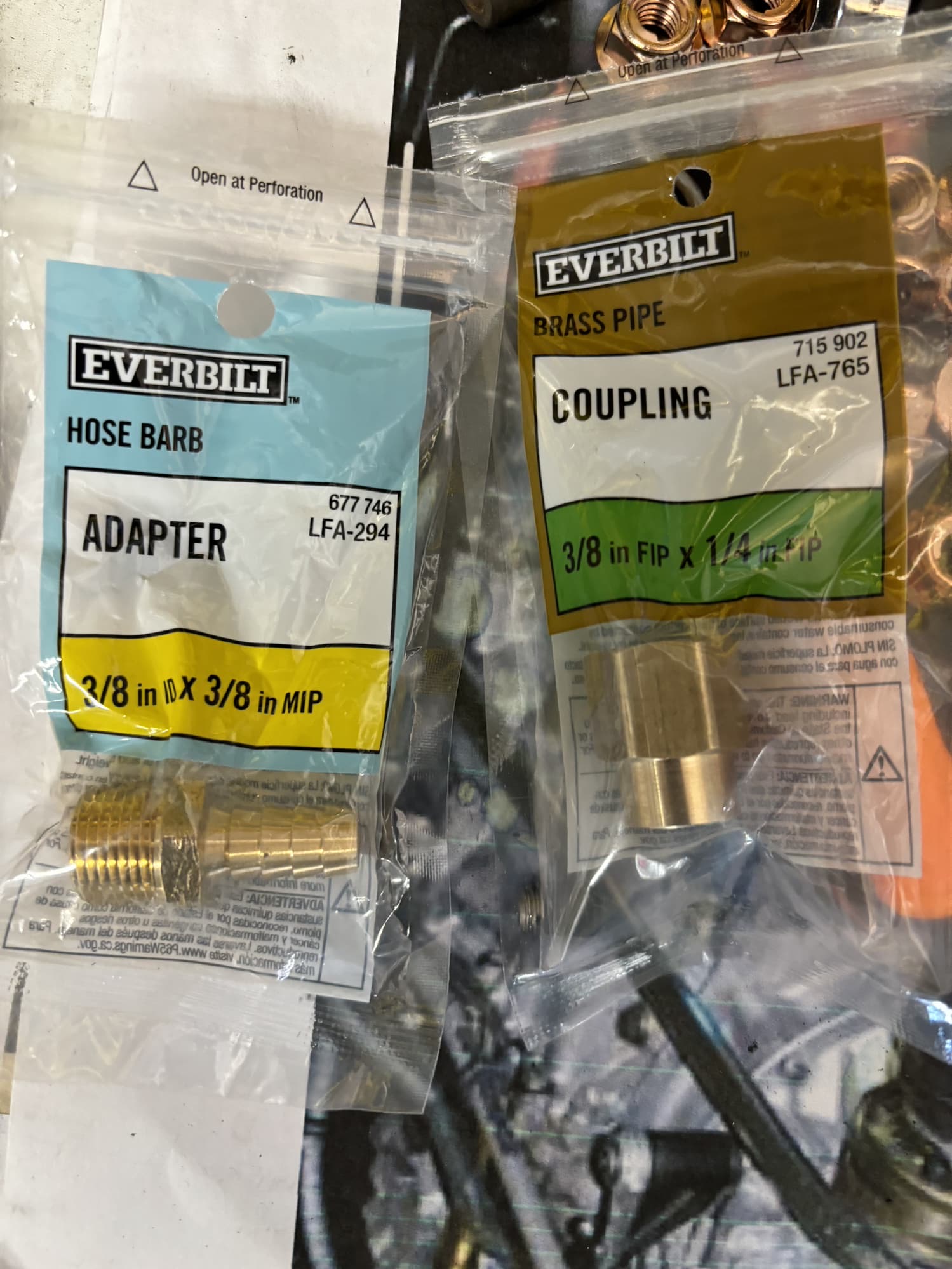

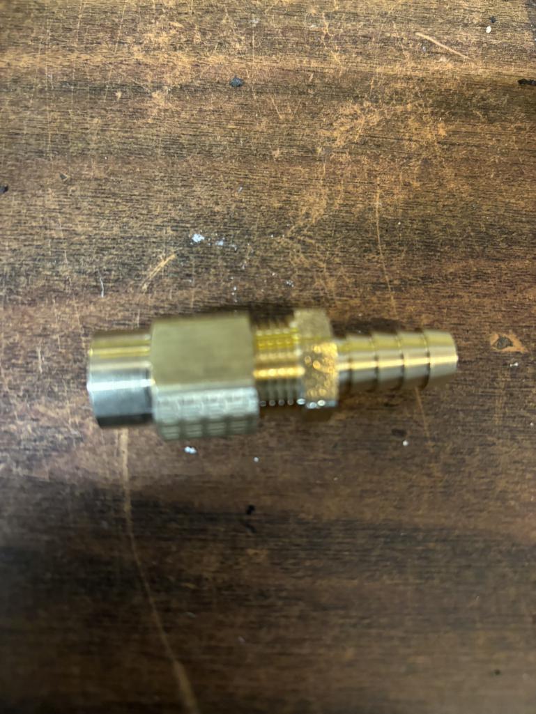

Different PMS cable but similar issue. When using the 3.6 PMS cable with a 914, the throttle cable is also about 1.5” too long. PMS recommendation was to extend the outer shielding at the firewall with their spacer. I accomplished the same thing with Home Depot crap. Check out my thread. http://www.914world.com/bbs2/index.php?sho...69082&st=80
The reason the PMS 3.6 cable is to long in a 914 is because you have to cut the intake pipes and rotate the throttle body to clear the trunk. Not a problem in a 911.

QUOTE(Steve @ Aug 23 2025, 07:11 PM) *
Do you have a photo itself of what it looks like? Curious to see, but glad I'm to hear there's some options. I have made everything shorter to try and compensate and still too long (IMG:style_emoticons/default/sad.gif)
Steve
post Aug 24 2025, 06:28 AM
Post #31
Posts: 5,926
Joined: 14-June 03
From: Laguna Niguel, CA
Member No.: 822
I don’t have a handy picture of it installed, but it just slips over the tube at the firewall and the throttle cable housing slips over the adapter/spacer. You have to remove the throttle cable to use it.
