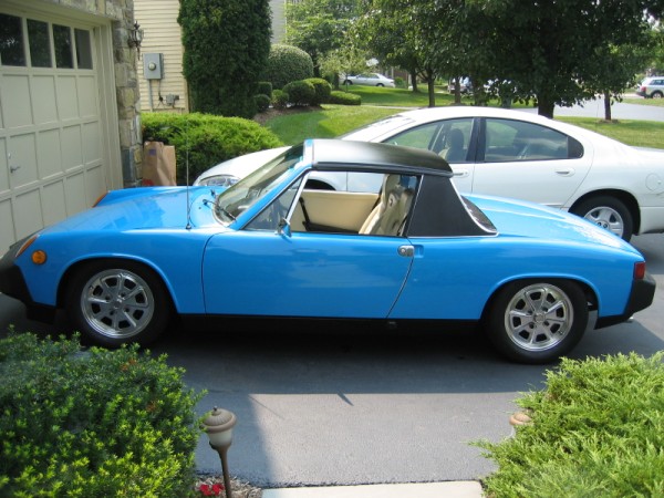

I recently bought a '75 2.0 and it was originally a California car. It has all the smog stuff but I wondered if California cars had any additional anti-smog/pollution items added to them?

Wow! Great looking car. Looks like white interior...it it?
Sorry, I not sure of any other CA Smog requirements. But John, I'm certain that others in the 914Club will comeback with any info you need.

I'll look for the info on the door sticker, thanks Jeff. I know the 75's and 76's had lower HP than the 73/74's but is that due entirely to the air injection/EGR stuff? If so, would backdating that set-up to the system used on the 73/74 return the additional HP? I know it'll lower the engine temperature. Cats can be rodded out, I think, to improve exhaust flow but that may have other negative implications.
Yeah, this has the white interior and it makes a big difference in cabin comfort here in Virginia in the summer months. I agree this is a great color combo and the first like it I'd ever seen. I never heard of the white interior but Johnson's restorer's guide says it was a 75/76 option.
Evidently this car won a San Diego Concours in 1996 but I'm not a CCW so that just tells me it's been well maintained. It was "restored" meaning it got a new paint job but it's the original color. Runs/drives great, ~74k miles.
