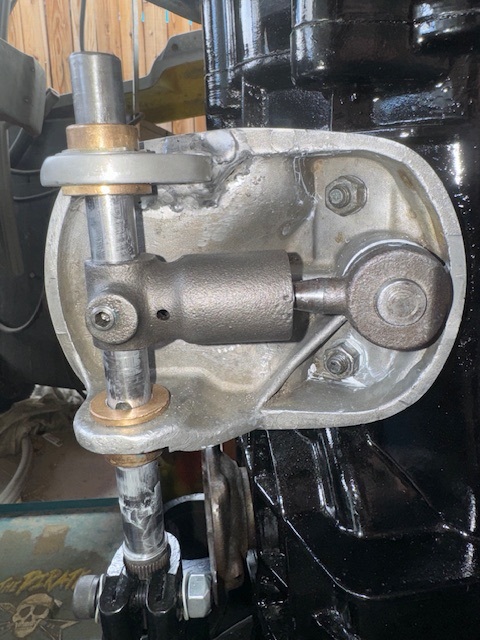

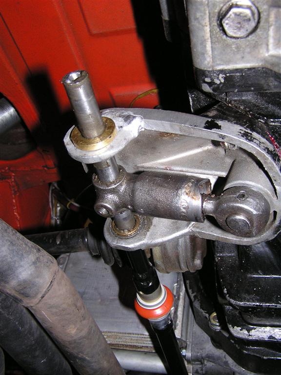

Title says it all. Thanks to Chris Foley for such good stuff!
My car shifts so well now its nuts! If youve not tried it, do it. The stock setup, no matter how new the bushings are dont even come close. Why the factory only had one pickup point at the console is beyond me. Tangerines system is how it should have been from the factory! I can actually shift with 100% confidence. It was always a thorn in my side the way the car shifted. That is over!!! Click, Click, Click (IMG:style_emoticons/default/piratenanner.gif)
Thanks Mr. Foley for all the rad products!!!!
Oh and his shifter adjustment procedure is easy as can be and the most effective ive used. (IMG:style_emoticons/default/beer3.gif)
SO HAPPY!! (IMG:style_emoticons/default/biggrin.gif)

speed metal army   Easy stuff! Took about 2 hours. No need to rem...   Apr 24 2024, 09:10 AM

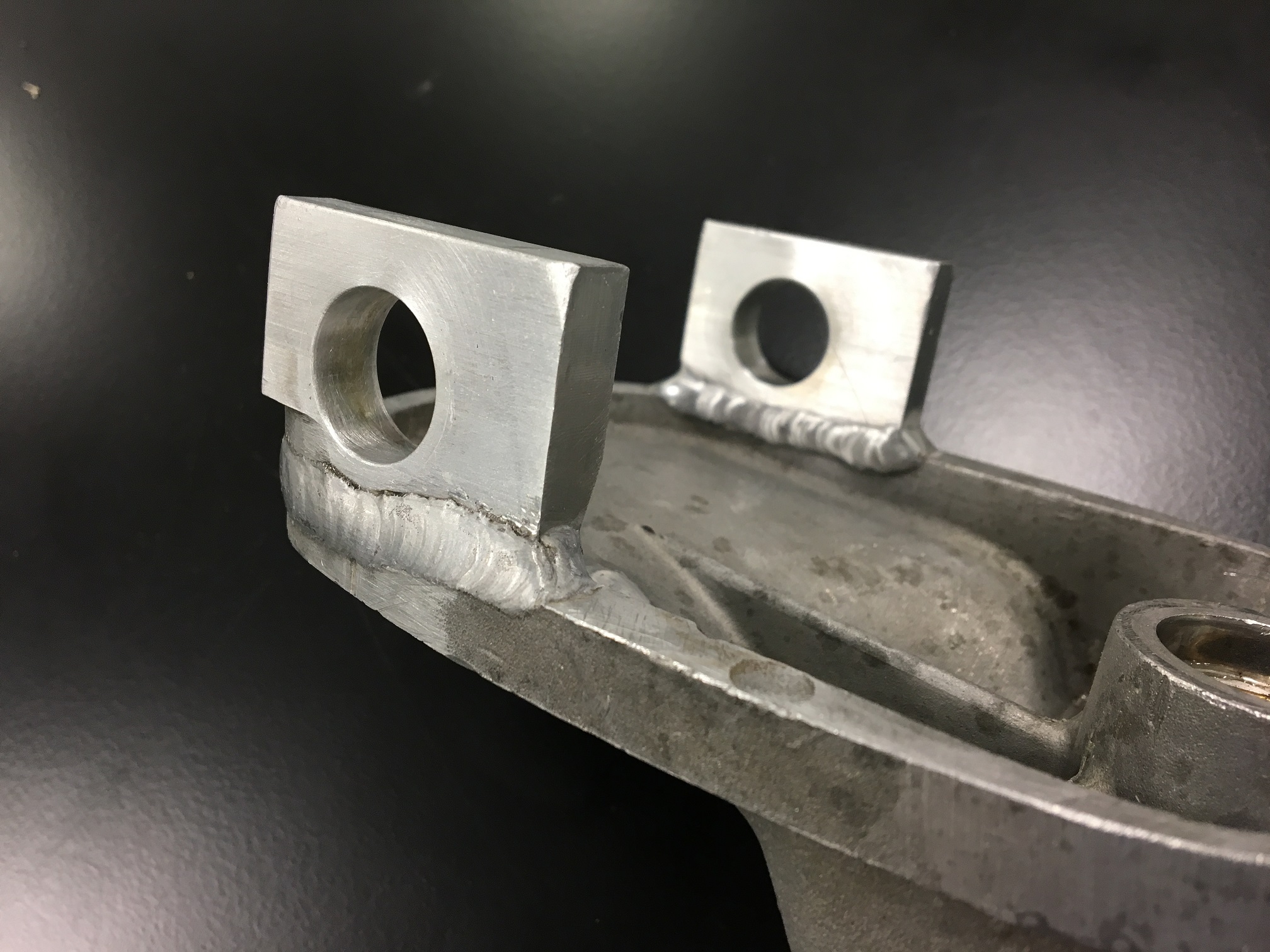

914werke   "He cut off the ear, put up the template, ma...   Apr 24 2024, 08:46 PM
mepstein   "He cut off the ear, put up the template, m...   Apr 24 2024, 09:12 PM
speed metal army   "He cut off the ear, put up the template, m...   Apr 25 2024, 09:03 AM

913B   How much do you hack off the console, is there a p...   Apr 25 2024, 02:11 PM
Shivers   How much do you hack off the console, is there a ...   Apr 25 2024, 04:14 PM

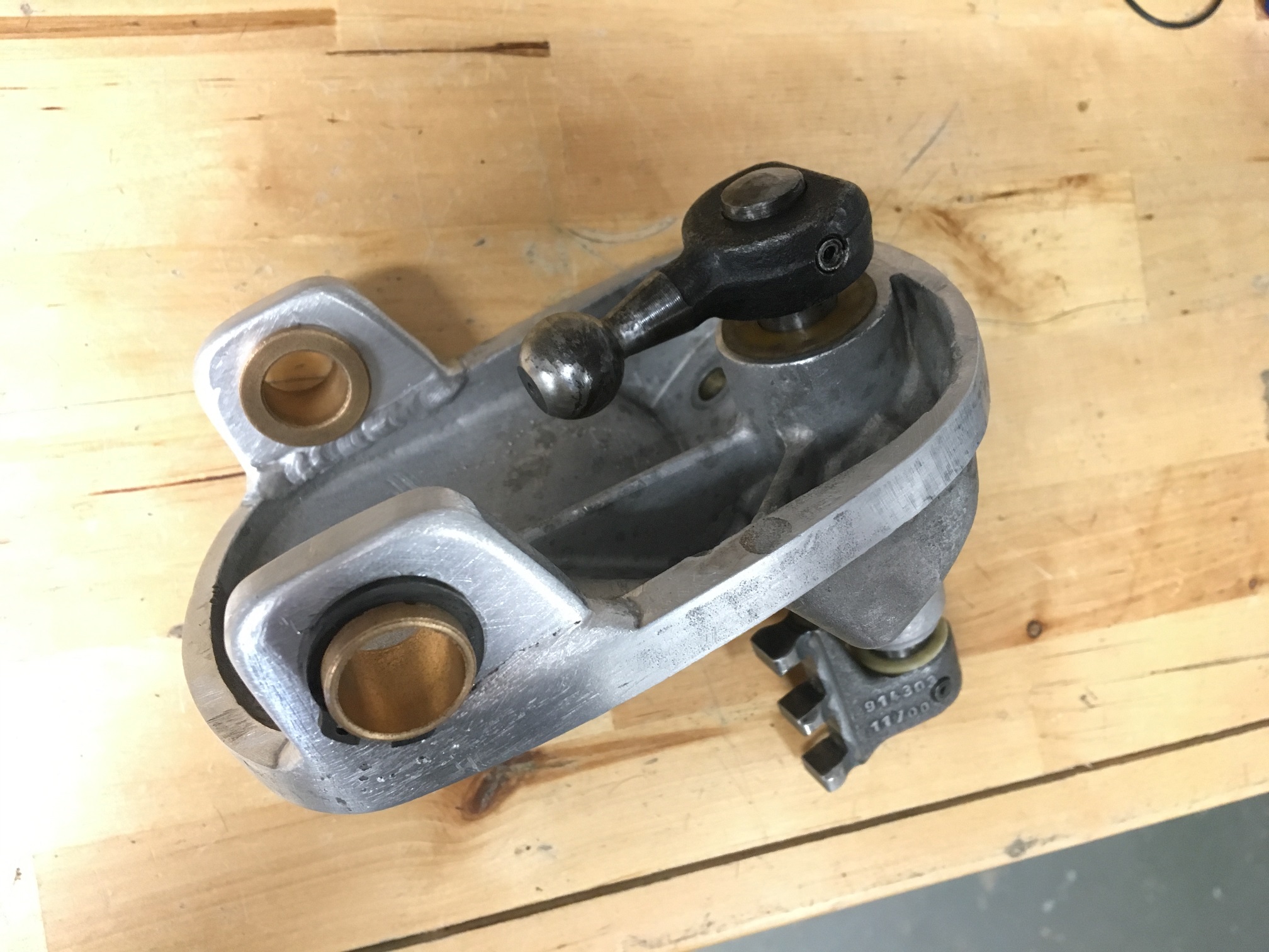

914werke   I am using the Weltmiester short shift kit up at t...   Apr 26 2024, 01:19 PM
Shivers   I'm glad I did the home brew version. It was f...   Apr 26 2024, 02:58 PM
gereed75   Rich Do you mean the "notchy" thing?? ...   Apr 26 2024, 04:30 PM

ChrisFoley   More drives, so happy!!! Its never b...   Apr 30 2024, 06:13 AM
NARP74   What if you want to remove it to take to to a lath...   Apr 29 2024, 09:13 AM
VaccaRabite   What if you want to remove it to take to to a lat...   Apr 29 2024, 09:48 AM
ChrisFoley   What if you want to remove it to take to to a lat...   Apr 30 2024, 06:11 AM
Shivers   What if you want to remove it to take to to a lat...   Apr 30 2024, 07:45 AM
NARP74   What if you want to remove it to take to to a la...   Apr 30 2024, 09:21 AM
