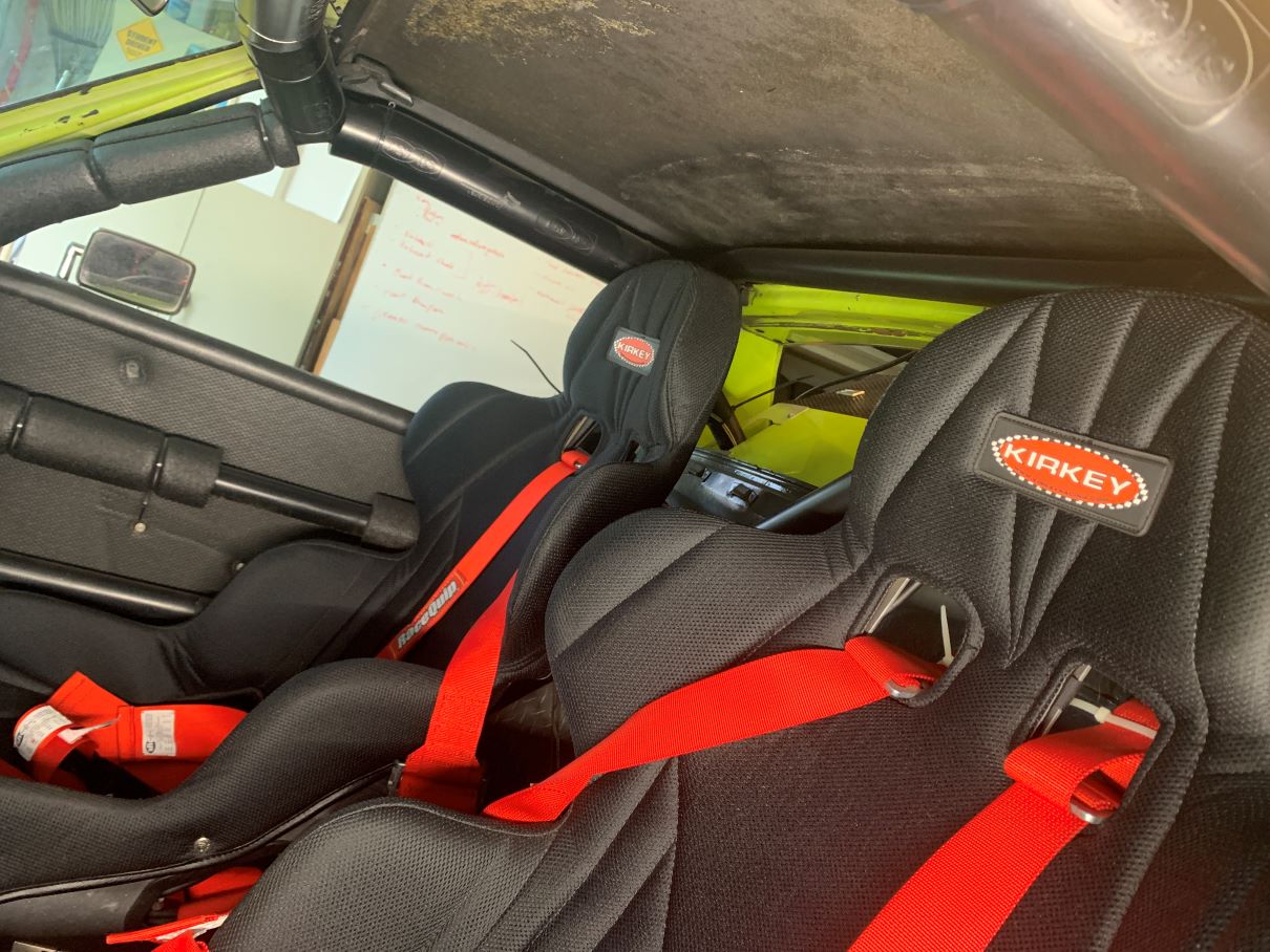

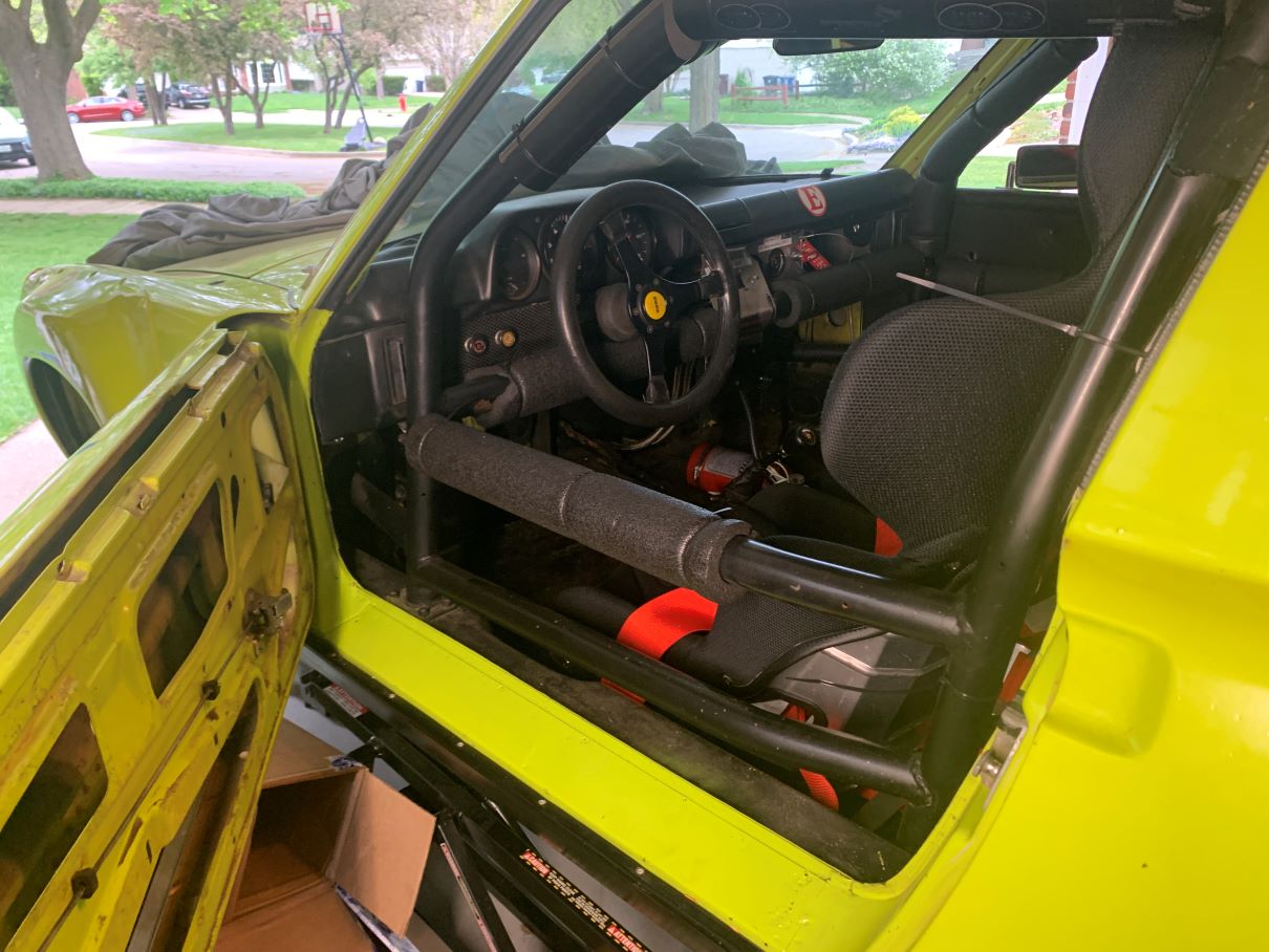

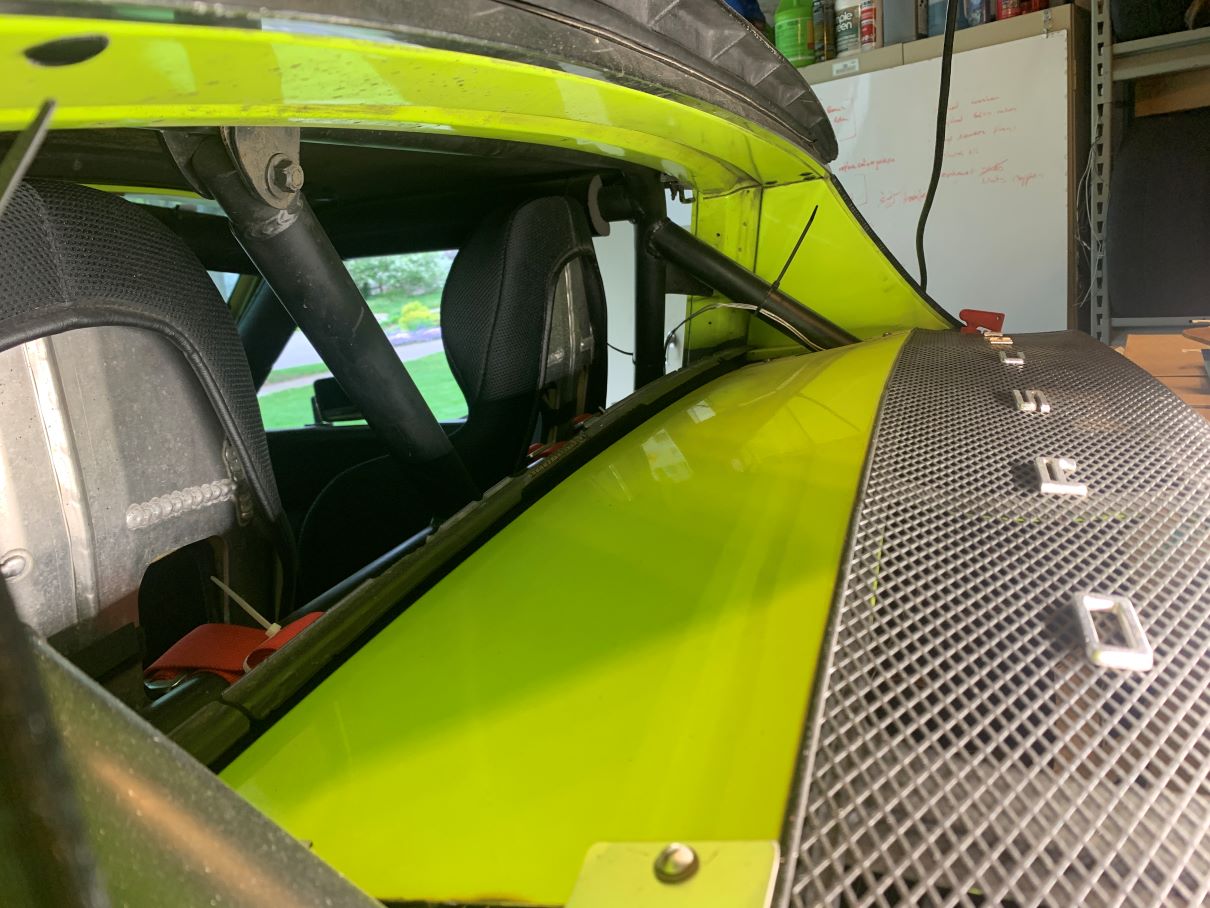

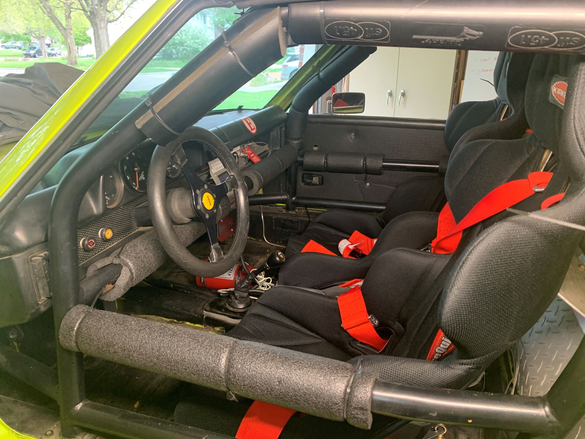

Hope this finally works, will get photos of the front cage and rear cage points later today. All connected in full 8pt cage.

>>> I'd need to see your cage...
Looks good from here.
>>> Kill switch
Installed. Ensure everything goes through it, and run the car and flip it to see if the car dies. That's how we test them.
>>> fire system required
I see it's there. Ensure the bottle is up to spec.
>>> Up to date harnesses
In 2017, SFI changed from tags listing the manufacturing date, to tags listing an expiration date. The old ones were good for five years with SCCA, the new ones two years. Yours appear to be the older manufacturing-dated SFI; if that's correct then you'll need to replace your harnesses.
However, if yours actually have another tag that gives an expiration date, ensure they're good through 2024.
Spend a little more for the FIA ones. They're good for five years instead of two.
>>> a good racing seat
Those look good. Give 'em a good shake and ensure they're "securely mounted".
A back brace is not required by SCCA, but may be required by other orgs.
Note that if you run with the top off, you must pass "the broomstick test" and use arm restraints. That mean the top of your helmet must be two inches below a broomstick (or whatever) handle placed across the top of the rollbars.
Ironically, if you install the plastic targa top, your helmet can actually touch the top and no one cares. Don't ask me why...
>>> windshield retention clips
Yours seem to comply.
>>> window net, fuel cell...Brake lights. Rain light, if your stock taillights are disabled. Disable steering lock. Tow hooks each end.
Check you comply with those.
