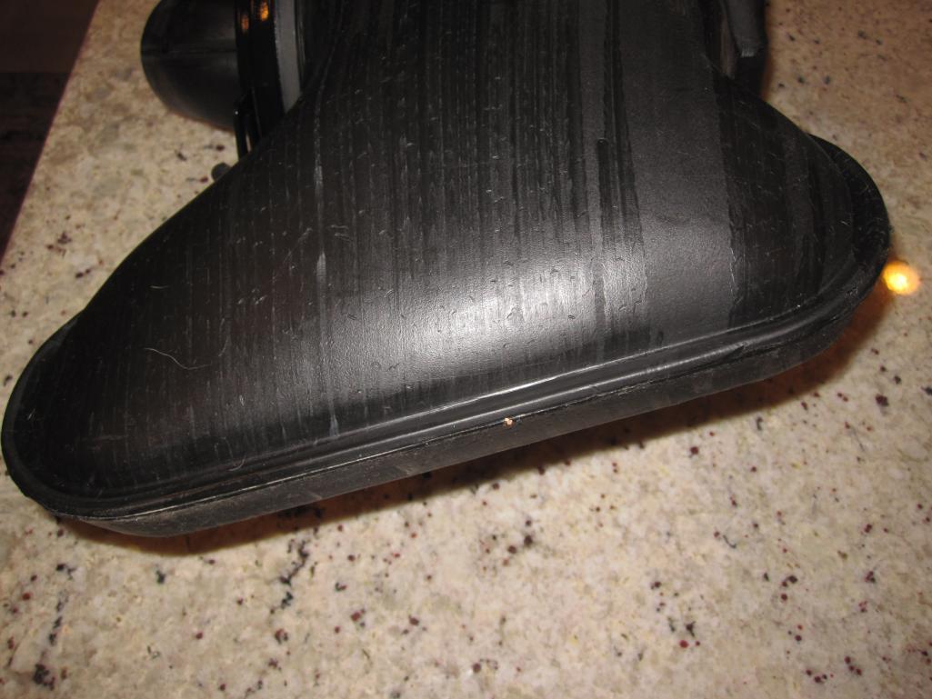

I recently picked up a 911 mechanical fuel injection, air cleaner assembly . I was hoping I could use this with the carburetor Air cleaner base unit I already have. I was wrong once again. Can anyone point me in the right direction on how to make this set up work? I have no problem making custom clips to attach to. Has anybody modified a plastic air cleaner to work with Zenith air cleaner base mounts.

So you have an MFI top as you know and carb bases. I went through this a bunch of times and to be honest I even had to modify my steel one to clear everything but I don’t have to worry about that starting on fire like a plastic one just food for thought

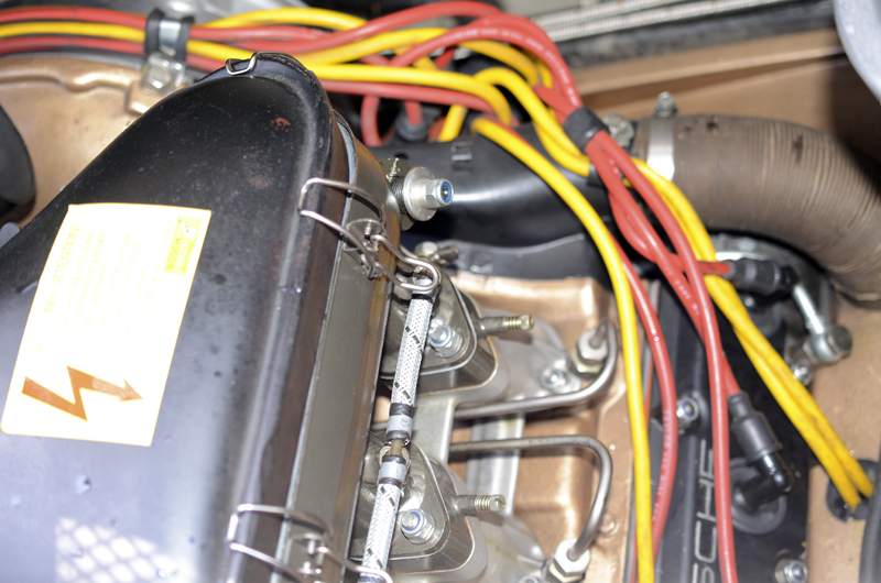

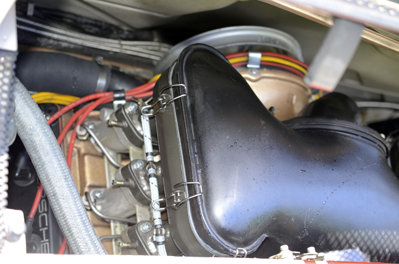

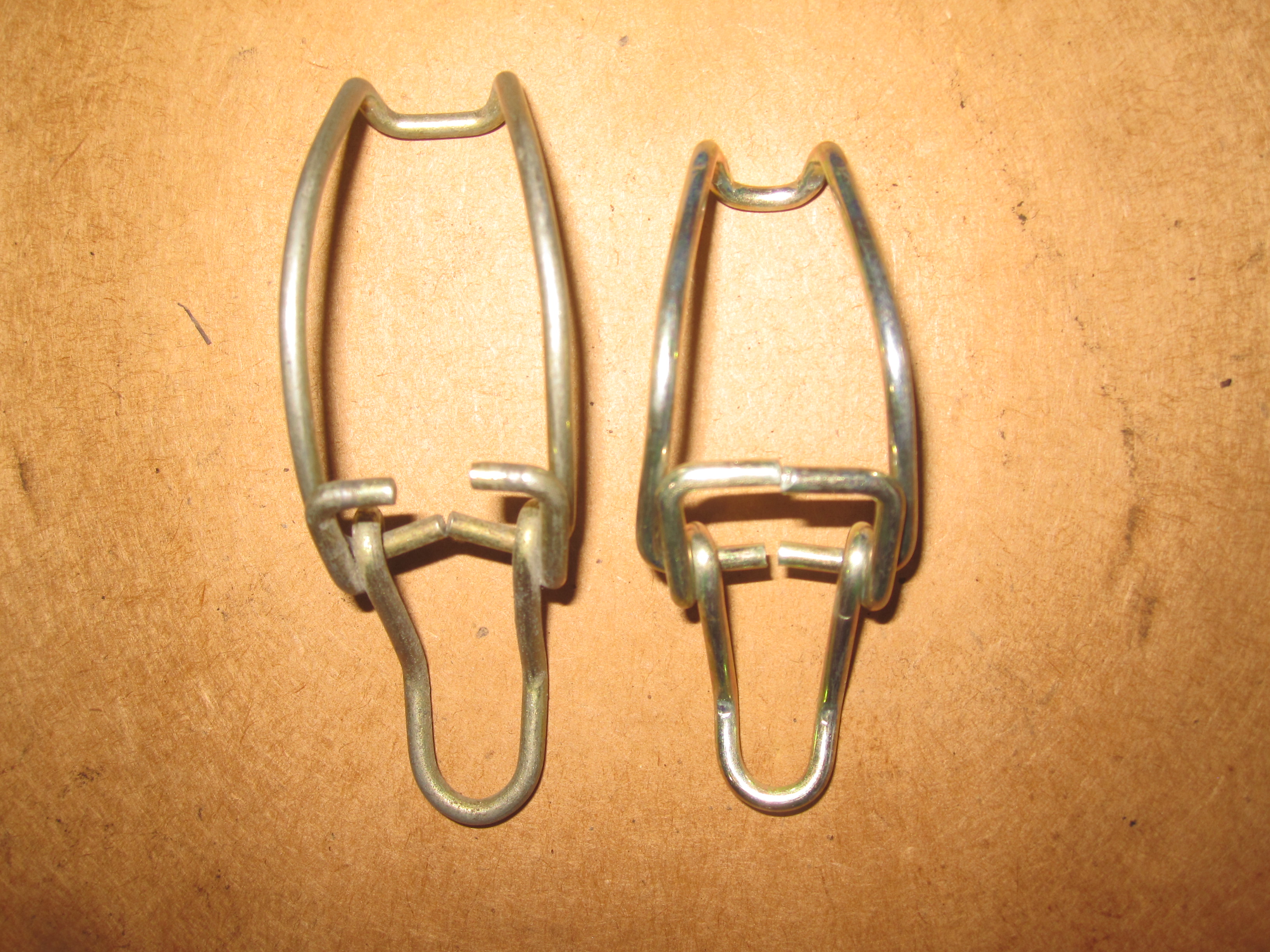

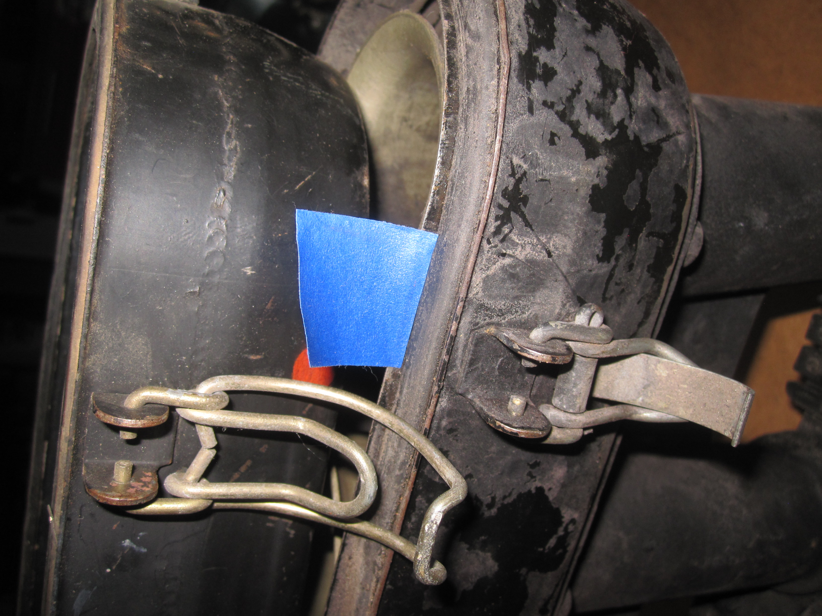

I just re-red your post and hope this helps
MFI boats have different clips and a taller flange on the inner edge of the rubber seal
If you trim the flange even with the top edge of the seal and change the clips I think you'll be in business.
See the pics.
Be carefull with the wire clips, there ar two versions. You'll need the larger ones

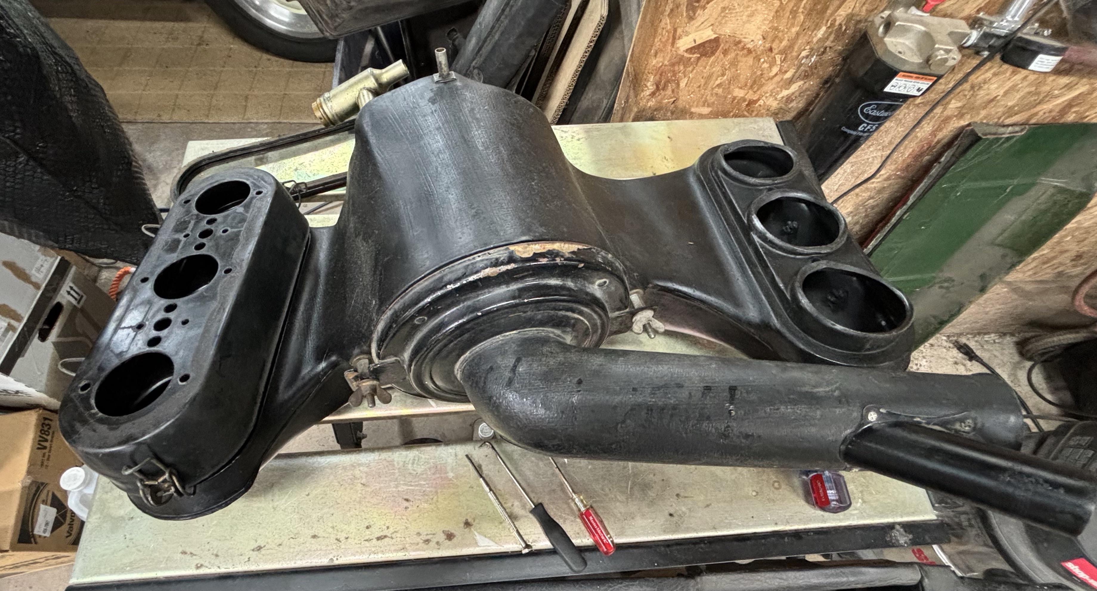

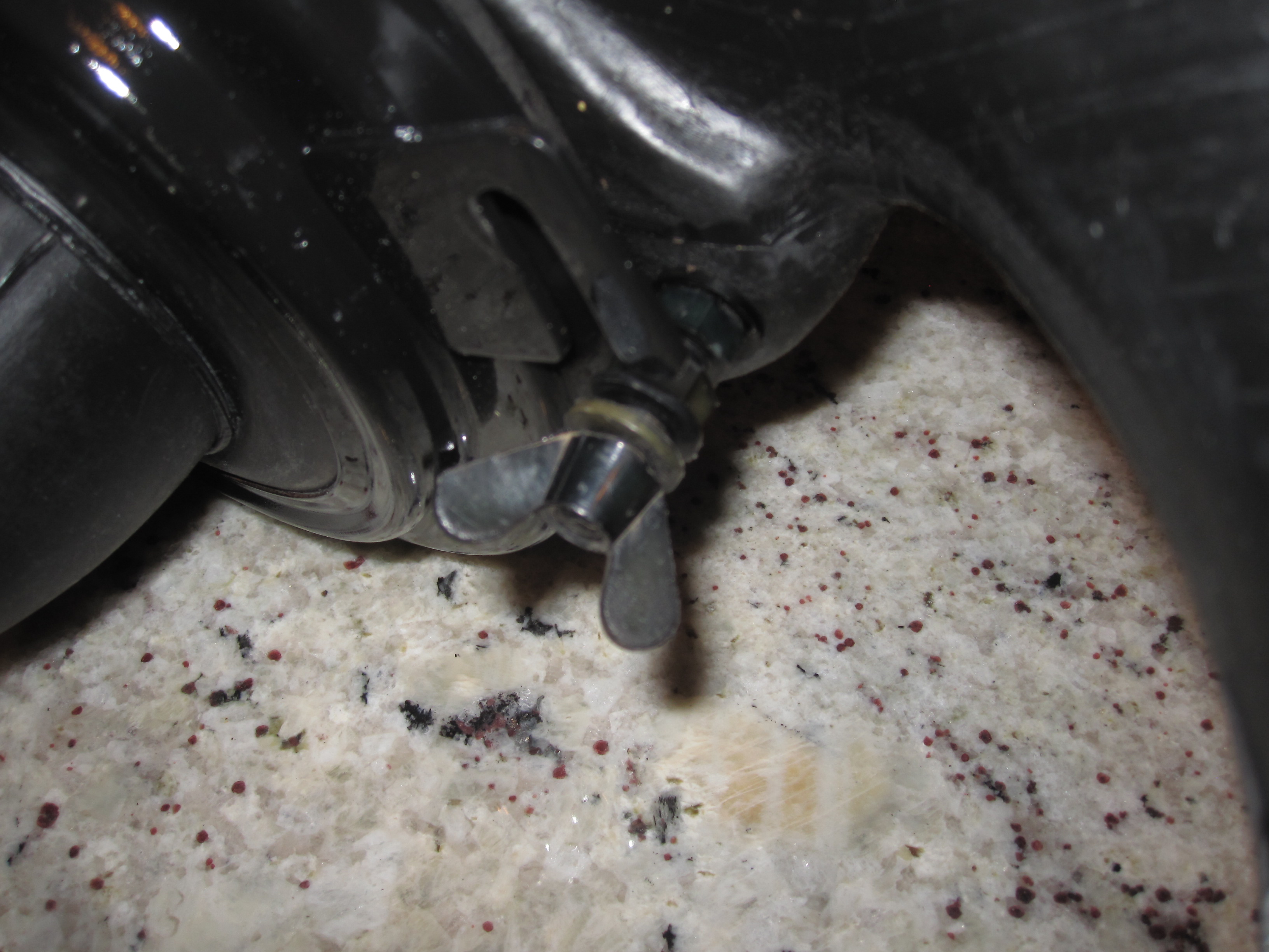

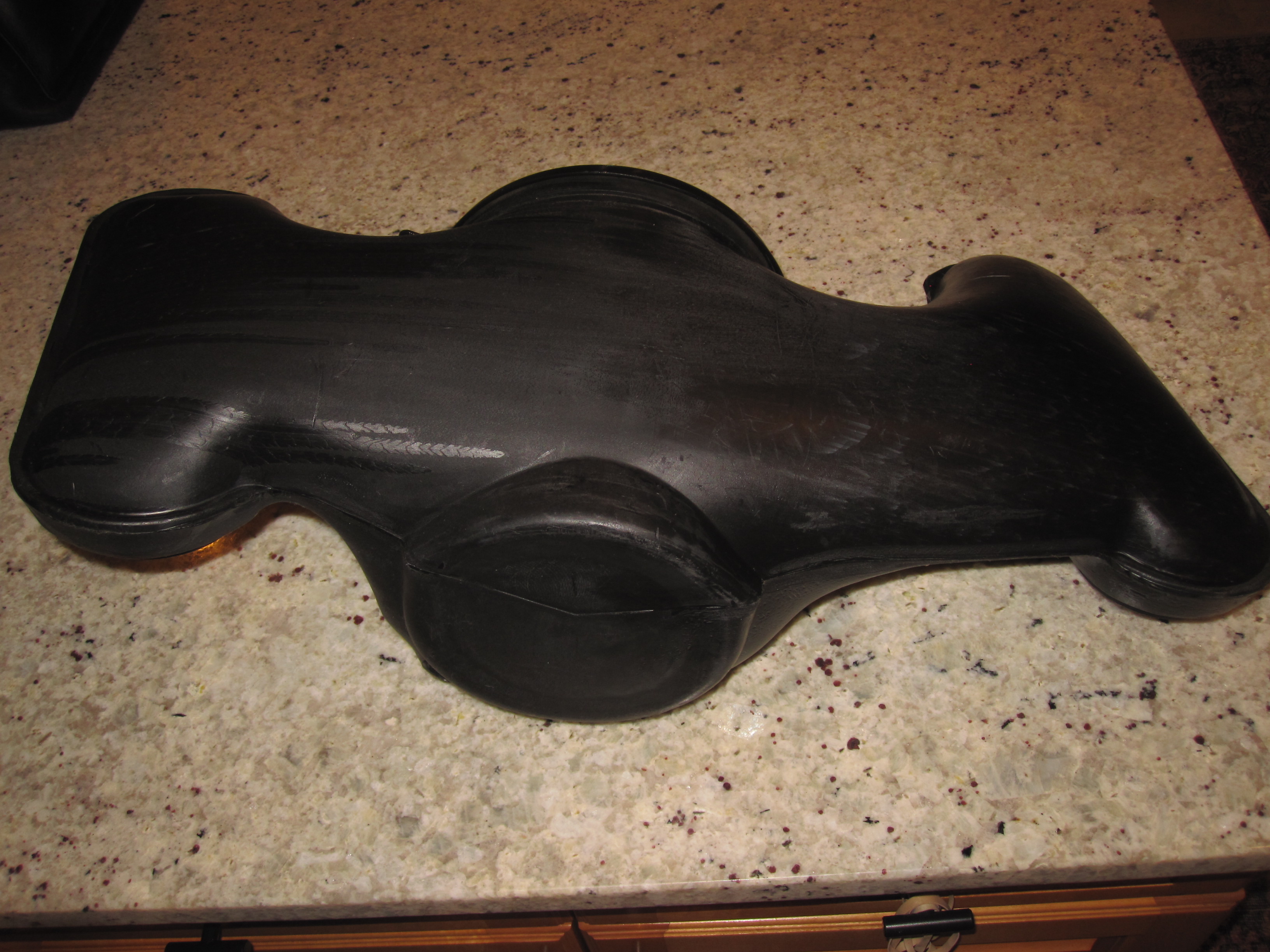

Did MFI air filters have the enrichment spray parts ?
914 6 air filters did.
Your snorkel is for a 911
Are the wing nuts plastic ?
Fires in the plastic housings were caused by a faulty enrichment system, faulty carbs and faulty maintenance, not by the housing itself.
Matt your housing is melted in the round openings for each stack. That's not unusual.
Are the mating surfaces flat ?
What carburators are you using ?
Added pics of a plastic MFI housing.

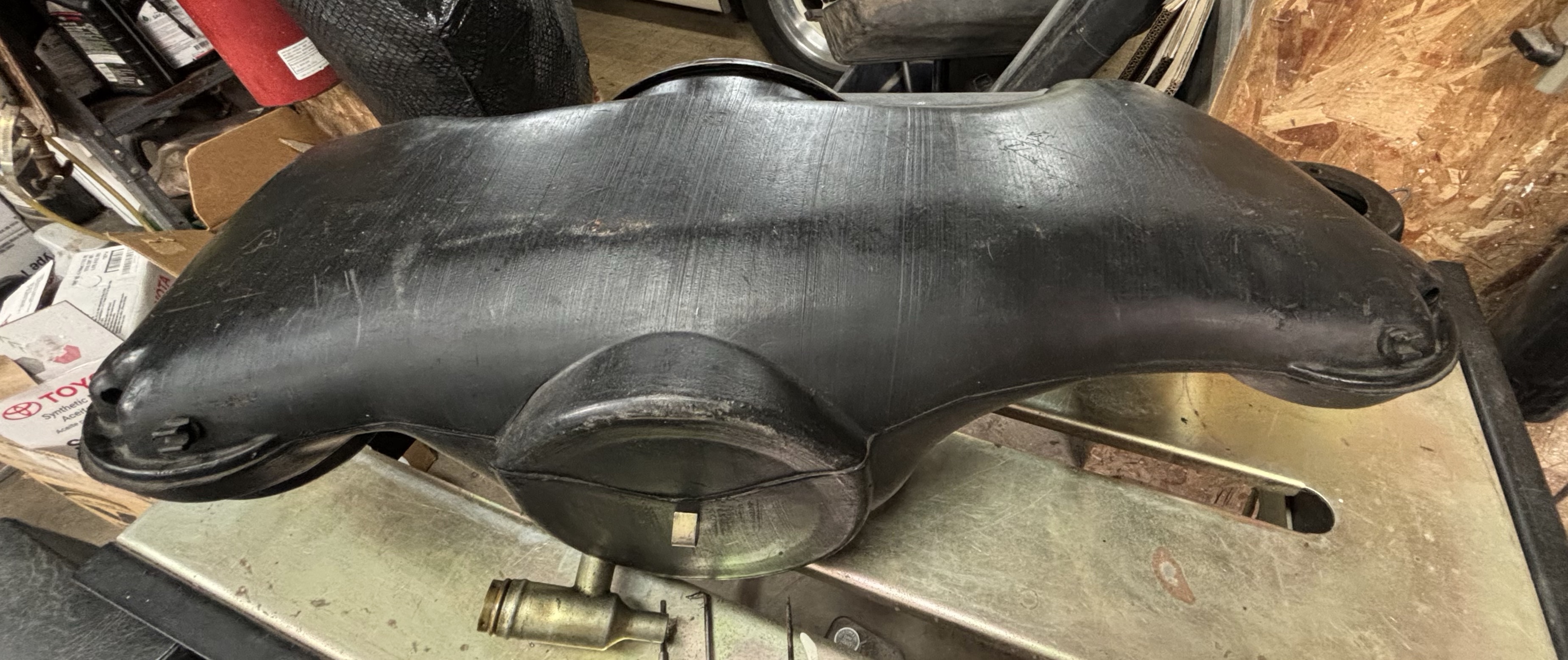

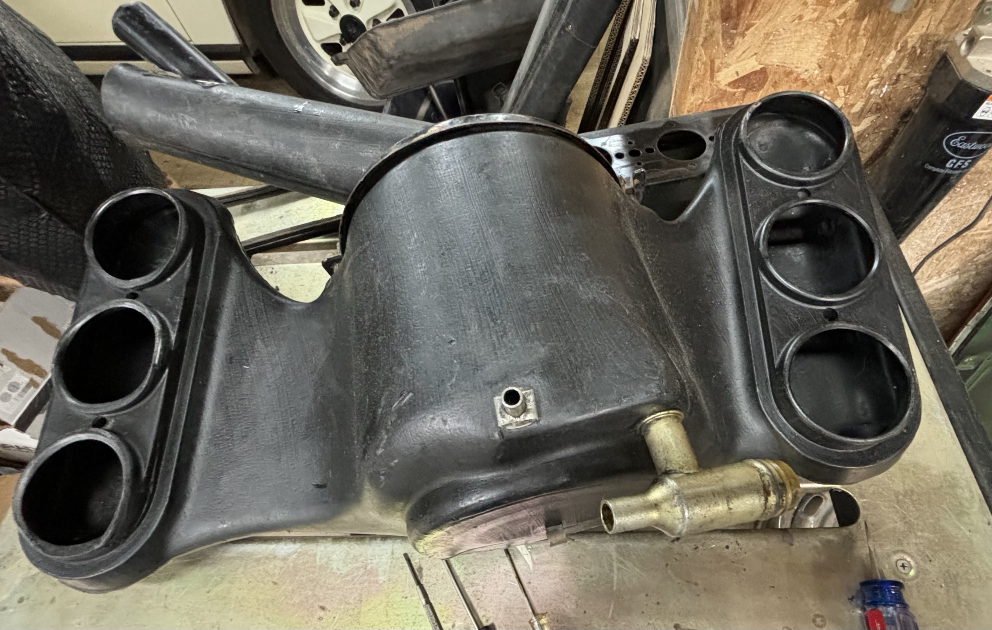

rgalla9146
post May 7 2024, 06:46 PM
Posts: 4,997
Joined: 23-November 05
From: Paramus NJ
Member No.: 5,176
And one more.
I hope this helps.
And congratulations, that's a 914 6 housing.

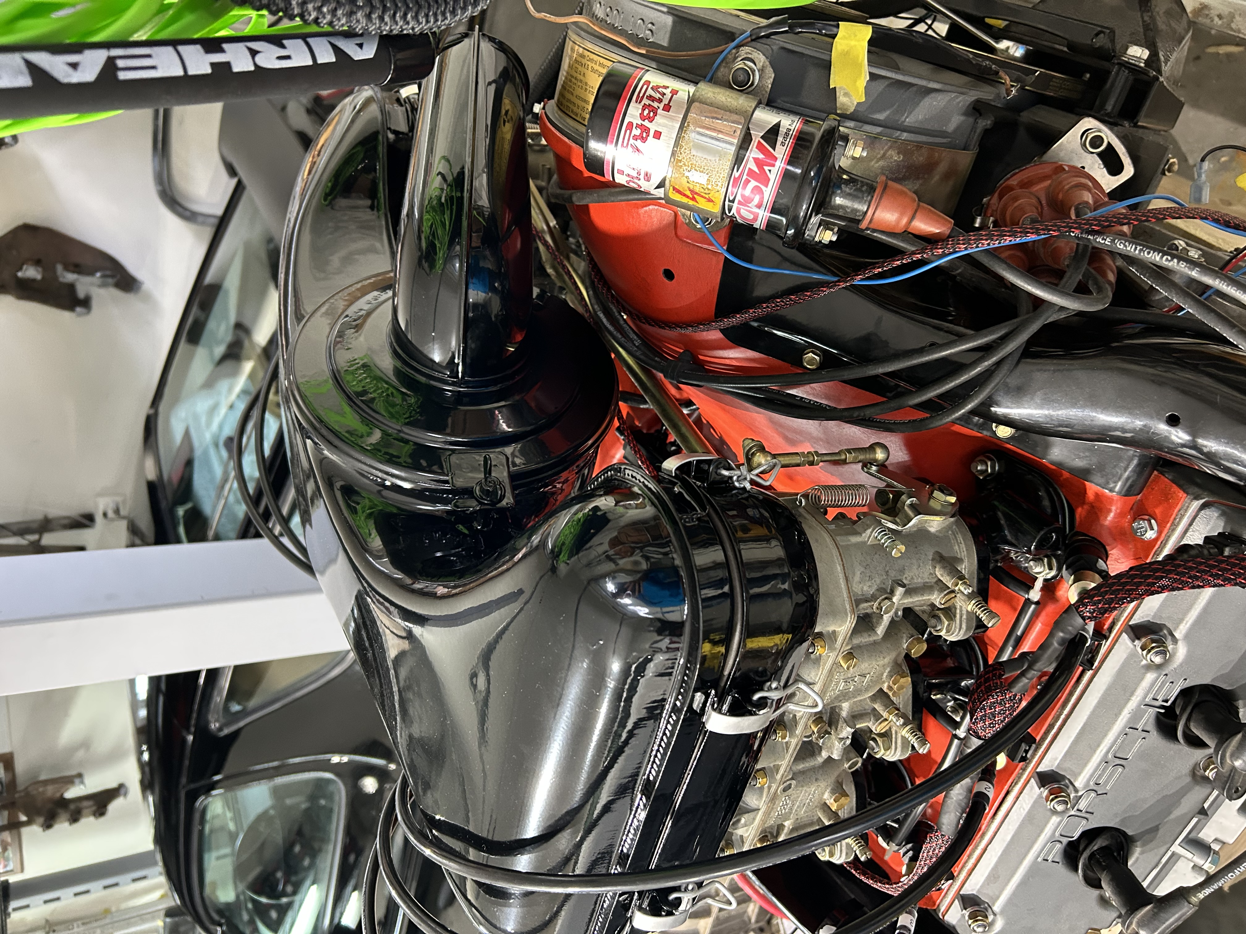

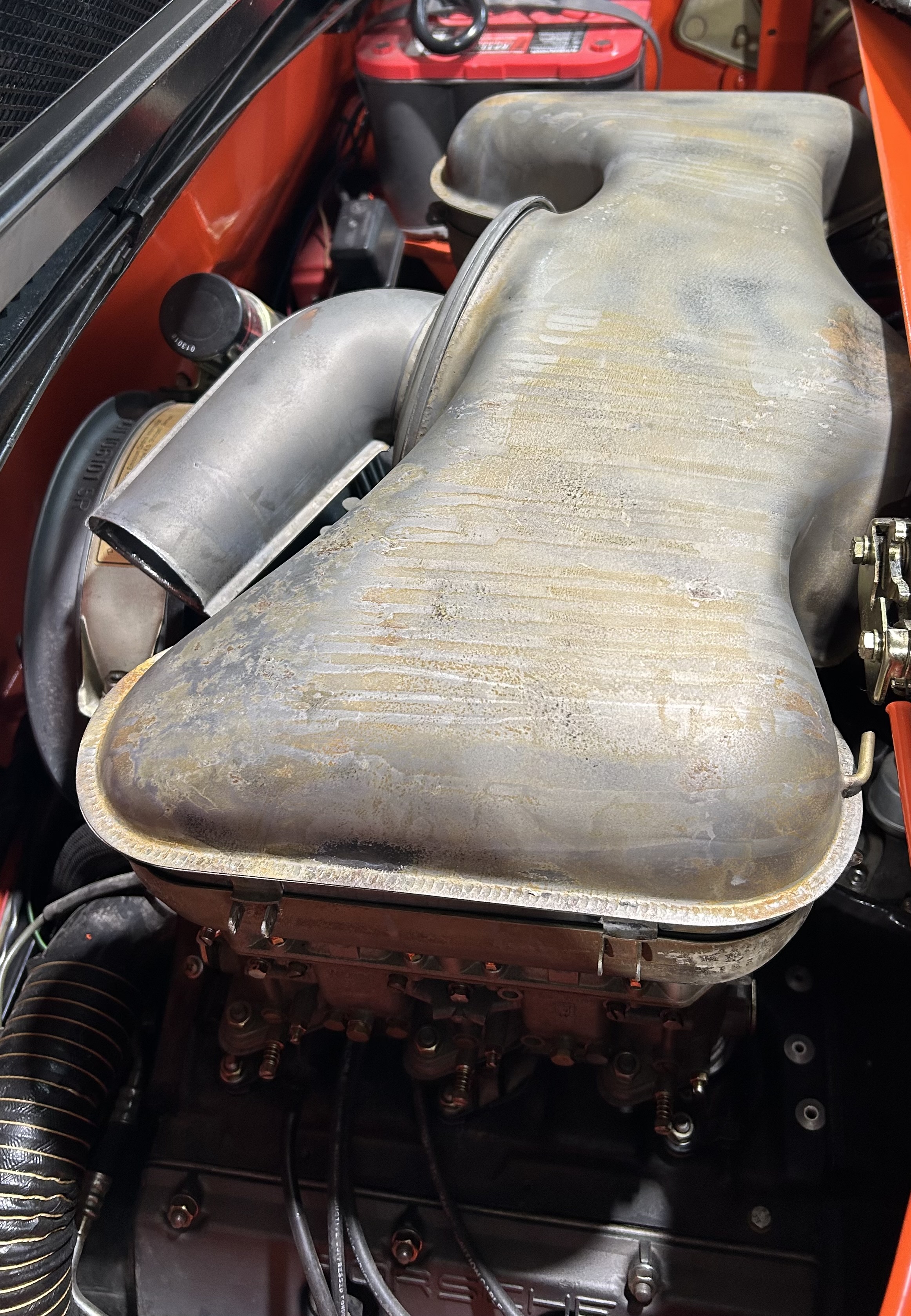

mb911
post May 8 2024, 03:51 PM
Posts: 7,809
Joined: 2-January 09
From: Burlington wi
Member No.: 9,892
You can see how I had to modify mine to clear everything but this is a 911 unitAttached Image

Hi Matt,
it looks good. Maybe it's just put together wrong. You need the long clips. I use a plastic box with carburetor/ 2,2MFI base. Cheers Dirk

Hey Matt
What doesn't fit ?
You have a 6 air filter, Zenith boats (same as Webers) and Weber carbs.
When installing the stock air filter housing in the car it is a bit of a wiggle.
Attaching the drain hose, the big vent hose and flipping a couple of the clips is
annoying.
Doesn't sound like any adaptation is necessary except for correct clips.
