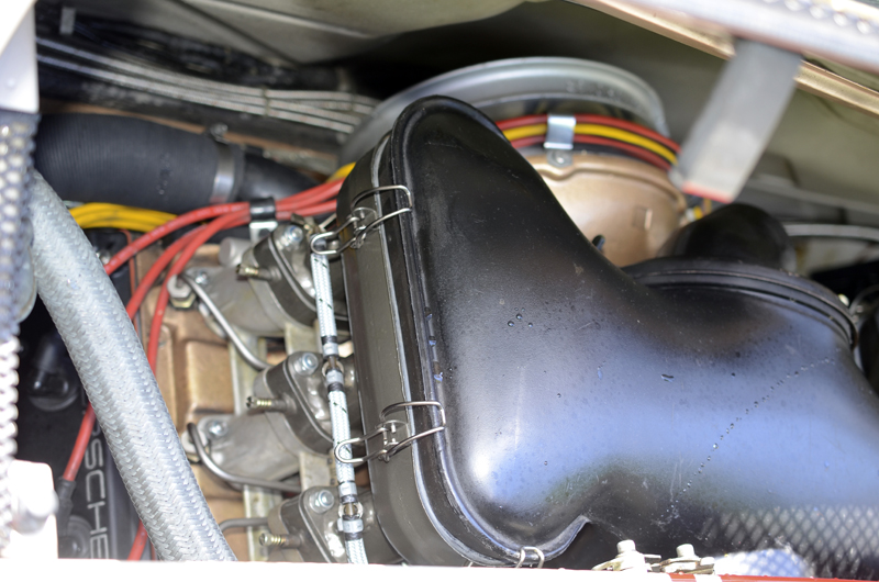

I just re-red your post and hope this helps
MFI boats have different clips and a taller flange on the inner edge of the rubber seal
If you trim the flange even with the top edge of the seal and change the clips I think you'll be in business.
See the pics.
Be carefull with the wire clips, there ar two versions. You'll need the larger ones

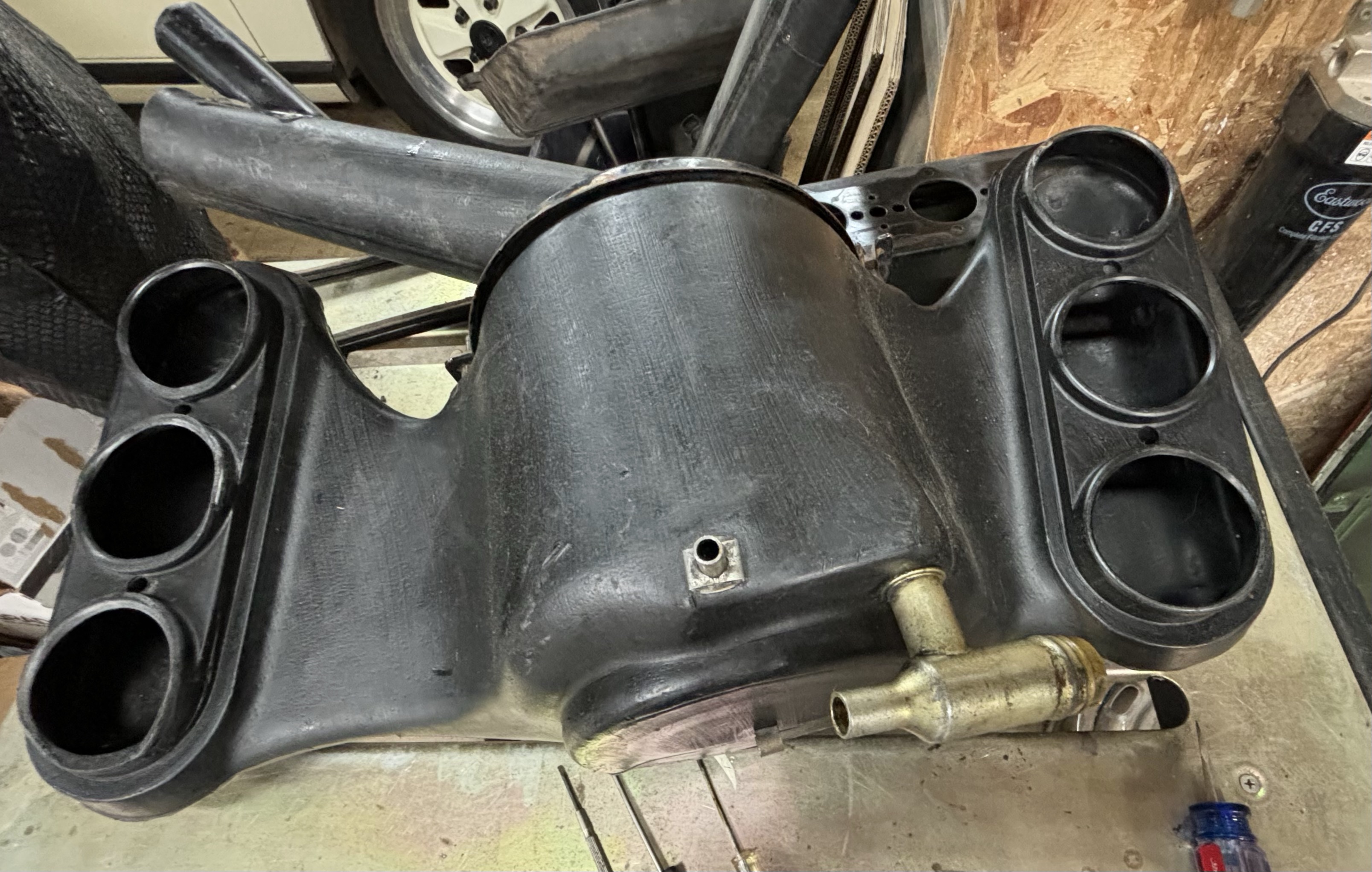

Fires in the plastic housings were caused by a faulty enrichment system, faulty carbs and faulty maintenance, not by the housing itself.
Matt your housing is melted in the round openings for each stack. That's not unusual.
Are the mating surfaces flat ?
What carburators are you using ?

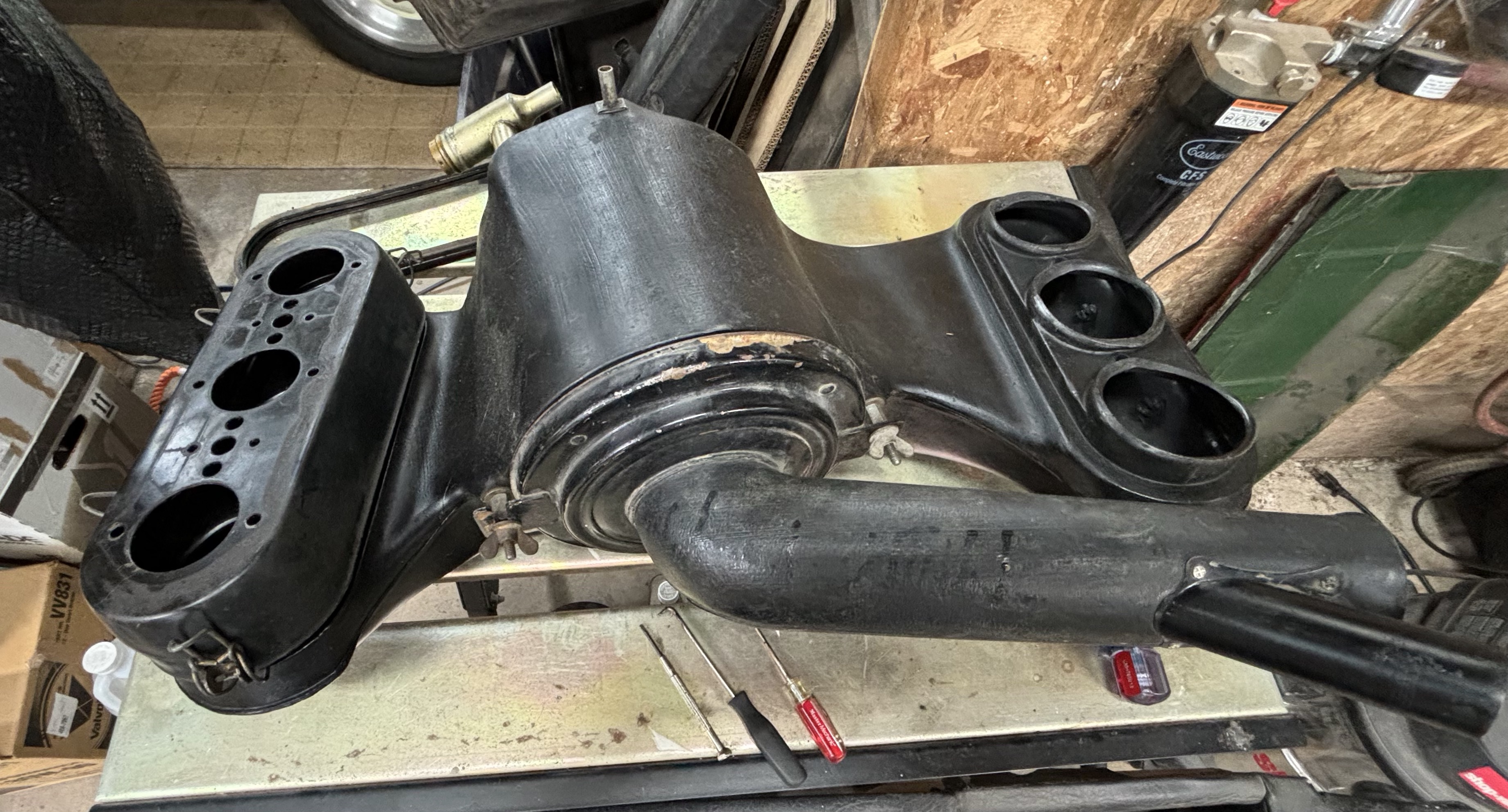

Added pics of a plastic MFI housing.

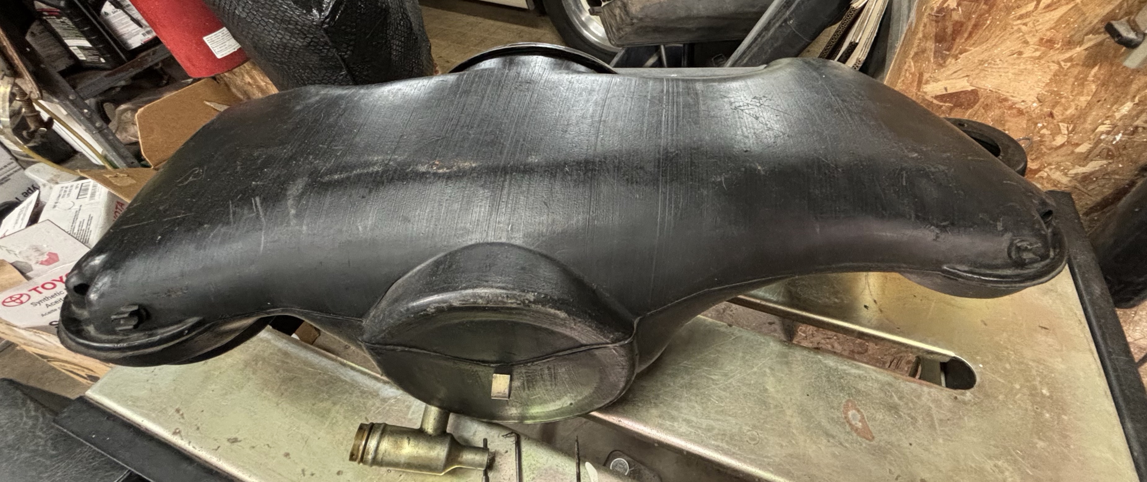

rgalla9146
And one more.
I hope this helps.
And congratulations, that's a 914 6 housing.

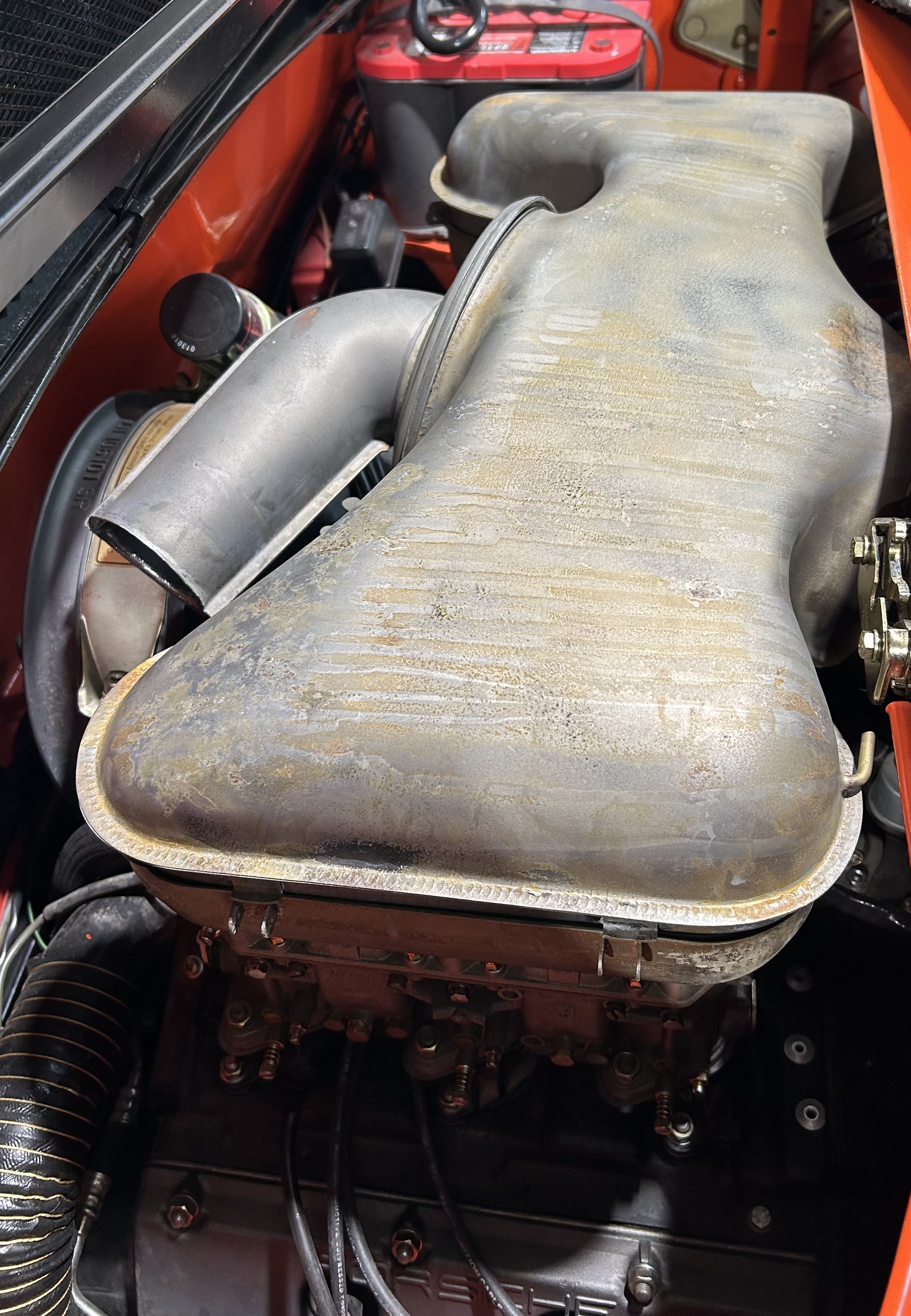

mb911
You can see how I had to modify mine to clear everything but this is a 911 unitClick to view attachment

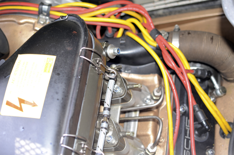

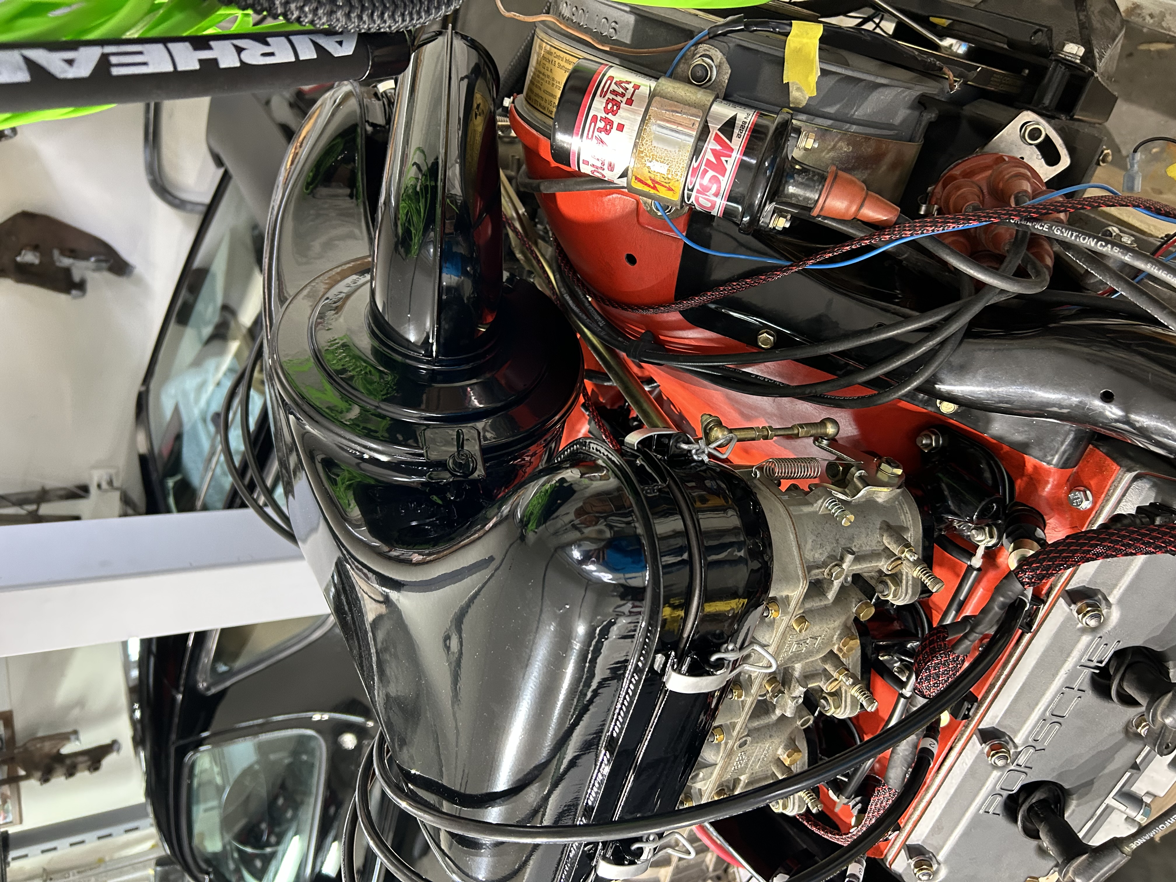

zulu33
Hi Matt,
it looks good. Maybe it's just put together wrong. You need the long clips. I use a plastic box with carburetor/ 2,2MFI base. Cheers Dirk
Click to view attachment Click to view attachment
