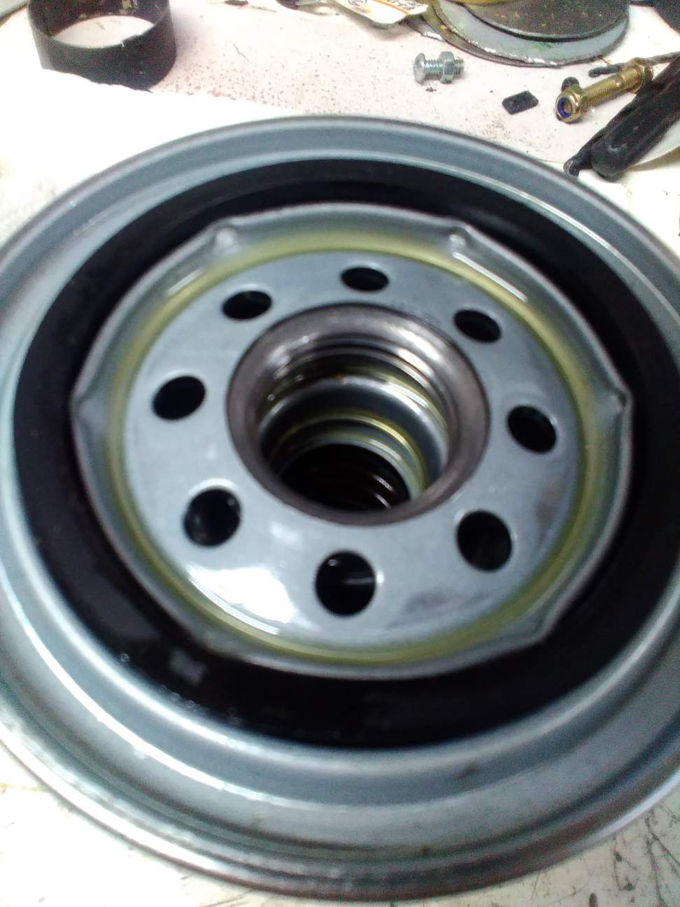

Me too, this was about an hour of run time on a brand new fresh build, think $$$. I hired the engine build as I have never done a /6 before. Many /4's and V8's and tractors
Had about a tea spoon full.
Looking back, I probably should have known better, being an old guy and I now see the amount of details to do this sort of build.
I will get a pic tomorrow. It appears there is a valve that normally sits at the bottom of the filter, the failed unit has the valve at the top (IMG:style_emoticons/default/idea.gif)

Attached Image No good
Appears some sort of valve has found it's way to the top, and blocks oil flow. Will get a shot of a good one later
