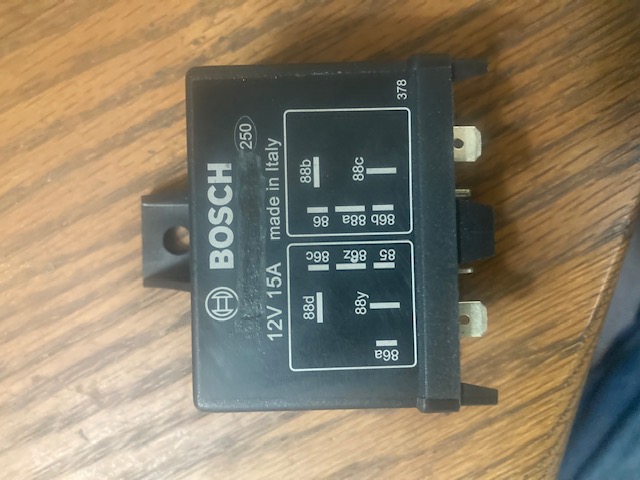

I found the relay locally through a VW parts store.
I found it odd that the part number had been ground off, apparently for another L-jet application but plugged in and the car operated as it should.

QUOTE(Artfrombama @ May 16 2024, 08:44 PM) *
You have an actual brick and mortar VW parts store near you in Alabama? That's awesome. The last local store in the Bay Area shut down a few years back and I have to get everything for my Beetle and my Ghia from on-line suppliers.
I believe the part number got removed because it had an alternate part number printed on it and they simply re-boxed it or put a new sticker on the box. Nothing nefarious about it, I think it is just done to avoid confusion (IMG:style_emoticons/default/confused24.gif) .

QUOTE(fiacra @ May 15 2024, 10:53 AM) *
This was initially posted in the FS/WTB forum as a WTB ad but I think it now more properly belongs in the Garage forum. Those of us with an LJet car with the original FI know that this NLA Bosch relay #0332514120 is a weak point in the system. If it fails, you are dead in the water, and eventually it will fail. At the moment the only sources I have found are AA and one eBay seller. The pre-tax/shipping price from AA is $325 and on Ebay it is $459.99 (unbelievably it appears they have sold a few at that price). It took a fair amount of time exploring the back alleys of the internet but I finally found a source for this Bosch relay using a cross referenced part number. It is a foreign supplier with back stock. Once that is gone they won't have any more. I ordered one just to make sure it was identical, and it is. I'll test it in my car sometime in the next few days, but I see no reason why it won't work (update: tested and working perfectly). I can order enough to pass on if people are interested.
Would you mind posting a photo or possibly the alternate part number?

QUOTE(Artfrombama @ May 19 2024, 10:10 PM) *
I put some photos up in the thread in the classifieds.
http://www.914world.com/bbs2/index.php?showtopic=369867
