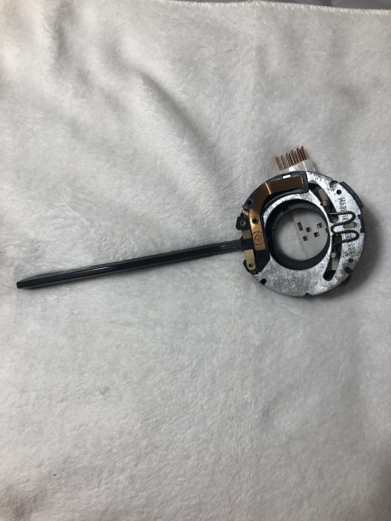

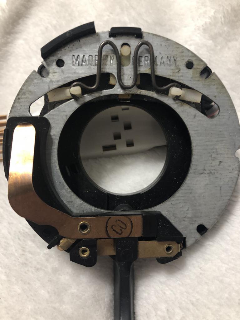

I have a NOS SWF replacement. Not cheap but the real deal.

QUOTE(914Sixer @ May 27 2024, 10:38 PM) *
Looks nice. I'd like to find an aftermarket one ... considering the price of most NOS parts. And my car is bit of a rescue.

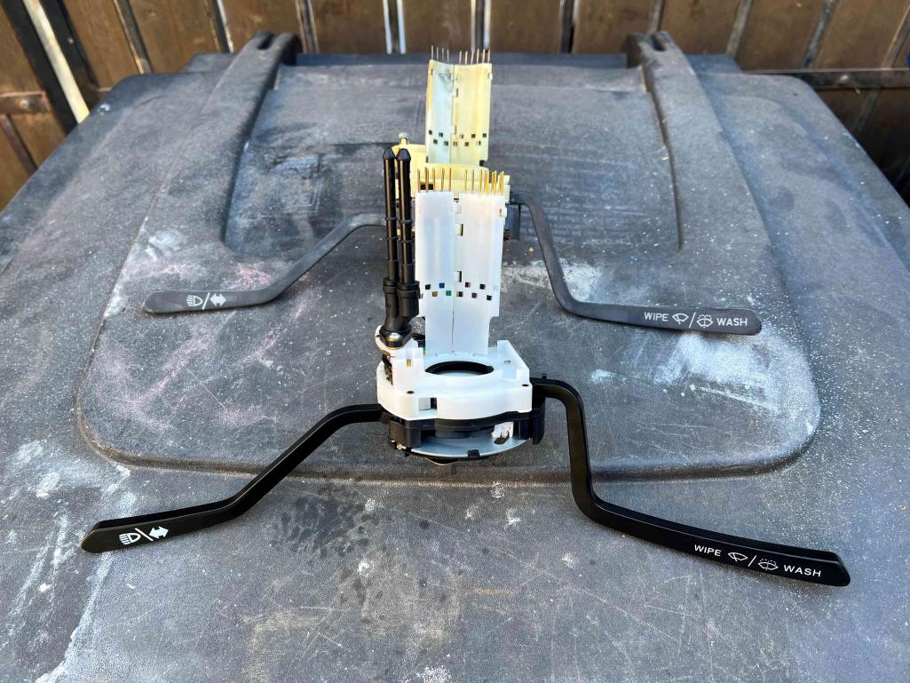

I ordered mine from JBugs. There are two versions though...had to order both to figure out the correct one - one extra connector on the first one I got. Physically would not fit into the column opening.
https://www.jbugs.com/product/111953519H.html
Here's a pick comparing the Jbugs levers/switches with the originals:
Hope that helps! (IMG:style_emoticons/default/popcorn[1].gif)
