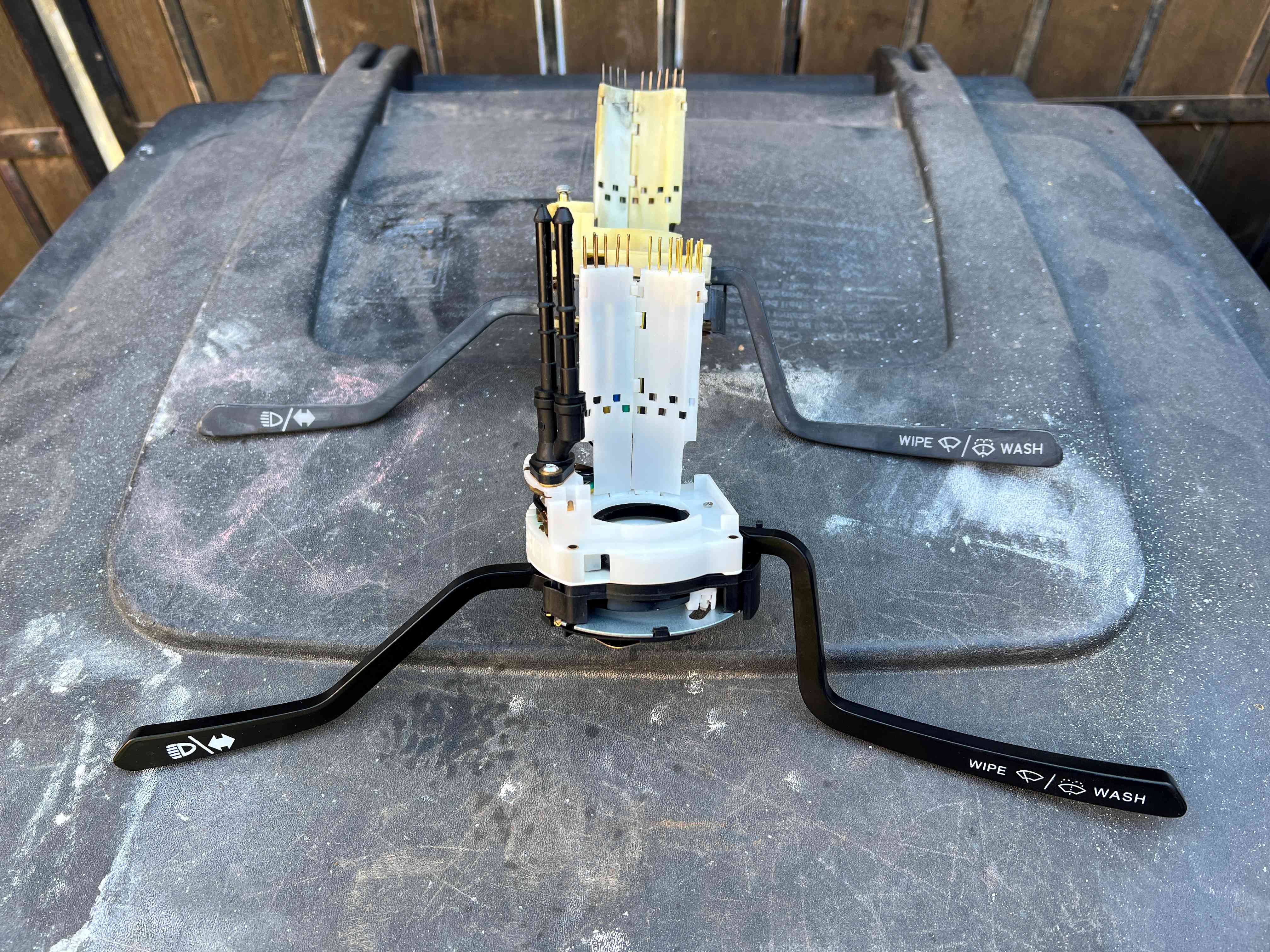

I ordered mine from JBugs. There are two versions though...had to order both to figure out the correct one - one extra connector on the first one I got. Physically would not fit into the column opening.
https://www.jbugs.com/product/111953519H.html
Here's a pick comparing the Jbugs levers/switches with the originals:
