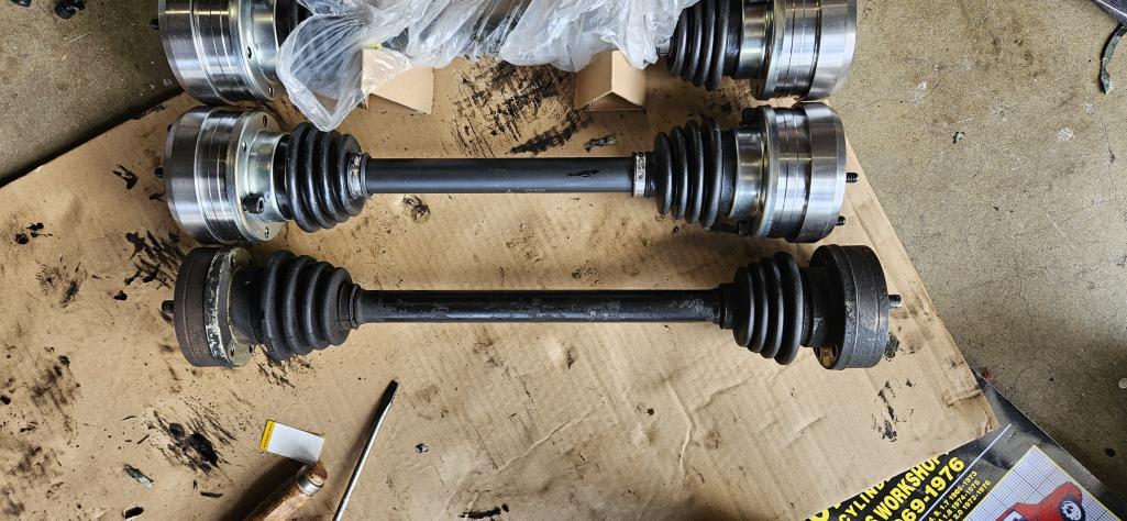

I bought some HP Axles for my 1975 914 from Tarrett Engineering. I believe these are the ones Renegade use for their cars.
When I went to put them on though, I noticed that they were significantly shorter, even with the spacers on both ends. Anyone else have this issue?
I haven't tried installing yet but wanted to make sure it will work because it looks like it won't.

Are the CV joints fully extended on both sets of axles?
Call Tarrett.

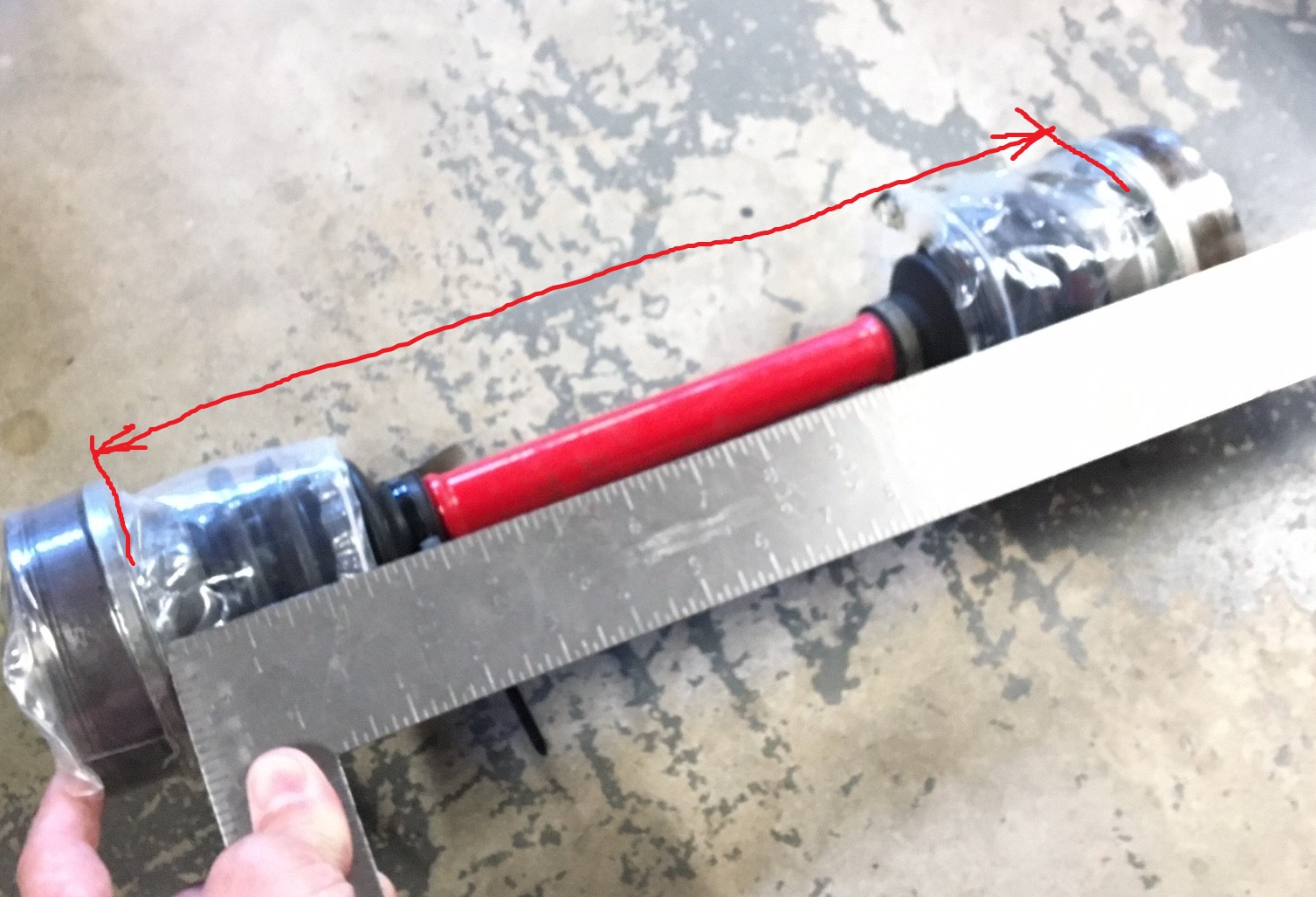

I have a set of those axle. Currently the spacers are removed but I will try to do two measurements; extended and compressed and post here later today. My shafts are red.
BTW, those Tarret Engineering axles are actually using Loebro VW bus CVs PN 301137. These CVs are 100mm x 32mm with 33 splines. Adaptors are obviously custom machined and I don't know if the shafts are standard VW bus. It surely would make the whole thing easy to put together from available components if it was. I don't have a bus shaft on hand but I would be curious to compare the lengths. (IMG:style_emoticons/default/idea.gif)

Measured from inside to inside:
Pushed in: ~15"
Extended: ~16 3/4"
Hope this helps! (IMG:style_emoticons/default/smile.gif)

According to the boots, the left side of the 914 axle is extended.
Yes, bus axles.

To the OP: Not sure why but your shafts seem different (other than color). There doesn't seem to be any locating humps on them to set the small end of the boot. (IMG:style_emoticons/default/confused24.gif)
