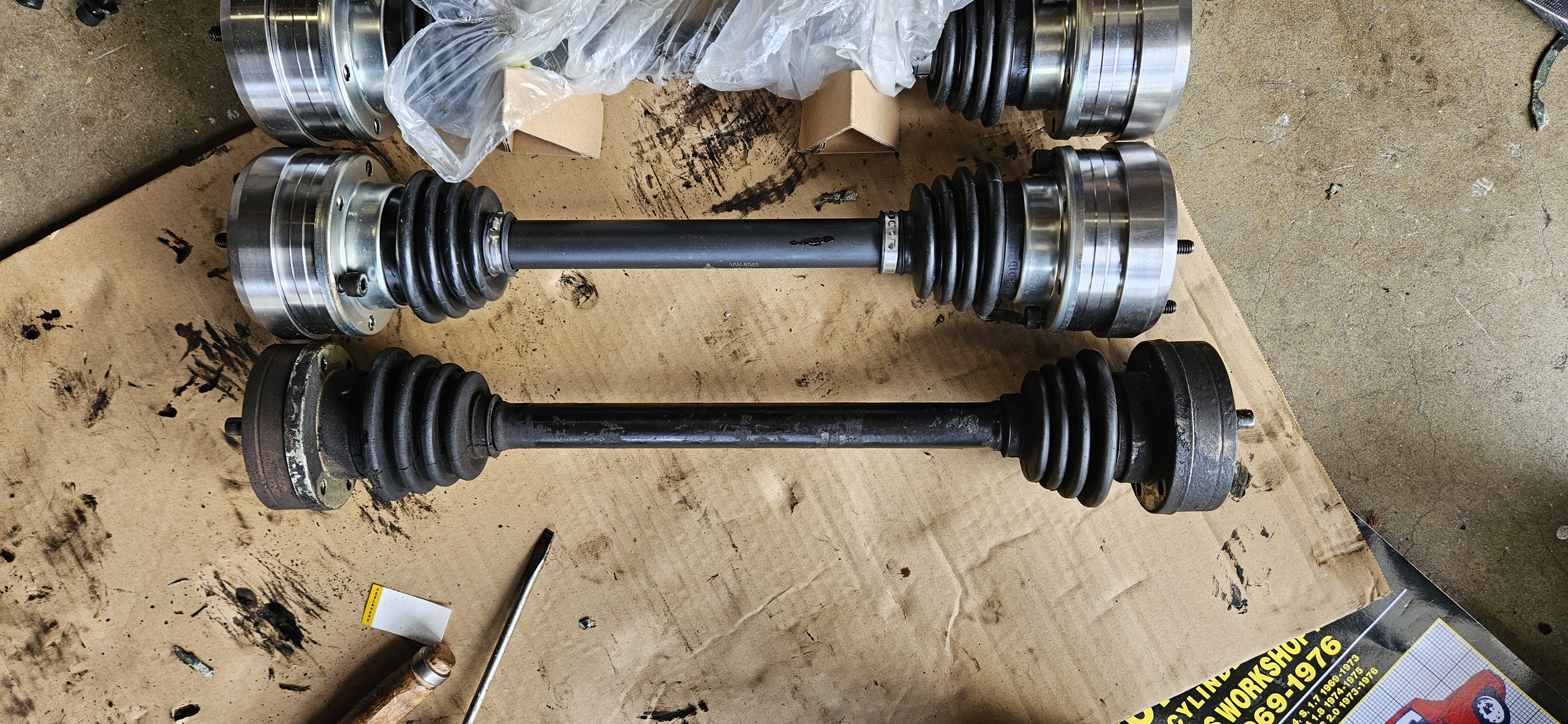

I bought some HP Axles for my 1975 914 from Tarrett Engineering. I believe these are the ones Renegade use for their cars.
When I went to put them on though, I noticed that they were significantly shorter, even with the spacers on both ends. Anyone else have this issue?
I haven't tried installing yet but wanted to make sure it will work because it looks like it won't.
Click to view attachment Click to view attachment

Are the CV joints fully extended on both sets of axles?
Call Tarrett.

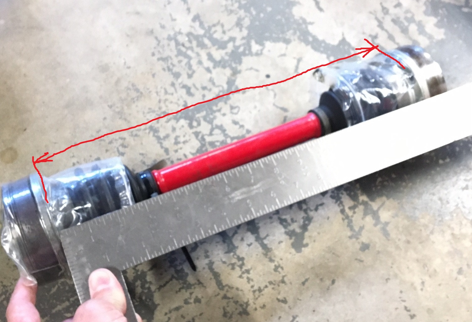

I have a set of those axle. Currently the spacers are removed but I will try to do two measurements; extended and compressed and post here later today. My shafts are red.
BTW, those Tarret Engineering axles are actually using Loebro VW bus CVs PN 301137. These CVs are 100mm x 32mm with 33 splines. Adaptors are obviously custom machined and I don't know if the shafts are standard VW bus. It surely would make the whole thing easy to put together from available components if it was. I don't have a bus shaft on hand but I would be curious to compare the lengths. idea.gif
Montreal914
Measured from inside to inside:
Pushed in: ~15"
Extended: ~16 3/4"

According to the boots, the left side of the 914 axle is extended.
Yes, bus axles.

To the OP: Not sure why but your shafts seem different (other than color). There doesn't seem to be any locating humps on them to set the small end of the boot. confused24.gif
