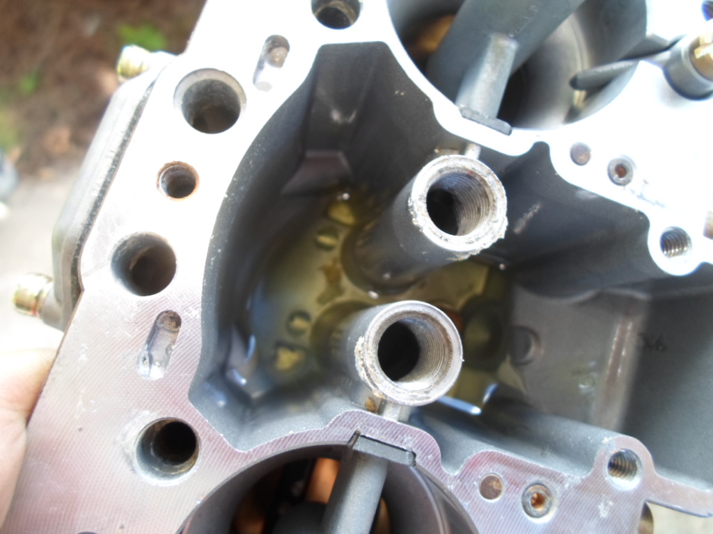

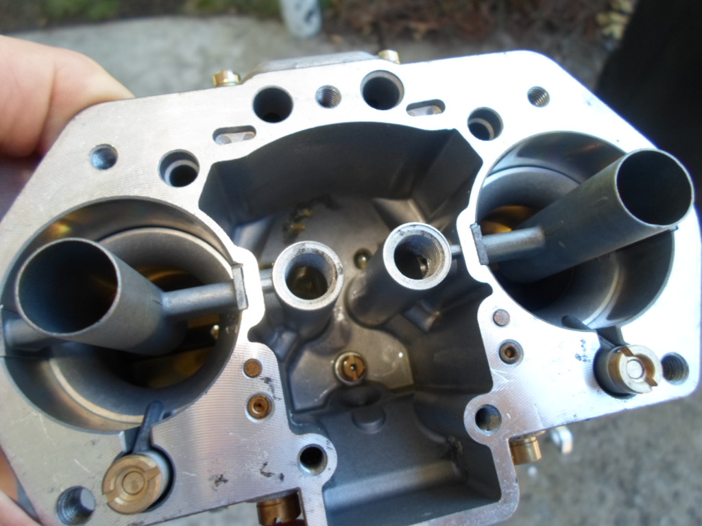

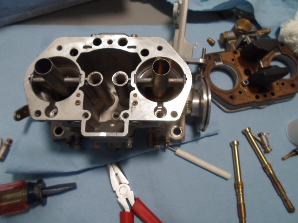

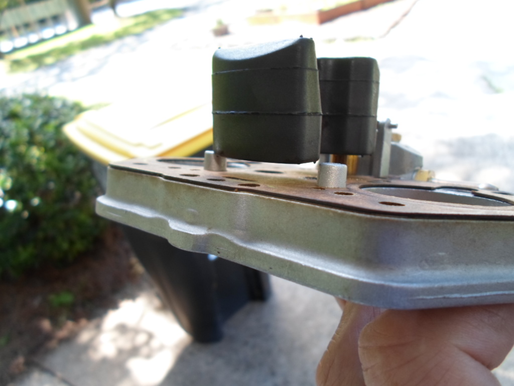

So last time I posted, I had a suspicion that my fuel pump or filter were not working correctly, as my pressure was dropping and the car was bogging down. I SHOULD HAVE stuck to my gut and started troubleshooting the pump first. That said, I wanted to maintenance the inside of these carbs because I had never opened them.
I took them both off today, dissembled most of the important parts, cleaned out the all the jets and circuits as best as possible and added new gaskets. I did find some junk in both bowls and I've tried to include some pics. Also, I have never adjusted the floats, so I adjusted them "closed" at roughly 12mm and "open" at between 23 & 25. The floats themselves looked great, but they were probably at around 6-8mm at the closed setting. Not sure how much difference that makes or if anybody has different numbers to shoot for?
Anyways, put it all back together and car won't start at all now. I didn't have time to troubleshoot much after that, but it doesn't look like it's getting much, if any fuel....leading me back to my original suspicion. That said, I feel better about the carbs having been cleaned and floats adjusted.
In the next day or so I'll check the flow to the "t" and get some voltage measurements to the pump. I do hear the pump kick on, but it doesn't sound as loud as normal.

You did have some nastiness.
Looks like a goober in the top of the chamber in the first picture.
Some crustiness on the main well tubes in another.
I'd have put a few ounces of fuel in the bowls to test/flush out the accelerator pump circuits.
The carb bodies look NICE, however.
They needed to be "poor boy" rebuilt now.
Is the picture of the floats with your new adjustment?
Something I've noticed over the years is when the floats are right the parallel lines/surfaces are also parallel to the top plate. This is on almost everything, not just Webers.
It looks like the outer float is a little bit bent downwards (high level) but picture angle may be playing a part.
If "12" is pictured, then 6-8 would have been a significantly higher fuel level in the bowl.
Tuning/jets might change
Did it run rich?
Too high a fuel level in the bowl tends to make things rich.
Get an 8oz container with a squirt top and dump 2 oz of fuel into each carb through the bowl vent. It should run then.
I'd run a bunch of fuel through the pump/lines looking for trash in it.

Just set the float level on IDF carbs. 12mm was too much and caused the fuel to leak out the carb top/vent. 10mm seems to be the "goldilocks" amount, just right.
So, suggest you check the floats for straightness/twist... Should be even/level for both front to back and side to side. If not, the float might catch on the inside of the carb or not "float" at the correct level.
