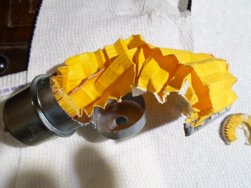

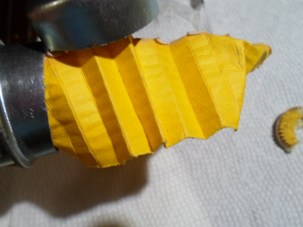

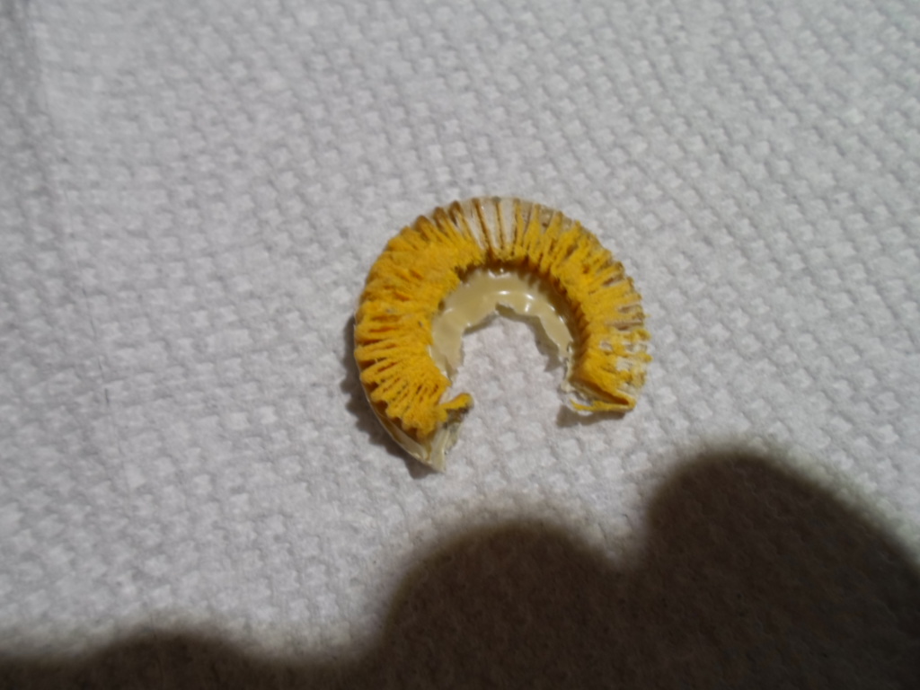

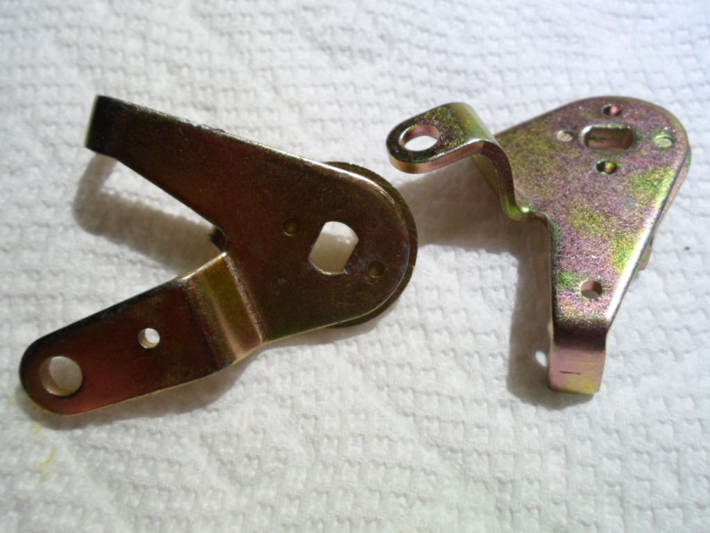

Thanks for the reply. I'm fairly sure it's not a flow issue from tank or pump(at least not any more). At one point in my troubleshooting I removed the main fuel supply line from the "t" and set it into an empty gallon container...then turned on the pump....it was flowing freely. Also the tank and sock have probably less than 100 miles on them. I did remove and clean the inlet strainers as well.
Another thing I did today was cut the old filter open with a sawzall. I have attached a couple pics of "the innards". I'm no expert on fuel filter autopsies, but, to me, it looked pretty clean.....as if "crud" coming from the tank wasn't the probable issue... which stands to reason as the tank is almost brand new.(although the cross section piece in pic #3 might be a little suspect??)
For now, I'm going to replace the worn throttle lever(not sure I'm using the right terminology, but I've attached a pic) and finish tuning the carbs again.....this time using very small increments on each adjustment.
Fuel Filter Autopsy Pics:
Throttle lever replacements parts:

I’m with ya’, that filter media looks fine. No obstruction there.
Agree - resync carefully. synchronized carbs make a big difference in smoothness.

(IMG:style_emoticons/default/agree.gif) The media appears mostly clean, free from debris. Having your carbs synchronized is very important.
