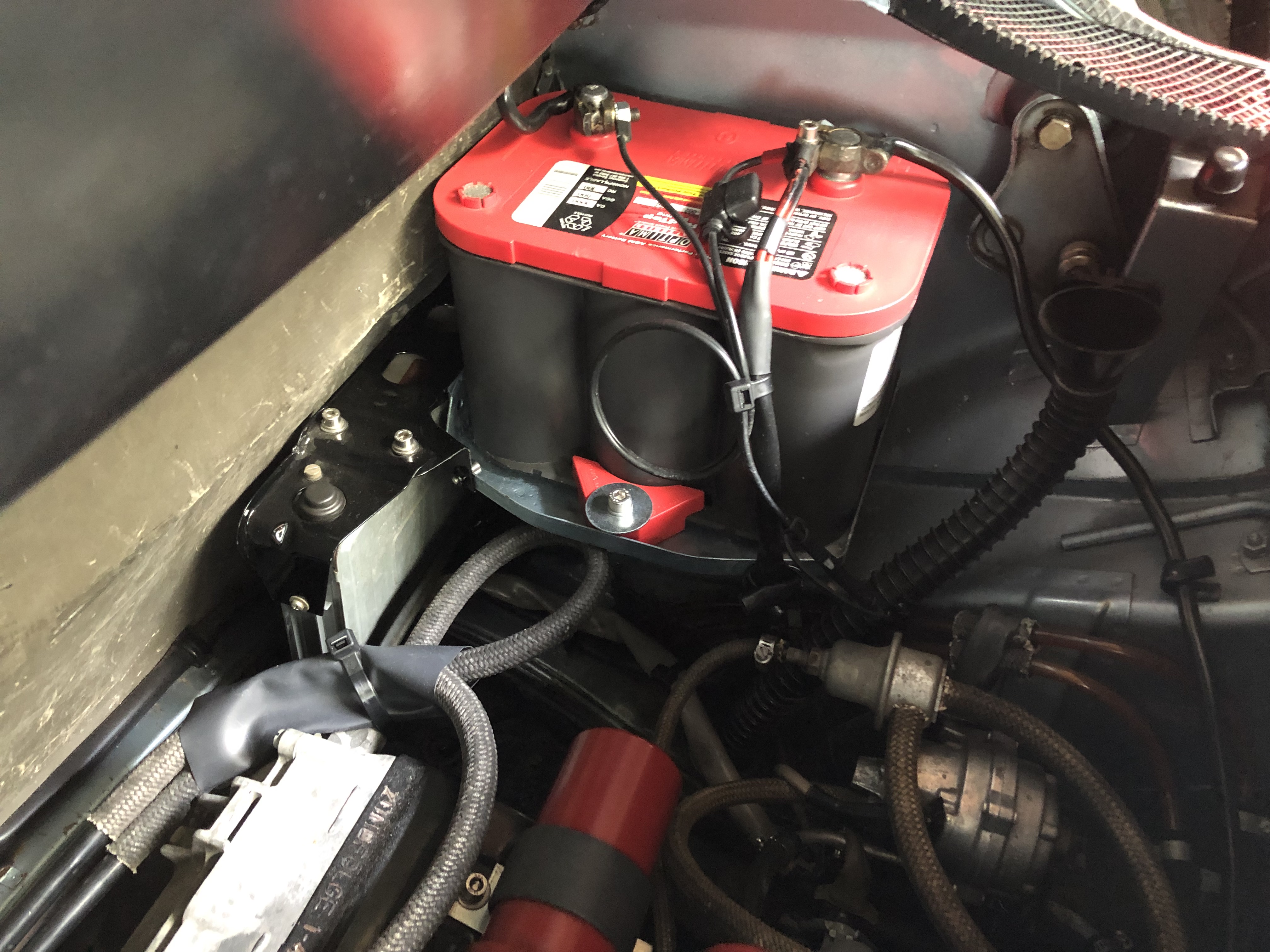

This one was purchased in 2008. I cooked the first one from 2007 when I shorted the terminals. Optima replaced it for free.
Whenever I put a flat washer on plastic, I install it burr side up. I do the opposite for metal to minimize lateral slippage. And it's burr side down with a lock washer. The flat(s) on the lock washer go burr side down too.

The fewer the parts the better from a reliability point of view. This is especially the case if the battery gets wet. Besides, the location of a heavy battery helps to balance the load of the driver. Pick your poison. BTW, my Optima rig only gets connected to a tender in the winter time & even if I forget to do this, the car starts up flawlessly. This battery is a "Die Hard" like Sears used to sell. BTDT with the VWs.

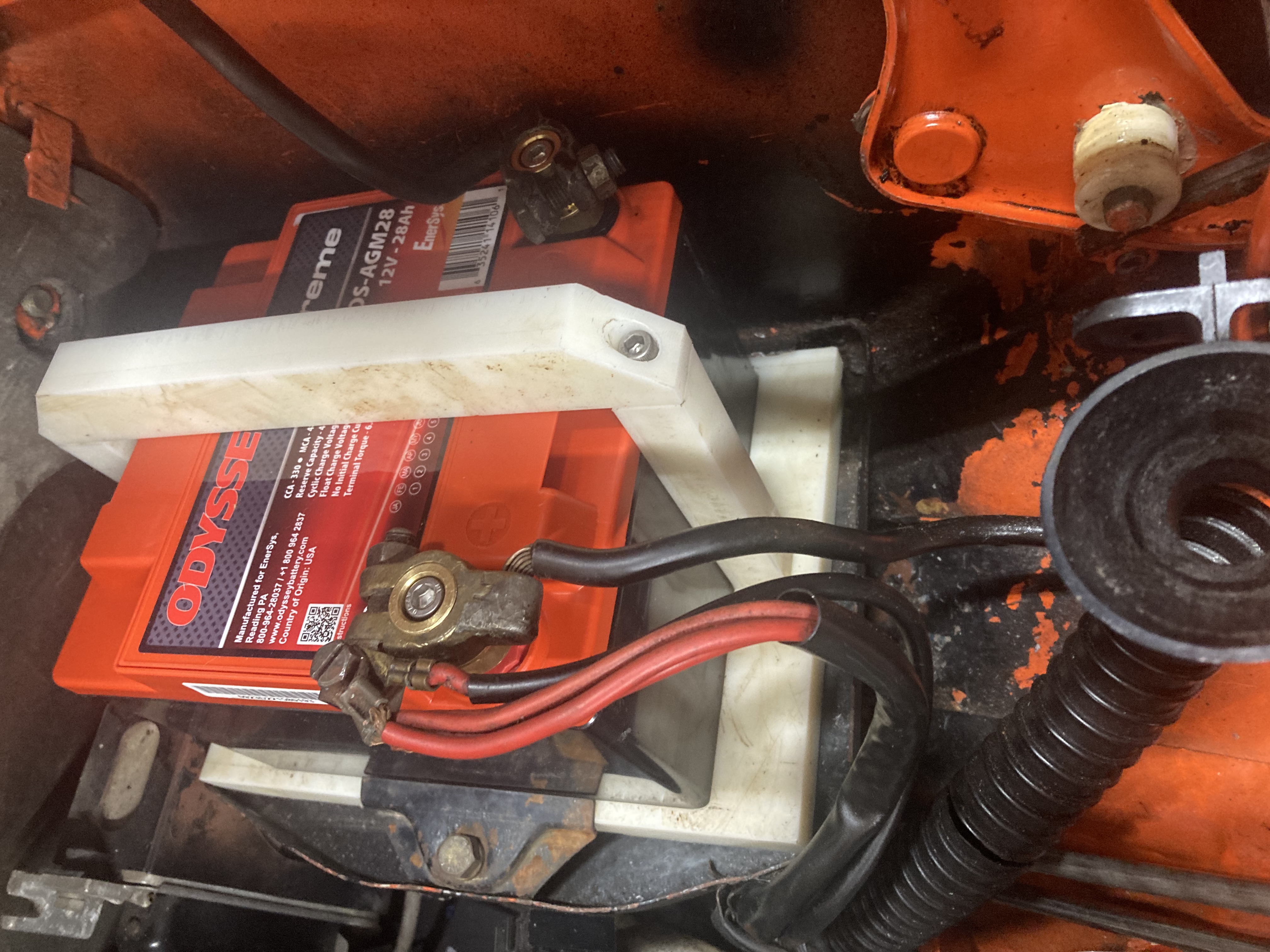

IIRC I got it on eBay. Pictures below. It fits perfectly into the stock battery tray but you cannot use the stock battery hold down. However it is such a tight fit that the battery can't move, unless you roll the car. If you know anyone with metal fabrication skills they probably could easily modify this to fit the stock hold down (IMG:style_emoticons/default/biggrin.gif)

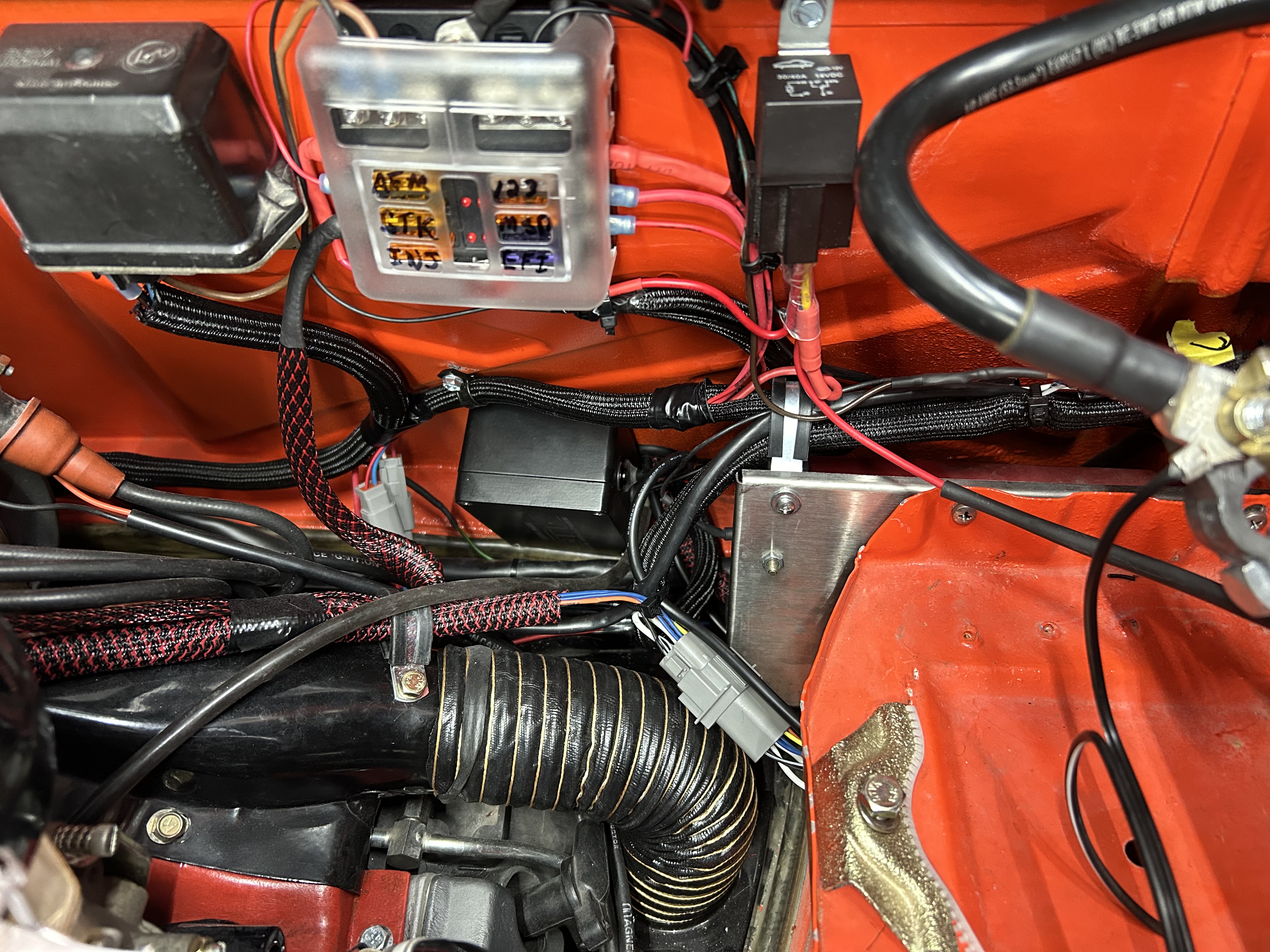

To give you all an idea. I will make sure the wiring is cleanAttached Image

Nice job Ben, talk about clean and organized. The best I've seen. Mark
