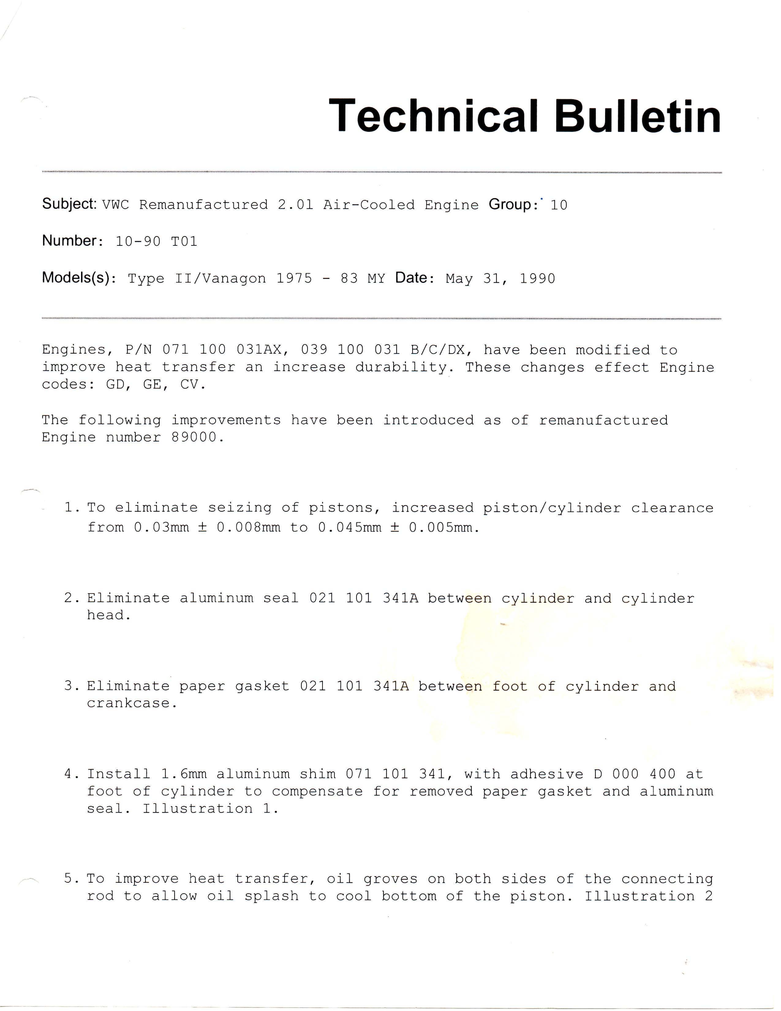

QUOTE(914werke @ Jun 16 2024, 04:49 PM) *
(& blessed by the manufacture)
I still want to see the Porsche documentation that says to do this. The only thing I can find is a VW tech bulletin that does NOT cover a 914/4 engine.

QUOTE(emerygt350 @ Jun 17 2024, 06:36 AM) *
QUOTE(torakki @ Jun 15 2024, 11:10 AM) *
I've read where it's a good idea to remove the head gaskets and re-assemble without them. Something about, they crush and cause an issue. Is there anything else you need to do or change, in their place? Like a different head design?
Thanks
Here is an old thread with the bulletin and some pretty good points made.
http://www.914world.com/bbs2/lofiversion/i...hp?t215407.html
Still having the same argument over a decade later.
QUOTE(Cap'n Krusty @ Jul 24 2013, 01:15 PM) *
Will this bullshit misinformation NEVER end? The Tech document refers ONLY to the revised 2 liter heads. Period. Perpetuating misinformation does no one any good.
The Cap'n
The listed thread makes the same point I have been trying to make. The tech bulletin does not apply to the 914 engine. The tech bulletin applies to the engines with the revised head design.
The key words here are "REVISED HEAD DESIGN". The 914 motor does not have it.

QUOTE(ClayPerrine @ Jun 17 2024, 08:05 AM) *
I've read where it's a good idea to remove the head gaskets and re-assemble without them. Something about, they crush and cause an issue. Is there anything else you need to do or change, in their place? Like a different head design? Thanks
Will this bullshit misinformation NEVER end? The Tech document refers ONLY to the revised 2 liter heads. Period. Perpetuating misinformation does no one any good. The Cap'n
The listed thread makes the same point I have been trying to make. The tech bulletin does not apply to the 914 engine. The tech bulletin applies to the engines with the revised head design. The key words here are "REVISED HEAD DESIGN". The 914 motor does not have it.
Does not have what? with all due respect to John.
Sorry Clay but you are making a specious argument. First no one will argue (I think (IMG:style_emoticons/default/blink.gif)) that the T4 motor is a VW design & that Porsche's contributions to it related to the 914 centered around the 2.0L & redesign of its heads.
Arguing the VW bulletin cited isn't applicable may be splitting the finest of hairs.
Perhaps you can define what you think the specific features are that differentiate the "Porsche" vs the "Volkswagen" versions described in that bulletin, and how they are germane to this discussion about the use of compressible multilayer metal head gaskets?

Look. . this is real simple. Do what you want with your engine.
But please READ the tech bulletin in detail. It specifically mentions only the later Vanagon engines by type. It does not apply to ALL type IV engines.

Pardon my lack of knowledge in this area, but what specifically changed with the later T4 heads? Obviously there are some differences between the 1.7, 1.8, VW 2.0 and 914 2.0 heads but I did not realize there were changes from earlier to later versions.
In my vast knowledge and experience rebuilding VW motors (a whopping 1 T1 motor and 1 T4 motor (IMG:style_emoticons/default/laugh.gif) ) I have taken this to be ubiquitous to take the head gaskets out on all T4 heads. Based on the VW bulletin and Jake Raby's suggestion. I have heard of doing metal o-rings with a groove cut in either the cylinder or head for it for super high performance engines. That is a whole different ball game though.
I am not trying to argue either way, but would like to learn more from both schools of thought. To my line of thinking, it would logically make sense that it would apply to all T4 motors. They are all basically the same, and how much of a difference can a head redesign really make? Perhaps though it is just the extra heat and load from the breadboxes on wheels that was the primary cause of the issue?

Not wanting to enter a debate that clearly needs an Ecumenical Council to resolve, I would point out the following:
The document, written in 1990 is stating that these changes have been introduced as improvements to their remanufactured engine program. "The following improvements have been introduced as of remanufactured Engine number 89000". It is information applicable to a certain year range of Vanagons, but is silent on all other models. This doesn't mean that it is not applicable to other models with type 4 engines. But generally, it is not wise to offer recommendations on changes to other complex systems unless you are reasonably sure that the changes won't have some other effect not considered. Also, do we even know if, in 1990, there was a remanufactured 914 engine program?
I would not say that this bulletin was meant for all type 4 engines, but only for their remanufactured engines. That does not mean, however, that the changes may not be applicable to your particular engine.

I disagree. If you look at that tech bulletin, it clearly says "These changes effect Engine codes: GD, GE,CV."
None of those engines were used in the 914 at all.
Jake, you can do the required machine work to make it work without the gaskets. Ordinary guys working in their garage cannot do the precision work you do. They cannot machine heads with enough accuracy to be able to eliminate the gaskets. I would bet 98% of the professional machine shops out there cannot do the quality of work you do. The head gaskets are there to compensate for the less than dead nuts on machine work that comes from most shops.

Question:
The update states improvements were made but does not say what they were unless I missed it in my speed read. What was done to accommodate the change?
Superhawk996
post Jul 2 2024, 07:22 AM
Post #40
Posts: 8,156
Joined: 25-August 18
From: Woods of N. Idaho
Member No.: 22,428
QUOTE(rick 918-S @ Jul 2 2024, 08:54 AM) *
Question:
Re-read, the stated actions are the improvements.
