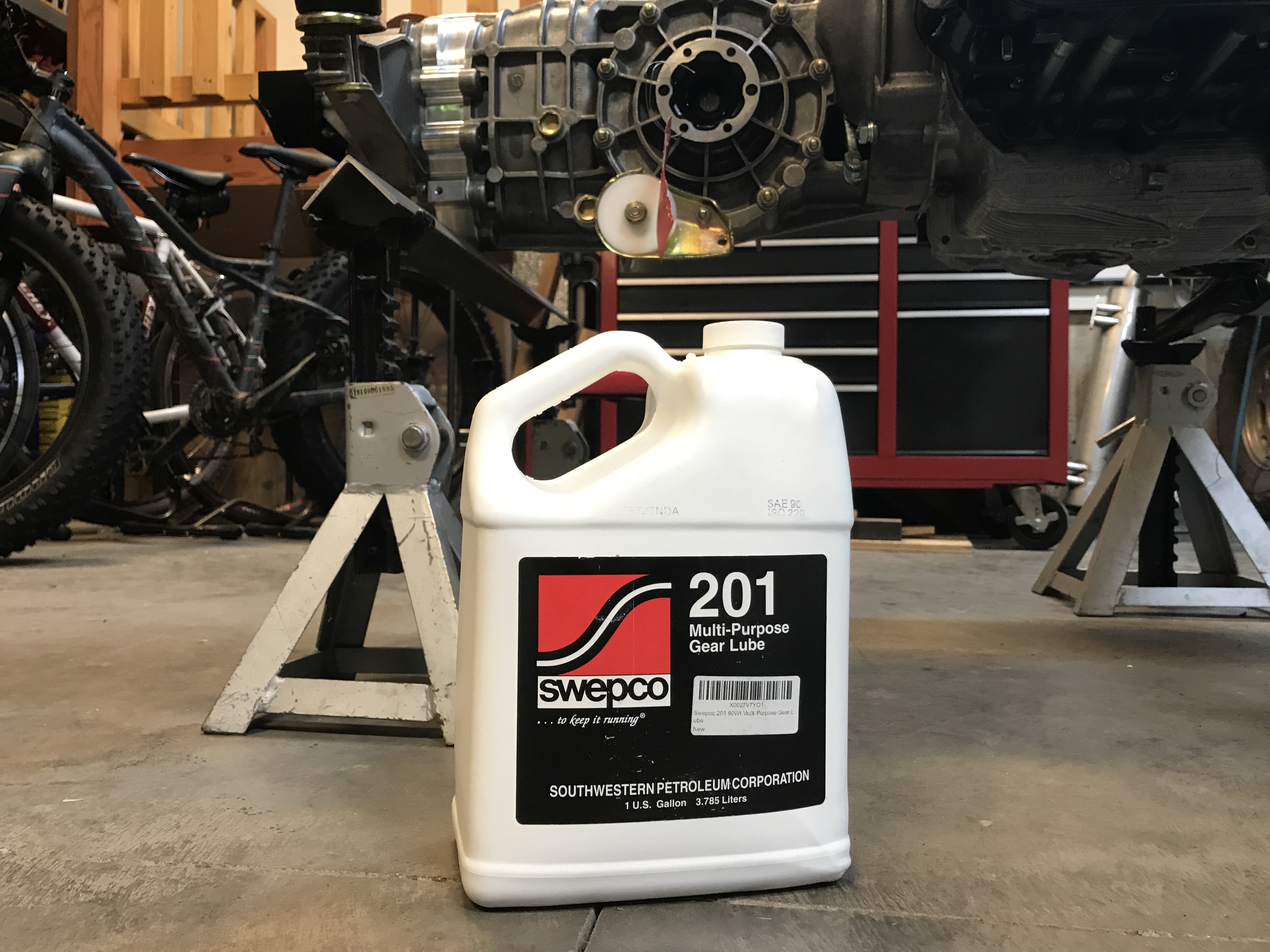

Based on the recommendation of CMS, who did the rebuild of my transaxle, I used Swepco 201. I figure they know what they are talking about.

Is that stuff blue in color? If so, I use the same stuff.
