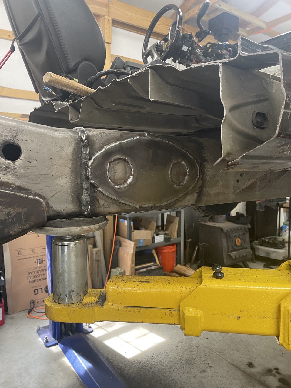

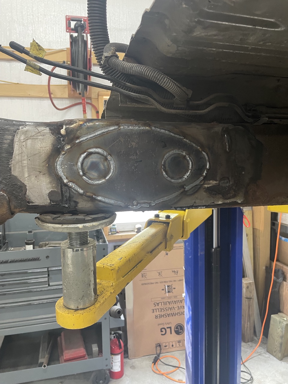

Welded in the fish plates. If this frame ever breaks, it won’t be here (IMG:style_emoticons/default/smile.gif)

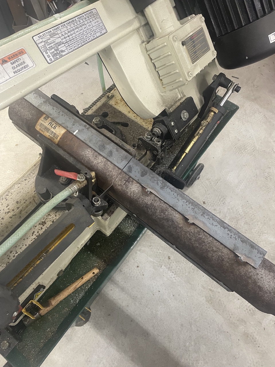

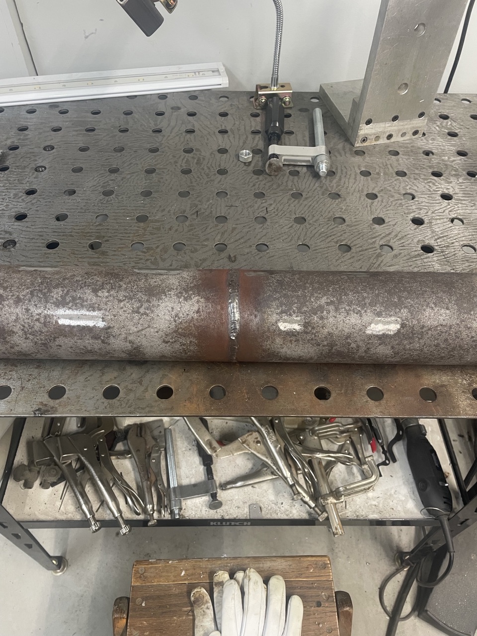

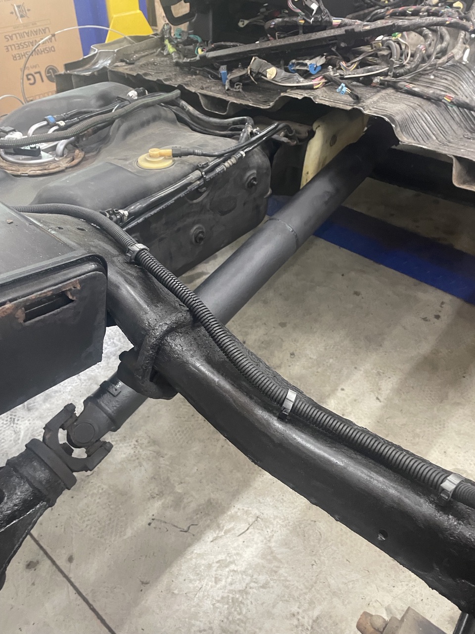

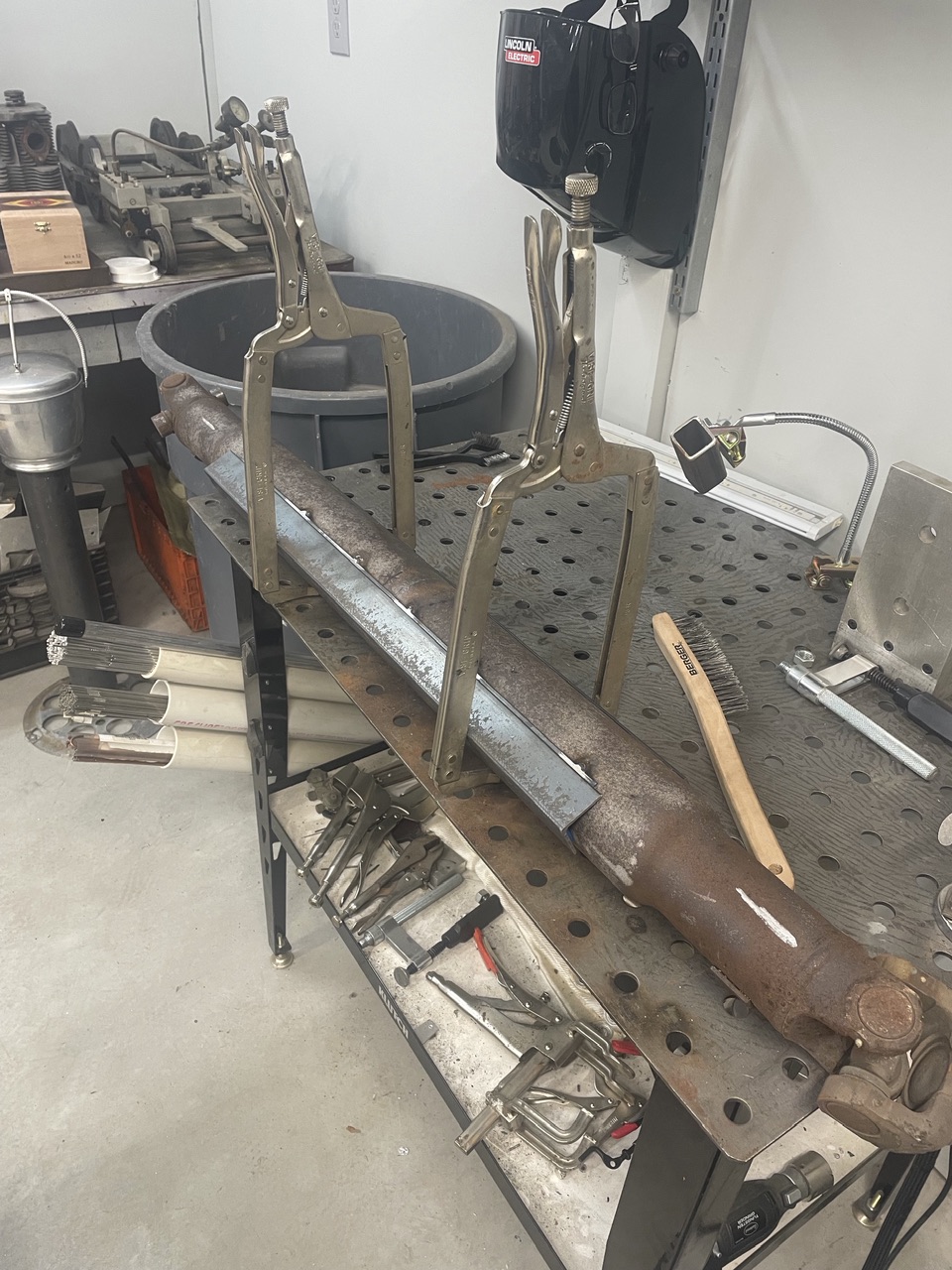

Todays fun was shortening the driveshaft. I tacked two pieces of angle 180 apart onto the stock driveshaft and then cut through the shaft and angle on my bandsaw. The angle will ensure the u-joints are correctly clocked and will help with keeping the shaft straight for welding.
After cutting a 12-1/2” section out, I clamped another piece of angle across the cut sections and welded it up.
I don’t know how much this effected the balance of the shaft but time will tell. If I have vibration at speed then I’ll get a shaft professionally made/balanced, but I wanted to try this first. I’m betting it works just fine.

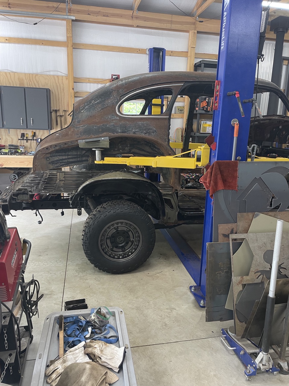

It’s getting real….

Points for creative use of the lift!

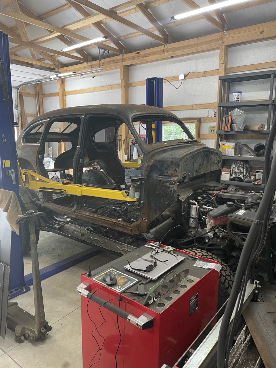

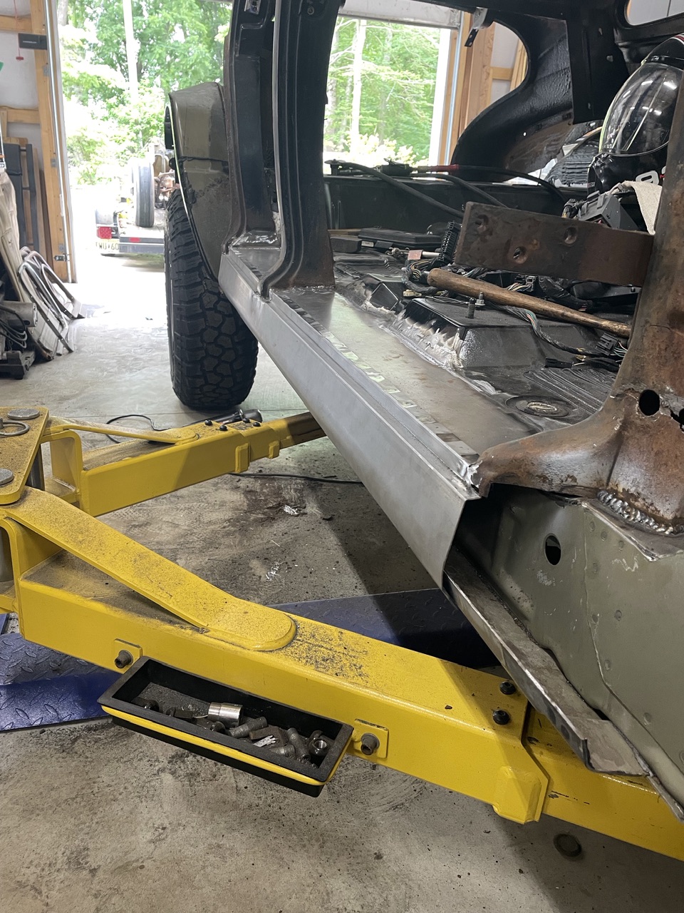

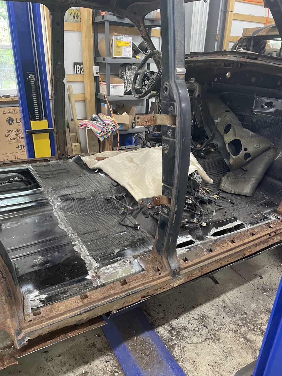

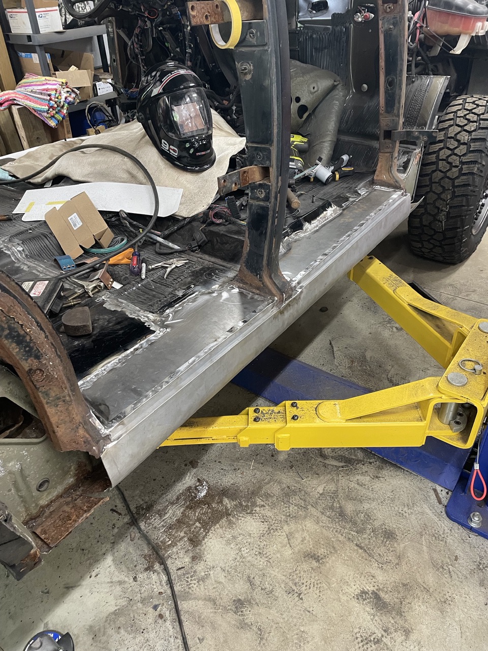

I’ve got the body on the chassis and it’s working out well so far. I welded the floor pan back together and started welding the body to the floor pan. Yesterday I made new sill plates to tie the 41 body to 08 floor pan, and made new rocker boxes…..it’s coming along.

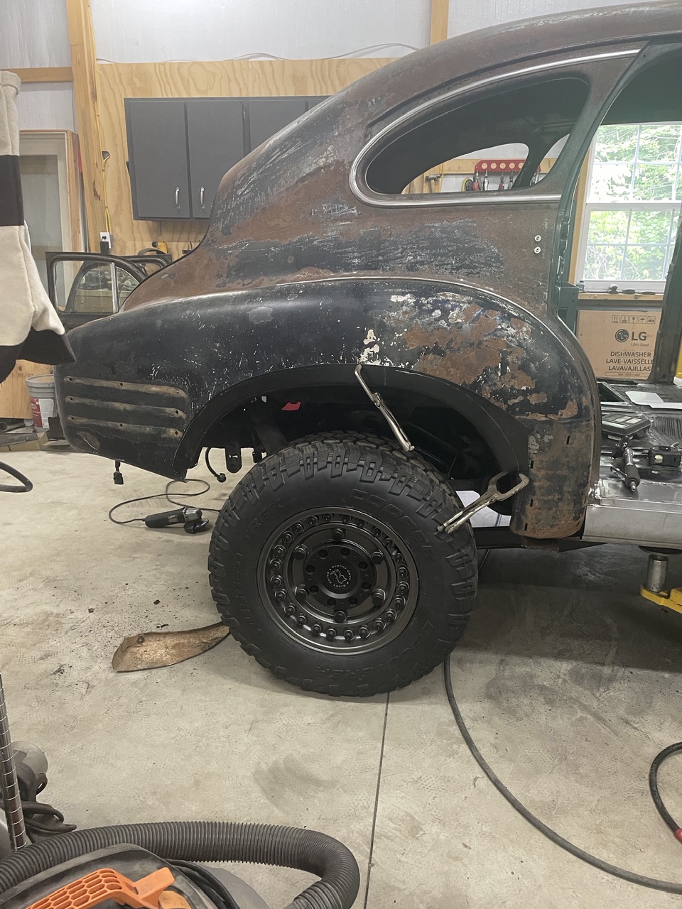

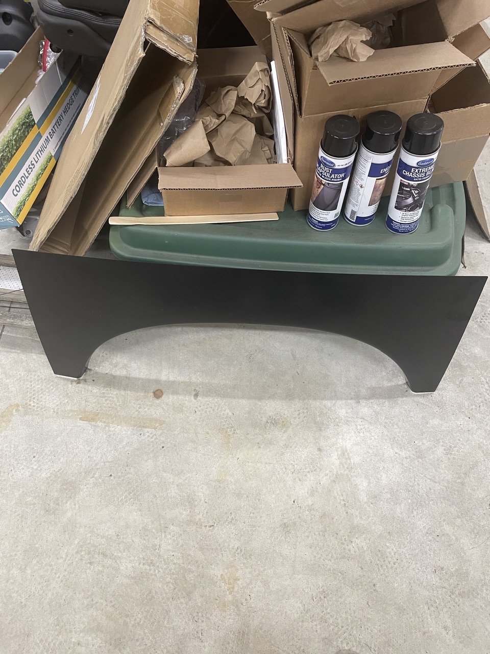

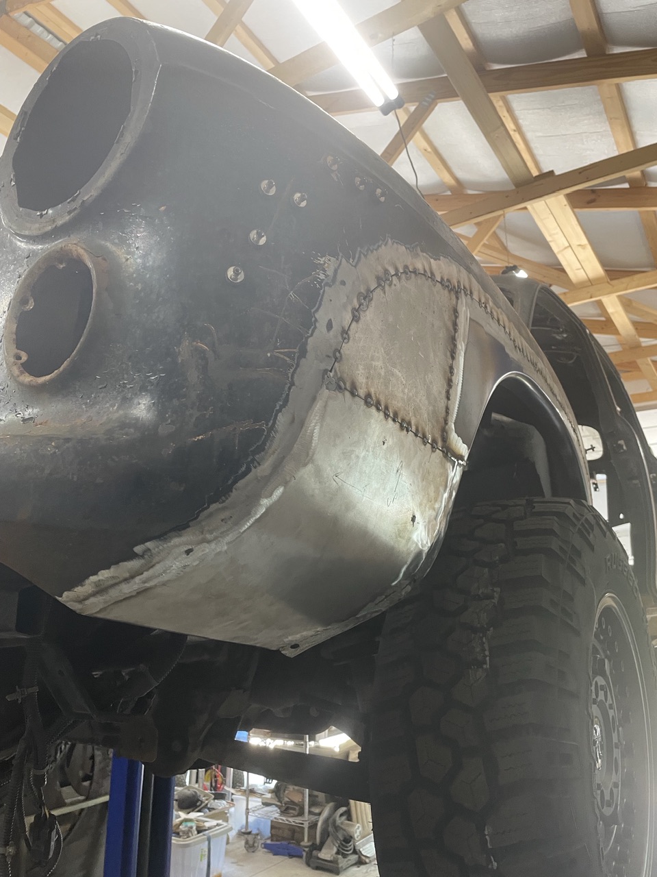

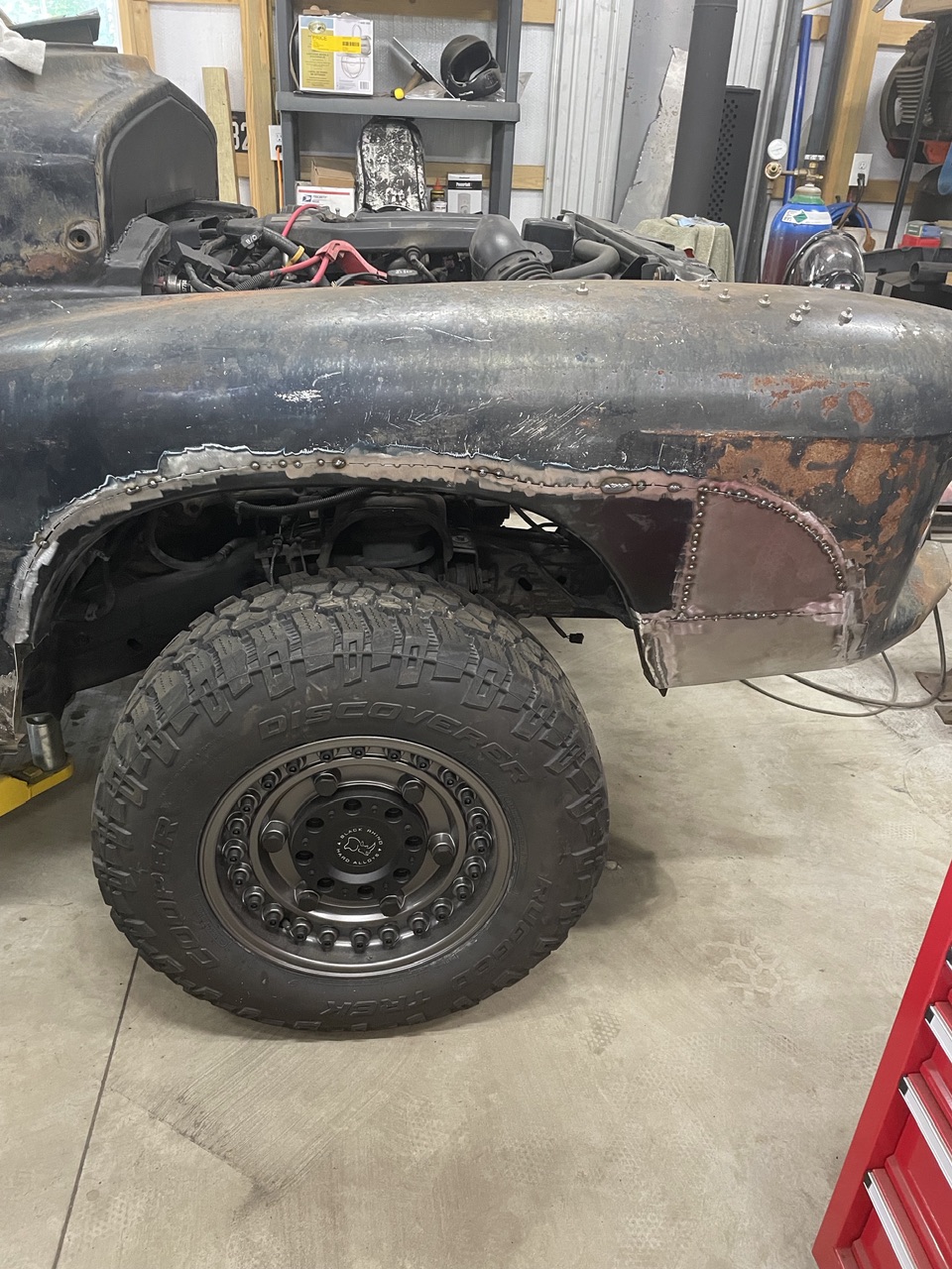

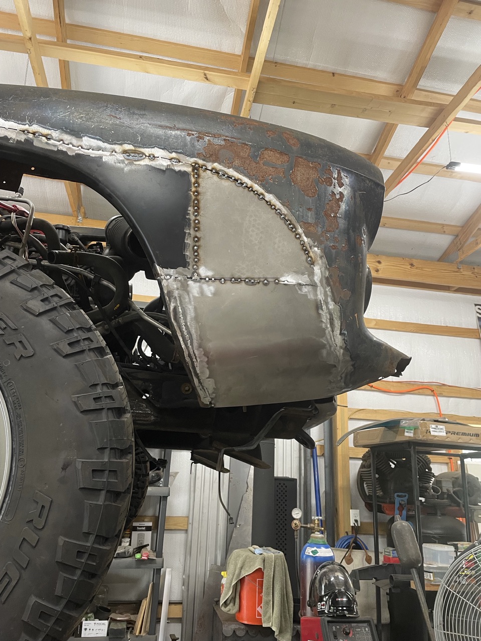

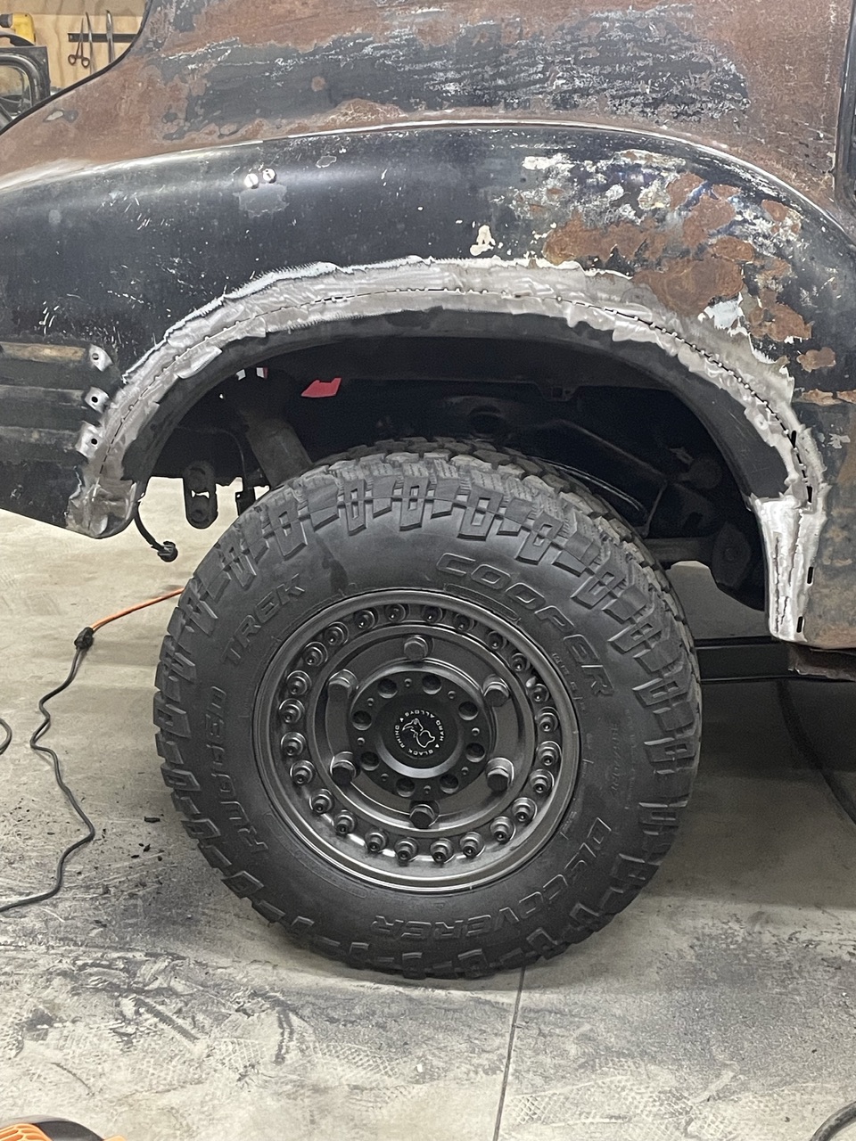

Made some rear fender mods. I had to make the opening larger and move it back a couple inches. I got fender repair panels for a 2004 Dodge pickup and used the lip to create the arch I wanted, then re-blended the lower fender from the Caddy. I need to finish weld them but think they’re going to look good.

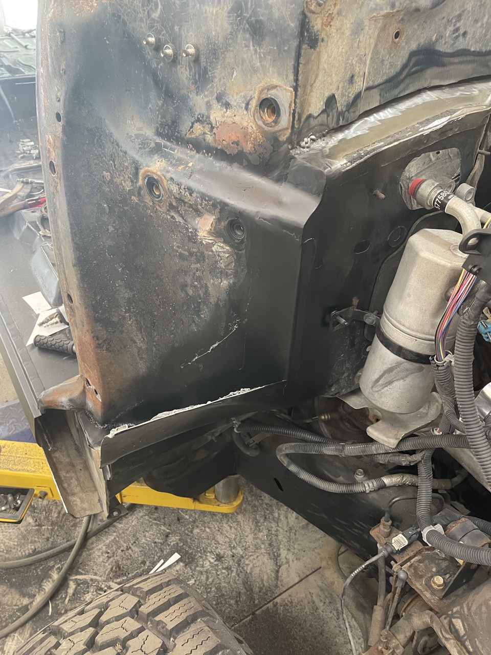

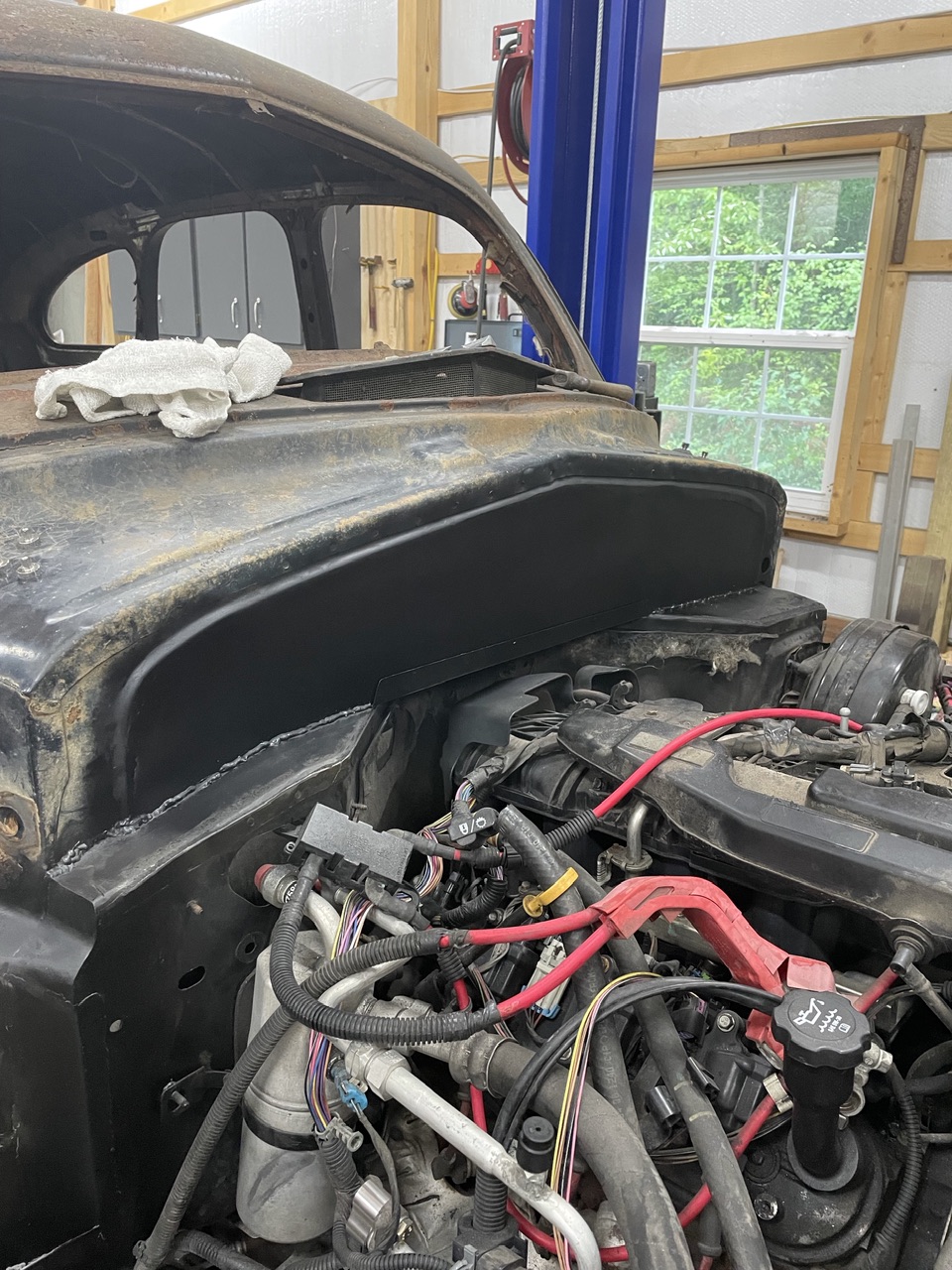

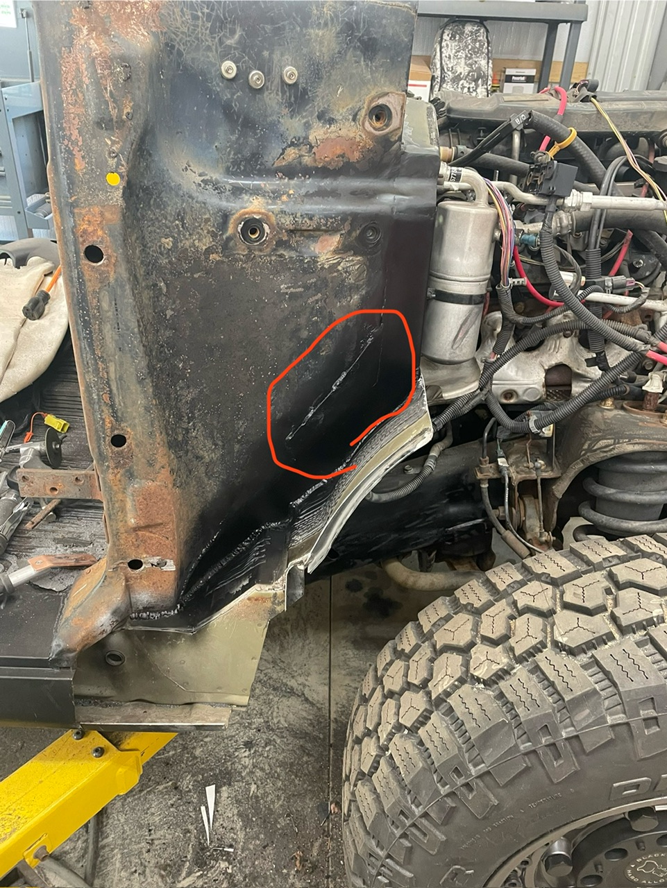

Moved on to the front fender well and firewall area.
Here’s tying the caddy body to the Yukon floor pan at the front wheel well. The ugly seam and welds (circled in red) is factory Cadillac workmanship (IMG:style_emoticons/default/smile.gif)

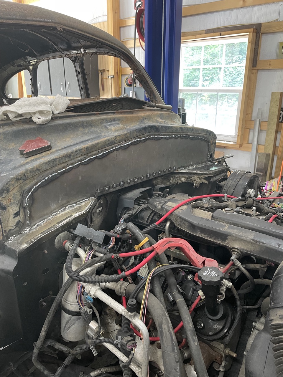

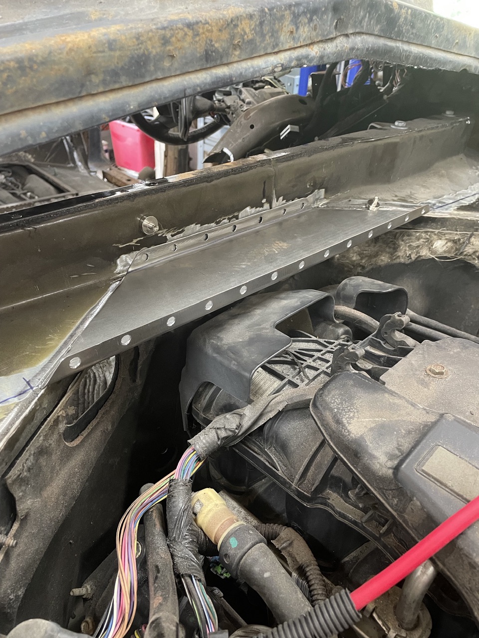

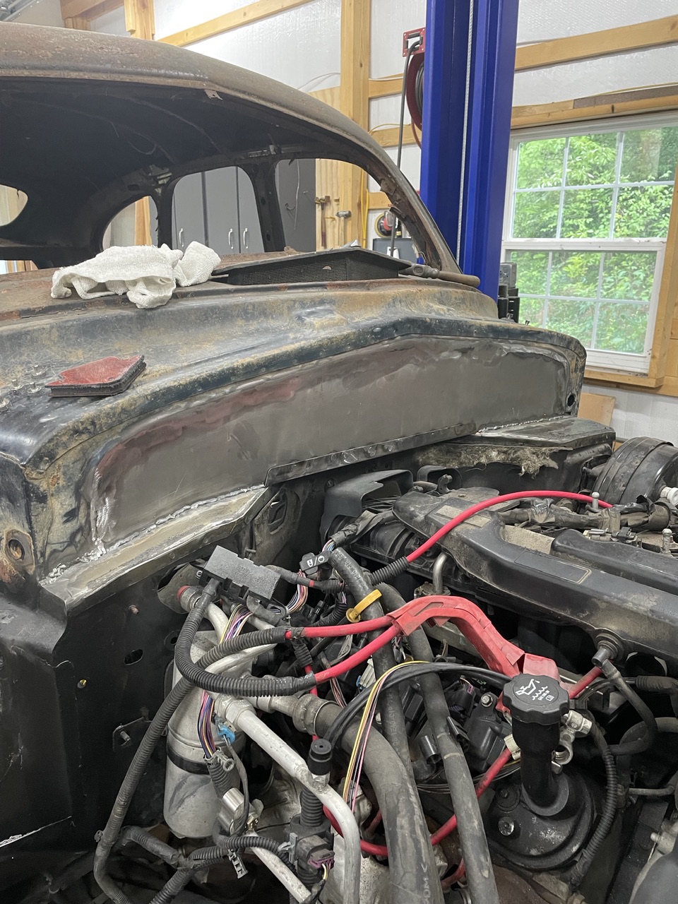

Next was the firewall. I had to make a small triangular part to transition from the shape of the Yukon firewall to the Caddy shape (flat).

This came out great. Nice work on the rear fender lips, Way easier to start with something, than making them yourself and they'll look like mass produced. Very cool

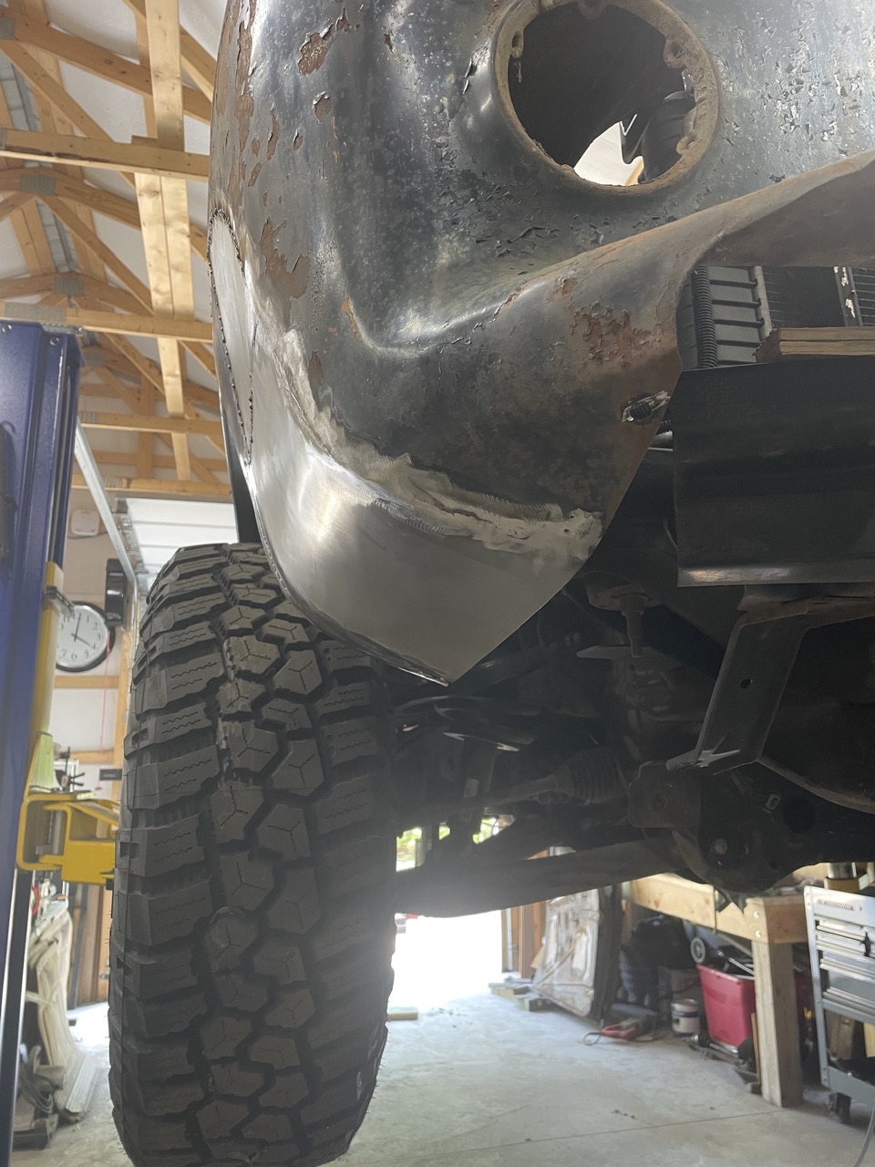

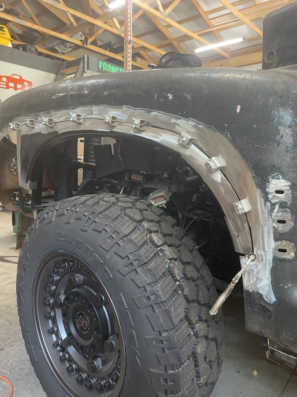

Decided to attack the front fender next. I had to relocate the fender opening 11.5” rearward and was really worried how this would look. I used the same fender lip as the rear fender (dodge pickup repair panel) but had to fab the area in front of the opening to blend with the curvature of the fender. I’m happy with the results and it looks pretty good. Minimal filler and it will look like it was made this way.

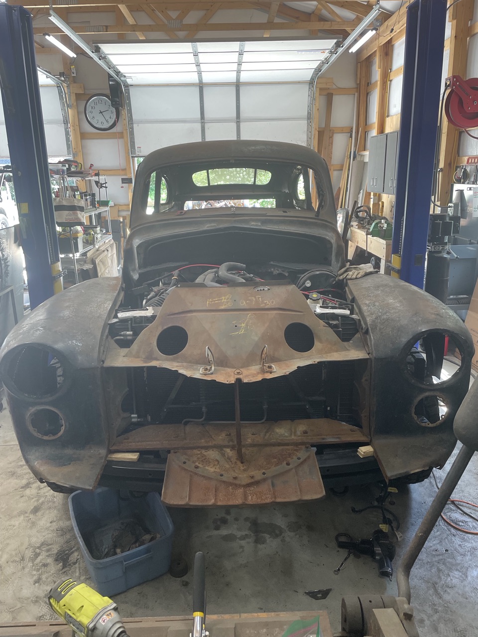

That said, I’ve made good progress. I wasn’t sure if I would be able to retain the stock GMC radiator and fit it under the hood line. There was no single mod to lower it down, but I found 8 different little mods that collectively allowed me to move it down to clear…yay!
Next was fitting the Caddy radiator support and making sure I could modify it to fit. I’ll have to fabricate a new top section but that’s not a problem.
Also finished modifying the other front fender to move the wheel arch back and enlarge it……getting there!
