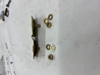

Here we go again. Aftermarket molding clip doesn't work. Why sell this shit. See attached picture. The one on the right is original and the one on the left is after market.
Stud is to short. Can't get a washer and lock washer yet alone a nut on. Attached Image (IMG:style_emoticons/default/confused24.gif) (IMG:style_emoticons/default/hissyfit.gif) (IMG:style_emoticons/default/av-943.gif) (IMG:style_emoticons/default/sheeplove.gif)

Disappointing for sure. That stud looks very short.

[Just my opinion here] You should send it back and fabricate your own.

we had ours made with the stud a bit longer to accommodate for body filler better too long than too short. Maybe though the one you got had an odd stud welded to it, happens. I doubt that we investing so much in tooling and quantities would make it with a stud too short

I feel your pain. So tired of people that sell stuff that is totally unfit for its intended purpose.
The split lock washer is completely unnecessary. Maybe if you just do nut and flat washer it will be long enough?

It’s wrong but typical for aftermarket. I would cut it off and weld on a longer one. It’s the kind of thing we have to do 1000x over when building a car.

I agree but pet states lock washer and nut. Just saying. I try and build the way it was on every thing. I can barely get the nut on. Thats in a pretty tight space.

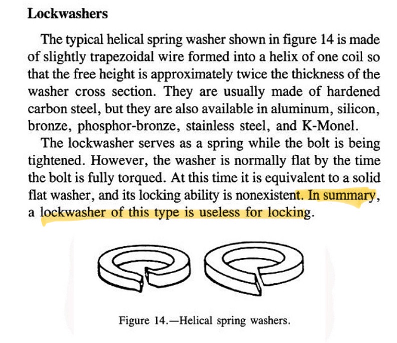

QUOTE(TonyA @ Aug 13 2024, 04:45 PM) *
That’s fine if you’re trying to build concours project.
Otherwise lock washers used up through the 70s do absolutely nothing to “lock” fasteners. NASA fastener design manual from 90s clearly states this along with tons of fastener torque testing within various industries.
Just trying to give you an option
https://ntrs.nasa.gov/api/citations/1990000...19900009424.pdf

Use a nut with a serated flange. A lot easier to install.
