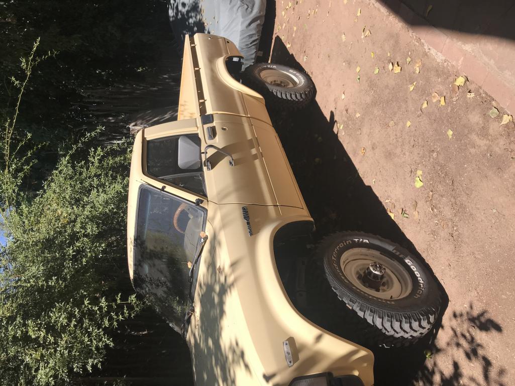

I painted my little Toyota truck the same way. The work is all in the prep. And it turned out really nice but the paint looses its shine in the sun. I got about two years out of it now I’m ready to cut it and try to bring the shine back up. Wish I would have used a higher quality paint.but I do believe it makes a durable thick finish. If it doesn’t last this time I’m going to find a material I can go straight over itAttached Image

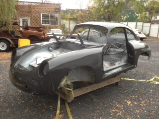

I've painted several Porsche over the years and painting well is really hard. I asked the guy who painted my 356 about this and he said, "it's the dozen".
He said there are about a dozen things you have to get right to get a good paint job and your average guy who knows tools can count on getting about 8 right on any given paint job. This corresponded with what I was getting, a different problem every time, sometimes this, sometimes that, but never a perfect paint job. He said you really need to have painted about 100 cars in a few year period to get to the 12, where the paint gun becomes part of your arm.
This was my last paint job.

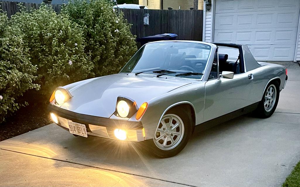

I painted my car. I used a lot of Eastwood primers, Bondo, highbuild etc. I stripped my car back to bare metal and worked forward from there.
You need a good air filtration system to keep the water out no matter what you do. Plan to buy good sanding blocks and lots of sand paper. It’s a lot of work to do it right… and yes prep is 95% of the work.
I shot the trunks and engine bay and misc with single stage… and the body with base/clear. I used PPG shop line for my paint.
I found the single stage was harder to spray… easy to lay it on too thick and get runs. The clear also ran on me after 3 coats. You need a variety of guns to paint a car… primer. Highbuild and paint are the basics. I sprayed metallic which comes another set of special problems… getting it to lay down evenly.
I had issues with spraying a sealer coat of primer before painting. The thinned primer was lifting previous coats. Frustrating but I figure it out… after is sanded it all back to metal.
Painting a car takes patience and a lot of labor. It took me several months to do… another reason it costs so much. I visited a lot of local vendors that sell paint. I settled on the one who seemed the most interested in helping me with issues.
I’ve done some spray work before… so I had some skills beforehand. I don’t believe that all paint is the same. Good paint covers well and is predictable. Am pretty sure it’s the first and last car I’ll ever paint… but I did it and learned a lot. I followed a lot of painters on YouTube etc. There is good information out there.
Good luck!

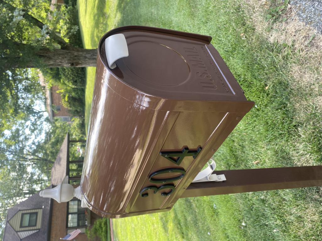

This (if it posts) is my mail box painted with rust oleum and a little DuPont clear added. It sprayed ok, but then I painted for 20 years and sold paint for 20 years. The comment about the twelve is correct. Let you know how long it shines
