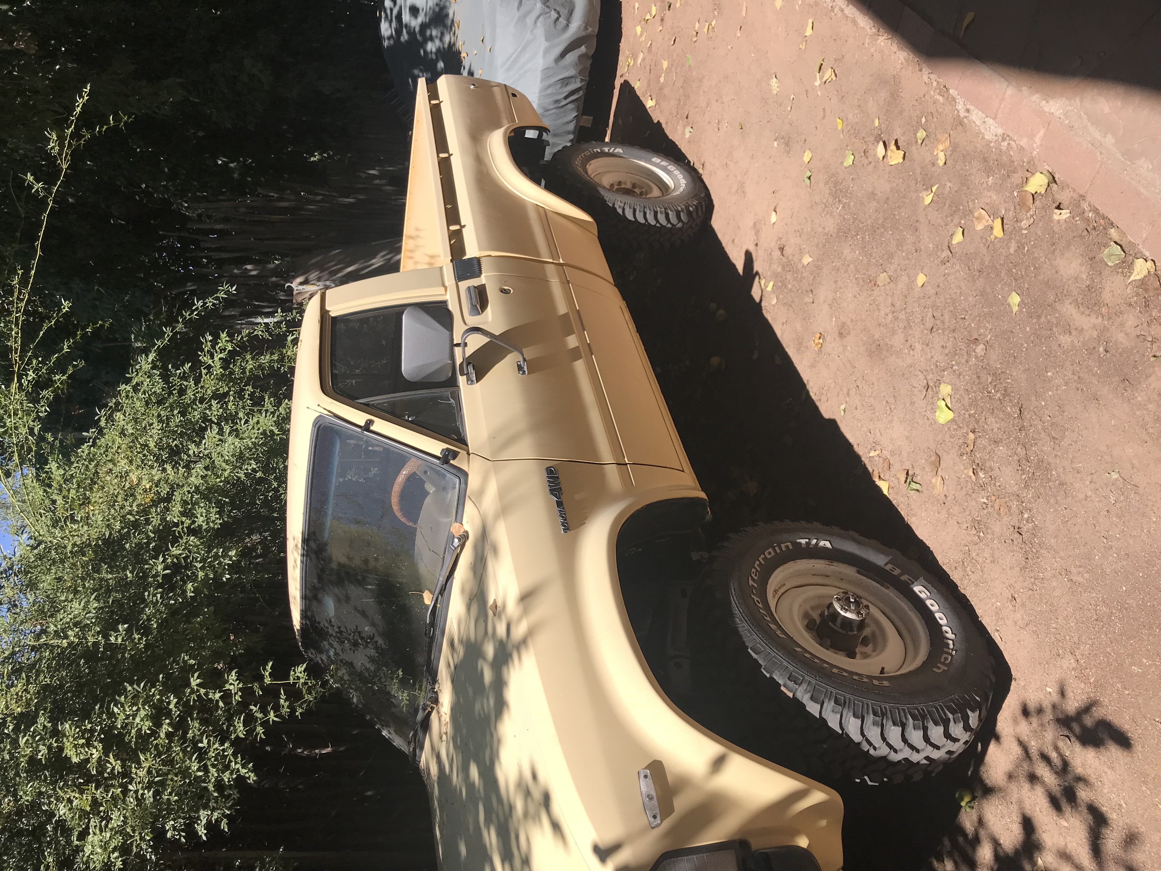

I painted my little Toyota truck the same way. The work is all in the prep. And it turned out really nice but the paint looses its shine in the sun. I got about two years out of it now I’m ready to cut it and try to bring the shine back up. Wish I would have used a higher quality paint.but I do believe it makes a durable thick finish. If it doesn’t last this time I’m going to find a material I can go straight over itClick to view attachment

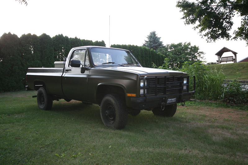

Several years ago I painted a guys M!008 CUCV pickup pickup in epoxy sold through a milsurp shop designed for old Jeeps and military trucks. It looked and smelled JUST like Rustoleum, and the suggested primer was a Rustoleum product - though this paint was a different brand.
It looked GREAT when I painted it, given that the guy stressed that I do minimal prep.
IPB Image
But after about 2-3 years of being kept outside the paint was definitely faded and sunburned.
in 2020 I used Rustoleum hunter green to paint my little m416 trailer, and it also lives outside and the paint has held up GREAT. No real fading and sunburn, and it also lives outside all the time for about 4 years now.
A gallon of Rustoleum is CHEAP compared to any 2K paints, but I still don't know that I'd want to paint a sportscar with them.
