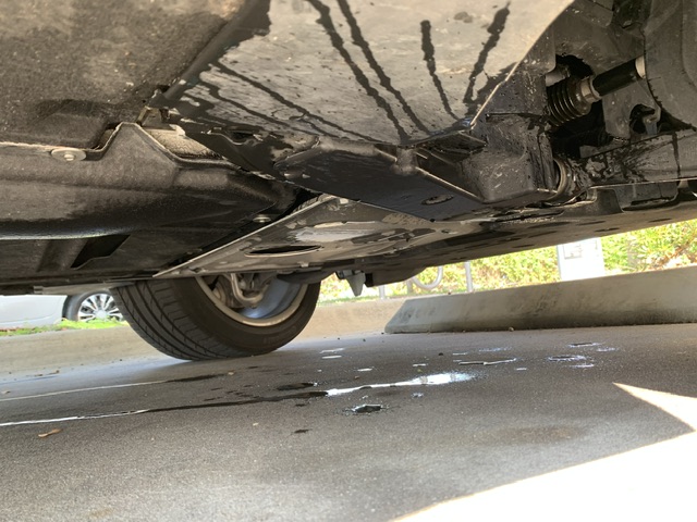

Bad engine coolant leak
It’s not a drip, drip, drip. Good flow.
Not up front so doesn’t appear to be radiator.
Near firewall.
Anyone have experience with similar?

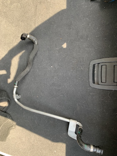

Failure of the EGR Cooler-Coolant Pump Pipe. Here is the offender:

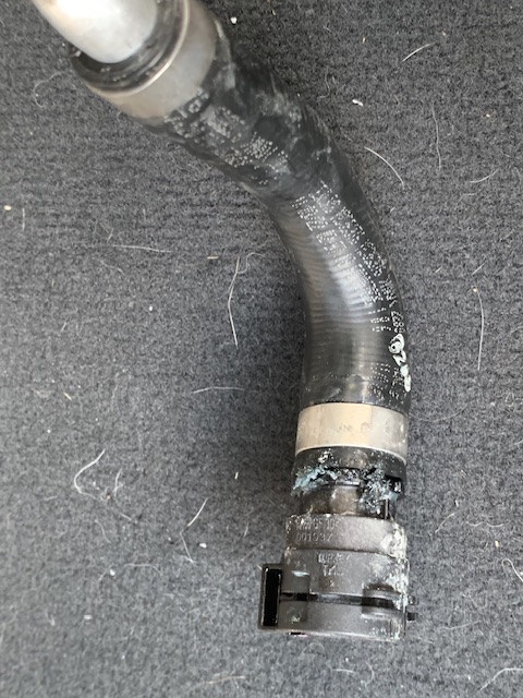

Here is the failure:

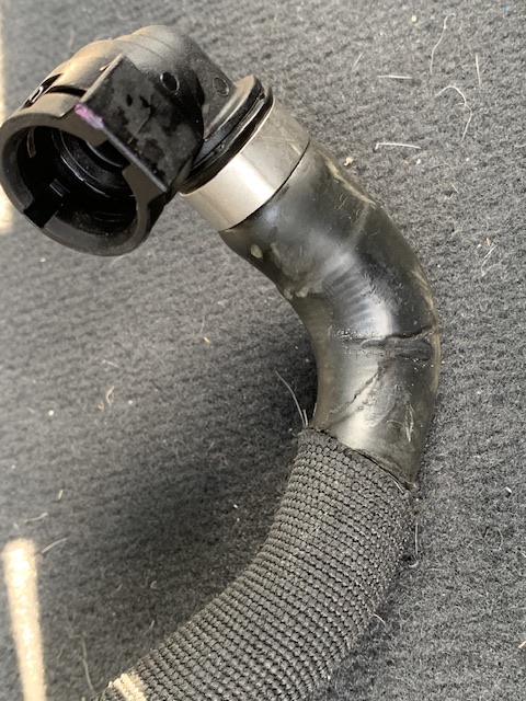

And, here appears to be the root cause of the failure - a kinked hose:
The repair shop found the elbow of this hose to be severely kinked. (IMG:style_emoticons/default/mad.gif)
This would have been caused by the local BMW dealer when they did a recall repair 4/2021 on the EGR Cooler. 15,000 miles later resulted in a burst pipe.
