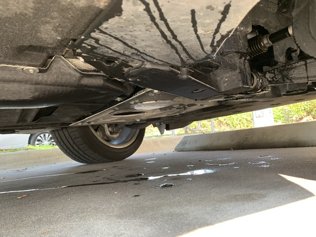

Bad engine coolant leak
It’s not a drip, drip, drip. Good flow.
Not up front so doesn’t appear to be radiator.
Near firewall.
Anyone have experience with similar?
Thanks,
Sean
Superhawk996
BMW notorious for leaking coolant pipes. Often made of plastic - cracks. O-rings get nicked or degraded though yours isn’t that old. Metal retention clips fail or don’t get clipped properly.
No easy answer other than de-trim the belly pans if necessary to figure out where leak is coming from.

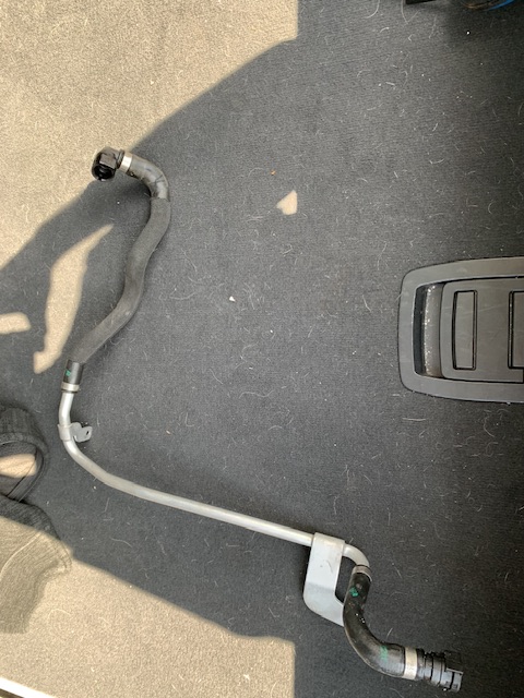

Let’s close this out with the repair findings.
$1100 and my DD is buttoned up and back on the road.
Failure of the EGR Cooler-Coolant Pump Pipe. Here is the offender:

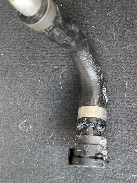

Here is the failure:

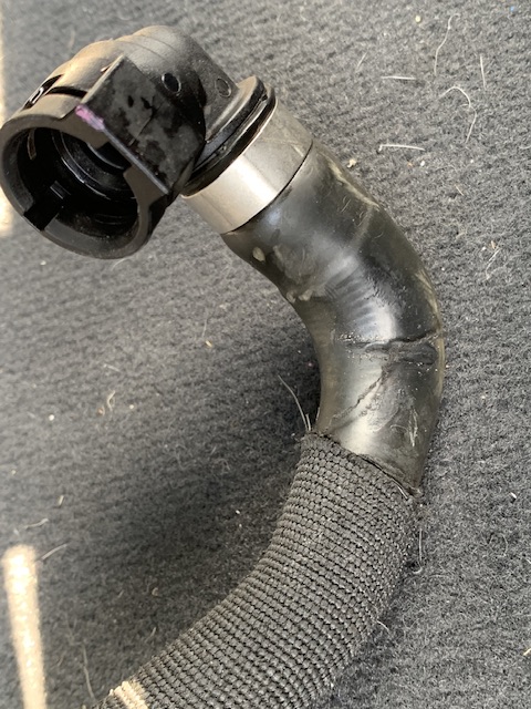

And, here appears to be the root cause of the failure - a kinked hose:
This would have been caused by the local BMW dealer when they did a recall repair 4/2021 on the EGR Cooler. 15,000 miles later resulted in a burst pipe.

Sorry the stupid stealership jacked it up during recall. This stuff really burns me when someone else’s screw up ends up costing you $1100 for what is basically a $20 part (OE production price).
