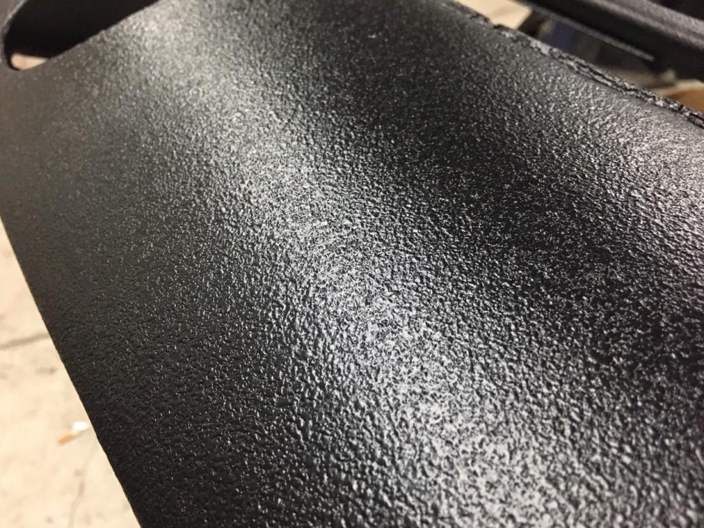

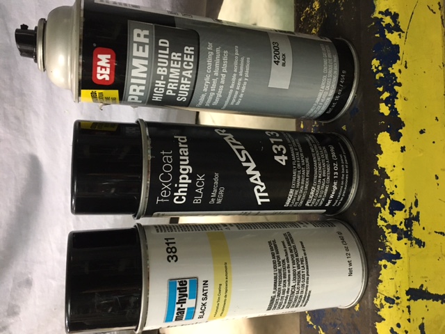

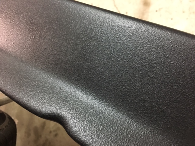

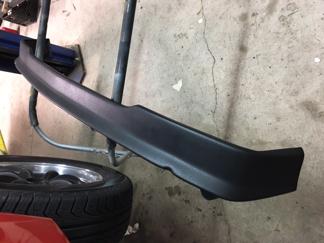

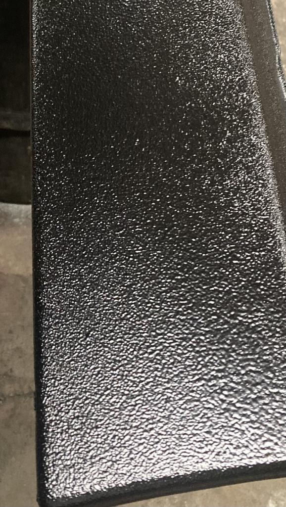

I just did this technique on the front air down, I use the same technique for rockers.
Here’s the three products to use. First spray the black primer for a basecoat. Second after some practice spray a light coat of chip guard with some distance from the rocker, that will give the speckled effect. Just a quick light back-and-forth does a great job. Third I use the black satin as a topcoat.
I suppose any black primer would work, but the brand of chip guard and black satin work, and match original color very well.
To see this on rockers, see my build link at the bottom of this post.

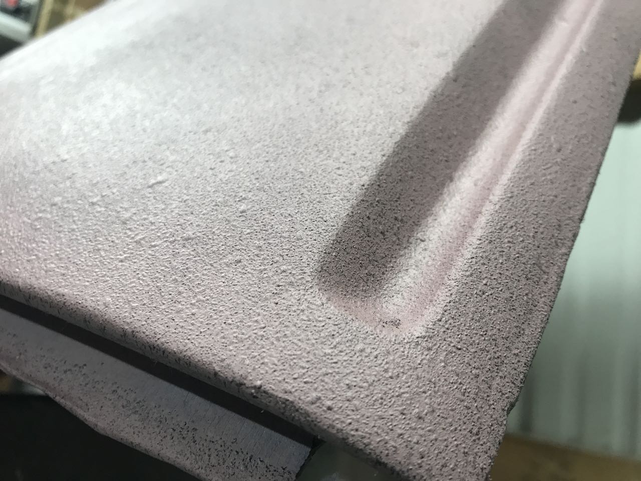

Here is a good thread on valance refinishing. On our car, the rocker finish is not the same as the valance. I don't know if that is correct.
We haven't completed ours yet, but ended up buying 3M Rocker Panel Coating - Gray for texture and Wurth Flexi-trim Satin Black for color.
Some very nice results in @Garland post.
technicalninja
post Aug 24 2024, 07:25 AM
Posts: 2,531
Joined: 31-January 23
From: Granbury Texas
Member No.: 27,135
QUOTE(Garland @ Aug 23 2024, 08:43 PM) *
Thanks @Garland !
Part numbers and all.
Best DIY I've seen yet for finish appearance.
You NAILED it big time!

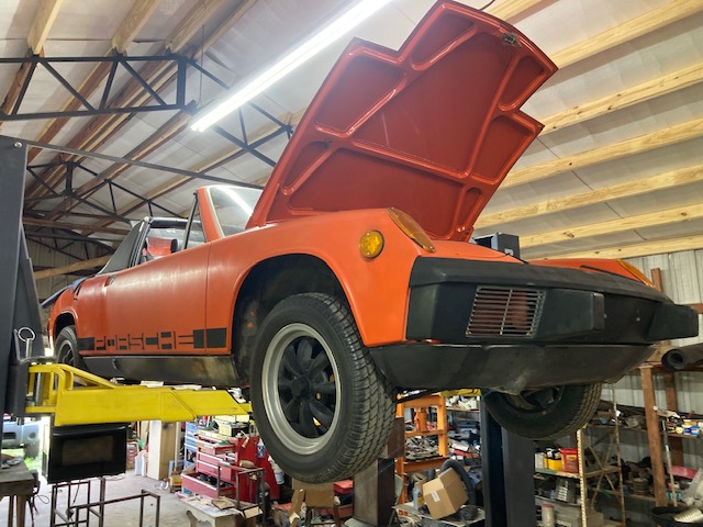

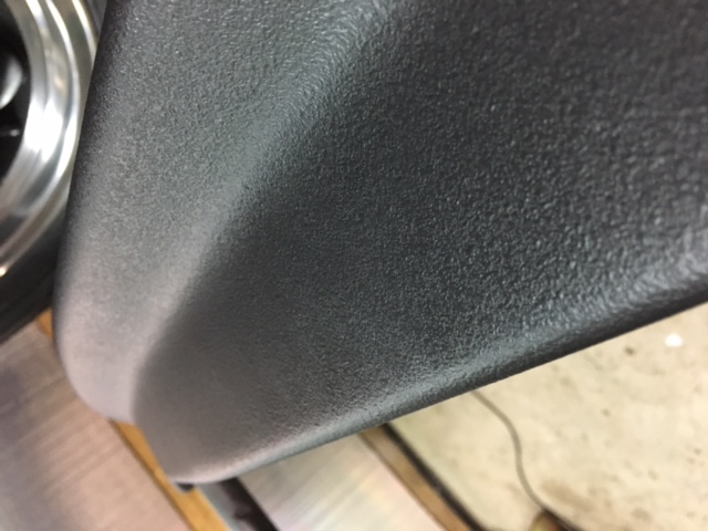

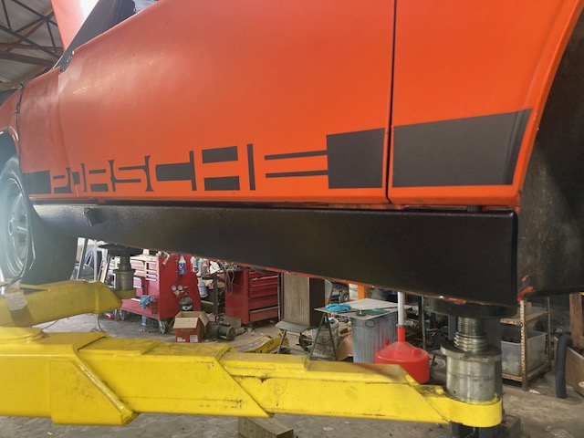

Same technique:
Rocker finish from my 2016 build,
Attached Image .
and Targa top.

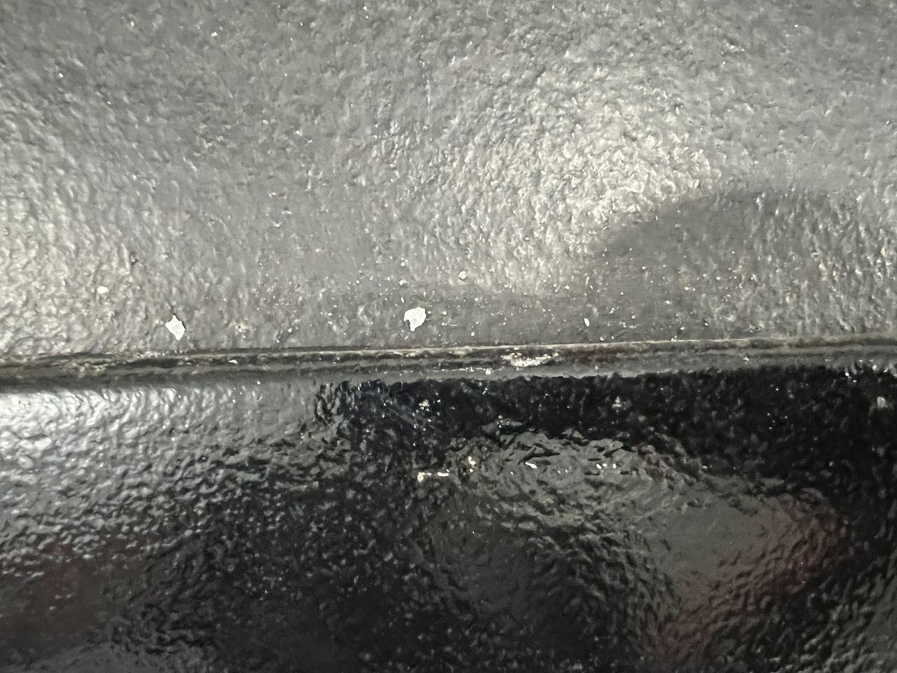

Here is another comparison reference. My dad completed the refurbish using standard primer base, 3M Rocker Panel Coating - Gray for texture and Wurth Flexi-trim Satin Black for color. POR15 on the back to address some rust.
Top is the front valance refinished with 3M. Botton rear valance with what I think is original finish. Original is a bit larger and smoother, but not much.
Our valances are different from the rockers. The rockers are much larger and smoother orange peel finish as described by @wonkipop .
I am still unclear as to whether original rockers and valances had different textures. Also if it varied by year.

QUOTE(DennisV @ Aug 30 2024, 06:15 PM) *

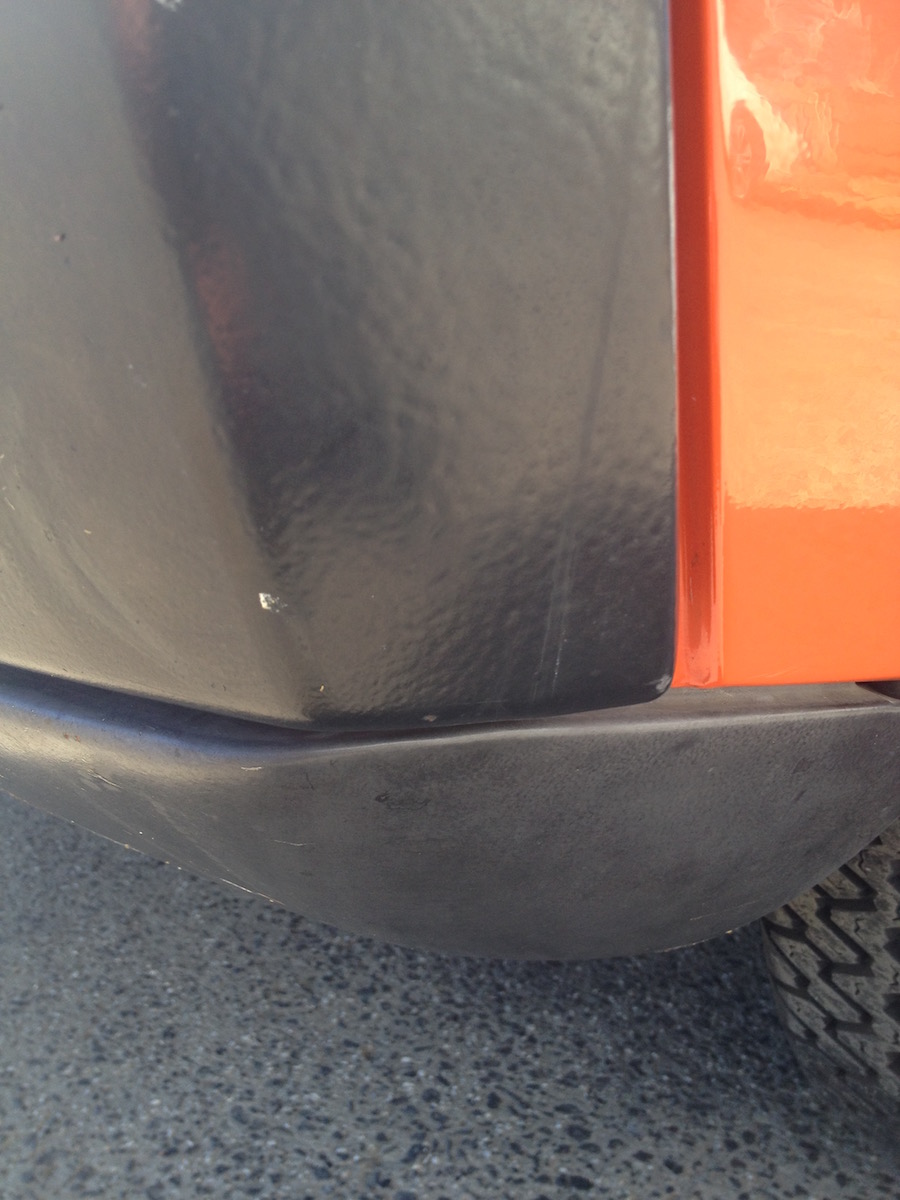

orig factory finish on my car rear bumper and valence.
would say orange peel on rockers mid way between.
you can see from the bumper its a shutz coat under a final finish coat in satin black.
mind you i would highly qualify this.
its a 74 1.8
no idea what an earlier car has or had.
and possibly varied month to month depending on shultz the shutz mans hangover. (IMG:style_emoticons/default/biggrin.gif)
but art from bama does have a 74 1.8 like mine pretty close in production date.

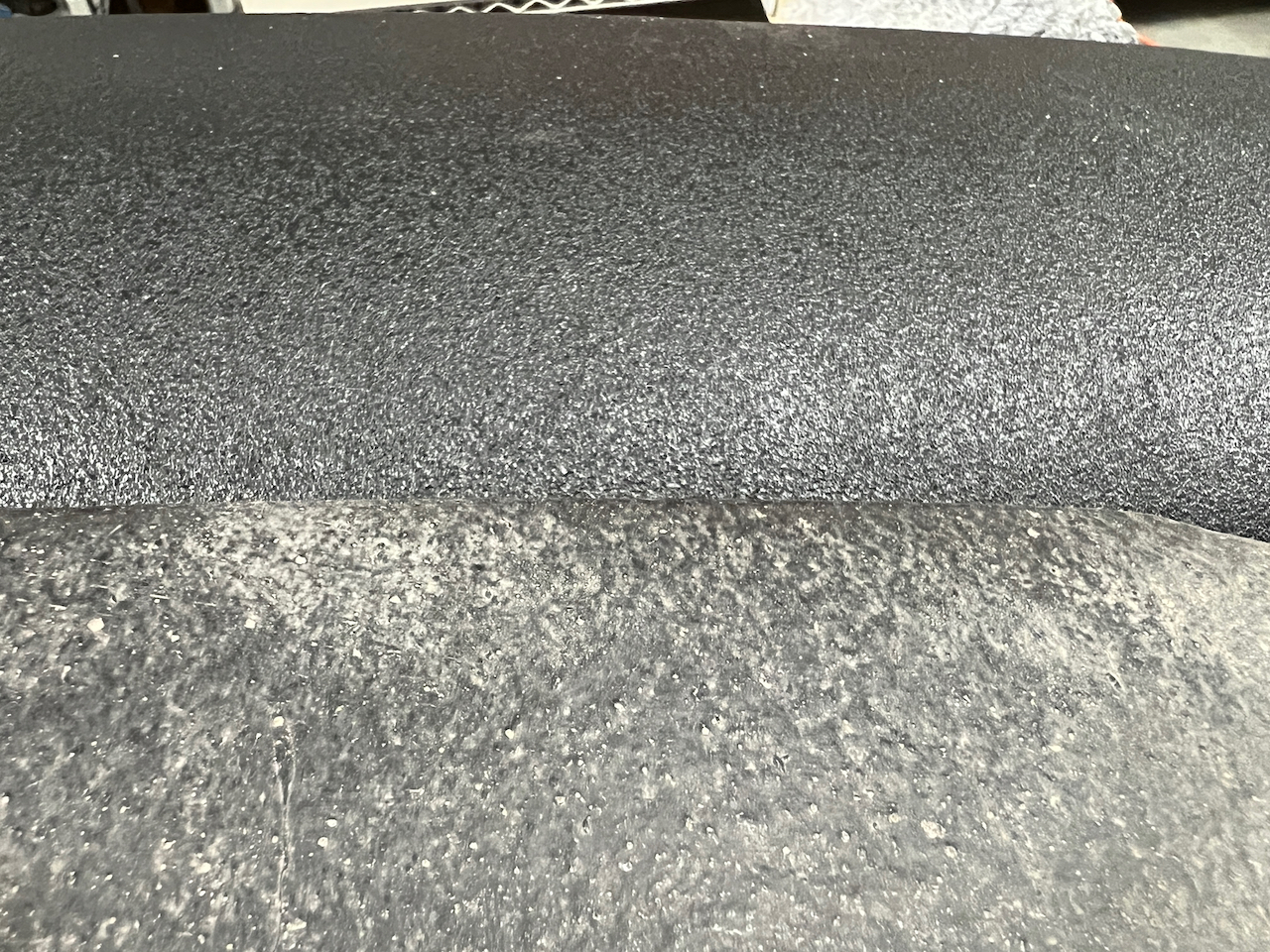

Just to bring the reference from our car full circle, since I am actually with the car this weekend.
Here is our front valance (top) next to a rocker (bottom). Hard to know if either has been refinished, but there's no obvious tells other than the rocker being somewhat glossy. They are from 1970 914-6. Texture is much closer to matching than I recalled.
