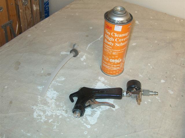

Actually, at least with the early models, the front & rear valences were textured satin black. I was told many years ago by a Porsche technician that it was a 2-step process. They basecoat was a product called Body Shutz (3M I think). The finish coat was satin black (don't remeber if it was Wurth or Glasurit). Body Shutz goes on with a special spray gun at low pressure & allowed to dry before finish coat.
Body Shutz is available in spray cans, but I don't recommend it for this use because it comes out at too much pressure & can leave a stippled appearance - buy the gun, it's inexpensive & the result looks original. I found out the hard way & had to redo at all.
Nice thing about Body Shutz is that it's rubberized & will take a pounding from stones. Quite frankly, it wouldn't be a bad product to basecoat the rockers with, but that wouldn't be original.

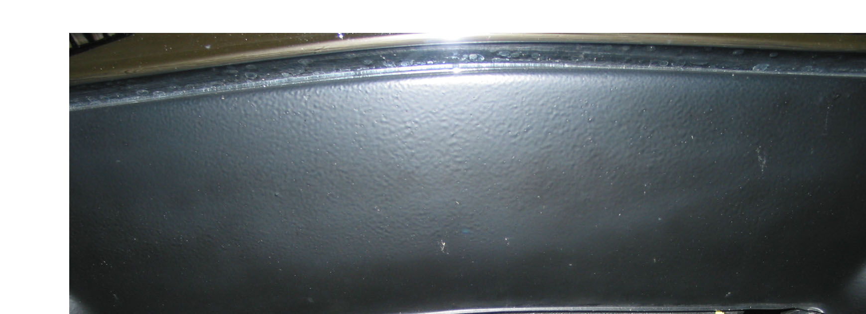

Dug up a picture what I think the finish should look like.
body shultz & satin black.
tom

The finish is very apparant in that pic. Thanks. From what year car is that panel taken and is that a factory application?

QUOTE(1970 Neun vierzehn @ May 2 2006, 08:53 AM) *
Tom,
I've known this car for a long time (~75) & it is a pretty original car. I know Paul too, but that's a different story. The problem I'm having here is that I am convinced his valences are original to the car & seriously doubt the former owner took the effort to have them re-finished, since it was still a very new 914 at the time. If there had been damage to them, what's the likelihood that BOTH would be damaged or replaced?
I suspect that since his is an early car, they probably came without a textured finish. Remember how many variations there were to the appearance group on the early cars? He can go either rout - 2 stage, or single stage, and get away with whatever choice he makes. I would reiterate that the "shutz" method does offer better protection from nicks.

Here is a picture of the gun and a container of 3M Body Schutz;
