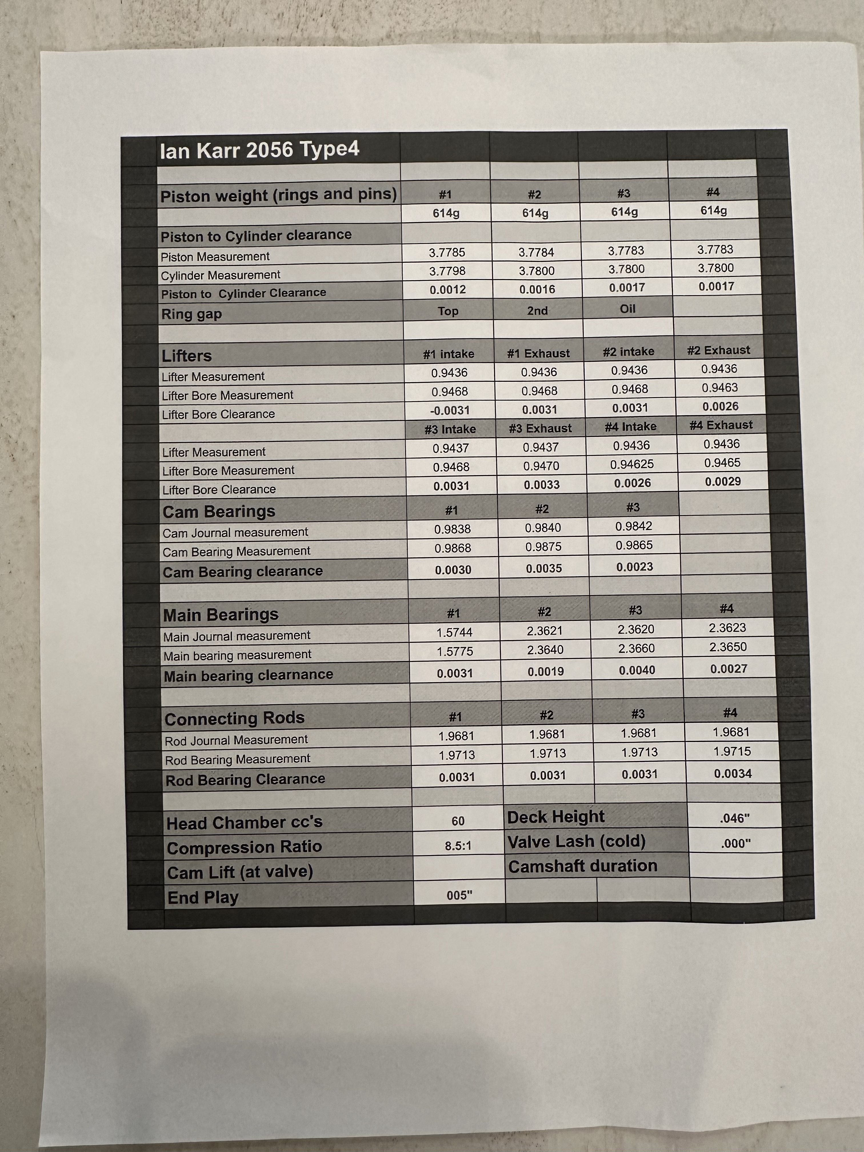

Geezer914   What were your final main bearing clearances with ...   Sep 3 2024, 04:04 PM
iankarr   Here’s the build sheet…   Sep 3 2024, 10:14 PM
