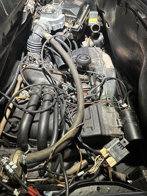

Hi all this is my first post here! I recently picked up a ’75 1.8 that was last registered in 2001! Pretty good barn find, in my opinion. It was up in the high desert of California, so no rust, great mechanicals, all the electrics work. Just flaking paint, decayed interior …and an engine that probably hasn’t run since the Clinton Administration.
The TLDR is the car has started and run for 10 seconds but now won’t start at all.
A quick timeline of what I’ve done/tested:
- Dropped the engine, adjusted valves (encountered something strange that I’ll ask about later)
- Old starter could barely turn the engine over. Replaced it with a hi-torque.
- good compression
- Replaced the old broken bellows thermostat
- New fuel lines, vac lines, spark plugs and wires
- deleted EGR system
- Fuel pump was getting power but dead - replaced it.
- Coil’s good. Cap and rotor look good. Points gapped.

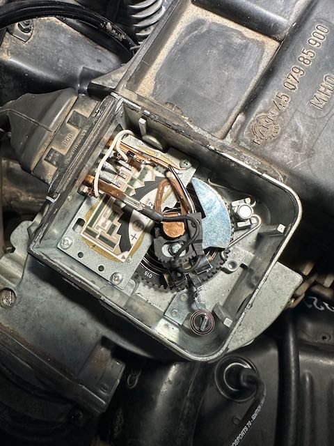

- The L-Jet AFM had been opened and the adjustment wheel inside was so loose that it the flap wasn’t closing fully so the pump was running continuously. I rotated the wheel until there was enough tension to turn off the fuel pump. (I would have normally never touched the AFM!)
Put the engine back in and the car started on the key immediately, ran for 10 seconds and died. I tried again, it started and ran for 5 seconds, then popped loudly back up the intake with enough force to blow the intake boot off the AFM. Since then, it hasn’t started.
Couple notes:
- after the pop, I felt like the intake pipe connector hoses were probably leaking, so I put hose clamps on them. With those clamped down and fresh vac lines everywhere, I’m pretty sure there aren’t any more leaks.
- oil filler breather nipple broke so I’ve taped it off until I can get a new one. But I’m not sure how this affects the vacuum… should it be left open for now?
- I don’t know the fuel pressure but it does have a new pump and lines so I’d be surprised if pressure is the problem.
- tested injector ballasts and got correct ohm readings
- It did start and run on its own spark and fuel, so I assume ECU and injectors are OK.
- the AFM is obviously an issue … probably considerably off. But again, the car did at least start a few times.
So now what?
- I’d like to check/test anything I can before I start buying replacement components.
- Are there baseline settings for idle speed screw, and at least a “best guess” AFM setup?
- Should I just buy another AFM now, knowing this one may never be right again?
- could the intake backfire have damaged something?
Thanks in advance for your thoughts!

I’ve never owned or messed with 1.8L Ljet. But any of the airflow meters with a swinging door are susceptible to backfire damage. Not unique to 914. 1st generation Miatas had a similar airflow meter that was easily damaged.
There are Lots of guys here that have worked on the AFM. Don’t give up just yet but that is most likely the source of your no-start.
Good man on wanting to do diagnostics before throwing parts at it.
There are basics on the AFM in the Haynes shop manual. Jeff Bowlsby site likely has good info too. Check the tech section

I would get a good used AFM as it is very unlikely that one will ever work properly due to past "tampering " the setup of these very important ,back fires can damage these also but that is the least of your issues .
I have one that is damaged one and the air gate sticks up... no good @ all.
Just make sure you buy a replacement that is the correct type and has history of actually working ,good luck.

Yes, the AFM is a POSSIBLE source of the no-start condition. With a backfire the flap can be damaged, but it is possible it is just stuck open. Double check that first if you haven't already. I was also afraid to open my AFM for adjustment, but once I did it I was glad I did. Having said that, I'm not sure that the adjustment you made to your AFM put it back in the right range. I'll give you a link to the most helpful site that I found for AFM adjustment. I'll also give you a link to the L-Jet trouble shooting manual. That is from Jeff Bowlsby's website, which has a whole lot more helpful information on it. It is worth perusing. I'm assuming that when you dropped the engine you checked below the tin for rodent nests. Don't forget rodents can also get into the exhaust system and a plugged exhaust system is a potential cause for your problems. As a matter of course I would also replace the points and condenser. A condenser that has sat for 25 years may be fine, but I'm not sure I would trust it. The L-Jet system is very sensitive to vacuum leaks so if you haven't yet replaced all of the vacuum lines that have been sitting for 25 years you are going to need to do that. A smoke test or a test with compressed air and soapy water can be helpful. Rebuilt and used AFMs are out there. Don't forget these were also used by certain VWs. Try the Samba as I have seen them there. FIC does rebuild these. I'll give you a link to their website.

SirAndy's post is rhetorical I guess. But the first thing I did was to take the engine out, oil the cylinders, and then turn the engine carefully by hand.

I dropped the engine back out and pulled the intake tubes. engine is completely flooded with fuel. must be an injector stuck open.

QUOTE(spencercanon @ Dec 16 2024, 03:57 PM) *
Good, he's starting a resurrection properly!
And...
He's perfectly fine with ripping the puppy apart. Most folks go to great lengths to NOT remove the engine.
He starts with it...
KICK ASS!
Now, because of "newness" of the breed he didn't take it down far enough.
@Superhawk996 has a bunch of pictures of what you CAN find under the tin.
It's impressive enough to make "check under tin" a MUST do on something that has been sitting awhile.
We (the forum) really ought to have an "engine out" maintenance schedule/list
There are many things I'd suggest/do automatically.
The hard plastic fuel lines in the tunnel should get changed to SS lines. (Tangerine racing).
Do a "valve job" on the heads. Replace springs if old.
Do the shim kit on the rocker arms.
Both crankshaft seals. Check/set endplay on crankshaft.
Inspect the crap out of the OP control valves. (see Tangerine Racing for solutions).
Clean the oil cooler and replace seals.
You're running a 75 1.8L (exactly like me!) Your fan does NOT have TDC marks!!!!!!
Degree fan for TDC and TDC 180 out.
I found a 2.0l fan that had the normal TDC mark and added the second mark.
This makes leak down tests a BUNCH easier to do!
Flexible sewing tape measure is the easiest way to mark fan. Just go 1/2 way round.
Tangerine racing (I'm sounding like a commercial for TR!) has a KILLER firewall spherical shift rob bearing. It's easier to install with engine out.
That's just a start. I'd bet I've missed a bunch of other stuff.
QUOTE(spencercanon @ Dec 16 2024, 04:29 PM) *
And he's QUICK to rip it back down!
Love the enthusiasm!
I'll bet you've already figured out how much EASIER the 914 is to work on over the Europa I see in your garage. That looks like a NICE one!
Injectors are another thing that sitting forever screws up. Pull that stuff off of the engine, hook it back up to the car and just pressurize it.
I'd bet money at least one of those injectors will be streaming.
Nother thing to look at is the condition inside the tank.
We currently can buy new tanks for less than $300 so don't bust your ass to clean a nasty one!
(IMG:style_emoticons/default/welcome.png) (IMG:style_emoticons/default/welcome.png) (IMG:style_emoticons/default/welcome.png)
