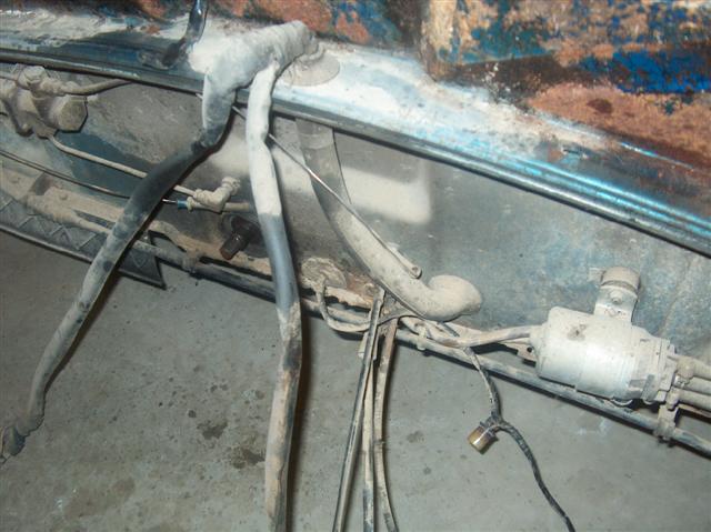

Lou W
post Aug 27 2005, 10:12 PM
Posts: 4,109
Joined: 9-May 04
From: Roseburg, OR.
Member No.: 2,039
Region Association: Spain
Here you go, upper left of picture;
