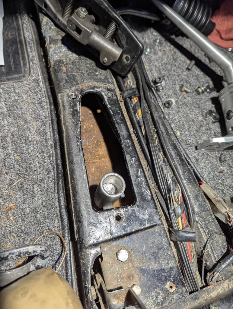

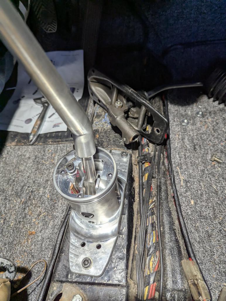

I think I've read every Rennshift post on the forum trying to figure out WTAF is going on with my car and this installation.
Here's the quick and dirty version:
  • Put the stock into 2nd gear
  • Removed the stock shifter
  • Put coupler onto shaft, flat face forward
  • Seated the new shifter.
  • It won't line up with the mounting holes
I got under the car, tried to adjust the shifter rod where it links up behind the firewall, but it's just too short. I can't put the gear into 2nd no matter what I try.
It has not been modified.
I was thinking about either adding length to the front of the rod in the cabin, or removing it, drilling a new hole for the pin, and extending it forward by the inch or so that is needed to make this work... IF there's enough length to do that.
I'm super annoyed by this.

is that a 914 side model JWSTRSSDSTSN
post Jan 1 2025, 09:08 PM
914-6 GT in waiting
Posts: 20,661
Joined: 19-September 09
Member No.: 10,825
QUOTE(sixnotfour @ Jan 1 2025, 09:06 PM) *
Yea, What's pictured is a stock side shifter but the rod in the tunnel has a tail shifter cup.
The stock rod would have a round shaft at the end, not a cup. Did you change it for some reason?

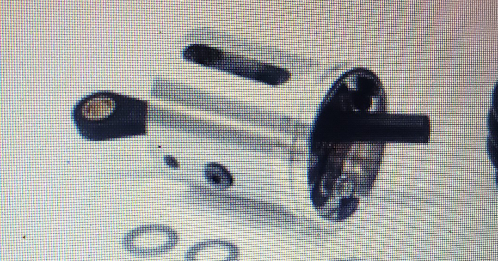

Gearbox/Car Type: 914 Side-Shift (Clevis attachment under shifter) ('73-'76)
sixnotfour
post Jan 1 2025, 11:07 PM
Posts: 11,213
Joined: 12-September 04
Member No.: 2,744
https://cdn.shopify.com/s/files/1/0521/8792...df?v=1665708537
see page 2.. pic on left.

I'm really confused here.
Is your car a tailshift car? Or a sideshift car?
Please send a pic of the bottom of your rennshifter as you would have it right before installing it into the car.
Take that cup off the shift rod so its just the knurled end.
Transfer the attachment from the stock shifter to the Rennshift, with a new bushing.
As far as general poor shifting...
If the rest of the bushings along the shift bar are trashed, the Rennshift WILL NOT fix your shifting issues. In fact it WILL MAKE THEM WORSE. To get the benefit of the Rennshifter, you NEED new bushings all the way from the firewall to the transmission.
post Jan 2 2025, 07:09 AM
914-6 GT in waiting
Posts: 20,661
Member No.: 10,825
I have a feeling it’s just a miscommunication about the part on the rod in the tunnel. Like Zach said, show us the bottom of the Rennshifter and we’ll go from there. Chances are you just need to move parts over from your stock shifter (linkage piece and metal bushing) and then get the correct rod or parts in the tunnel. Probably all an easy fix. Take pics of everything, show them here and the guys here will help you get it right. (IMG:style_emoticons/default/beerchug.gif)

I would also take some pics of the engine side firewall at the bottom where the shift lever exits the car and the back of the transmission- just to confirm what you got.
