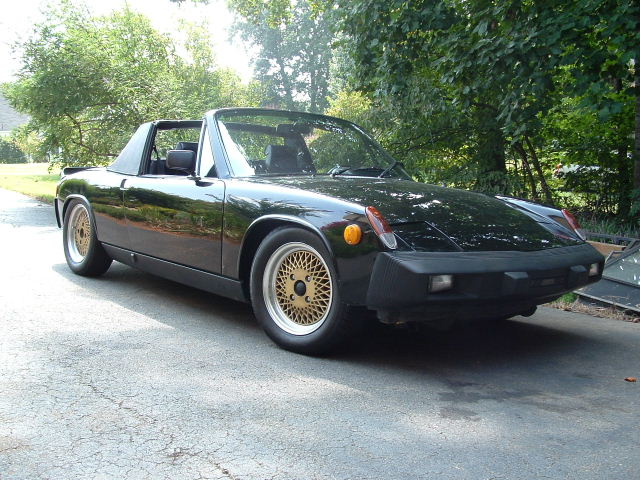

According to "Tech Tips 700", page 38, item #265, I may be suffering from weak spring syndrome! I have attached photos showing the left rear, right rear, right rear fender clearance and a side view to show front to rear difference.
As near as I can tell, the springs currently on the car have two green marks. If I need new springs, what do you people recommend?

one thing to consider is that "as delivered" the 914 was normally higher in the front...so it has an illusion of having weak rear springs (IMG:http://www.914world.com/bbs2/html/emoticons/wink.gif)

Stock super beetles are set up higher in the front too. Isn't there a ride height adjustment for front and back?
On IRS bugs, you have torsion bars on the back that set ride height, shocks have little to do with ride height, as I understand it. You have some excessive negative camber too, so somethin' ain't right, have seen that on VW, MB and BMW on the rear.

Due to the fact that there is no published factory rear ride height dimension given (only a difference from side to side), there can be no sagging springs.
Way back when 914's were new, it appears (from old pictures) that the cars came from the factory with a slight nose-up attitude.
If you are concerned with the stiffness of your rear springs and you use the car for street, I would suggest not going much stiffer than 140lb rear springs.

double green marks where what.. 105 lbs? if that?
Just get yourself a set of 140's, and live happy.

Lots more camber on the right though... (IMG:http://www.914world.com/bbs2/html/emoticons/unsure.gif)

check your suspension ear for cracks ...
how many (or not) alignment shims do you have on each side?

I do not know the number of shims at this time...I will have to jack her up tomorrow and try to produce a count. Let's assume there are no shims present (which is highly probable, knowing the things that were done by the previous owner). I highly suspect the springs are probably shot by now. It would be best to replace the springs and then get the alignment done, would it not?
Which leads me to the next question. I would think that a 4-wheel alignment would not be something that your local alignment shop would be able to accomplish, particularly to a 1975 porsche 914. Would it not be better to take it to the nearest porsche dealership that would hopefully have the proper shims necessary to do an appropriate alignment? My nearest dealership is about one-hour's drive away.
yes, your local "american iron" alignment shop will *not* have the needed shims.
and yes, i agree, get new springs/shocks first, then worry about the alignment.
while you are in there, examine the suspension "ear" (where the trailing arm mounts to) for cracks, especially the pass. side ...
get some good shocks like bilstein or koni with the threaded collars which will allow you to set *any* ridehight you desire.
