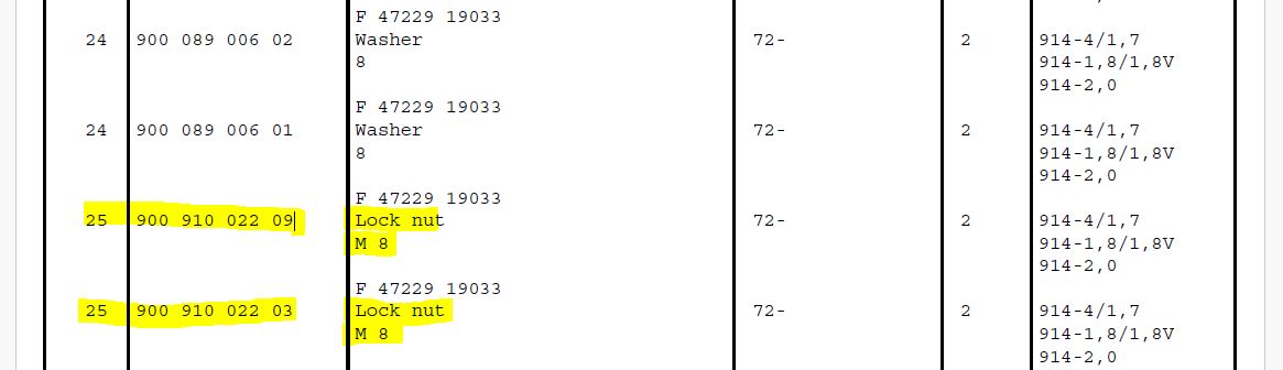

I need to replace the ball joint nut that connects the strut/balljoint pin.
It’s a M8 lock nut correct, 911 314 119 06, that fits 72-89 911 and 72-76 914s?
Thanks,
Kelly

M8 Lock nut

Do you happen to know the pitch depth of the threads?

I used the m8 nut by ordering the part number in the 914
katalog and proceeded to strip the strut pin.
Be careful! It would be great if
The pin and nut came as pair.
