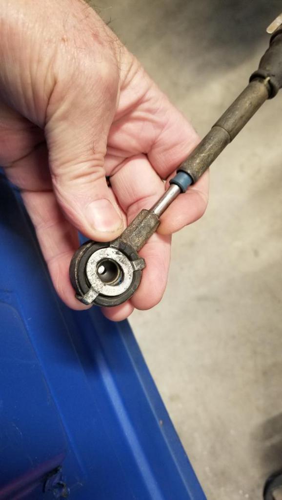

Hi guys,is it possible to remove these cable ends? I want to replace them with heim joints.Attached Image

QUOTE(Steve1956 @ Jan 28 2025, 01:00 PM) *
I looked at this when I went to the Cayman 6 speed. You can't remove the ends. They are crimped onto the cable.
I used Numeric shift cables.
https://numericracing.com/products/performa...-cables-986-987
They are not cheap, but they use really nice joints on the ends of the cables, and they are removable.

What I thought I would try if the rod is soft enough,cut the end off and thread it with a die. They are 6mm in diameter.
Whoa!,,,I guess they are pricey! Yeah,gonna try threading them!
