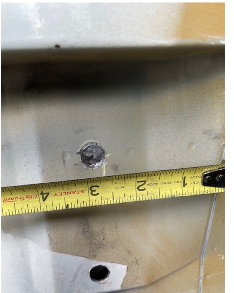

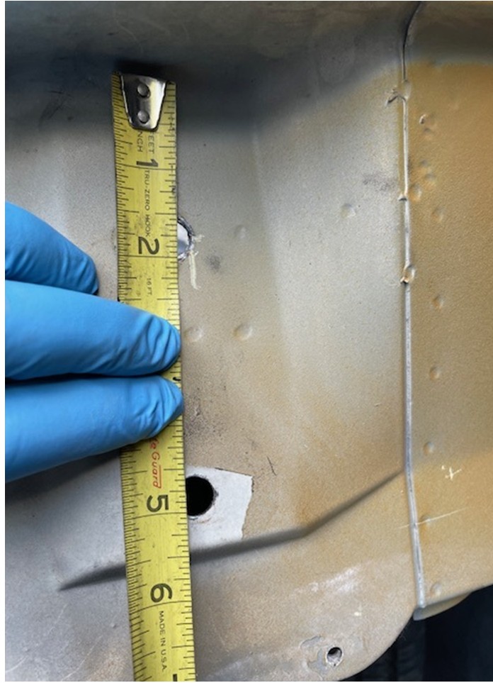

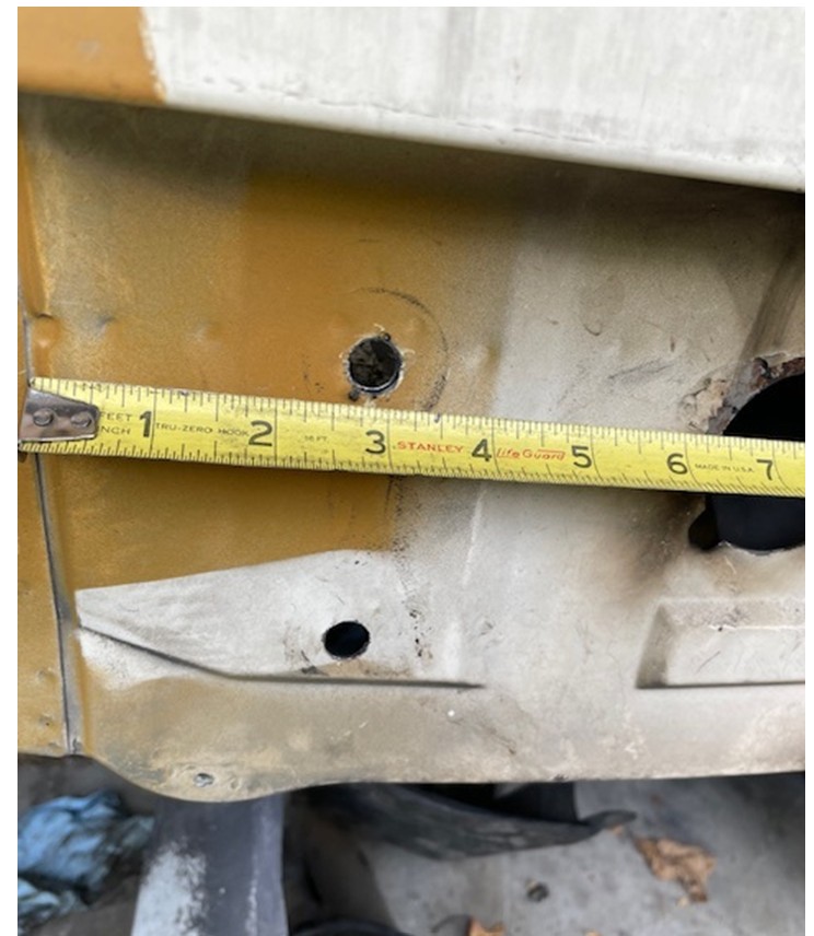

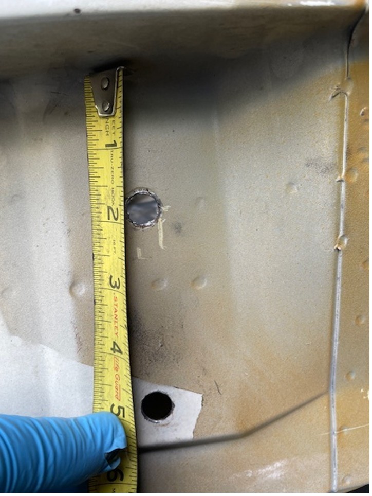

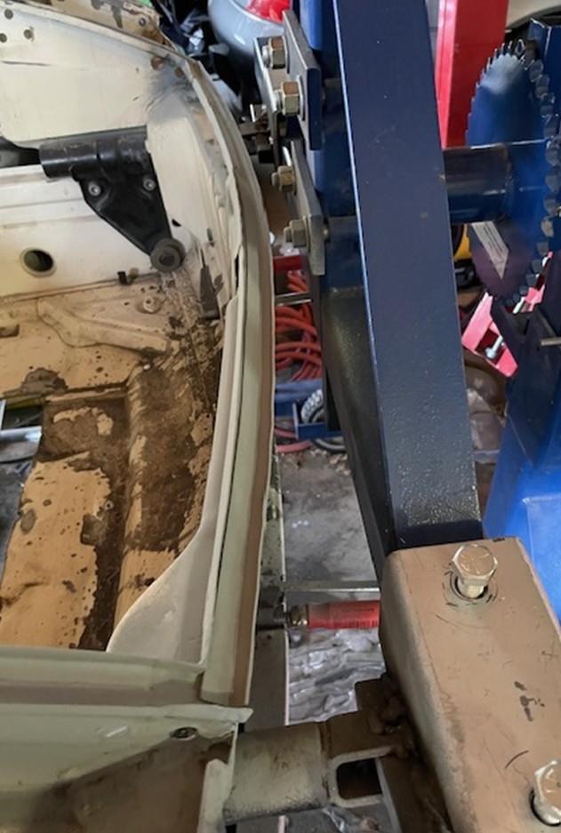

I back dated my 75. I found the measurements in on the rear in the referenced thread to be close but just slightly off on my 75. I have a 73 as well to reference. I mounted the lower valance on the rear and set the taillight in place and then set the bumper where it needed to go.
I used someone else suggestion of short studs and a little dark grease on the dog bones to get the exact locations.
Below are the measurements I got when done. Over all process worked well.
On front holes are marked as indicated in referenced thread.
I ended up making a whole new front channel as I had some slight rust under the original.
I have changed to studs on my 73 and it makes installation a easy one person job.
Hope this helps.
john

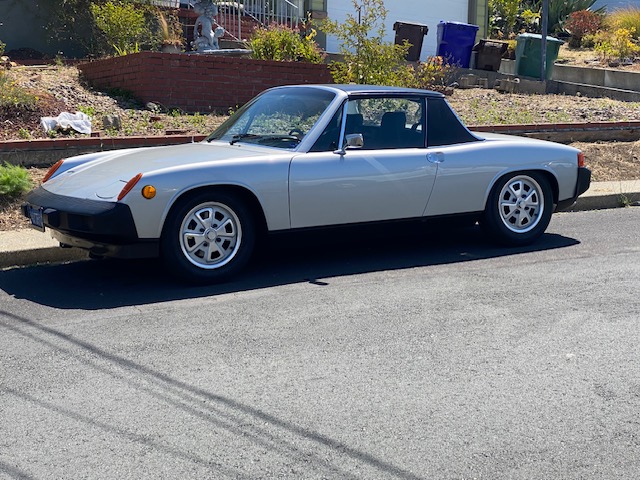

I hate the Rear BUBs, But oddly enough, I still like the front BUBS that wedge style front is what left its foot print on styles in the late 70"s
So I just back dated the rear bumper

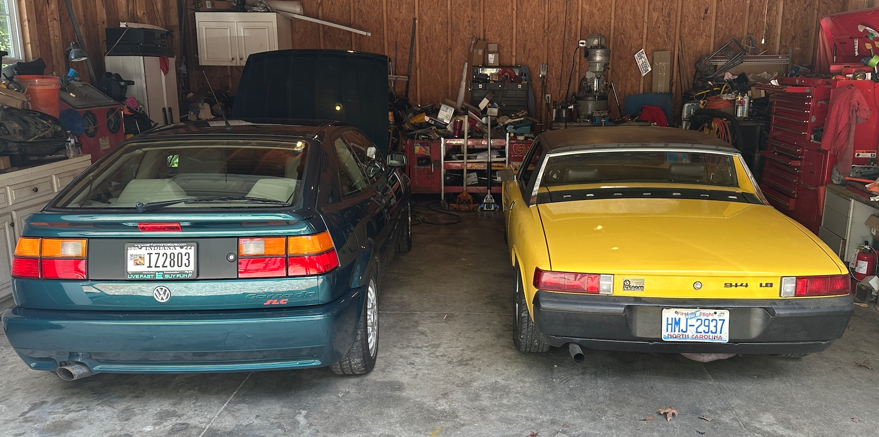

I’ve only ever seen one “front dated” (early car with BB’s).
BillJ
post Feb 6 2025, 05:42 PM
Posts: 1,355
Joined: 4-March 13
From: charlotte, NC
Member No.: 15,610
QUOTE(mepstein @ Feb 6 2025, 06:18 PM) *
One too (IMG:style_emoticons/default/beerchug.gif) many!!

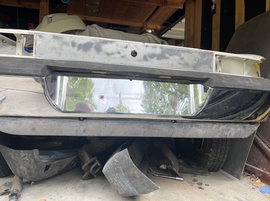

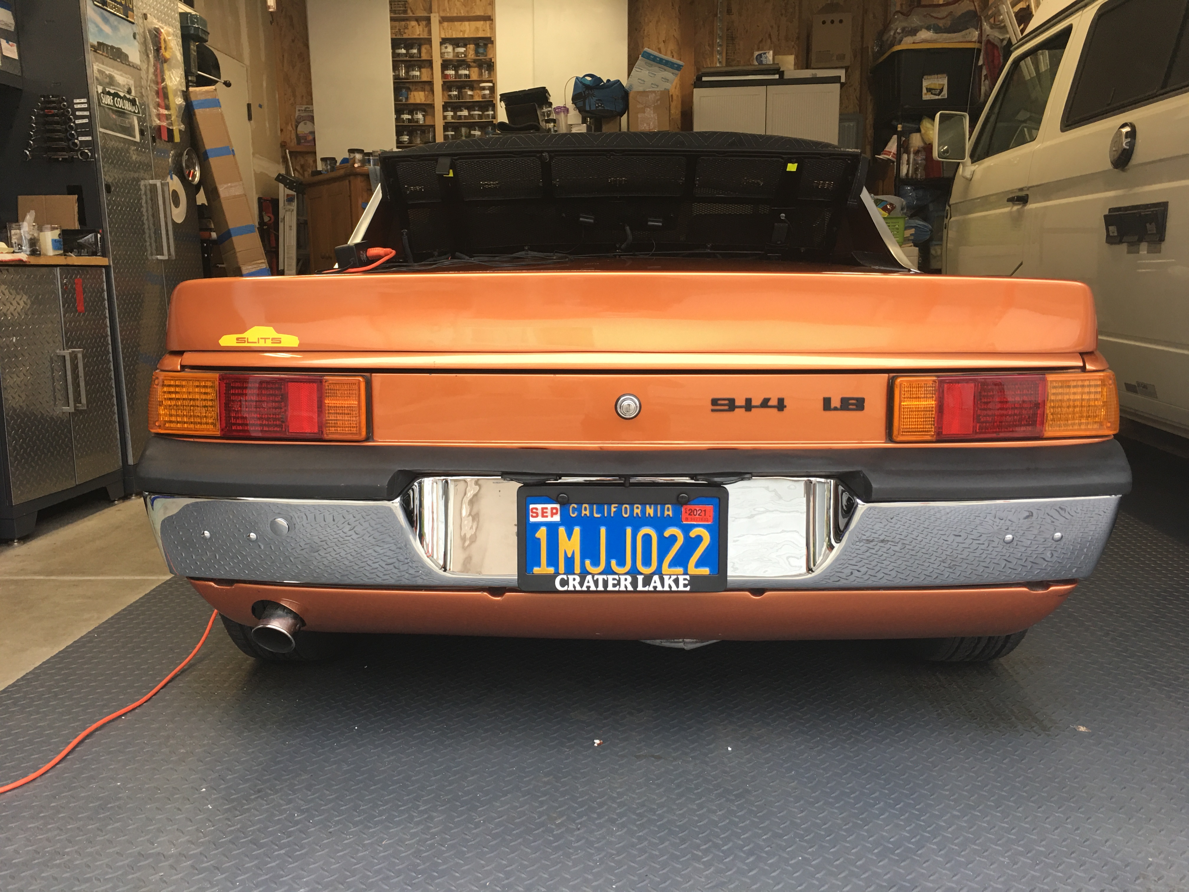

I did the rear and kept the original front…
