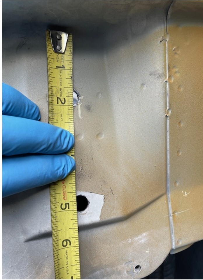

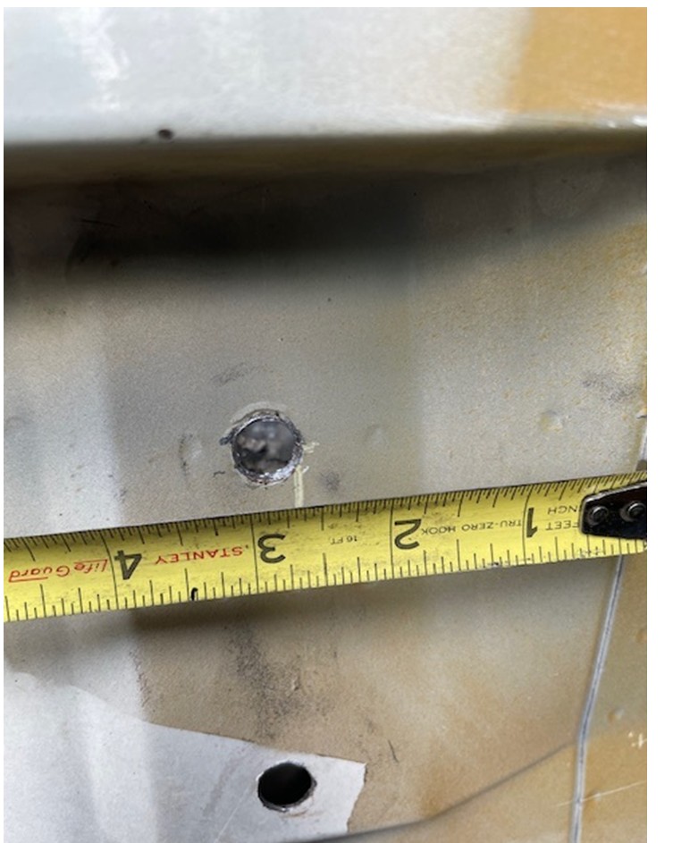

I back dated my 75. I found the measurements in on the rear in the referenced thread to be close but just slightly off on my 75. I have a 73 as well to reference. I mounted the lower valance on the rear and set the taillight in place and then set the bumper where it needed to go.
Click to view attachmentI used someone else suggestion of short studs and a little dark grease on the dog bones to get the exact locations.
Below are the measurements I got when done. Over all process worked well.
Click to view attachmentClick to view attachmentClick to view attachmentClick to view attachmentOn front holes are marked as indicated in referenced thread.

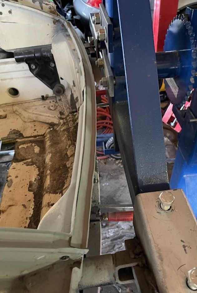

I ended up making a whole new front channel as I had some slight rust under the original.

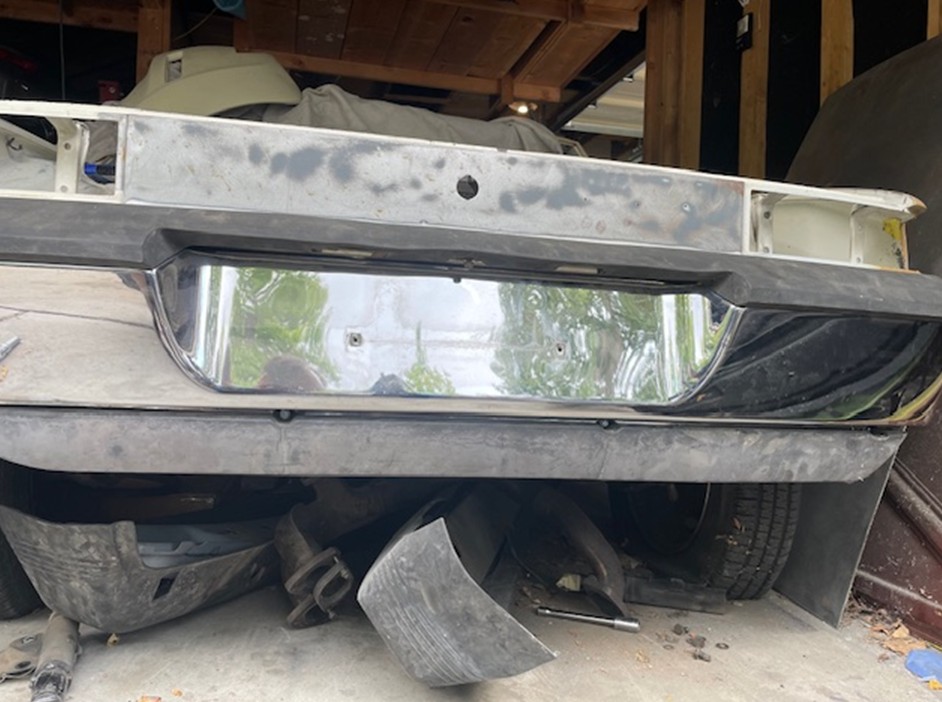

I hate the Rear BUBs, But oddly enough, I still like the front BUBS that wedge style front is what left its foot print on styles in the late 70"s
So I just back dated the rear bumper
