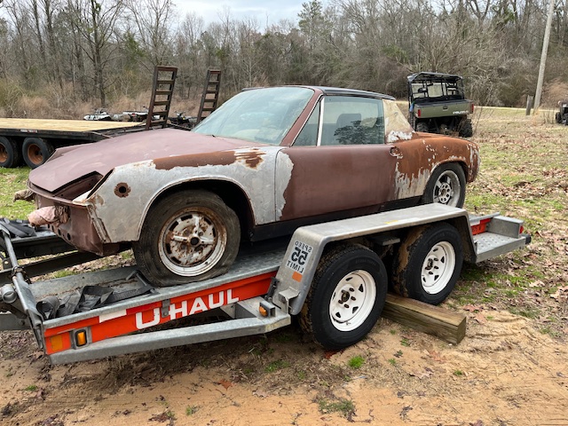

Well I finally was able to go and pick it up yesterday and bring it home. A very interesting journey it was. I rented a U Haul car trailer and drove about 90 miles back to get it, still sitting where I left it. The seller helped me get it onto the trailer and then we went searching for missing parts and found most of them. The bumpers are in decent condition for their age and I got a couple of other trim pieces I can't identify yet. Got the door cards, all the window and door handles. All the dash instruments are there. It has a set of Fuchs wheels. Haven't found the headlights yet. The tires are trash, never seen steel belted radials deteriorate quite that way. I'll replace them all with some old cheap tires to move it around but will put all new on it to drive. I can open the rear trunk without any problem and both doors can be opened but the front hood, boot or whatever it is called is stuck. It's partly open but won't open completely. The passenger side hinge there only has one bolt. The driver side release is in need of lubrication as is just about every other hinge on this car. I tried to get the plastic battery tray out but one of the bolts seems to have a stuck nut on the inside. Happy to say there is so far no evidence of serious corrosion but I'm just getting started. The rear trunk had a bunch of junk in it but I cleaned all of that out and again, no sign of rust or any serious paint failure. I do believe this car stayed under cover out of bad weather for the last 25 years or so.
Got all the carpet out and floors there are in surprisingly good condition as well. I think I'm going to let it sit for a few days completely out of the weather and just let it dry out. This is going to be interesting and I hope a lot of fun. It's hardly the worst car I've ever restored but not the best either. A few photos from my phone are hopefully attached, I'll post better shots when I get them downloaded.

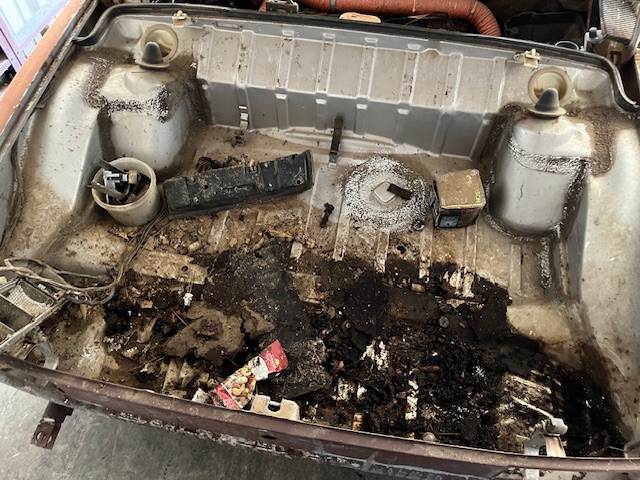

I got into it again for an hour or so this morning trying to get the battery box out. Definitely some kind of plastic replacement and definitely a hurry up job. It has a screw going though one side that won't come loose and I kid you not, an L bracket that I would normally use to put up a wall shelf if I were in a hurry is holding it in place. I think it will take a hack saw to get that out of there and I have no idea how the person who did this managed to get nuts onto the bolts inside some of the sheet metal but I have to wonder if a trip the the doctors office afterward was involved. More damage to the hell hole than first seen but no surprise. I need to get the side skirts off for more inspection. By the way, where are the jack points on this car? I'm going to have to put it up on stands long enough to get tires replaced just so I can move it and don't want to punch a hole in the bottom. I noticed battery cables in place and there is oil in the engine. I wonder if it will turn over.
Rick H.

That battery tray is the top of a marine battery tray. Looks like it is just bolted on the wall and that should come out very easy. I got and old 914 that the PO made a battery out of wood.

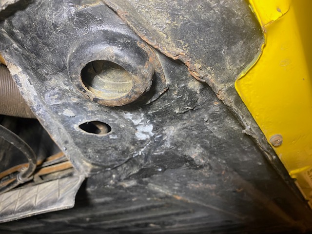

Jack points are the little raised bits Hanging down just under the longs. Pretty obvious if you look around. There are four of them and they all look the same. Good luck! I think Red Green has a saying like "if they don't find you pretty, at least they will find you useful"? If I were you I wouldn't be shooting for the moon on that one, just clean it up real good and figure out what you got. That motor... Yeah ... Better to focus on the body for a bit and don't let the mechanicals get you down. Those will be far easier and cheaper than the body.

I have heard some people say not to jack up the car on the doughnuts (the raised bits emergygt350 is talking about - I'll attach a picture to make it clear) but I think most of us do. That's what I use when I put my car on the lift. In the rear you can also use the engine bar as a jack point. Under no circumstance use the factory jack points until you know the condition of the longs, and even then there are probably only a few people who use them.
