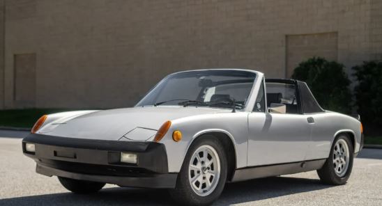

Given your 914 is a 1975 and most likely silver, should have looked something like this when it left the factory. The bumpers are rubber covers over a steal beam:

Mine was built in November and is 5767 so around 1700 were built between mine and yours. It is indeed a '75.
Good luck with the build!
BTW, your motor is most likely a 1.8 but could be a 2.0.
Oh, and yes, I backdated my bumpers. I have some really nice late ones for your car if you want/need them. Free if you want to come get them.
