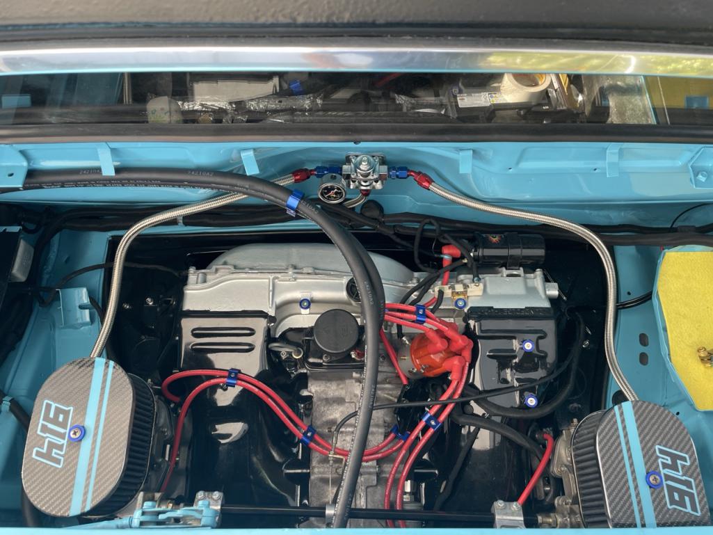

So after 5 long months of work, I finally have the 2056 built and installed. (IMG:style_emoticons/default/piratenanner.gif)

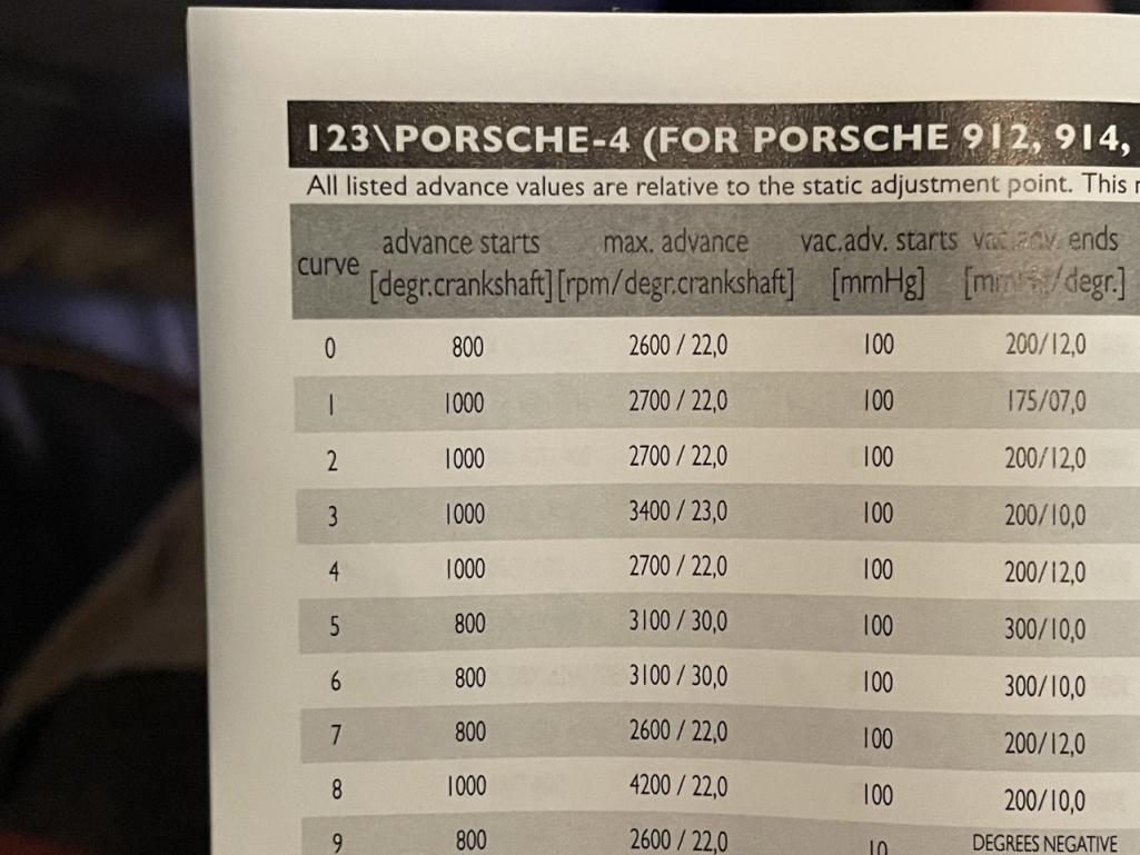

1) Since our motors go in a CW direction, the first movement of the distributor goes clockwise until the light turns off? Then CCW until the green light comes on? Correct?
2) The engine has dual carb Webber 40’s/Web cam 86a/Mild port and polished stock valve heads. My question is what setting should I use on the distributor? From what I see it looks like curve #3. Does this sound right?

technicalninja   Curve 3 looks fine for an initial setting to me. ...   Apr 27 2025, 08:54 AM
emerygt350   Curve 3 looks fine for an initial setting to me. ...   Apr 27 2025, 09:49 AM

Chad911sc   Yeah 3 is what I read on a couple other sites as w...   Apr 27 2025, 07:48 PM
