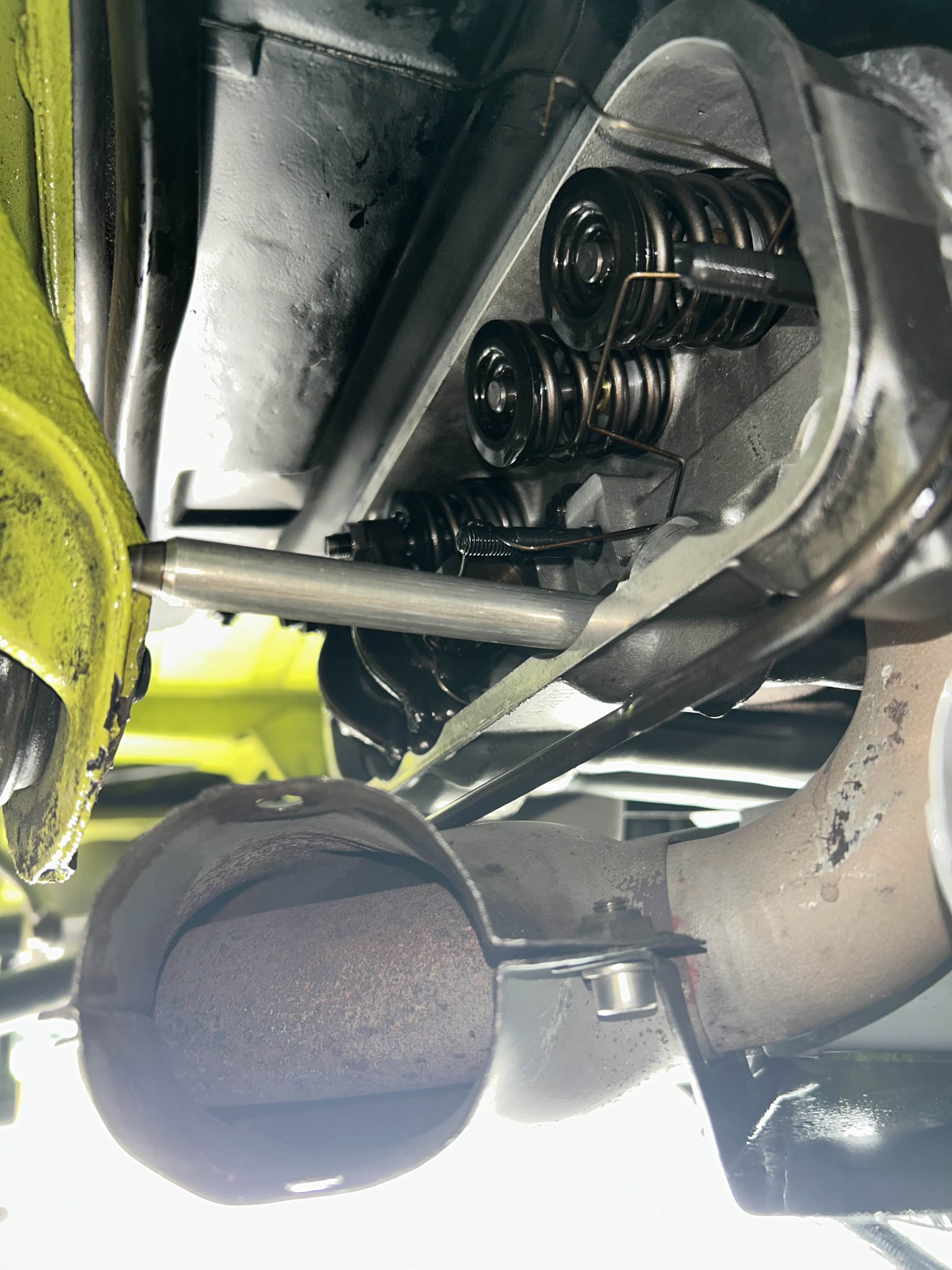

So I wasn't crazy when I posted earlier that I cannot get the intake push rod out on cylinder 4. It's hitting the body/frame of the car. Should this not be happening? Any way to pull it out so I can roll it w/o without dropping the engine?

QUOTE(DC_neun_vierzehn @ Jul 18 2025, 01:38 PM) *
You don’t need much. Undo the two large bolts on the crossbar. And lower it a bit with a floor jack.

Unseat the pushrod tube by a twisting force and pull the tube out away from the engine centerline.
The pushrod can then be removed by pushing it towards the case and out through the narrower end of the tube.

DC_neun_vierzehn

Well boys … didn’t go as planned today.
I lowered the motor to gain access to that C4 intake pushrod, but it still would not come out - the rod was still hitting the body/frame. I took it as low as it would go after removing the 2 engine bolts/nuts (probably 3” lower). No dice.
So then I removed the S tube connected to the HE on the passenger side to gain better view of pushrod tubes … I contemplated removing that pushrod tube, but that’s a tough one to get a grip on with the exhaust header pipes and it’s sandwiched b/t other pushrod tubes pretty close. Never pulled a push rod tube before . I don’t have the tools for removal nor new seals needed for reinstall … and lacking confidence … so I held off.
Unsure of next move. Maybe it’s time to take it to a shop to assess?

Hmm, I thought it would go a hair lower without disconnecting the transmission mounts. Did you recheck the clearances?
DC_neun_vierzehn
post Jul 19 2025, 03:38 PM
Post #60
Posts: 654
Joined: 16-November 20
From: Coastal Delaware
Member No.: 24,893
QUOTE(emerygt350 @ Jul 19 2025, 03:30 PM) *
It went down several hairs … probably 3” but still not enough. I went inch by inch lowering then checking, lowering and checking. The engine bar went down to where it wouldn’t any more (meaning I saw space between the jack pad and the engine bar after a while) and still not enough to get the rod out. It was so close but no dice.
