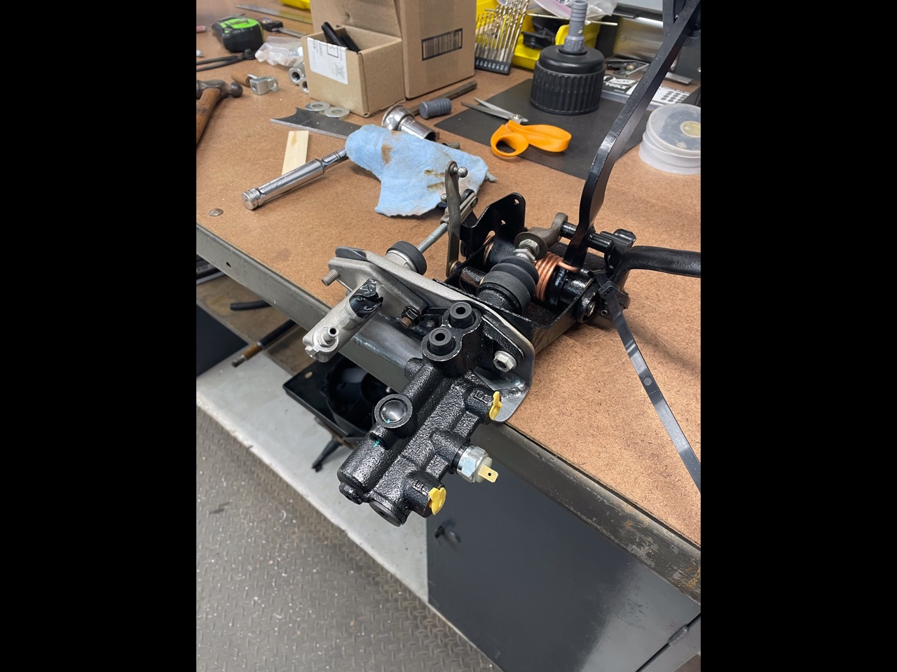

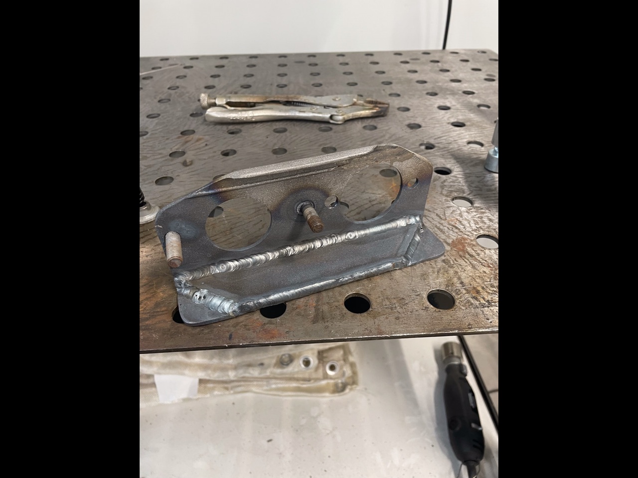

Here’s my setup. It’s for my Suby conversion, but should be viable for any setup. Don’t score my welds (IMG:style_emoticons/default/smile.gif)

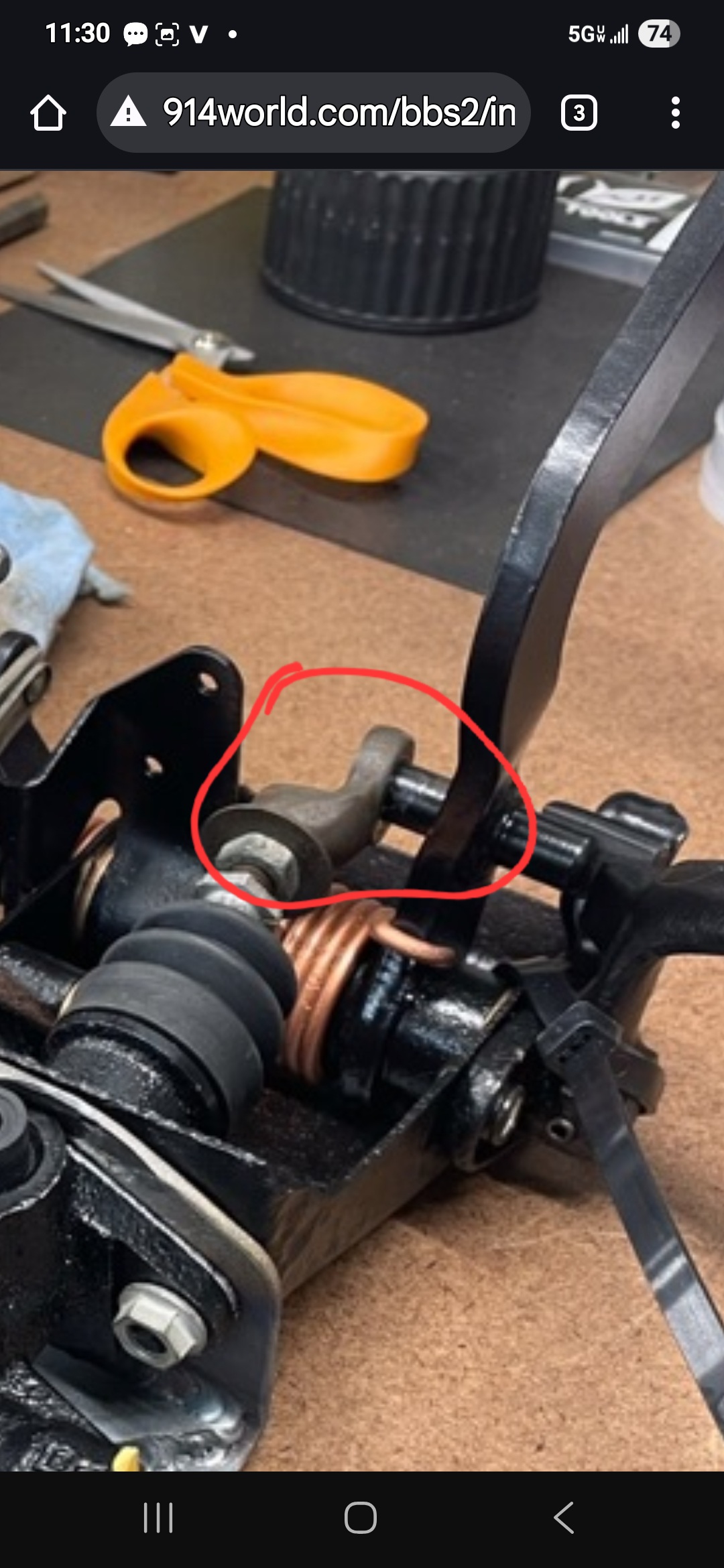

@East coaster
You need to push the brake rod assembly onto the post and install the washer and cotter pin.

QUOTE(bdstone914 @ Jul 15 2025, 11:34 AM) *
@East coaster
Yup, it’s all together correctly in the car, this was just playing with the setup on my bench.
